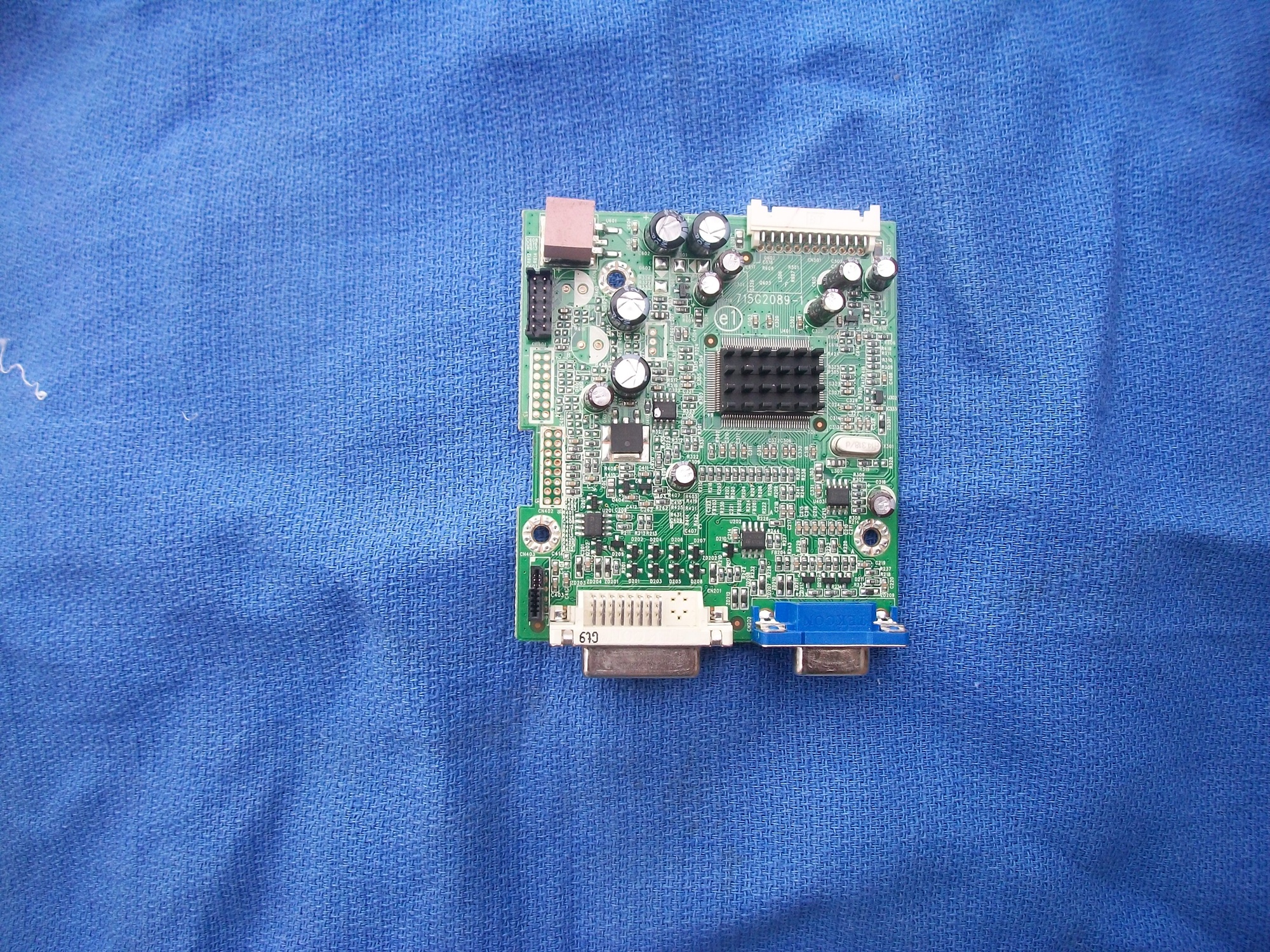

                                  #56
                                  Re: Dell E207WFPc
                                  On L903 on both pins I got 5v
                                  On L904 on both pins I got 14v
                                  On connector to signal board Pin 9 and 8 are ground pins
                                  Pin 7 & 6 I got 5v as printed on board
                                  Pin 5 & 4 are blank (no wire)
                                  Pin 3 reads 0v
                                  Pin 2 blank (no wire)
                                  Pin 1 reads 0v
                                  On signal card connector I got the same readings on each wire as above.
                                  Pictures of signal card attached.
                                  Have you ever stopped to think and then forget to start thinking again?
                                  As a very wise man once said on this forum: "Of all the things I have lost I miss my mind the most."

                                    #57
                                    Re: Dell E207WFPc
                                    Pin 3 reads 0v
                                    Pin 1 reads 0v
                                    OK, power supply is working, and sending 5 VDC to the signal card. Did you check the wires at the connector or at the signal board itself? The connector pin seems to be a little high.
                                    Unfortunately, the picture of the top of the signal board leaves a little to be desired, could you retake it, please.
                                    Whoops, just to make sure we are on the same page, this is NOT the 'panel board' you referred to above, is it?

                                      #58
                                      Re: Dell E207WFPc
                                      No it is not the panel board. That board is attached to the back of the LCD Screen. I took the readings from the connector. The connector on the power board has nine pins in a straight line. The connector on the signal board has two rows of pins so I was not sure which pin was which and I just measured at the top of the connector where I could tell what wire went where. I will try to get a better picture. It is dark here now so I will take it first thing in the morning.
                                      • PlainBill
                                        • Feb 2009
                                        • 7034
                                        #59
                                        Re: Dell E207WFPc
                                        A quick background on what is happening here. A monitor is totally 'fly by wire' - the processor on the signal board controls everything. Once the power cord is plugged in it scans the front panel looking for a key press. It turns the power LED Green (or blue), amber, and off, the inverter on and off, adjusts the brightness, and turns the power to the LCD panel on and off. And of course, it also processes the video information.
                                        At this point it's very likely the signal card is bad and we have to figure out if it is repairable.

                                          #60
                                          Re: Dell E207WFPc
                                          I understand. Hope these pics will help.
