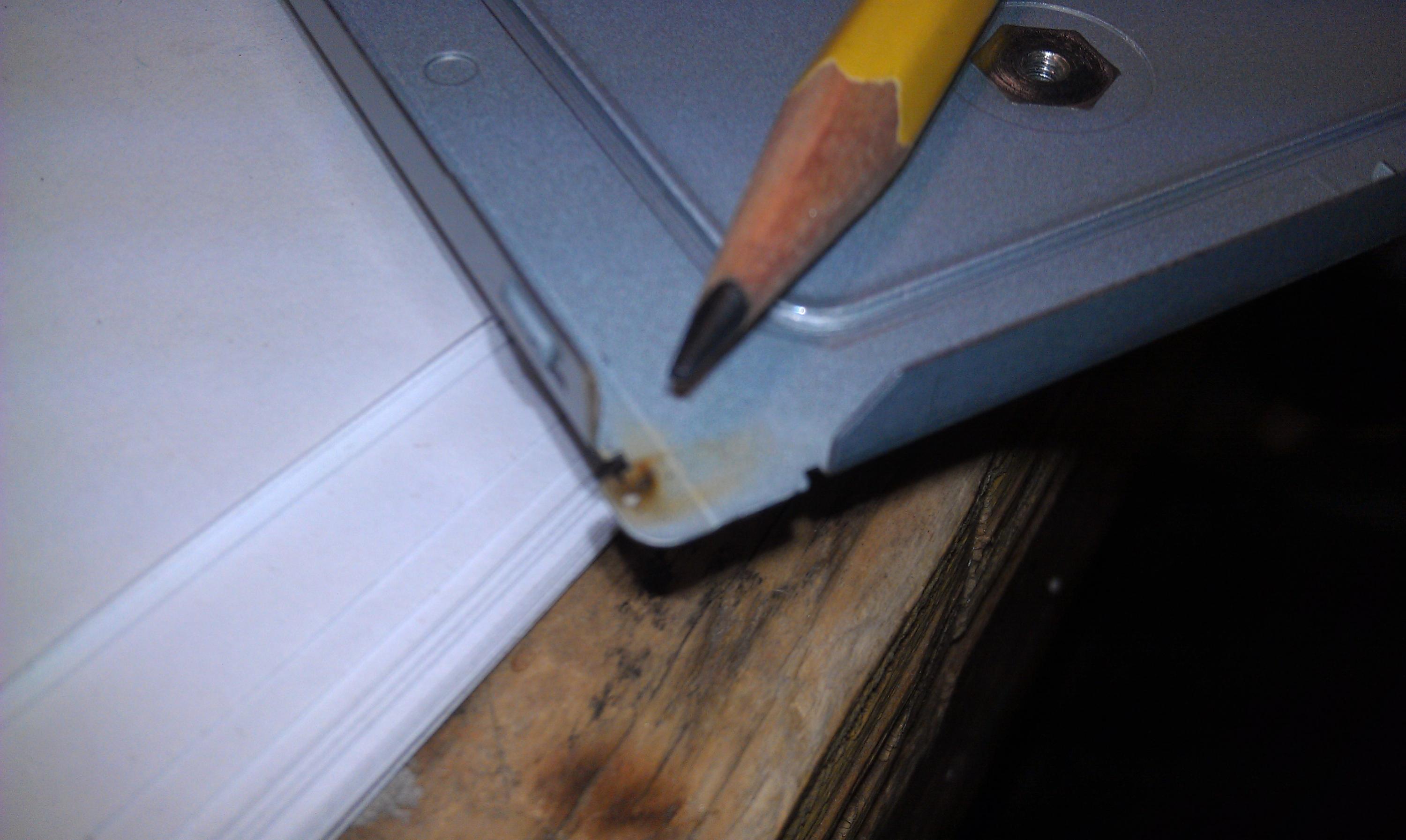

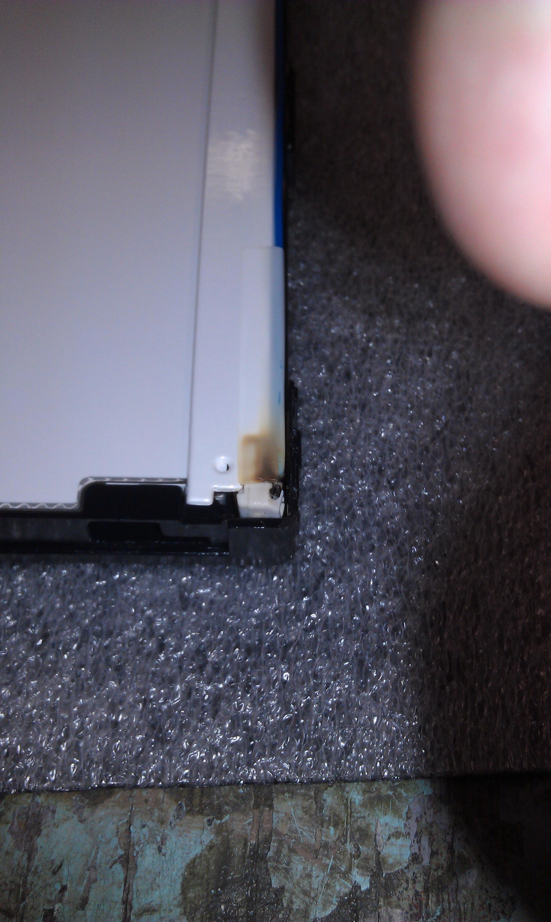

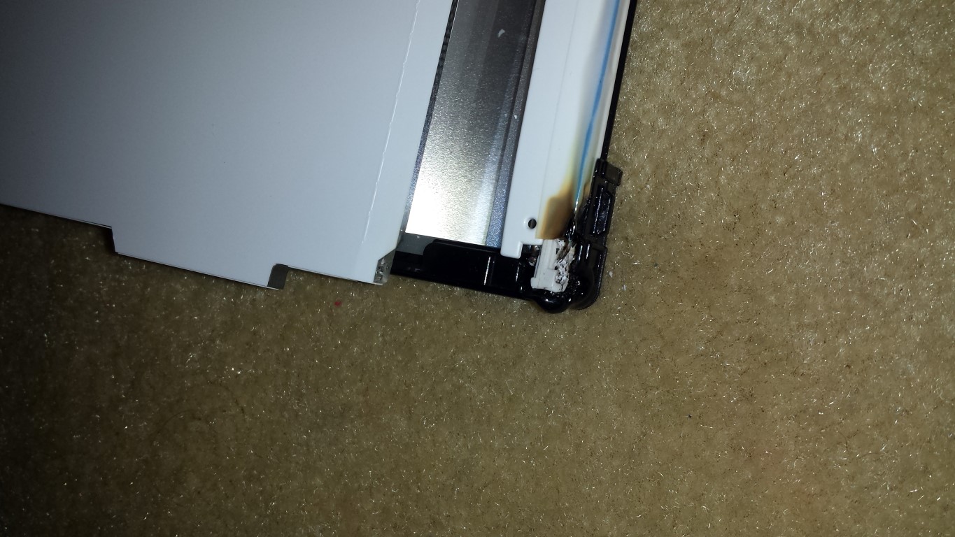

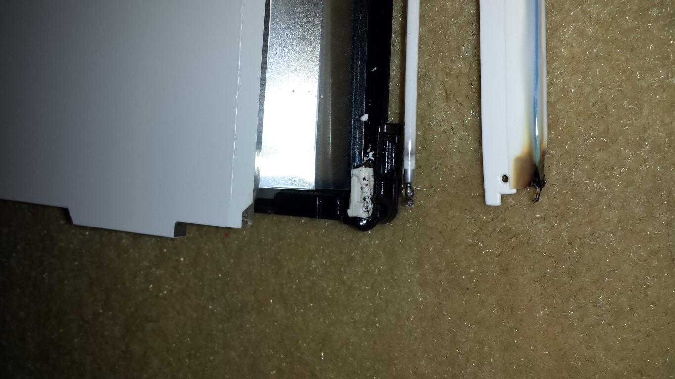

        I know this thread is old, but this info might help someone else. I just received this same monitor from a friend it had the exact same symptoms as this guy did. push the power button had a brief flash of the pc desktop then dark, with a flashlight the PC desktop is seen just no backlight, power button led stays blue, after reading thru this forum i came to the conclusion it must be a bulb or inverter issue so after taking the screen apart and looking at the cfl's i noticed where the cfl connects to the tube whoever assembled the screen missed putting the tape over the corner where the wires meet the bulbby about 1/8" inch but just enough to cause the wires to short to the case i included a couple pictures (not very good but you will get the idea) i am going to order the cfl from lcd parts.net $14.95 so a fairly cheap fix (I hope) if i do not wreck the thing putting it back toghether.

          That the burnt wire symptom, very common due to poor soldering workmanship.
          I would inspect all the wires, also pull it slightly to see if it will come right out.

            Update i replaced just the top cfl from lcd parts.net (quick shipping) and put it back together powered it on and IT WORKED wahoo. I will add that the bulbs are way fragile and putting all the layers to the panel back together and correct was not a task i enjoyed quite tricky but did it and have a happy friend with a working monitor. Thanks for this forum and all the helpful people here
