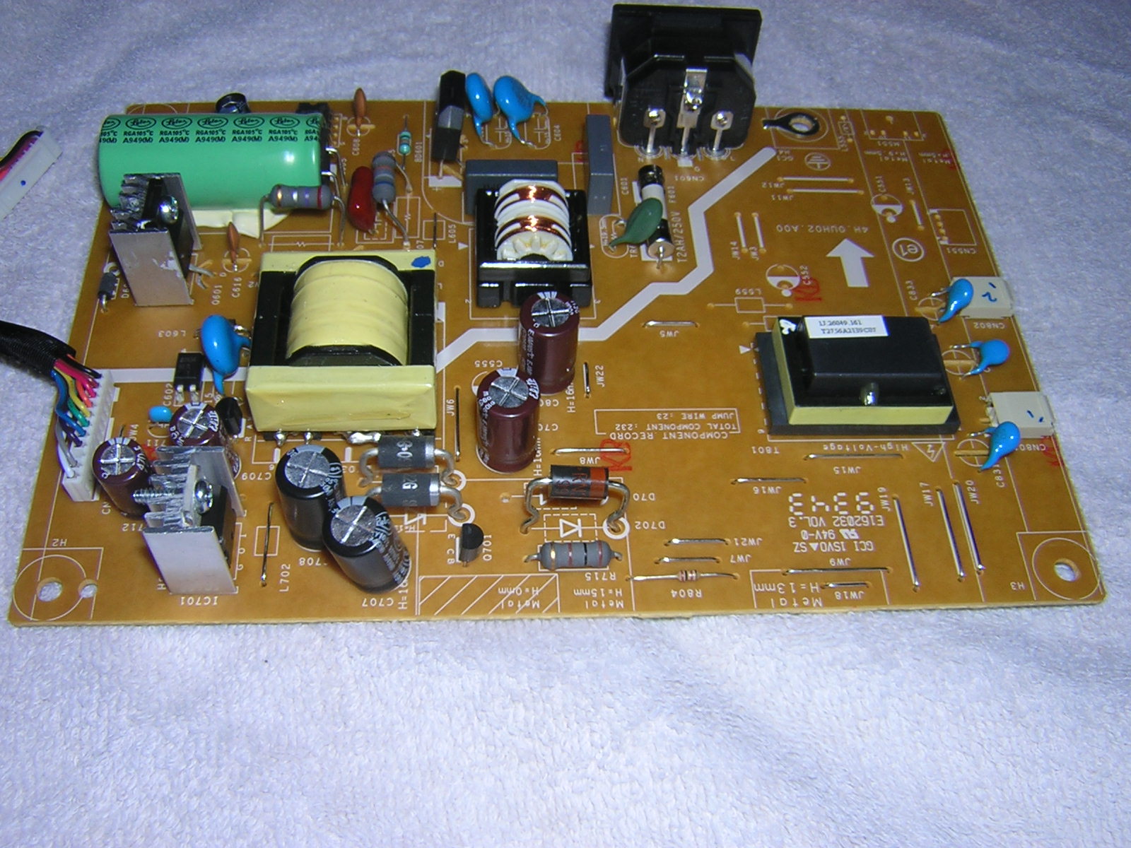

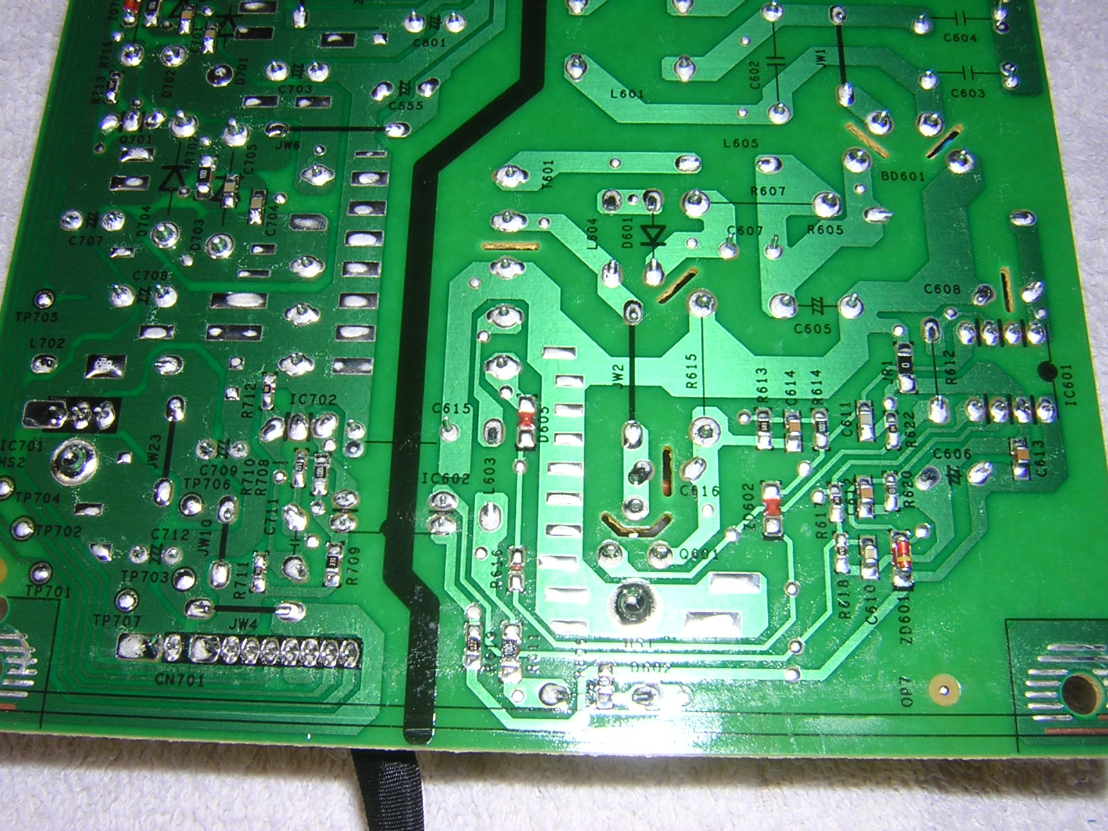

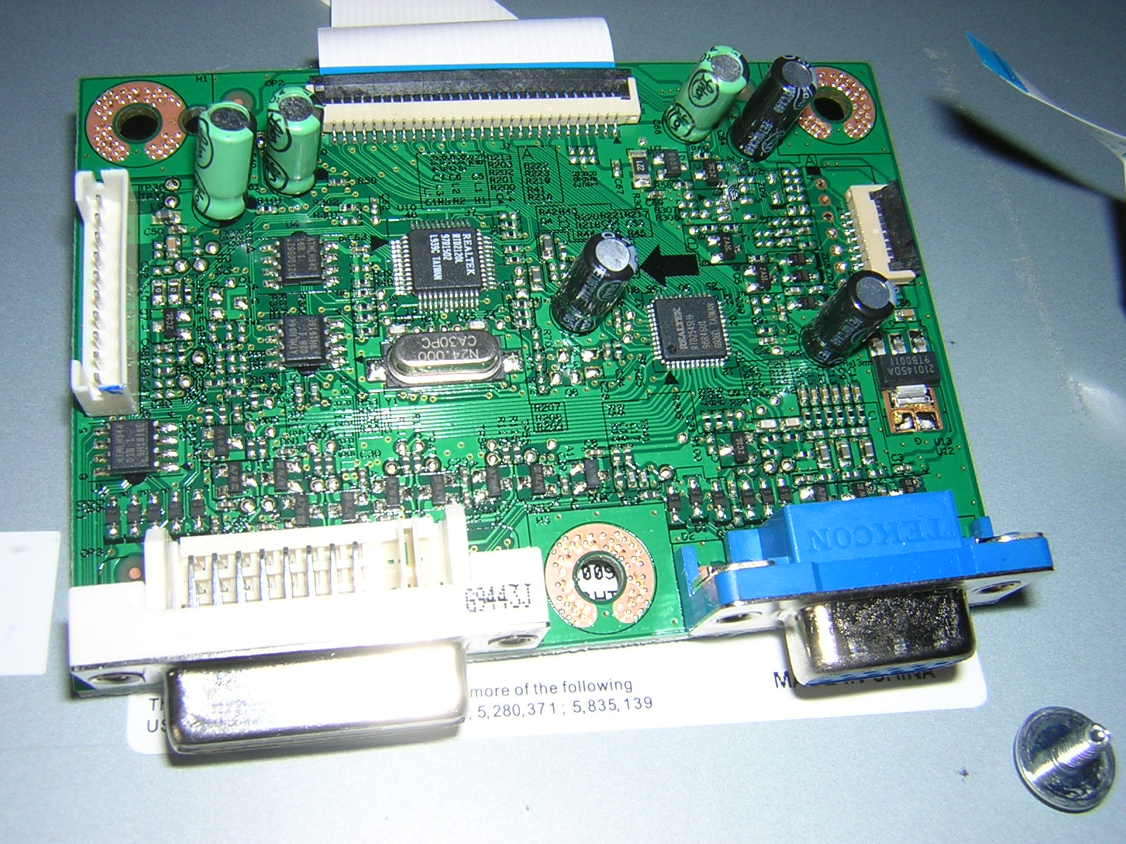

    Hi, its been a while since i did any kind of repairs..........but a neighbor has a monitor that is not working and they asked me to take a look at it.
    its an ASUS VE205. You turn it on and it onlly stays on for about 2 seconds.
    I have taken pictures of the boards. I took front and back pics of the power supply/ inverter board.
    Any ideas? The caps look ok to me.......but i know that sometimes "looks" are not every thing.

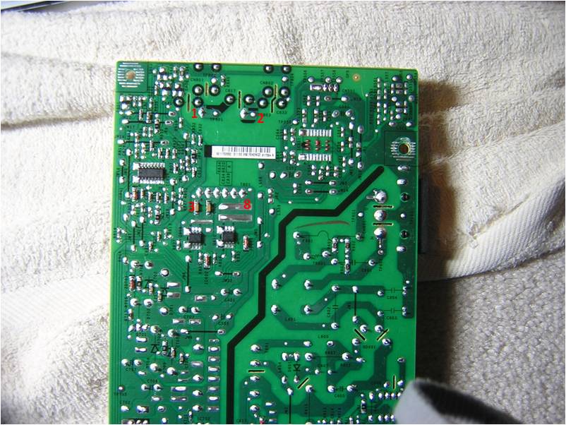

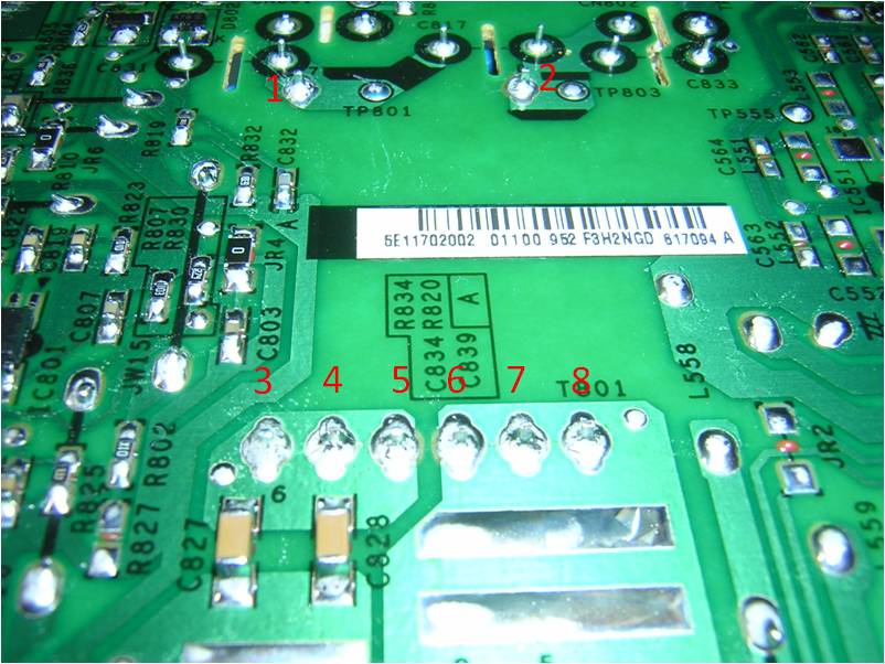

                      transformer tests: (see enclosed pic for labeling)
                      1 to 2: 0.448 Kohm
                      1 to 3,4,5,6,7,8: open
                      3 to 4: 0.3 to 0.4ohm
                      3 to 5: 0.3 to 0.4ohm
                      3 to 6: 0.3 to 0.4ohm
                      3 to 7: 0.3 to 0.4ohm
                      3 to 8: 0.3 to 0.4ohm
                      NOt sure if the above readings are good or bad for transformer

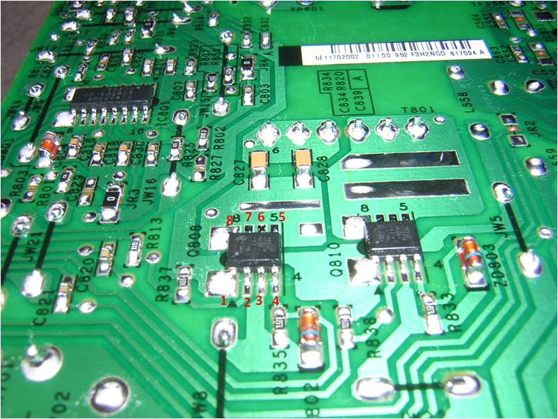

                      IC: alphaomega 4614
                      https://cdn.badcaps-static.com/pdfs/...0e94bf963c.pdf
                      1 to 8: 3meg ohm
                      2 to 8: 3meg ohm
                      3 to 8: 3meg ohm
                      4 to 8: 3meg ohm
                      1 to 2: 10kohm
                      3 to 4: 5kohm
                      Not sure if these are good readings.....i think so but not sure
                      thoughts?

                        Looking at pictures and telling you what pins to test is something i am not very good at.
                        It is exceptionally difficult with the pictures you provided, a better picture would be one straight down showing the entire board, please try to use natural lighting.
                        I THINK the secondary's are you're numbered pins 1 and 3 and numbers 2 and 8
                        Whatever I do, I consider it a success, if in the end I am breathing, seeing, feeling and hearing!
                          Re: Asus VE205 .... 2seconds to black

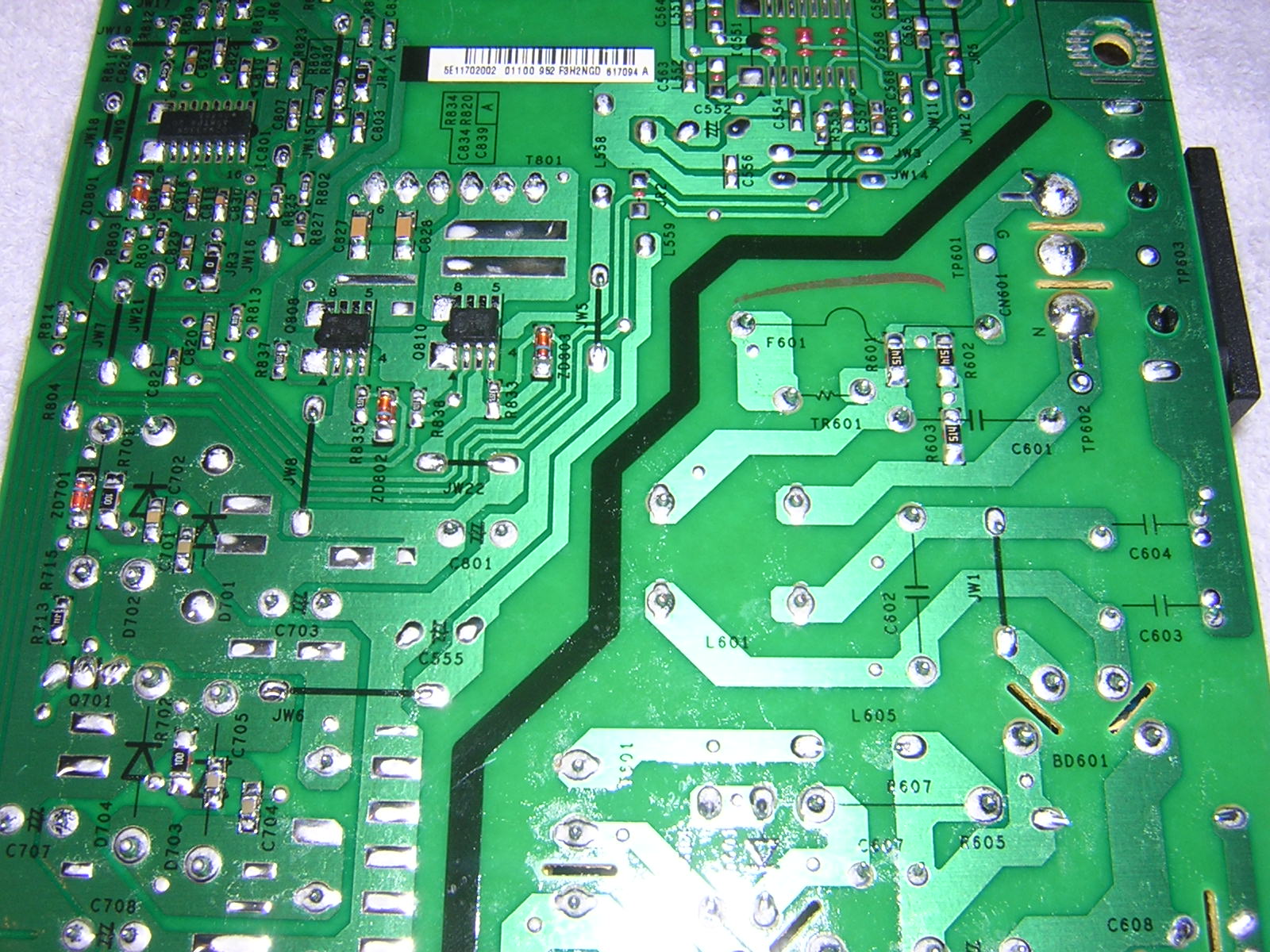

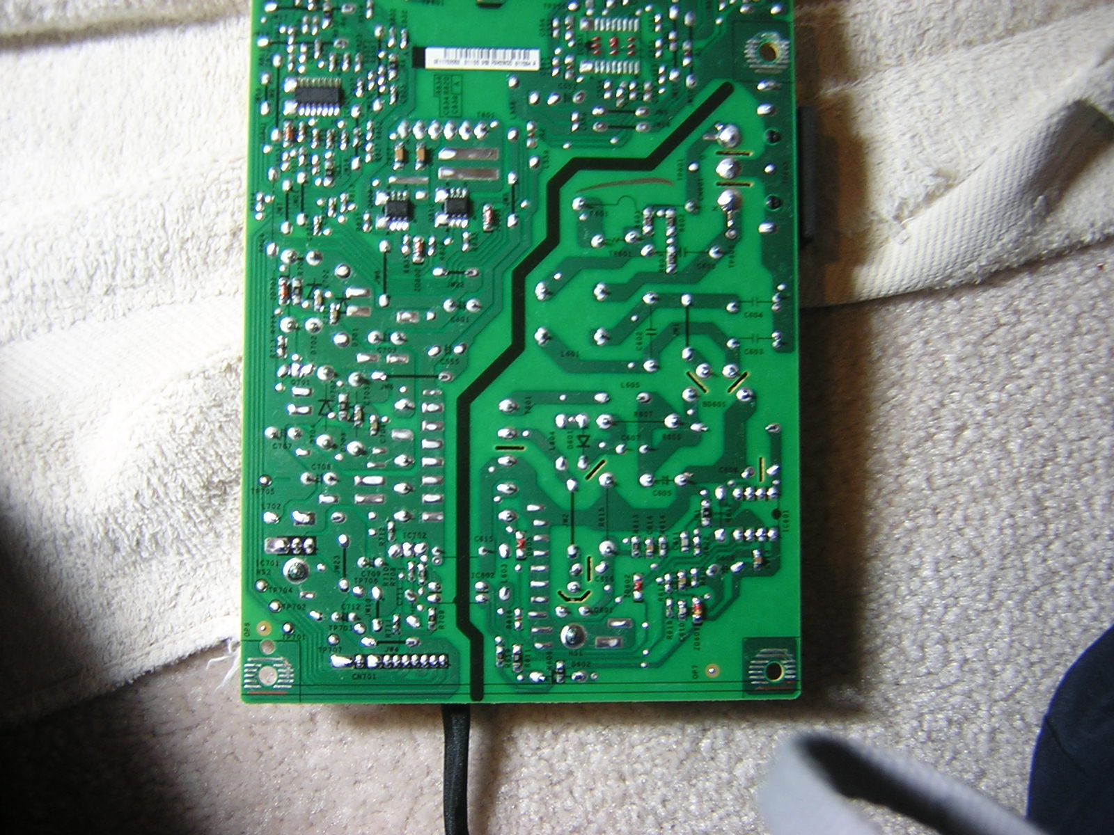

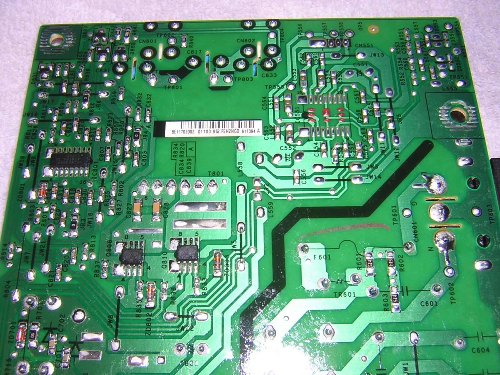

                          i am enclosing two pics of the back side......both pics together show the entire back side........i also show the pins on the transformer.
                            Well my eyes saw it in the very first picture,but i guess my mind didn't let me believe it.
                            This monitor looks like it's only using 2 CCFLs.So it looks like you measured the correct pins.The problem is we don't have anything to compare the reading to.
