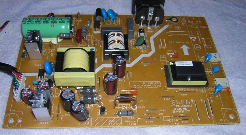

            Re: Asus VE205 .... 2seconds to black
            The white pigtail tube fuse. Its pretty clear as day to see it on the board. You have to de-solder it from the board.

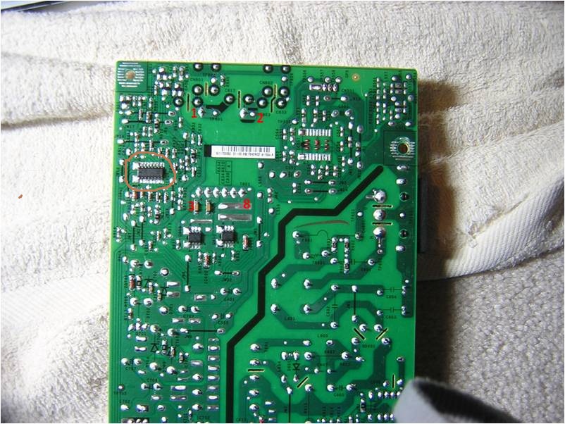

                  ok. I replaced caps but still the monitor does not come on.
                  I replaced caps (see enclosed file)
                  1:330uF/35V
                  2:330uF/35V
                  3:680uF/16V
                  4:680uF/16V
                  5:470uF/16V
                  6:470uF/16V
                  I DID NOT replace caps 7 and 8.
                  Cap 7 is 47uF / 50V
                  Cap 8 is the "big" cap which i understand does not normally go bad.
                  i recall from a post bill put out some time ago. I have done all of these. But i have not gotten any feedback on #2. Does anyone have any other ideas on this monitor. If not i am going to give it back to my neighbors and tell them to buy a new one.
                            What is the number stamped on the IC circled in brown?
                            Whatever I do, I consider it a success, if in the end I am breathing, seeing, feeling and hearing!

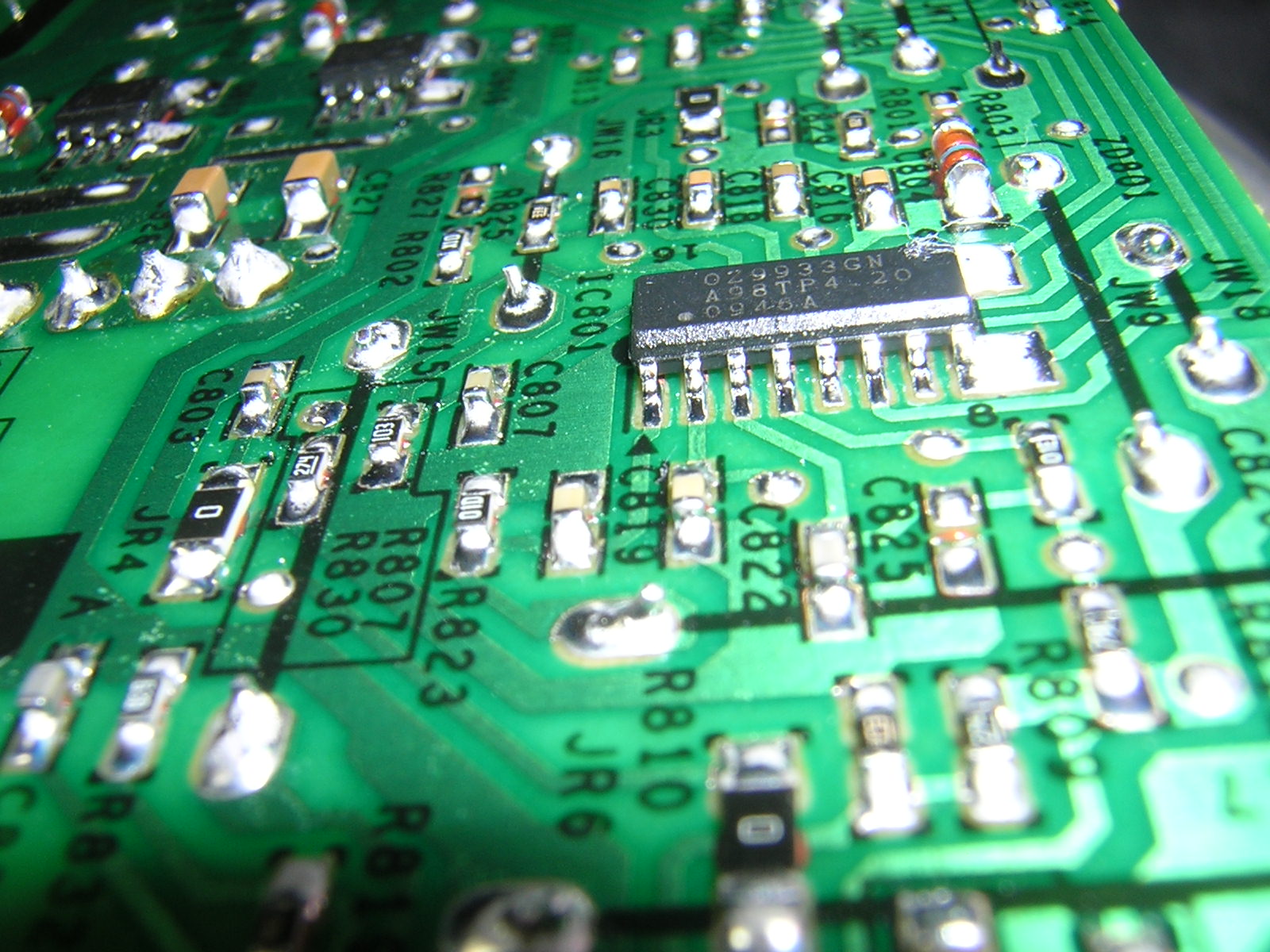

                              #34
                              i am enclosing a pic of the part........
                              the marking on the part looks to be the following:
                              0Z9933GN
                              A98TP4 20
                              0946A
                              The "6" in the last line could be either a 5 or 6 but i think looking at it with a magnifying glass looks like a 6.

                                #35
                                i think the part number is
                                "OZ9933GN"
                                first letter is an "oh" not "zero".........i think

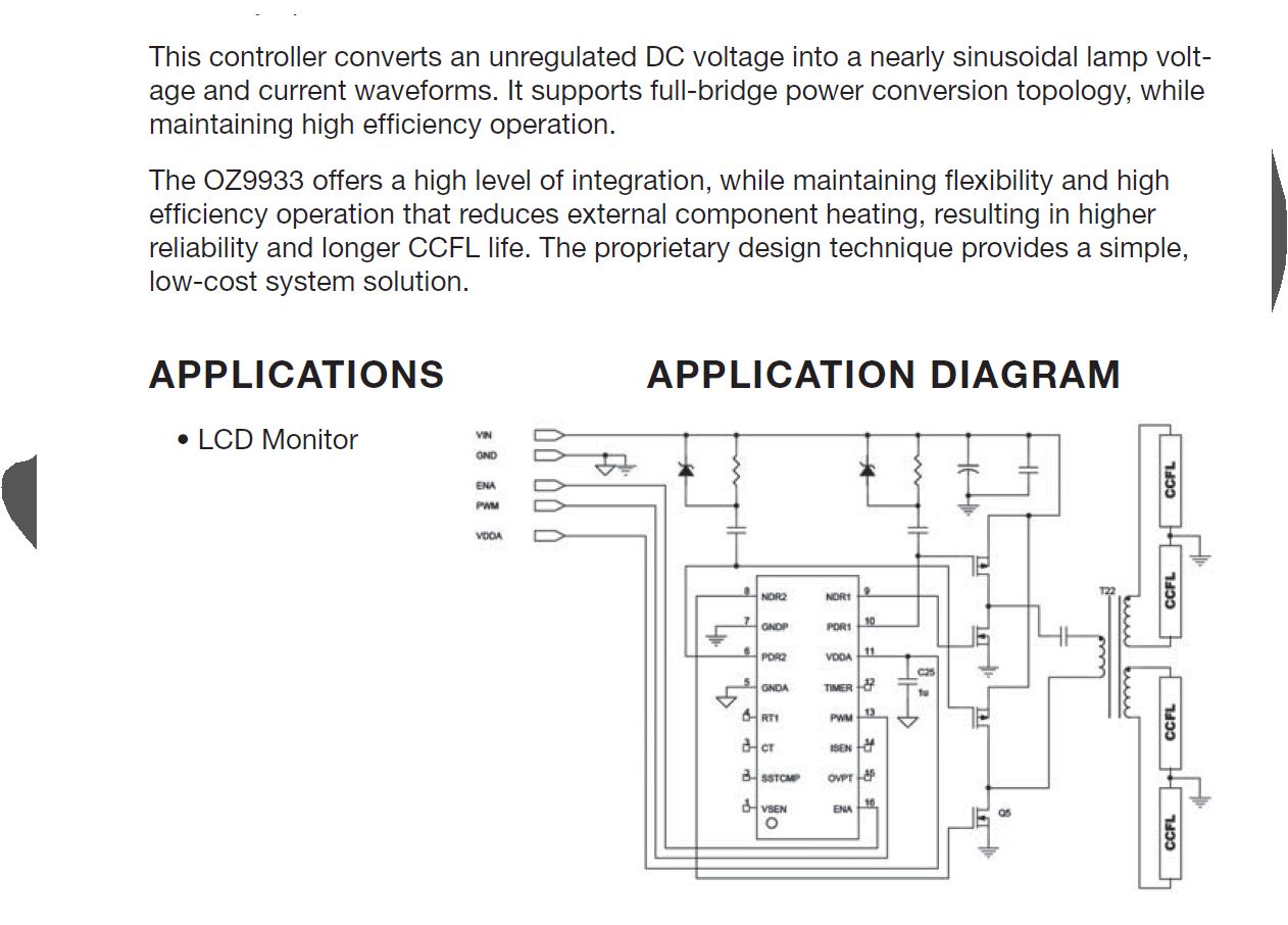

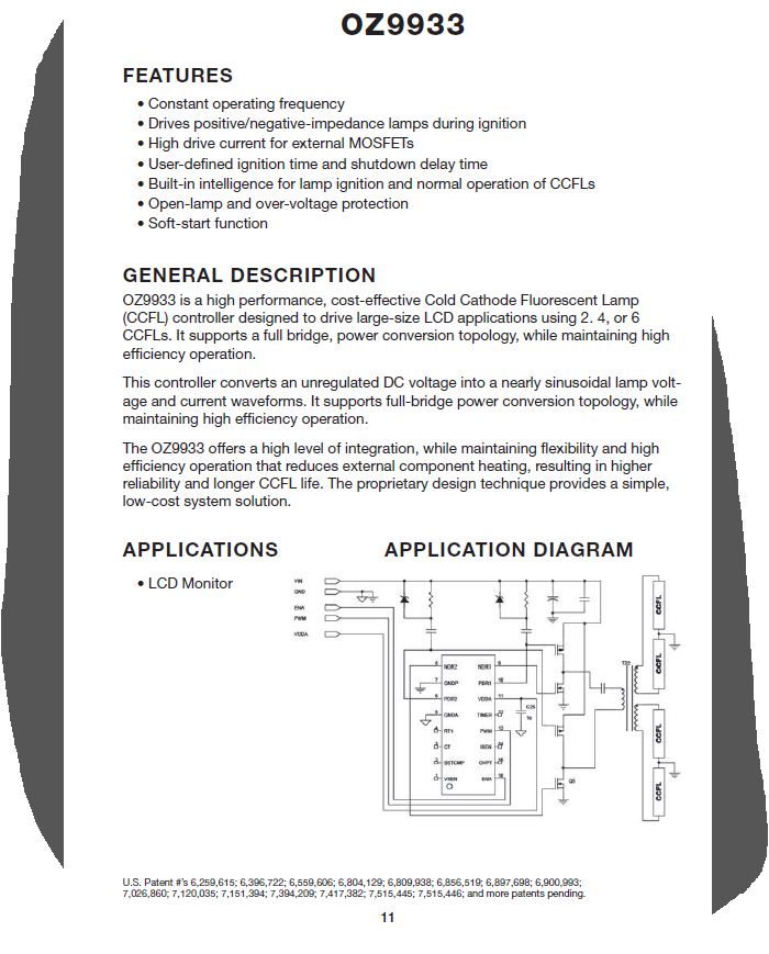

                                  I am going to be out for awhile,
                                  Here is the only information I found on the OZ9933
                                  Looks like pin 16 is the BL on pin

                                    #37
                                    to test the BLON voltage i just monitor pin 16?
                                    • PlainBill
                                      • Feb 2009
                                      • 7034
                                      #38
                                      Yes. Note that it is labeled ENA - Enable.
                                      PlainBill
                                      • alexanna
                                        • Mar 2010
                                        • 1346
                                        #39
                                        Yes positive lead to pin 16 for the BL on signal, It will probably read about 1 volt.
                                        You just need to compare the voltages when the backlights are on, and see if it stays the same when they shut off.
                                        Pin #4 looks to be the ground. And pin #11 VDDA is the power supply to the controller.
                                        I do not know the exact voltages you will see, you are just looking for something different when the lamps are on and when they shut off.
