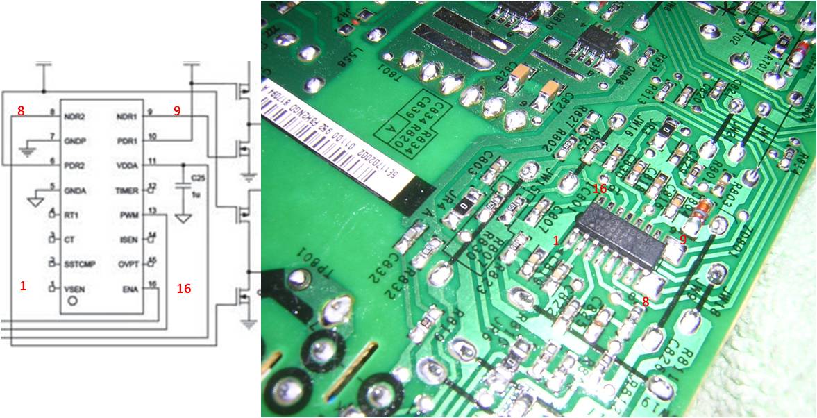

    You measured the power supply voltage to the controller; Let me get back to that in a moment.
    Measure the enable or back light on voltage positive lead on pin 16 lead,what voltage reading do you get with the back lights on and off?
    Whatever I do, I consider it a success, if in the end I am breathing, seeing, feeling and hearing!
    • Welchs101
      • Sep 2008
      • 979
      #42
      Re: Asus VE205 .... 2seconds to black
      Sorry, measured the wrong thing.
      Using pin 16 (ENA pin) and pin 5 (as gnd).
      Power on the monitor and LED light turns blue...........
      Pin16 DC voltage relative to pin 5 is........2.9Volts
      when LED light goes orange the Pin16 value drops to 0.1Volts
      Is this what you wanted measured? If not just let me know.
              Good,now would you measure pin 11 VDDA.
              With a signal applied to the monitor.
                pin 11 with computer connected relative to pin5 (gnd) is 5.0V.
                  When monitors first turn on they go through a self test of the inverter. By turning the back lights on to full brightness to check for proper voltage and current flow. So the back light on voltage starting high and going low and then going back high in my opinion is OK.
                  As long as pin 11 VDDA stays the same when the backlights are on and off, that also should not be a problem.
                  Even if a schematic was available this would be a difficult one to diagnose.
                  At this point I am out of ideas.
