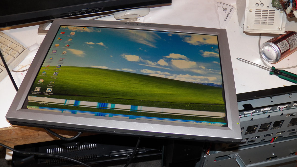

    Hello all.. this is an offbrand LCD monitor made by Metro. Original symptom is 2sec to black issue. You can see the WIndows XP screen no problem before it goes away.

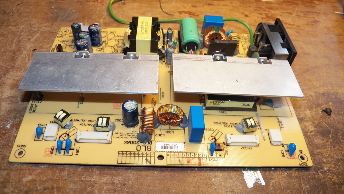

    Opened it up and I could smell something burnt.. this is a first for me! One of the little blue capacitors had burnt to a crisp. It's neighbour is a 12J 3KV capacitor.
    Looking for input here.. what would cause this cap to go poof? Bad transformer or bad CCFL? I probably have a replacement somewhere in my pile of boards.
    Thanks!

    Re: Metro LCD with crispy cap.. 2 sec to black issue
    The caps in this position have been known to fail. The first step would be to replace it and let the monitor run for a few hours before buttoning it up and giving it an extended run.

      Thanks Bill.. I have plenty of 3KV caps from other boards... will solder in another one and see what happens as you say.
      I will report back when I've had a chance to do it.. too many other things on the go this week.

        Make sure you match the capacitance (12pF).

          Hi Bill.. well I got the 2 second to black issue solved.. I found an identical blue cap on another board. However I think the effort turned out to be a partial waste.
          Fired it up and got these two white lines on the screen with a bit of black in the lower corner.
          Took it apart again.. found 2 caps on the video board that were really bad so I replaced them.. fired it up same result.
          Bad screen now?
            Bad screen now?
            Yes. That is a bad panel.
