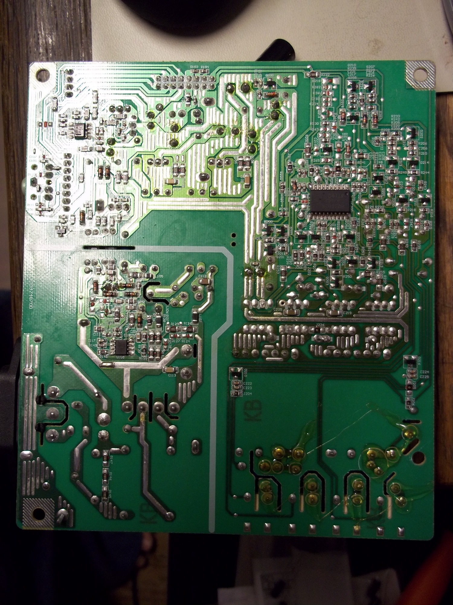

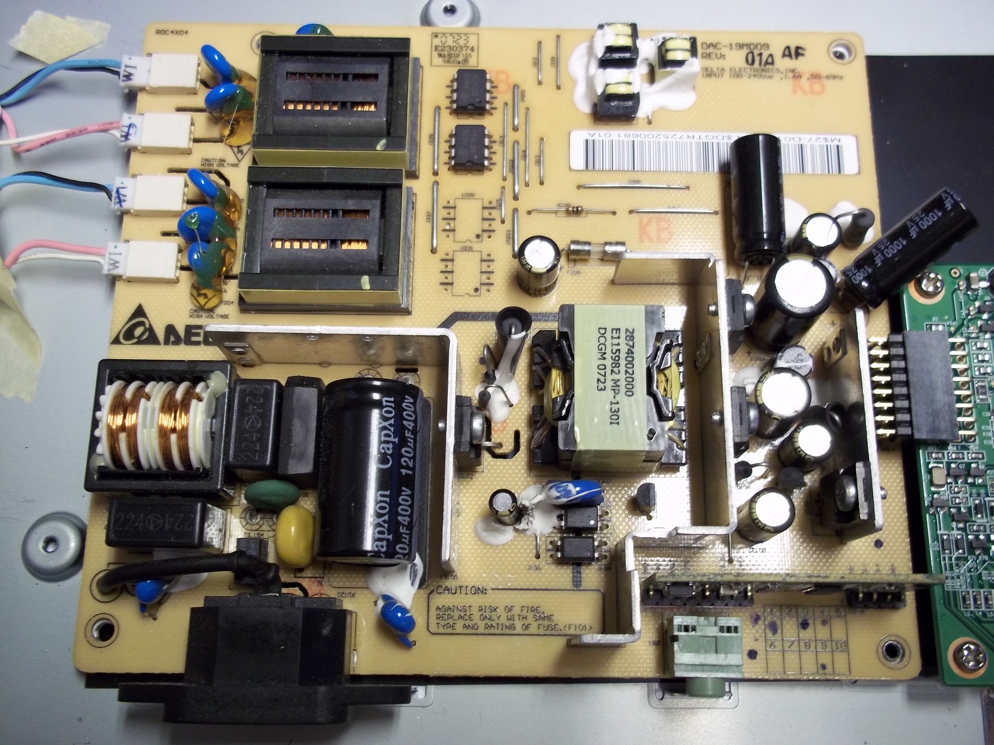

    Earlier this year around February, I found a Viewsonic VG2230WM in the trash. I took it apart and found blown Capxon caps. I replaced all but two with FR, FM and FC caps and the unit was fine until tonight.
    The two I didn't replace was the big 400V 120uF and a small GL 50v unable to see the capacitance due to some really hard glue that even a razor blade couldn't cut into it or it removed the paint/sleeve from the can. I think it's 22uF. At the time I wasn't really confident in maneuvering in tight spaces with a soldering iron, since the location of the small one was surround by zener diodes on the back side, I skipped it.
    All night the picture kept freezing, I mistakenly thought it was the system on the bench locking up. Well Just about 30 minutes ago I got up and went to the kitchen and when I came back the monitor was missing the right portion of the screen. Maybe the T-Con board went kaput. But then I looked closer and saw the blue LED light was dimming then returning to full brightness, but the backlight did not exhibit this problem.
    Turn it off and it never turn on again, Unplugged wait a few, replugged it back in. It turn on and display ok for 5 seconds before green lines appear all over the right side of the screen and then the display went dead.
    Took it apart didn't see anything wrong.
    Question is would this small Capxon GL be the problem? it's located on the stand-by side of the board
    I'm pretty sure it's 22uf 50v, voltage is correct since that writing was in clear sight. But I don't have any 22uf, used my last one few days ago. I have 2.2uf and 47uf at 50v Panasonic FC, would one of these make a good substitute? or should I just order the correct one from digikey?

    I would not take the chance with the small start up cap.Replace it with exactly what was in it.The 22uf cap rings a bell.
    Dose your monitor use a Delta power supply?
    What the number of the board?

        YES!
        DAC-19M009
        REV: 01A AF
        All right, will place digi-key order after league tonight.

          Replaced that GL with an FM but the display still doesn't work.
          The light comes on then goes off and repeats.
          I hear a slight hissing or very quiet high pitch whine almost sound like white noise from the speakers but it definitely coming from the PSU. It sounds like it's coming from the area where the transformer that bridges secondary to the primary. It goes in tempo with the led turning on then off again.
          The cap I replaced is near J100, the hissing is in the general area.
          Any ideas what it could be?

                Try removing the glass fuse on the front of the power supply for the inverter.
                Then see if the front PLED responds normally.

                      Been really busy last couple of weeks then today I had free time so I've been cleaning and this monitor was just getting in the way so I need to fix it or junk it.
                      Anyways I removed the fuse and the monitor stays on, displays an image but...
                      I shine a light into the screen and it looks like the TCON board is fubar.
                      Right side screen is scrambled to hell. I switch the tcon cables around to confirm that it was indeed the tcon board and not a bad cable.
                      At this point it's not worth fixing. Since I have another viewsonic that's 17" with bad ccfl. It might have been worth it if it was just few lines but since it's the whole right screen, forget about it.

                          From your image I can tell you that the four connectors on your upper left corner are wrong, the two blue ones should be on the top, and the two pink ones at the bottom.
                          I guess you already got rid of the monitor, but in case someone refers to this thread...
                          (like me)
                            Re: RECAPPED Viewsonic VG2230WM died tonight.
                            The way he has them is correct, and actually it does not matter since they are 4 completely separated lamps, any one of them can be connected in any socket since since each lamp has its owns two wires.
