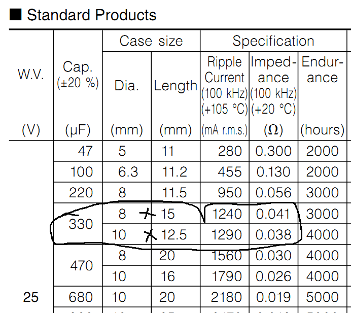

    ( note: I'm relatively a beginner in this but I did successfully recap a monitor and went through university with some electronics classes. Still you may want to wait for a word from other more experienced guys, maybe they disagree with something I say)
    You have to open up the monitor, look for any markings on the capacitors and then try to find the datasheet for that series of capacitors.
    For example, in my case I found a capacitor that says on it CapXon, GL and 330uF , 50v. So I made a search for "CapXon GL datasheet" and found the specifications.
    In general, what's important is the uF value, the voltage, ripple and ESR value.
    uF value, you keep the same.
    Voltage, you keep the same or you can go a bit higher but never lower, unless you're very experienced and can tell from the circuit that voltage is safe to use. Sometimes when you need a capacitor with higher ripple or lower esr, I believe you may find capacitors rated for higher voltage have better ripple or lower esr or both.
    Ripple value should always be equal or higher than what the current capacitor is spec'ed for.
    ESR value should be equal or lower. I have a mental note from a thread I've read on this forum (but I may be wrong about this or misunderstood what was happening there)... in some cases if the esr value is way way lower than what the original capacitor is spec'ed for, you may hear some other parts start to buzz, humm or vibrate.
    Here's the steps I followed:
    Pick the minimum dimensions for the capacitor you have and others slightly bigger ones that would still fit in the area (for example I picked 6x8mm, then I also picked 8x10 and 8x11.5 mm because they would fit in the space). Filter...
    Pick the uF value because that pretty much remains the same. Filter...
    Pick the voltage. Filter... (if no results or nothing on stock, go back and choose higher voltages and filter again)
    Sort results by dimensions, open the results in several browser tabs starting with the exact dimensions of the old capacitor...
    Check on each page the ripple value and the ESR, if you don't see the ESR look down on the page and try to find a link to the datasheet on the page - there should be a chart there in the datasheet where you find it along with the ripple.
    Then pick whatever you can order in the small quantity you need and still is better than your current capacitor specifications. (and from what I learned here, Nichicon, United Chemi Con, Panasonic, Rubycon are good and safe brands)
    PS. Here's an example... 330uF, 25v, found this one on Digikey: http://search.digikey.com/scripts/Dk...name=P12387-ND
    Scroll down to "Datasheets", click on the link. You're on Panasonic's site... click on Catalog. You get a PDF, scroll down until you see on the left 25, the voltage of the selected capacitor, and there you get both dimensions possible for that voltage and you see this:

                            Originally posted by PCBONEZ
                            Here is one example: 1500uF in 8x20mm
                            MBZ - 1870 mA , 0.019 Ohms
                            FJ - - - 1870 mA , 0.016 Ohms
                            If you went from FJ to MBZ there would be a ~19% reduction in ESR and ZERO increase in Ripple.
                            Would there really be an issue with the difference between .019 and .016 ohms of ESR in any consumer electronics circuit?
                            It's a serious question, really I'm not disagreeing, but seems to me that's pretty a trivial . I've replaced caps in a circuit that's just starting to have issues, where the ESR is 2 to 3 OHMS just a tad more than 19% out.
                            36 Monitors, 3 TVs, 4 Laptops, 1 motherboard, 1 Printer, 1 iMac, 2 hard drive docks and one IP Phone repaired so far....
                            • PCBONEZ
                              Grumpy Old Fart
                              • Aug 2005
                              • 10661
                              Re: Capacitor Ordering Help
                              Not likely to but it can be if that 0.019 ohm cap is remotely near it's Ripple Current limit.
                              First realize that the Ripple Voltage as measured on a cap goes down when ESR is reduced because more Ripple Current is passing -through- the cap.
                              Lowering ESR in a filter does not reduce the Watts of Ripple coming from the source, it only redistributes the -flow- sending more through itself (more Ripple Current -through- the cap) and away from the load.
                              [That's why lowering ESR is good - *IF* the cap can handle the Ripple Current.]
                              Point is the energy in the Ripple doesn't go *poof* - it gets rerouted through the cap.
                              Given the same circuit [thus the same Watts of Ripple to deal with] , Lower ESR = More Ripple Current [Through the cap]
                              If you are going to send more Ripple Current through the cap then the cap has to be able to handle it.
                              Also note: Ripple Current is the primary source of a cap's internal heat. [Temperature]
                              Using the FJ and MBZ from before...
                              A cap with an ESR of 0.019 Ohms would hit a 1870 mAmp Ripple Current at 35.53 mV of Ripple [which equates to 66.44 mWatts of Ripple.]
                              A cap with an ESR of 0.016 Ohms would hit a 1870 mAmp Ripple Current at 29.92 mV of Ripple [which equates to 55.95 mWatts of Ripple.]
                              In other words the Lower ESR cap can only handle 84.2% as much Ripple -> without overheating.
                              So, lets say the 0.019 ESR cap was slapped into a circuit that has enough mW of Ripple [56.47 mW] for 85% of it's rated Ripple Current to be present.
                              [Which is entirely believable coming from a company that used crap caps in the first place, and 90% wouldn't surprise me either.]
                              If we swap in the .016 ESR cap it is going to have just enough Ripple Current to exceed the rating.
                              - Not much over spec in this example but that is with a mere .003 Ohms difference [and the same can size].
                              If the 0.019 ohm cap was at 90% of it's rating [which is possible] the 0.016 ohm cap would be at 1999 mA. [129 mA over.]
                              When it come to changing can sizes the difference can be a bunch more than .003 Ohms.
                              Going to a much smaller can can get you into trouble even if you don't change the ESR.
                              Same-same when jumping from a 'just barely low ESR' crap cap to an FM or FR - the difference can be a bunch more than .003 Ohms.
                              Beyond just the heat from the Ripple, excessive Ripple Current has a thinning effect on the thickness of the oxide layer.
                              As the oxide layer thins the DC Leakage Current goes up creating even more heat inside the cap.
                              Overheat = Short Life. [A 10C rise reduces the cap's life by 50%.]
                              Now, if the 0.016 Ohm cap could handle 15% more Ripple than it does....
                              ... which is often the case when ESR is lowered but, as shown by those example caps, is NOT ALWAYS the case ...
                              ... then everything would be fine.
                              The main point is:
                              Don't assume things by default.
                              Whenever possible check the old specs before choosing replacements.
