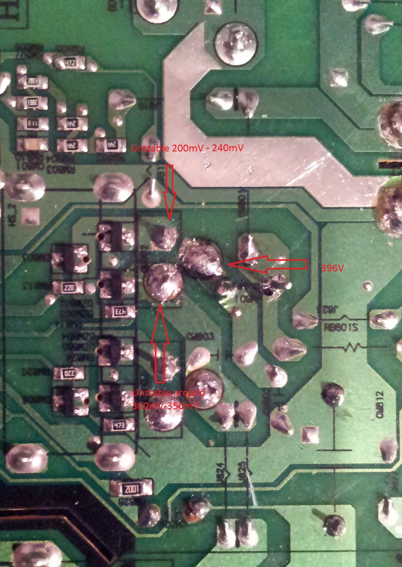

    No. The problem is likely in the Zener's and possibly QT851. Lift that 24v jumper and see if 24v comes back.
    <<Oh yes RT852 shows 168R>> ??
    What does that mean? Its marking or the value you read with a meter?

      I checked voltage on this large blue cap. Should it fluctuate from 300V to 330V-ish? Up and down all the time.
      Same unstable voltage on QM802 as per pic attached.

          I lifted the jumper. Still cant see 24V.

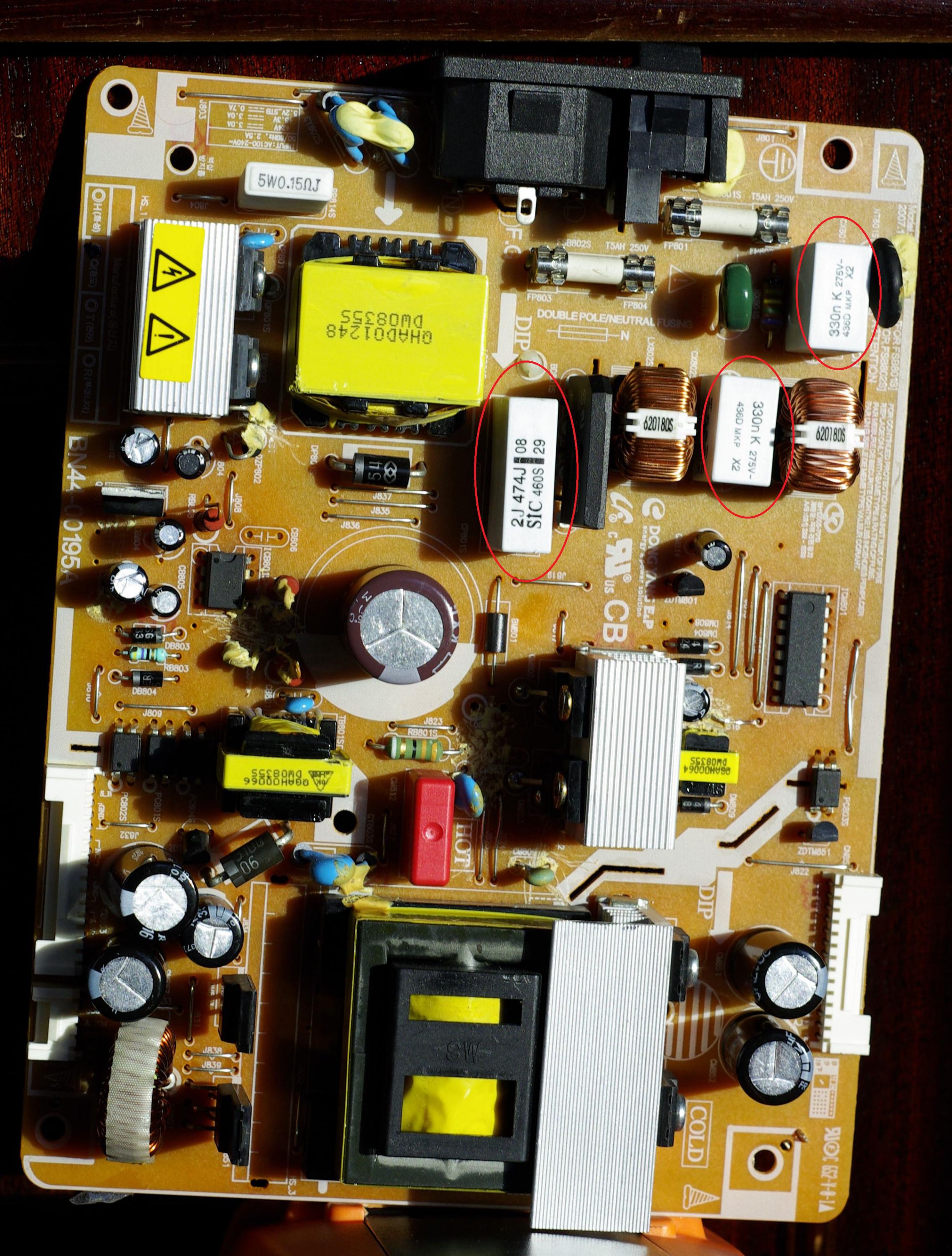

                Could you have a bad mains cap?

                  I checked CX801S, CX802S and CP802S (circled). I only have multimeter with capacitance test. I read CX801S - 312nf, CX802S - 315nF and CP802S - 480nF. That look fine to me.
