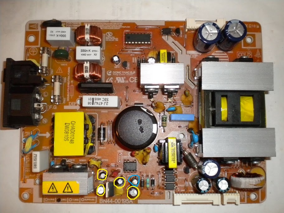

245BW, can't find problem. No 24 or 6.3V, standby is good.
    Power light comes on but I'm getting nothing on the 24v or 6.3v outputs from the power supply.
    The only lead I have is the large cap "CP801" which says "450WV 82Uf" on it but only gives out 173V's. Someone told me this is normal but I'm not sure if I should trust them.
    Model # on the board is: BN44-00195A

        All the regular cap's have been replaced, I checked all the resistors for continuity, fuses are good.

          In the future, please attach the photos using 'Manage Attachments' - below the text entry area. If additional pictures become necessary, it is best if they are as close to 2000 x 2000 pixels as possible (without going over). Here's why:
          1. On the top view I see a cap that looks suspiciously like it is bulging. I think I can see the identifier, but can't read it. The best I can do is say it is directly above the 'A' in BN44-0195A.
          2. Above that cap is an 8 pin IC. Again, while I can see the identifier, but can't read it. That is the SMPS controller. What is the part number?
          3. To the right of the board number are a pair of connectors. I can see labels indicating the function of the pins, but again, they are unreadable. One of the pins may be labeled 5V Stby, or something like that. What is the voltage on that pin?

            Well if I had a better camera maybe...
            1: Cap is just fine, and it's new.
            2:
            A6159
            SK812
            419K
            3: Mistake in the thread title, 6.3V should be 5.4V. There is nothing coming out of it.
            (I don't see a attack image option when posting?)

                  You can do what you have done, it just means the information transfer is a bit slower. The sketch gives me the information I needed, your note adds more, and the IC is an Allegro MicroSystems STR-A6159. It's an combination SMPS controller and power FET in one package. The datasheet of that IC is here.
                  From the datasheet, pin 3 is Ground, pin 2 is Vcc. With power on, CAREFULLY measure the voltage from pin 3 to pins 1, 2, 4, and 5. Do NOT measure the voltage on pins 7 or 8; if the IC is working it could destroy your DMM.
                  Oops, almost forgot. In the picture, the pins are numbered counterclockwise, starting at the lower left.

                    Oh well this sounds dangerous... SIGN ME UP!
                    1:0.01
                    2:11.6
                    4:0.01
                    5:153.2

                      Pin 2 is the key. The SMPS controller won't start until it reaches 17.5 volts. On similar ICs, the solution has been to replace the SMPS controller. You might wish to first check the capacitor connected to pin 2.

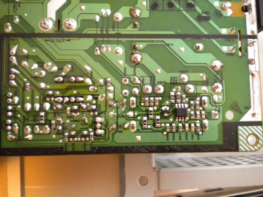

                          The picture of the bottom wasn't good enough to allow me to positively identify the startup cap. The cap circled in blue is the primary suspect. The ones circled in yellow are also possibilities.

                            If you replaced all the caps in that area as you said, what brand and series did you use?
                            i.e.- Radio Shack caps are not acceptable.
                            Trace the power supply circuit to that chips input (Pin 2) as PlainBill noted.
                            A closer, better lit picture of the back of the board (mind the glare) of the upper left which is the area of interest. Essentially (from your current photo) above the horizontal black line and the left of the vertical black line/slots.

                              Sorry I didn't want to upload it here because I would have to make it smaller. Ignore what looks like a really bad solder job I fixed it and it looks a lot better in person. I wasn't the one that replaced the caps.
                                Re: 245BW, can't find problem. No 24 or 6.3V, standby is good.
                                It would have been fine. Edit your post, pick "Go Advanced" and choose "Upload Attachment" and use the "Upload from URL" of the picture from Google. Quick!

                                      That cap circled in blue, it MIGHT be bad? I can't get more then 0.07V's from it. It also has some clear goo on the top that I thought was just hot glue but maybe I am wrong?
                                      EDIT: You know what, I'm an idiot. The more I think about it I realize that can't be hot glue. I will go down to radio shack tomorrow and see if they have anything.
                                      I can go higher in the uf rating right?
