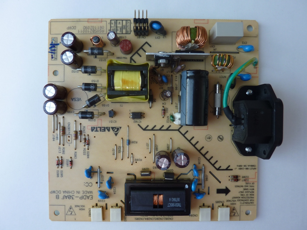

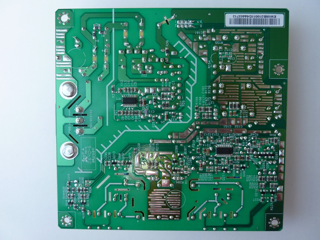

    I have a Dell E177FPv that does nothing when powered and plugged into a working computer. The on/off button does nothing when pressed and shows no lights.
    The two fuses (F1 and F151) on the board have been checked and show continuity.
    The voltage across the main capacitor reads 164.8 - 165.1 VDC.
    The 8 pins going to the video display board read:
    pin 1 (labeled +5.1V/1.6A) - 5.19 VDC
    pin 2 (labeled +5.1V/1.6A) - 5.20 VDC
    pin 3 (labeled GND) - 0 VDC
    pin 4 (labeled GND) - 0 VDC
    pin 5 (labeled NC) - 0 VDC
    pin 6 (labeled BRIG -A) - 4.98 VDC
    pin 7 (labeled BRIG -P) - 3.53 VDC
    pin 8 (labeled ON/OFF) - 0 VDC
    Q205 and Q208 were tested in circuit and are not shorted.
    Q1 was tested in circuit and is not shorted.
    I have replacements for the 8 capacitors on the power board, but have not replaced them as of yet. I was trying to determine the cause of getting nothing from the monitor when the power button was pushed. Any help would be greatly appreciated.

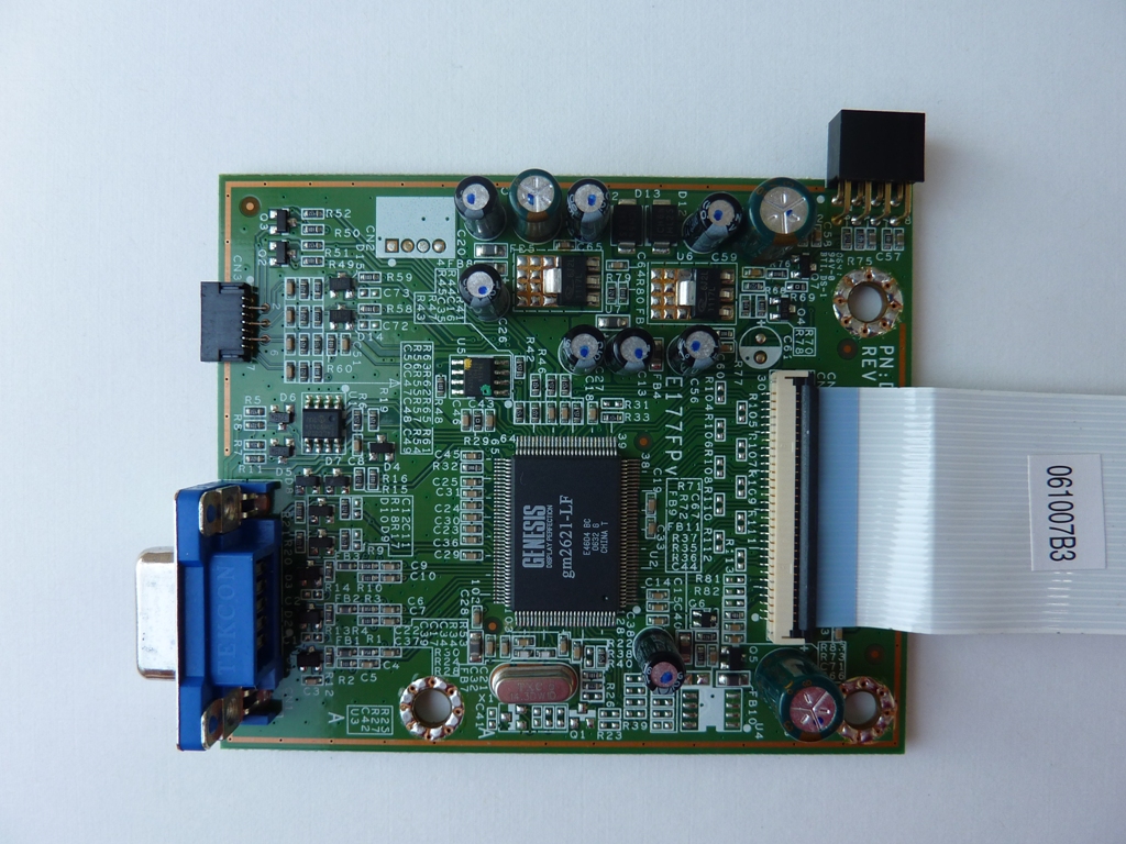

                    Sorry it took a little while, I went ahead and re-capped the power board.
                    Part No. 6J2L 1117L
                    Measurement taken with the power board and video board connected together out of the case (they are upside down and in-accessible installed). Power hooked up but no video.
                    U6:
                    top pin - 5.17 VDC constant
                    middle pin - 3.34 VDC constant
                    bottom pin - 2.09 VDC constant
                    to the left:
                    top pin - 1.19 - 1.24 VDC moving
                    middle pin - 0.38 - 0.45 VDC moving
                    bottom pin - 0.12 - 0.14 VDC moving

                      Looks like the voltage regulators are adjustable.
                      The input voltage on the left regulator really looks low.
                      Can you check to see if a filter cap is in the circuit to pin 1 of the left regulator?
                      If there is a cap involved, you should check to see if it's shorted.

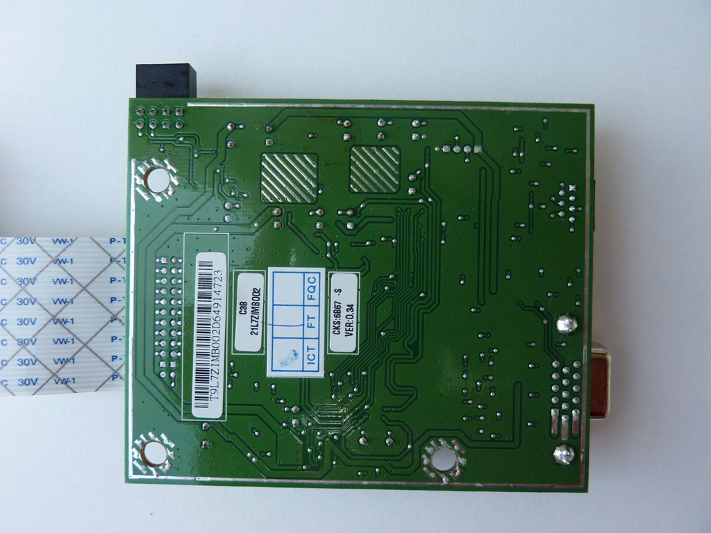

                          I took the monitor completely apart and checked the 2 fuses, voltage across the main cap, voltage on the 8 pins to the video board, checked for shorts on Q205, Q208, and Q1, voltage on the 7 wires on the ribbon to the control board, and the voltage at the 2 regulators. Everything reads the same as before and there is NO sign of life to this monitor. I'm not sure why it worked for a little while after I reassembled it after I re-capped the power board.
                          alexanna - I cannot follow the circuit to pin 1 of the left voltage regulator, there are no traces on the top or the bottom of the board, I would guess they are between the layers and not on either surface. I'm not sure if I can find a schematic of the board or not.

                                  The left regulator is U7. Is there any more text on the label? In that orientation, the top pin is input, the middle pin is output, the bottom pin ground (or adjusted). Does "moving" mean moving up and down?
                                  Guessing that's a 1.8V regulator, which should be getting 3.3V input from U6. The regulator itself might be bad. Sometimes ceramic caps short; C64 and C65 are worth checking. Testing or just replacing the electrolytics on that board is another option.

                                    The only point on the back of the board that I can find 1.19 VDC is at the positive side lead of C62. It's a little more difficult to take readings on the front of the board with it plugged in.
                                    Going left to right, top to bottom on the picture of the video board (some of the caps have multiple designations near them):
                                    C20 0.41 - 0.44 VDC
                                    C63 0.42 - 0.45 VDC
                                    C62 1.22 - 1.25 VDC
                                    C55 5.17 VDC
                                    C54 5.17 VDC
                                    C26 0.43 - 0.46 VDC
                                    C27 3.34 VDC
                                    C13 3.34 VDC
                                    C56 3.34 VDC
                                    C38 3.34 VDC
                                    C68 0.00 VDC
