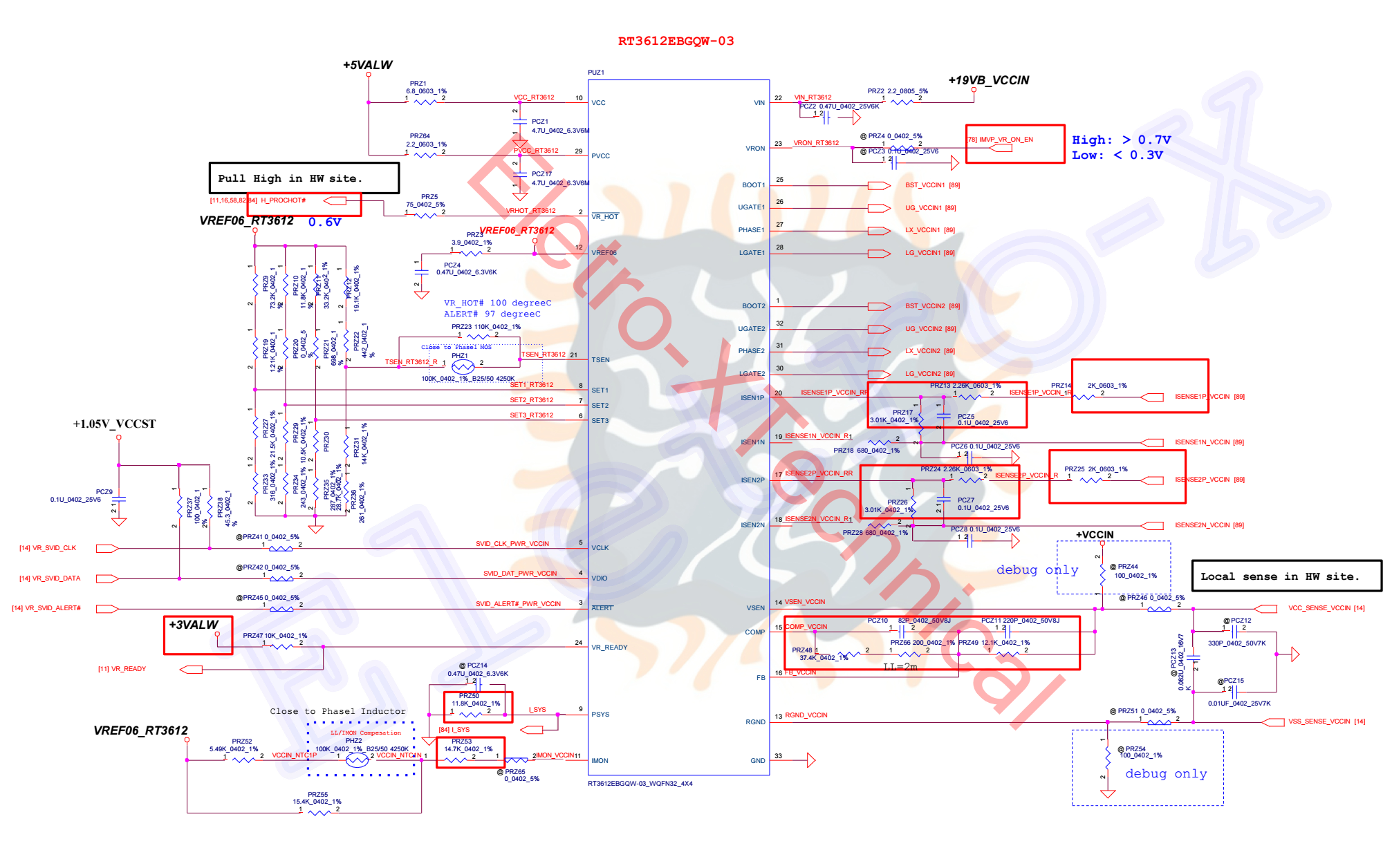

      At the moment I have gotten to this DC-DC controller - RT3612EBGQW-03.
      Click image for larger version  Name:	+3valw.png Views:	0 Size:	826.9 KB ID:	3558121
      I have measured that +5VALW, +19VB_VCCIN, +1.05V_VCCST are present. The +3VALW is missing.
      As I understand, this DC-DC converter is for powering CPU, correct? And if +3VALW is missing then CPU gets no power.
      On other parts of the board +3VALW is present. But it is hard to trace where the chain is broken going to this controller.

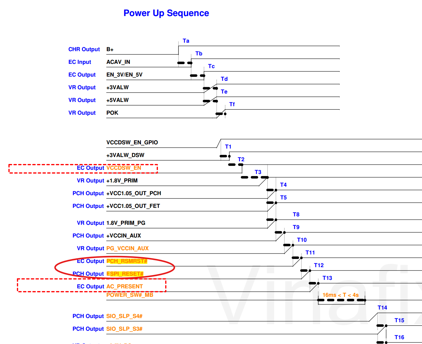

        Just went through schematics power diagram measuring voltages and power up sequence and it seems, that all stops at SPI chip.
        Could it be that the BIOS chips are bad? But I am still able to read them.

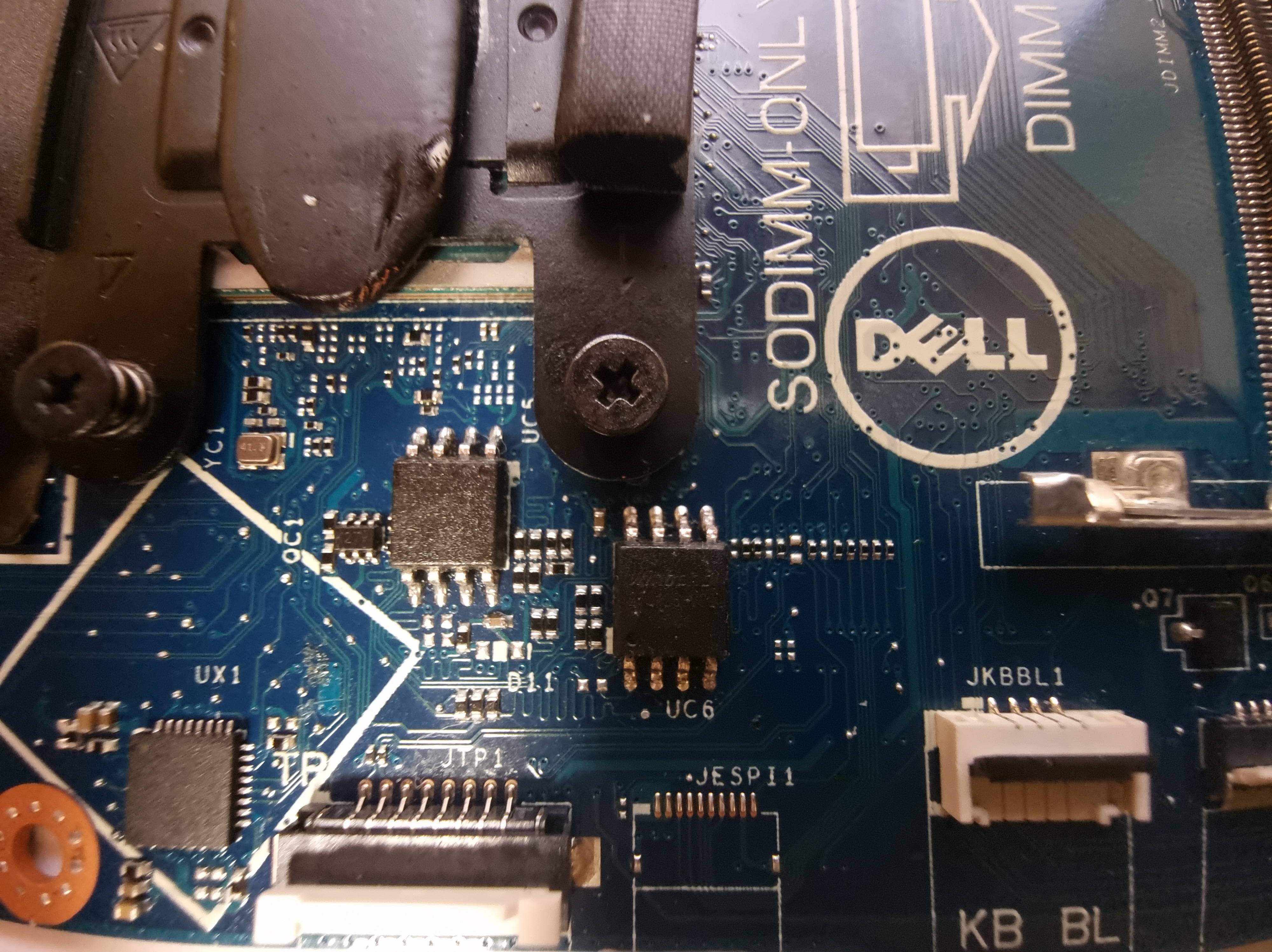

              What is the voltage on bios chip pin 8 ?
              Please post pics of the bios chips region also.

                  Voltage on PIN 8 of both chips are 3.408V
                  Here is picture of the area of BIOS chips.

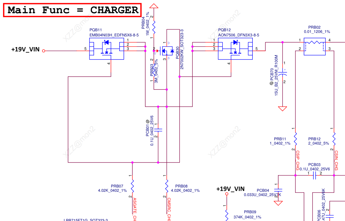

                            Attach the power adapter that is recommended for this logic board.
                            Measure the voltage to ground on each group of pins of mosfet PQB11.
                            Measure:
                            source (1-2-3) ; pick any one of these
                            gate (4)
                            drain (5-6-7-8)
                            Post each measurement. If the adapter is functional, you should have ~19v on the drain pins. To allow for the voltage to pass onto the main power rail, the gate voltage should be ~25 volts to enable this N-channel mosfet. Then the same voltage should pass onto the source (1-2-3) pins.

                              I got these measurements:
                              1-2-3 - 19.83V
                              4 - 24.51V
                              5-6-7-8 - 19.83V

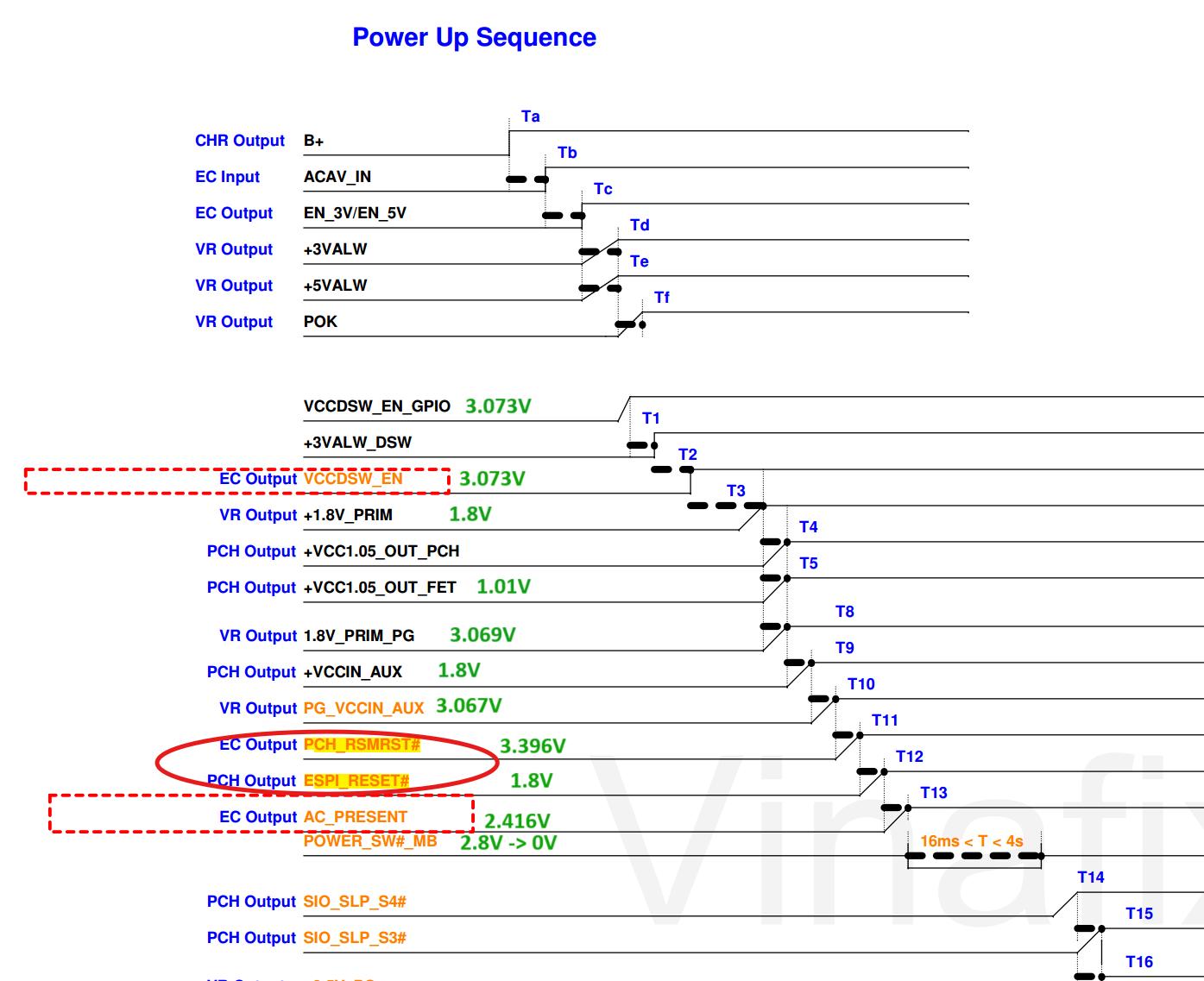

                                I did some more measurements on the startup sequence:
                                It seems that everything stops at SIO_SLP_S4# where PCH sends enable signal for 2.5V. When I press power button, my multimeter does not register anything.
                                Where should I look now?
