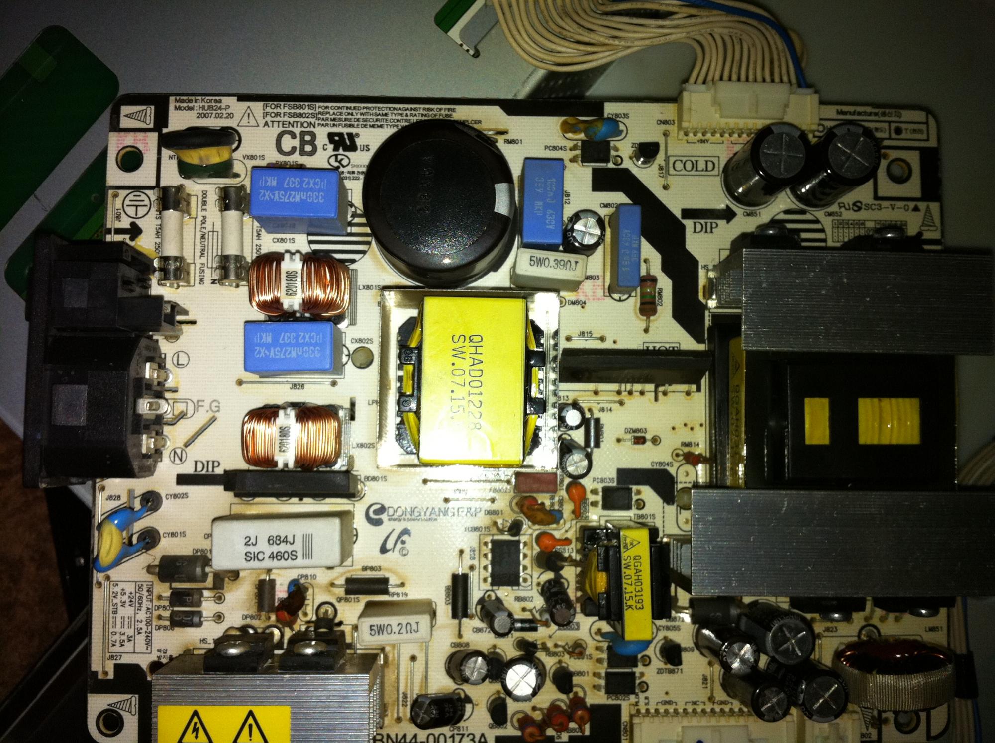

    Hi all
    i've read this post https://www.badcaps.net/forum/showth...?t=9343&page=1
    I have the same problem like this user - stewart710
    (The monitor powers on, the blue power led comes on, but there is no image displayed. I tried this with a DVI cable and VGA cable hooked up to my computer, no dice. The only thing I did notice is that my computer can detect the monitor and knows what resolutions it supports. Also after the computer goes to standby the blue Led on the monitor starts blinking. It comes back on when I wake the computer. This suggests that the lcd motherboard is functioning properly.)
    I opened the case and cant see a faulty cap. Do you think it can be the resistor RB805, RB806 and RB807 which are burned? Many users write about the same problem like my one and solved it by changing this three resistors.
    I dont have good knowledge at electrical components but i think to can repair it myself
    Of course i can upload some pictures after work so u can take a look on the boards.

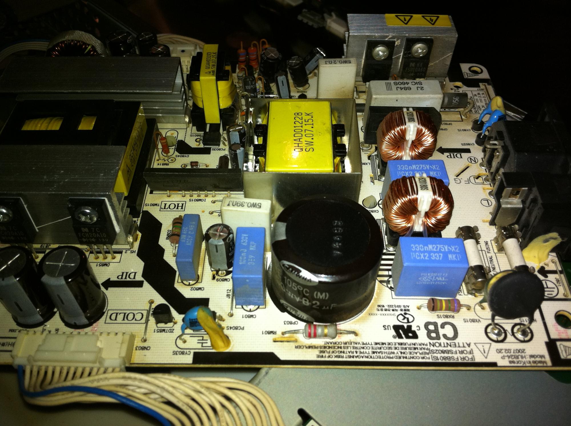

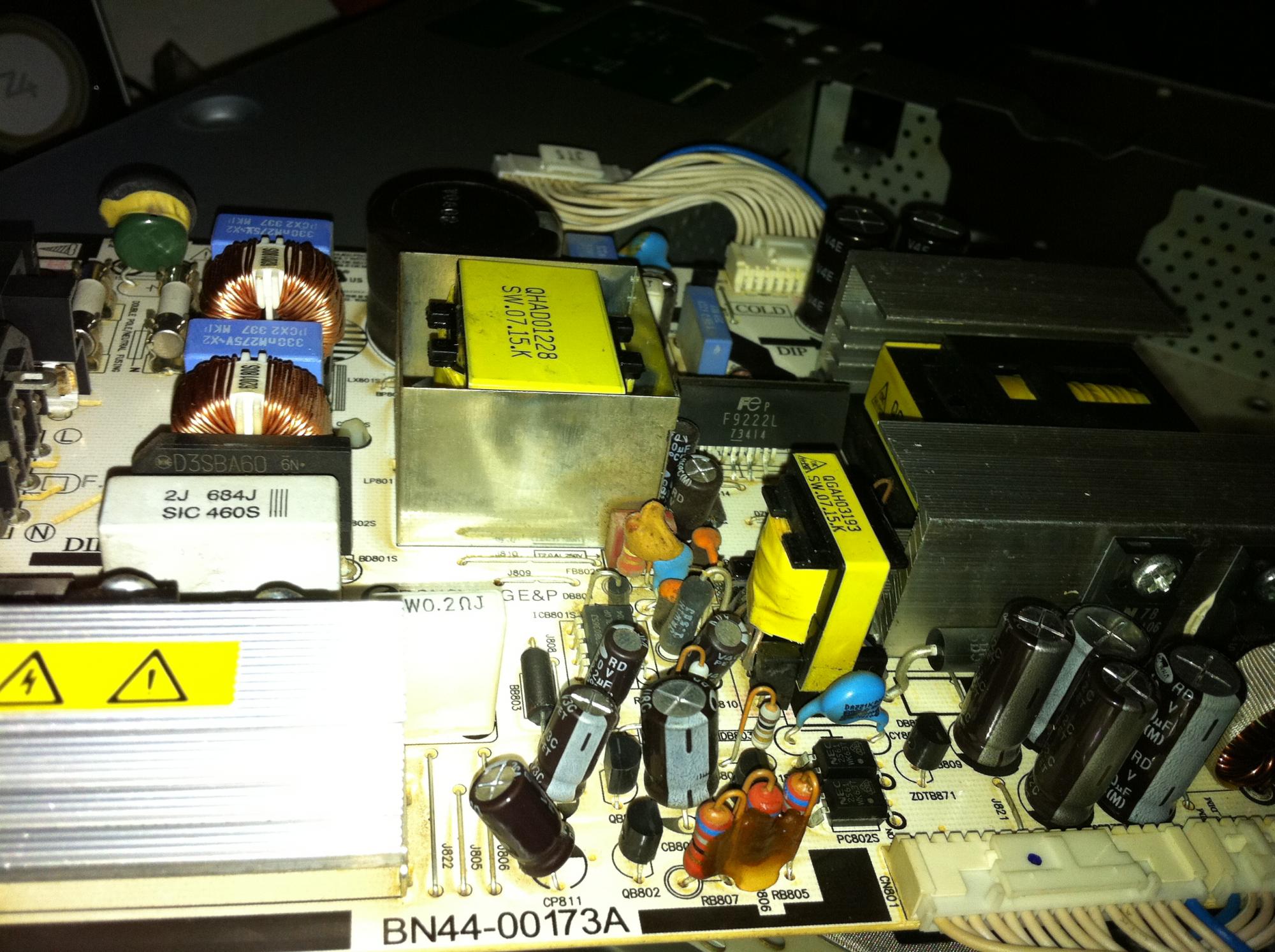

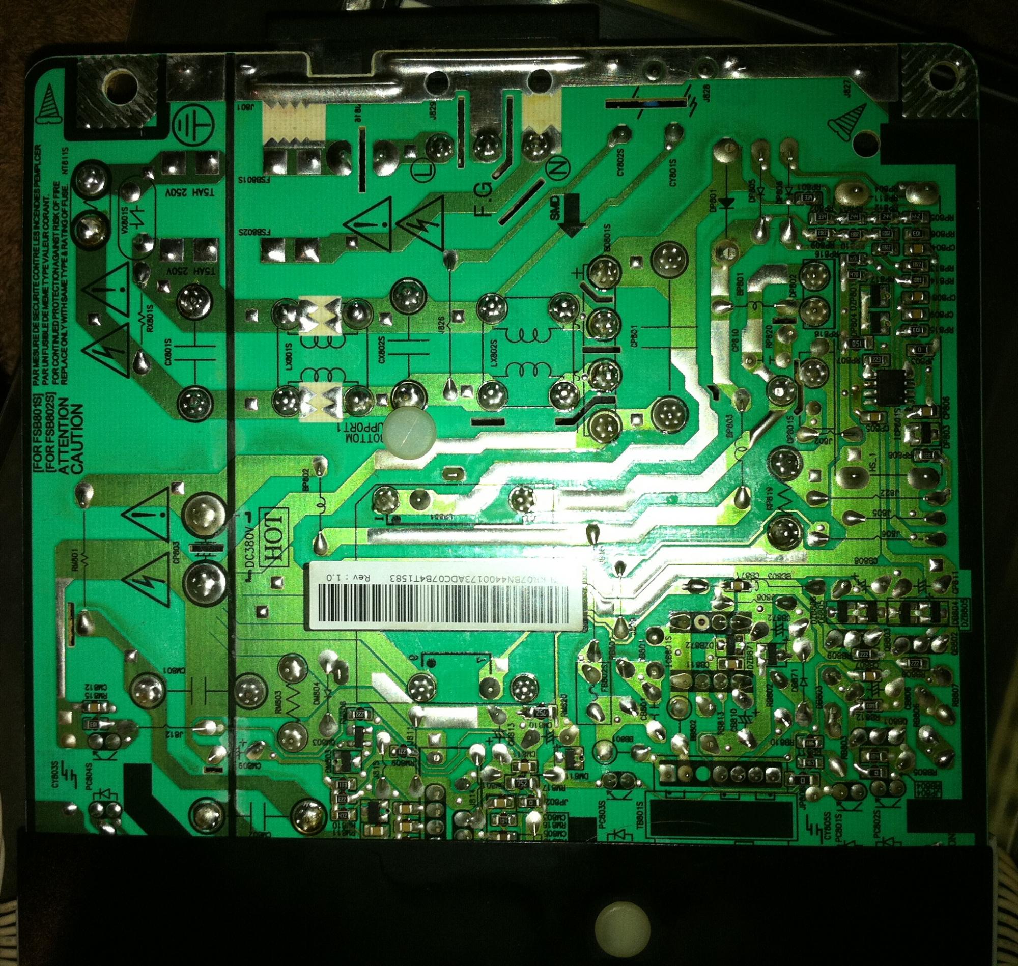

          Re: Samsung Syncmaster 245B Black screen and blue Power LED
          Here are the pics.
            Measure the resistane of the resistors and change as required....then should that not fix it, there are lots of other options.
              It was those resistors for me. Replace them with 3W versions just because it's open now.

                I found this thread searching by google.
                It looked like the same issue and beasureing the three resistors showedthat one of them were burned.
                I bought three new 5W 68 OHM resistors as 3W was not available (I think that the original were 1W) for 4 euro. and replaced all three now the monitor was opened any way.
                The monitor is now working perfect!
                THANK YOU to everybody for both the pictures and advices

                              At this point I have two options. I can go dig up pictures of the two different supplies used in your monitor, I can ask you to provide on, or I can give you a general answer. I chose the last.
                              Check the voltage at the PC_ON pin. It should be about 3.3 volts. Check the voltage across the large cap. Is it about 1.4 times the AC voltage in your home, or is it about 385 volts?
                              For further assistance at least give the model number of the power supply (starts with BN44-).
