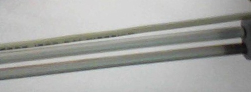

    Hi
    I have a IBM Thinkvision L170P second hand that works fine (no red tint, and good brightness and even light side to side). I've done a general revision of it (caps, dust, connections) to see if they are in good shape and they are.
    However I took out the CCFL lamps of the upper side only (there are 4 lamps in total, 2 in upper side and the other 2 in bottom side).
    The right side of both them is darkened while the other one is totally "new".
    Does this mean that lamps are too used and they could die "soon"? Does an old lamp both dark its ends? I have another 4 lamps from another monitor (15 inch) that have the same sign and also worked fine (the video circuitry of that monitor just died)
    Many thanks.

    It's normal for CCFL lamps to have some sort of darkness at the ends. It's no different than a regular flourescent lamp you have in the house. If it's a pale light grey colour I wouldn't worry about it. If it's really really black then time to replace it.

      Hi, many thanks for you reply:
      Yes, the color is a sort of dark gray with irregularities, at least compared with the "new" end of the lamp
      Here's the photo (sorry for the quality it's taken from webcam, appears more darker than it really is) The upper lamp is showing the clearer end, while the bottom one is showing the darkened one

        It's alright. You will be able to use the lamps for a couple more years.

                The blackened ends of the tube is the emmissive substance sputtering off the electrodes each time the lamp is started.
                This is also a normal occurrence on ordinary hot cathode fluorescent lamps.
                Nothing to worry about.
