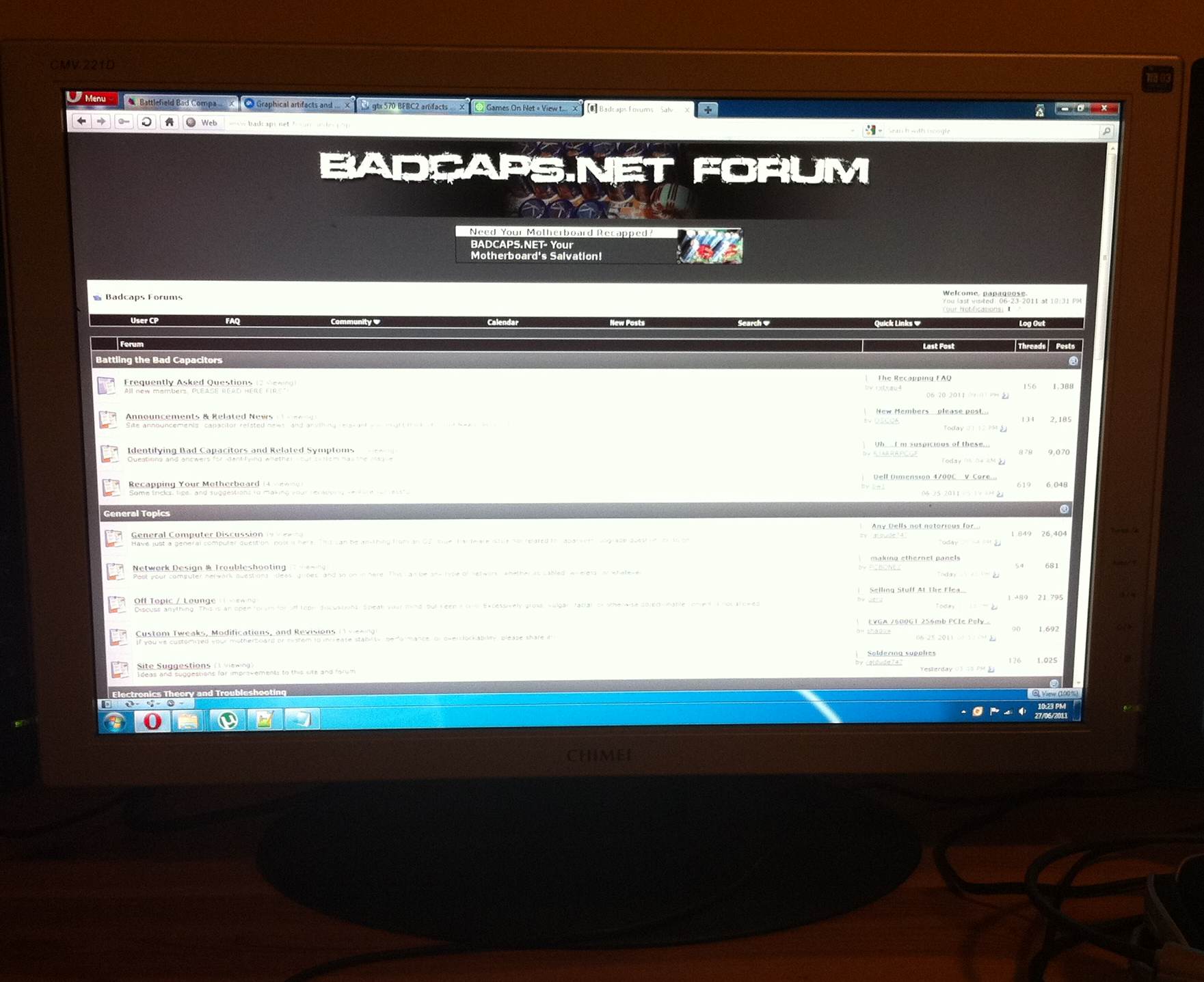

                    Thanks UniT3d, I've put in an order for the diode and for the insulation kit, hopefully it'll arrive this week so shall see soon if it works! (4-5 days shipping time unfortunately)
                      #70
                      Re: DAC-19M009 dead?
                      Well everyone, the diode arrived, I fitted it with the insulation kit, and everything seems to work fine! Been using the monitor for a couple of hours now Hopefully all the components were correct and nothing else gets damaged
                      Thank you to everyone who helped out, especially retiredcaps for the exhaustive initial tests to narrow down the fault, and to PlainBill for somehow incredibly tracking it down to that one diode! You guys are legends
