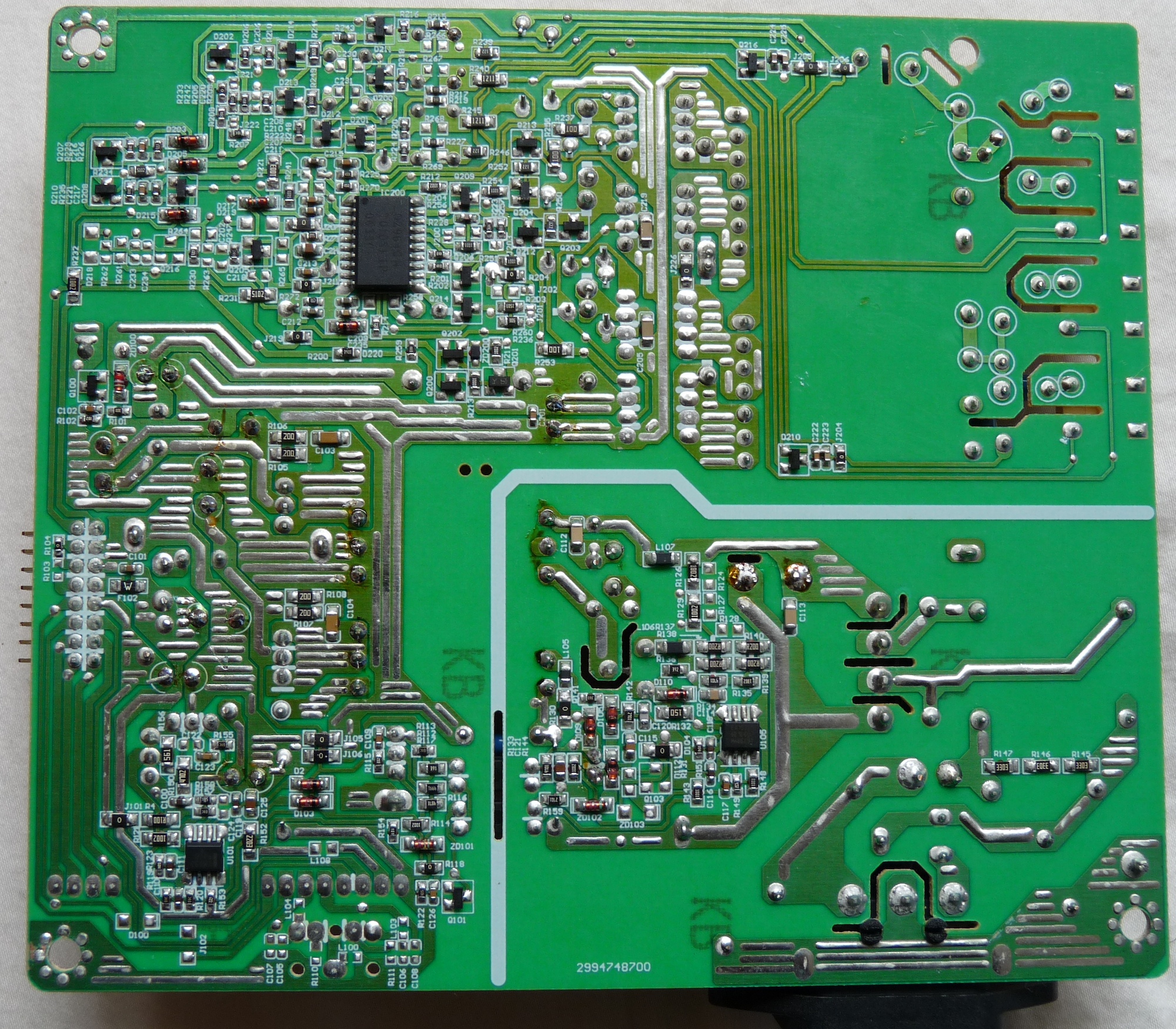

    When I turn it on, the voltage is about 340V, it does jitter a little for the first couple of seconds but I think that is just lag on my multimeter (it doesn't drop to zero instantly when I remove the probes). The voltage sits at 340 the whole time (I'm in Australia)

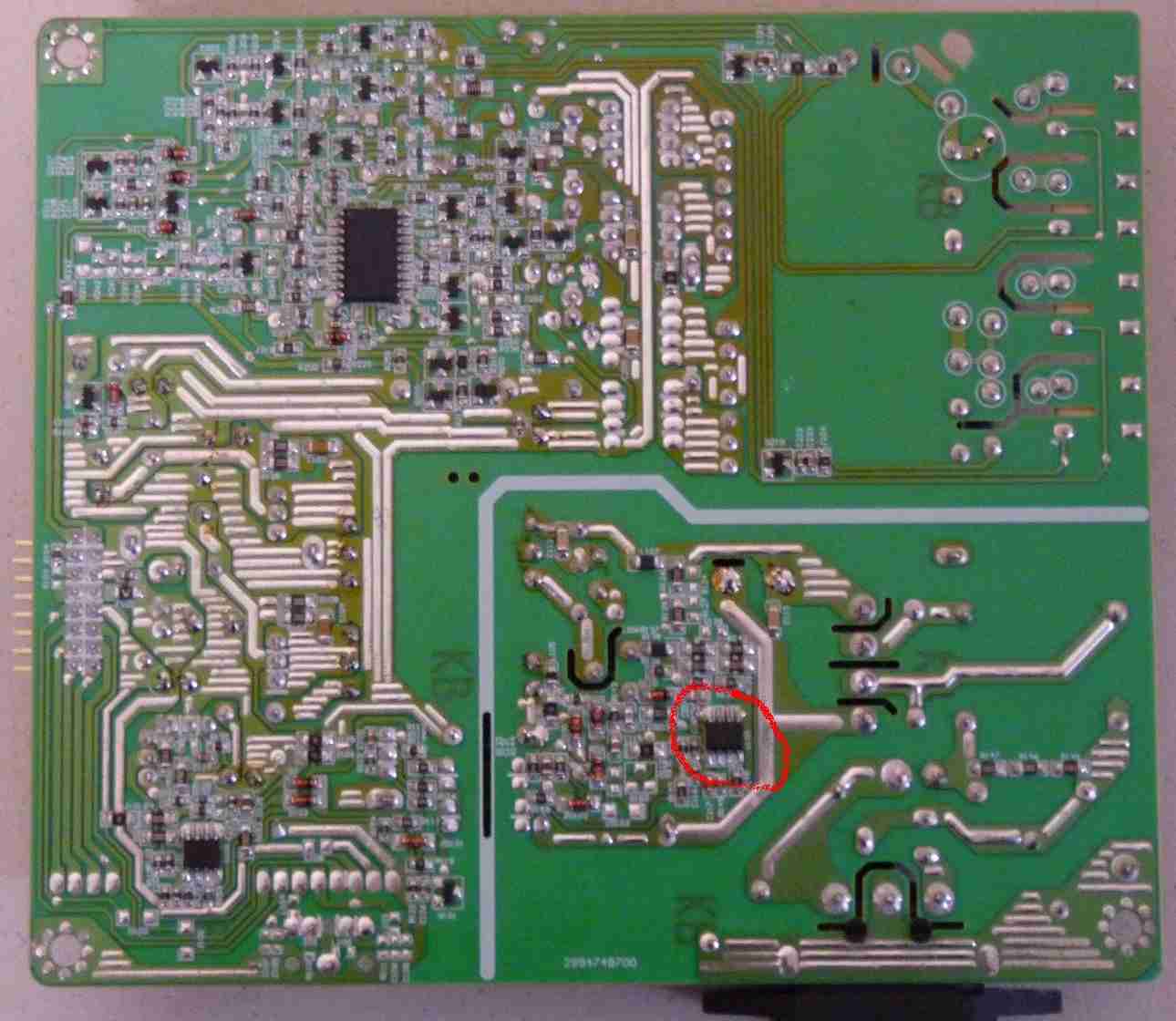

      What is part number red circled component (on the backside)?

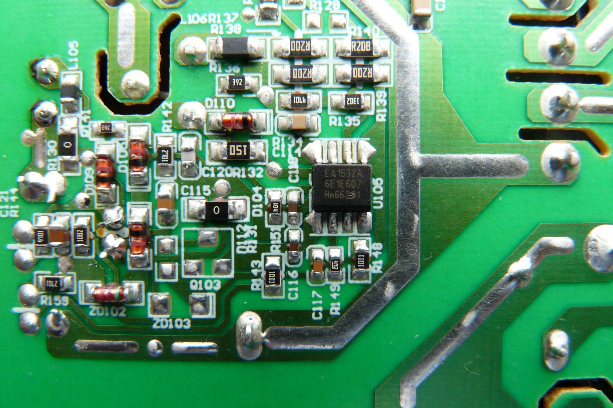

        It has written on it:
        EA1532A
        6E1E607
        Hn66291
        I'm going to take some better photos of the board, should post them soon

          Originally posted by papagoose View Post
          EA1532A
          1) This SMPS chip has been bad in other lcd cases posted here. Since all the caps have been replaced including the startup cap, this chip could be bad. That is my best guess at what is causing the voltage to drop.
          2) Digikey sells a replacement for $1.14 at (which I believe is the correct part)
          http://search.digikey.com/scripts/Dk...=568-3316-1-ND
          3) PlainBill is the real expert on concluding if this chip is bad or not by taking voltage measurements at the various pins.
          edit: He gives a good explanation at
          https://www.badcaps.net/forum/showpo...7&postcount=20
          4) If you have not done smd soldering, see
          http://www.youtube.com/watch?v=3NN7UGWYmBY
          Last edited by retiredcaps; 06-11-2011, 11:12 PM. Reason: added url foe PlainBill's explanation

                      The quick and easy test on the TEA1532 is to measure the voltage from pin 1 (Vcc) to pin 2 (Gnd) (DON'T use chassis ground). If the voltage is steady below 8 volts the chip is bad. If it's pulsing, the startup cap is bad, an output diode is shorted, or you have an excessive load on an output of the power supply. If it's in the 12-20 volt range the chip seems to be working properly.
                      This IC has the rectified mains voltage applied to pin 8, and is prone to failure.

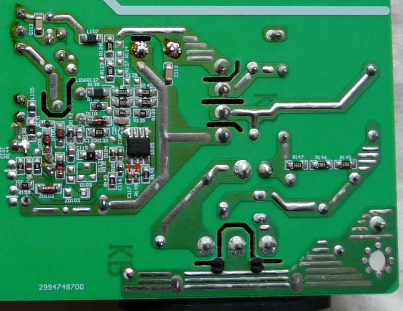

                            I checked the datasheet but I wasn't sure how to determine the orientation of the chip. I've marked which pins I measured as 1 and 2
                              Not much help because the picture is too small to see the orientation of the chip clearly. I THINK those are the correct pins, but I can't be sure. One end of the IC may have a notch in it. With that end to the left, the left-most pin on the bottom row is pin 1, as you indicated. Sometimes pin 1 is indicated by a circle.
                                PlainBill
                                Sorry, I've uploaded a better one. This is the same orientation as the previous photo (i.e. the two pins on the bottom left are the ones I measured)
                                  #36
                                  Re: DAC-19M009 dead?
                                  I think it is correct because you can see the "white chalk outline" having a little bit of an indent.
                                  I wonder if a diode around that area is shorted? In figure 4 of the datasheet, that would be the diode feeding into Vcc (next to the secondary winding).
                                    OK so in the previous photo, the visible diodes are the reddish cylinders D110, D109, D106 and something without a number? I've tested them, apart from D110 the multimeter gives about 600 (mV?) in one direction, and off scale on the other. D110 gives about 10 in both directions. So it seems to be shorted?
                                        Dang, that is one seriously good picture!!! It is clear enough I can follow the traces back to the rectifier. This IC uses a third form of identification for pin 1, it looks like the entire edge is chamfered. And you definitely measured pins 1 and 2.
