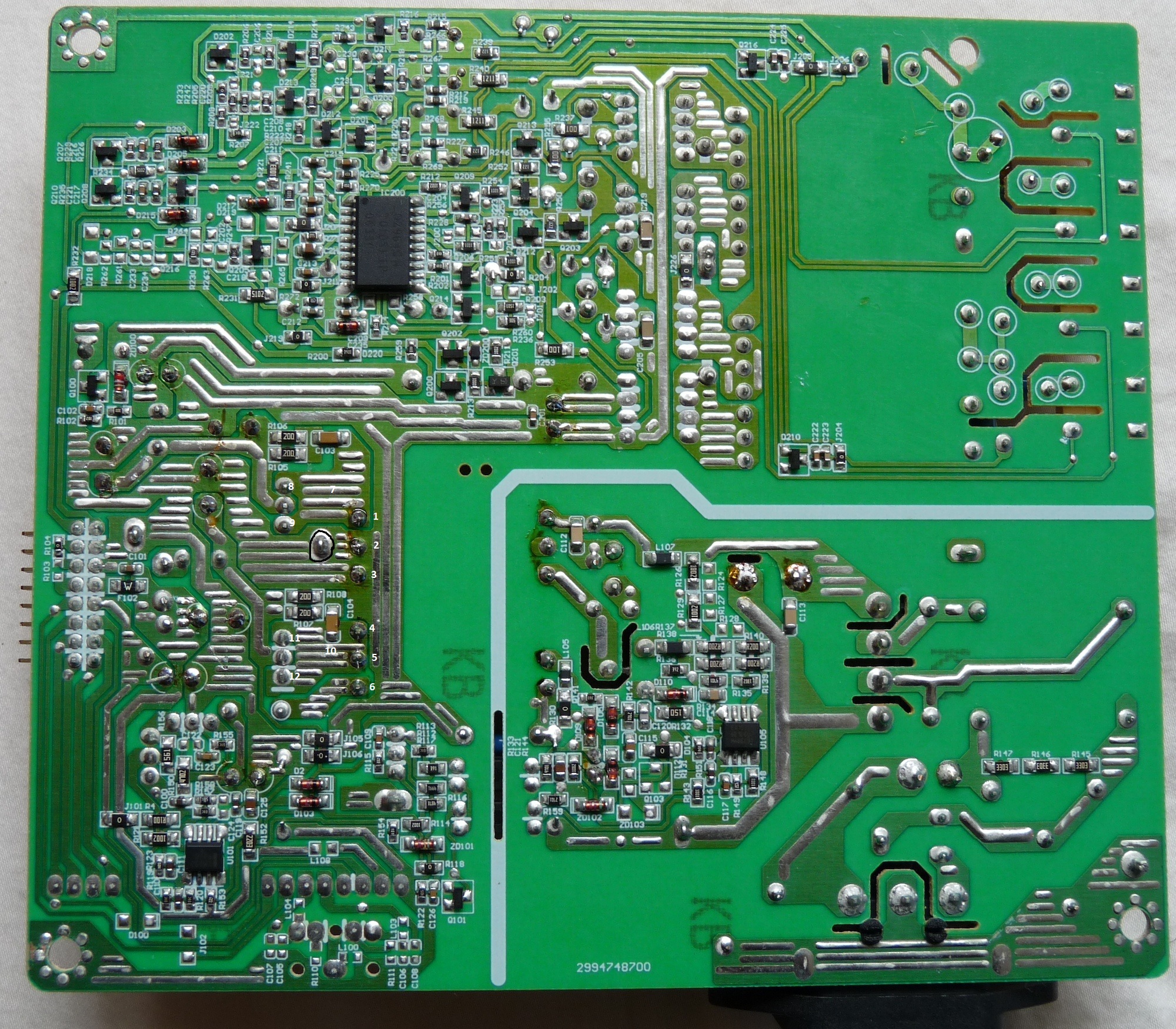

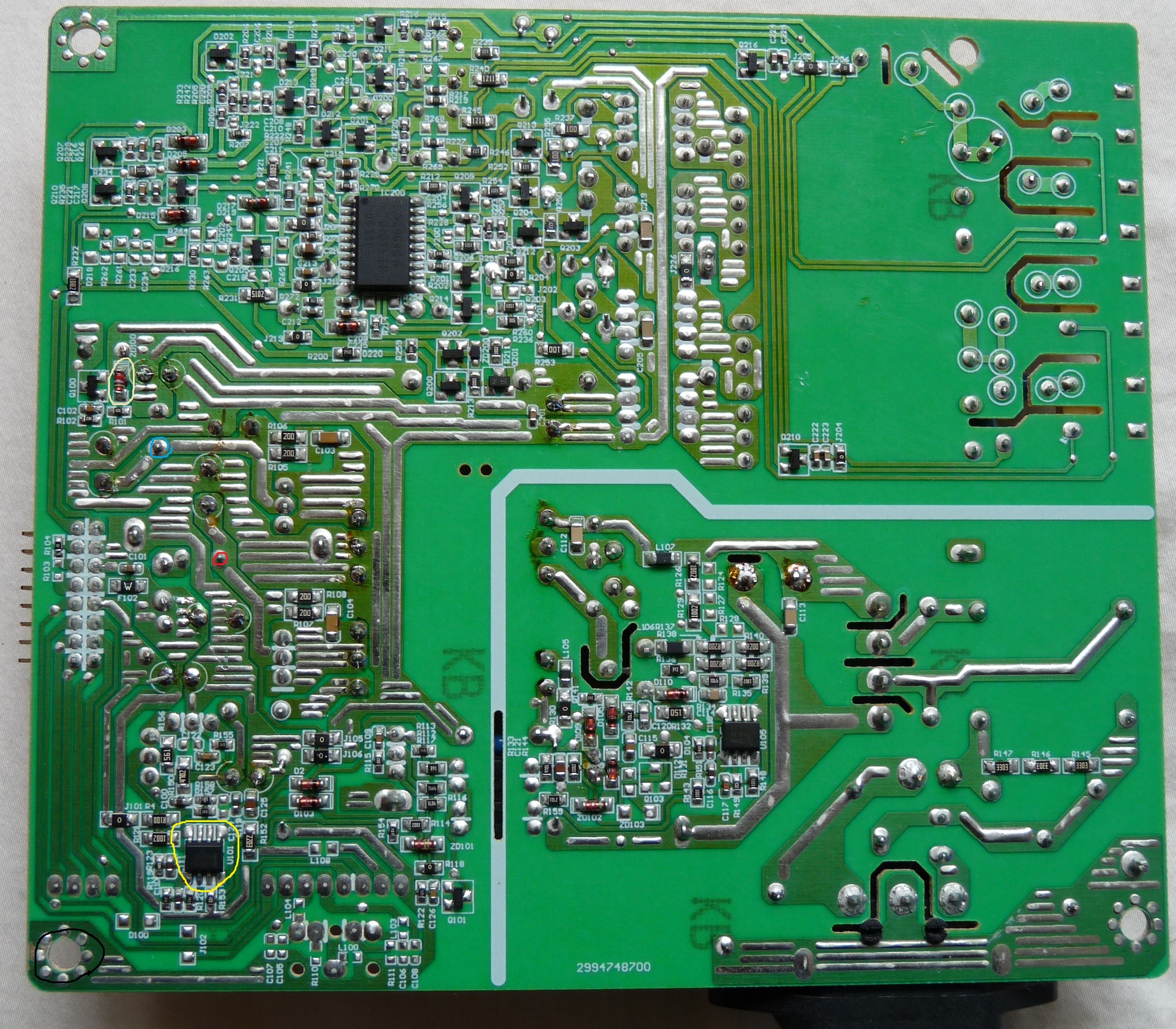

            OK, but remember, you asked!!!
            I've uploaded a picture after marking up a few points of interest.
            1. Black circle in lower left corner - use this as the ground point.
            Initial steps are with power off
            2. Yellow circle near lower left corner - what is the part number of that IC? I don't think it's the cause of the problem, I just want to know what it is.
            3. Diode circled in beige. Check it for shorts - you can do this in circuit.
            The next steps are done with the signal (logic) board unplugged from the power supply, and the power supply connected to the AC mains.
            4. Red circle. What is the voltage?
            5. Blue circle. What is the voltage?
            Disconnect the power supply from the AC mains, wait at least 10 minutes, then plug the power supply into the signal board. The signal board can be disconnected from the LCD panel and the front panel. Now connect the power supply to the AC mains.
            6. Red circle. What is the voltage?
            7. Blue circle. What is the voltage?
            There is something odd going on. Usually we see only one photo-coupler. This supply has two.
            PlainBill
              #46
              Re: DAC-19M009 dead?
              LM393
              With the black probe on the top (same orientation as in the image) the multimeter reads 800. In the other direction, it reads about 2000
              Red = 5V
              Blue = 0V
              The same as before, Red=5V Blue = 0V
                #47
                Originally posted by papagoose View Post
                LM393
                Red = 5V
                Blue = 0V

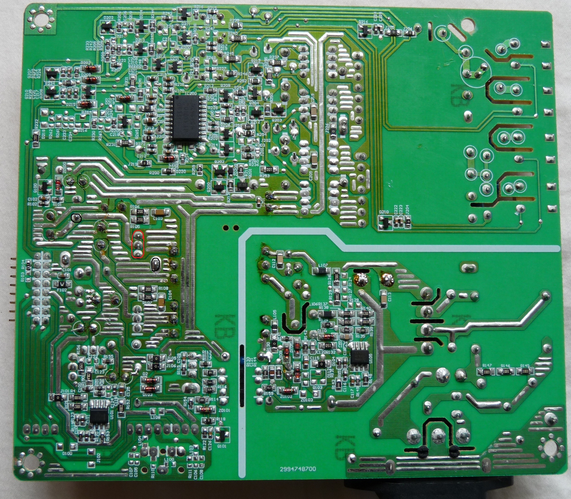

                Well!! We are making some kind of progress.
                Once again, I'm resorting to Paint. The only good part of Paint is no clean-up is required.
                Your mission, should you decide to accept it, is to perform some rudimentary tests on the transformer. Do this with power off, please.
                Note that I have circled one point in black, and numbered the pins of the transformer from 1-6. With the DMM set to the 200 ohm range, measure the resistance between the point circled in black and each of the numbered pins. Try to measure to the tip of the pin, not to the surrounding solder or the trace itself. Then repeat this, but measuring to the traces, not the tip of the pin.
                I would expect all resistances to be under 1 ohm.
                PlainBill
                  #48
                  I've measured it carefully touching the tips of the pins, all of them read <1 ohm. I'm not sure what to measure for the traces- are these the metal strips nearby?
                  The photo makes it painfully clear where I've slightly burned the board resoldering it! :p (other posts mentioned resoldering the transformer, I tried that before I started this thread)
                    #49
                    Oh, petals!! Well, ours is not to do or die, ours is but to reason why. The good news is that indicates the transformer is good.
                    The traces are the metal strips leading from the posts to the leads for the diodes. Lead free solder is notorious for producing joints that look good, but are faulty. So let's do the second part of the assignment. Measure the resistance from the spot circled in black to point 7 (the solder), and to points 8 and 9 (the tips of the pins.
                    Next step. Set your DMM to the 20 VAC range. Yes, I want you to try to measure AC!! With the monitor connected to AC power, measure the voltage from the point circled in black to point 7 and also to point 10. If either reads out of range, step up to the 200 VAC range.
                    PlainBill
                      #50
                      This may be a silly question, but I can't see 7-10 in the previous photo? Should I be looking near the transformer as before? Or is there a missing attachment?
                        #51
                        Oops!!! I used invisible paint!!

                          I've measured all the resistances, they are less than 1 ohm. My multimeter only has 750V and 250V in AC mode. When I measure the voltages from the black circle to 7 and 10, they are both essentially zero (it flucuated around 0.02 and -0.02). This is with the logic board disconnected. I checked the pins that go to the logic board, and they were showing the usual 5V etc.

                                #55
                                The resistance is < 1 ohm
                                The diode test read 0
                                And this read 0 as well!
                                Charming. Refer to the attached picture. If you would, remove the diode circled in red. Then measure the resistance between the two points circled in black. Also test the diode by setting the meter in diode test range and checking from the center lead to each side lead. Then reverse the DMM leads and test again.
                                PlainBill
                                  #56
                                  Haha it would have to be one of the diodes that is screwed into one of the metal dividers on the other side of the board! Just waiting for the soldering iron to heat up now...
                                    #57
                                    PlainBill
                                    OK now I am excited! With the diode out, the resistance between the two circled points is off scale (they don't seem to be connected).
                                    Am I correct in thinking this diode is actually 2 diodes put together? If I understand the drawing on the front correctly, they are connected in opposite directions. One of them reads 350 one way and off scale the other. The other reads 0 in both directions
                                      #58
                                      If it looks like this
                                      http://en.wikipedia.org/wiki/File:Schottky.jpg
                                      then the 0 reading suggests it is a bad component.
