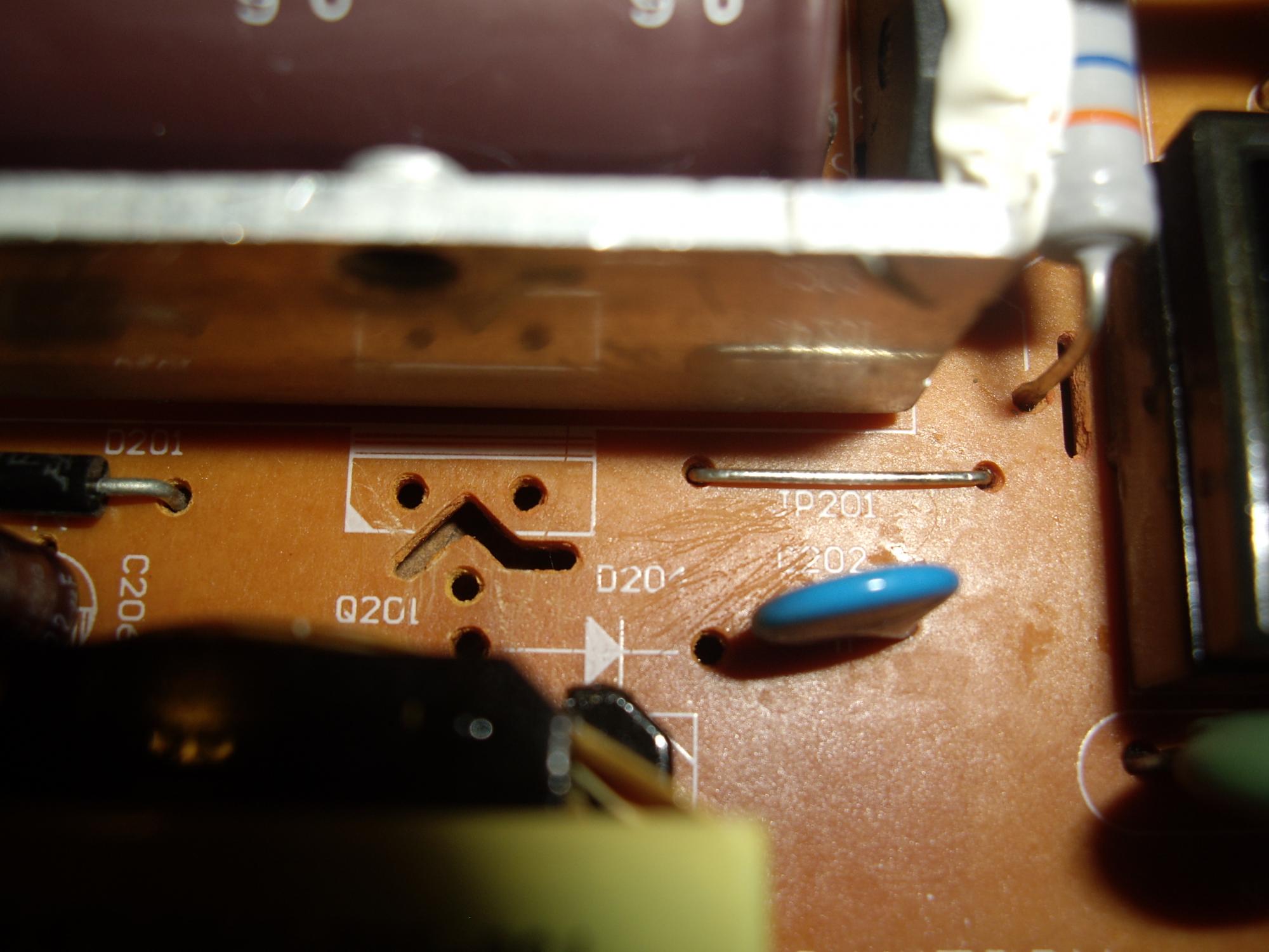

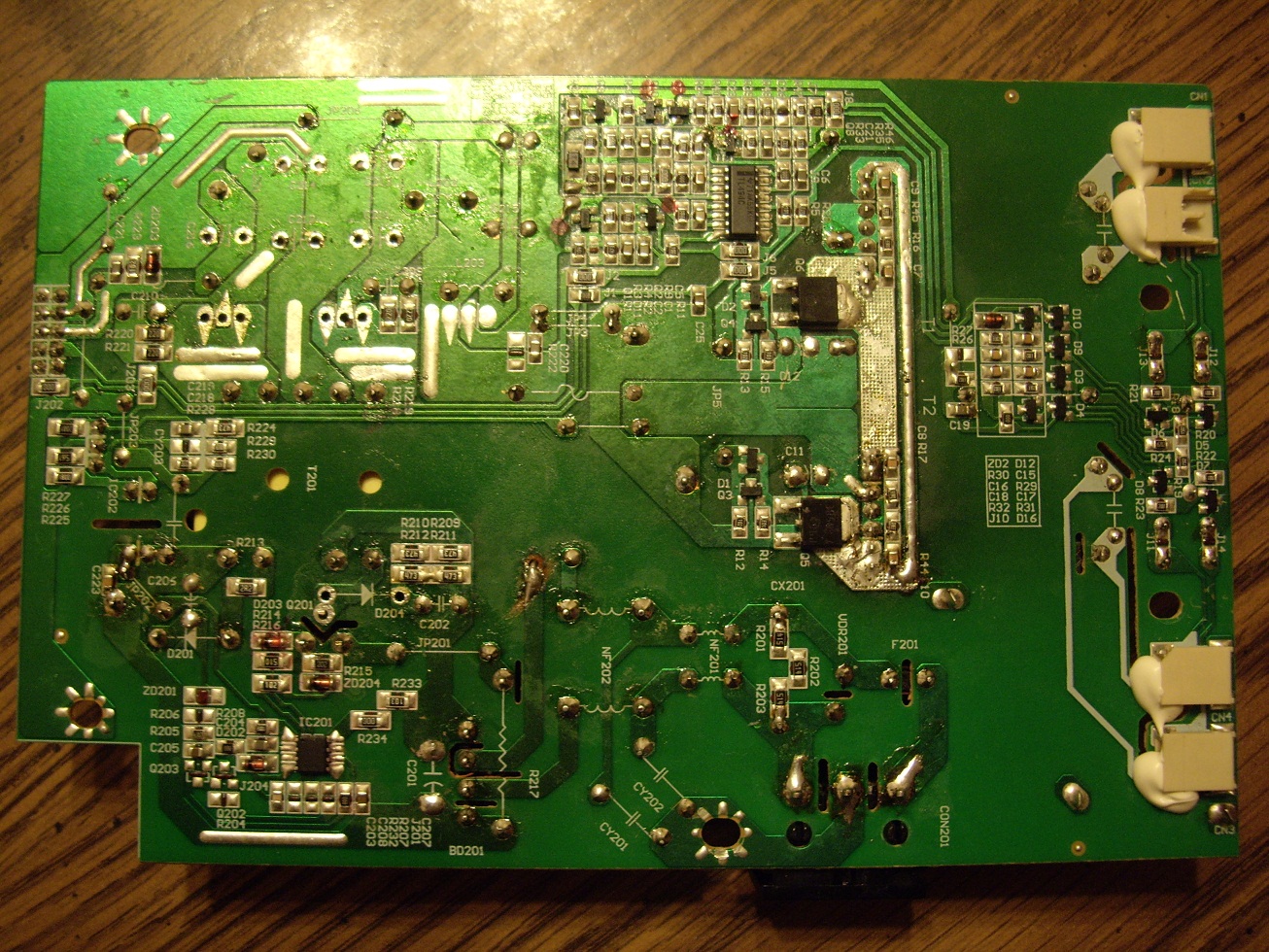

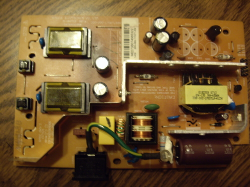

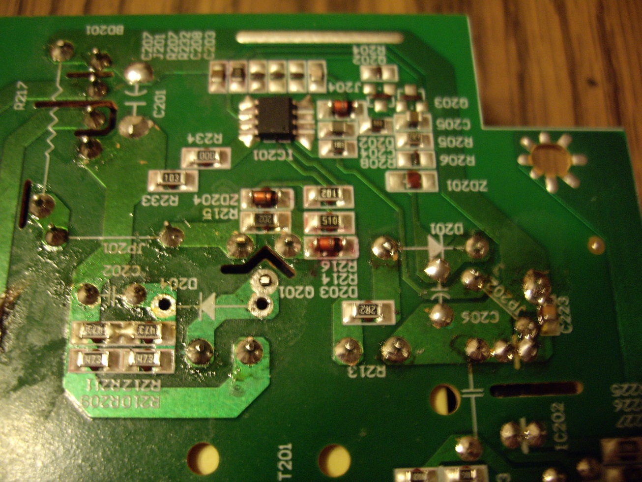

                Re: D201 Diode For Gateway FPD1975W/900W?
                Hello All,
                First off sorry for no photo! Second, my board doesn't have a ZD201. Sorry.
                Also its D204 not D201 as I posted before. My bad. I'm including pictures this time for all to inspect and comment on. Be kind!!! Thanks to all the fellas for the replies so quickly.
                Take Care
                Lcdman
                  Hello AWD Guy,
                  I went through my other boards and found one like the one you had a picture of. ZD201 has the numbers: LT52l0 & P6KEl2A under the LT52l0 Hope this helps in your search!
                    I see you have D204 removed. In that case, check the numbers on it and post them here. Otherwise, post a picture of the back side of the power board - this will help determine what the function of D204 is.
                    Also, was Q201 blown as well?
                        Hello Again,
                        Sorry for the delay in posting. Yard work, oil change on my car. Yes Q201,D204 were shot. D204 doesn't have any numbering on account it was fried! Maybe these two additional photos of the bottom of this board will help to identify D204?
                        Take Care
                        Lcdman
                            Yes, thanks.
                            Looks like D204 is the snubber diode, so you need a fast recovery rectifier rated for at least 1000v and 1A forward current (I would recommend 1.5A just to be safe). FR157 is rated for 1.5A and would probably work fine. PR1507G and UF1510 have the same ratings as well. A slight upgrade would be PR2007G, FR207, UF2007, and UF2010, which are rated for 2A, 1000V.
                            There's probably other choices as well, depending on where you buy from. If you have any junk power supplies, have a look in there first - they often have similar diodes on the primary side near the switching transistors.
                              Forgot to mention... Check C202, D203, and ZD204 for short circuit. Also check the SMD resistors to see if any are open.
