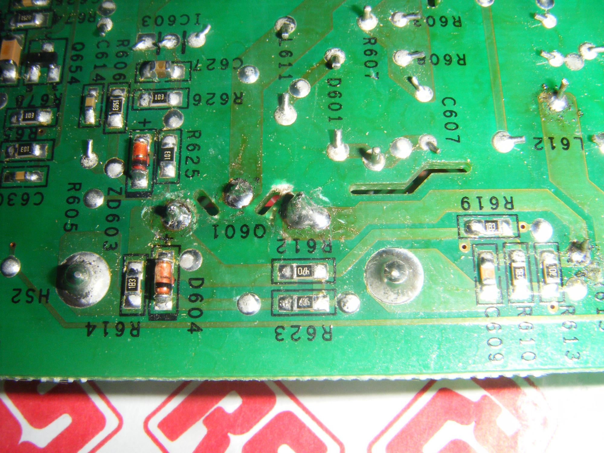

                    • newbie1
                      • Apr 2010
                      • 269
                      #90
                      Re: Dell 2407WFPb Monitor - Bad Cap
                      WillyBobz, many thanks for the information..
                      • newbie1
                        • Apr 2010
                        • 269
                        #91
                        It seems like my faulty power board has more faulty components then those stated in Post #77. I tried to purchase the whole board from Taobao.com, as being shared above, but they are ALL out of stock. So back to ordering & replacing the faulty components one-by-one..
                        Now I need your help, guys!!..
                        In addition to post #77, i had another SMD resistor R623 faulty as well.. I think it is tied to one of the leg of Q601 (shorted as well). But the problem is i could not see clearly the marking on it. Kindly see the attachments.. From what i can tell it is 4(?)7.. But i can't be sure. SO, i will need some expert help what the resistance i should order to replace the burnt resistor.. I have not yet completely check the rest of the zeners/diodes.. Hopefully, there would not be more being 'shot'.
                        • PlainBill
                          • Feb 2009
                          • 7034
                          #92
                          4?7 is not a valid resistance. That would be over 400 megohms!!!
                          PlainBill
                          • newbie1
                            • Apr 2010
                            • 269
                            #93
                            PlainBill
                            Thanks PlainBill,..
                            That last digit on it looks to be number '7', to me.. And for the first digit i could see a part that looks like the top part of the number '4'.
                            I am guessing here but is it possible for it to be marked '4R7'? Means 4.7ohms? Is it a standard resistance?
                            • PlainBill
                              • Feb 2009
                              • 7034
                              #94
                              Originally posted by newbie1
                              Thanks PlainBill,..
                              You, Sir are brilliant!!! Yes, that could be possible; indeed I am convinced you are correct.
                              PlainBill
