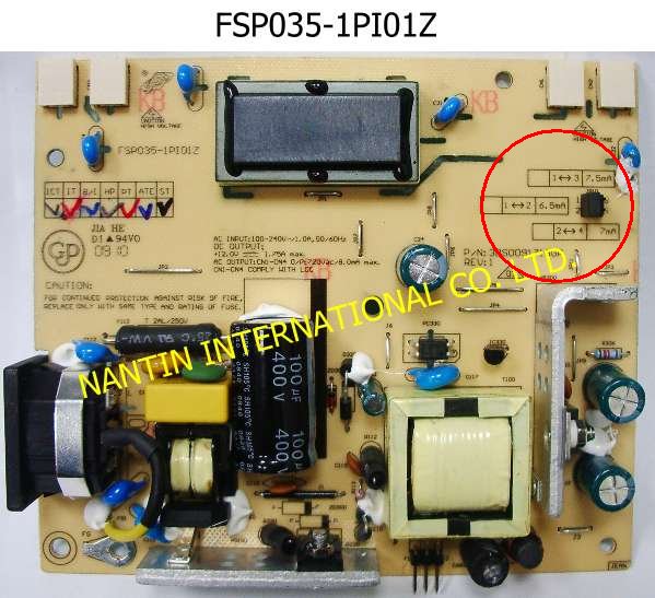

    fsp035 power board mA
    Hello, recently repaired one of these successfully (from info on this board, great but think the board may be worn out a bit (some faults came back after a few months), so bought a new one for £12.
    its for a viewsonic VX912
    original fsp035-1PI 01
    replacement fsp035-1PI 01Z
    the new board has 3 jumper settings for 6.5mA, 7mA or 7.5mA
    supplied setting is 6.5mA
    from where the silkscreen mA details are printed i imagine it's something to do with the high voltage supplied to the screen. can anyone confirm the mA ?

    Re: fsp035 power board mA
    it looks a lot like this board, mA jumper in top right
      17"....6.5Ma. 19"....7Ma. 19"Widescreen....7.5Ma.
        Correct, the mA rating tells you how much current will be supplied by the inverter to each CCFL. Bigger screens have bigger CCFLs and thus require more current. The voltage supplied by the inverter is constant, though.
          A CCFL inverter is a constant current source. The voltage will vary depending on the temperature and age of the lamps.
