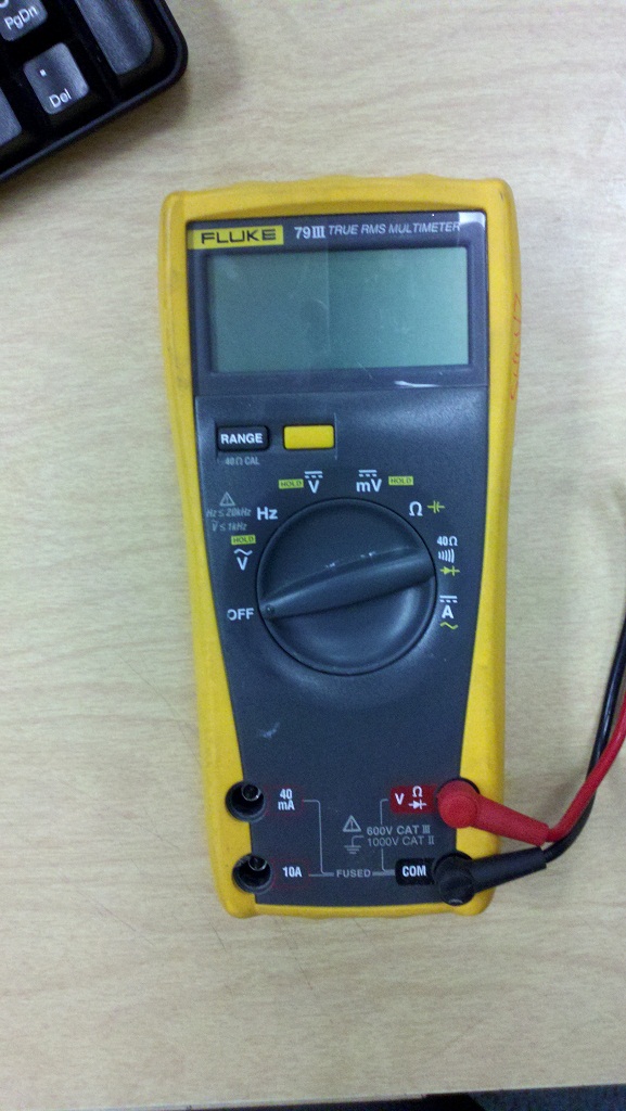

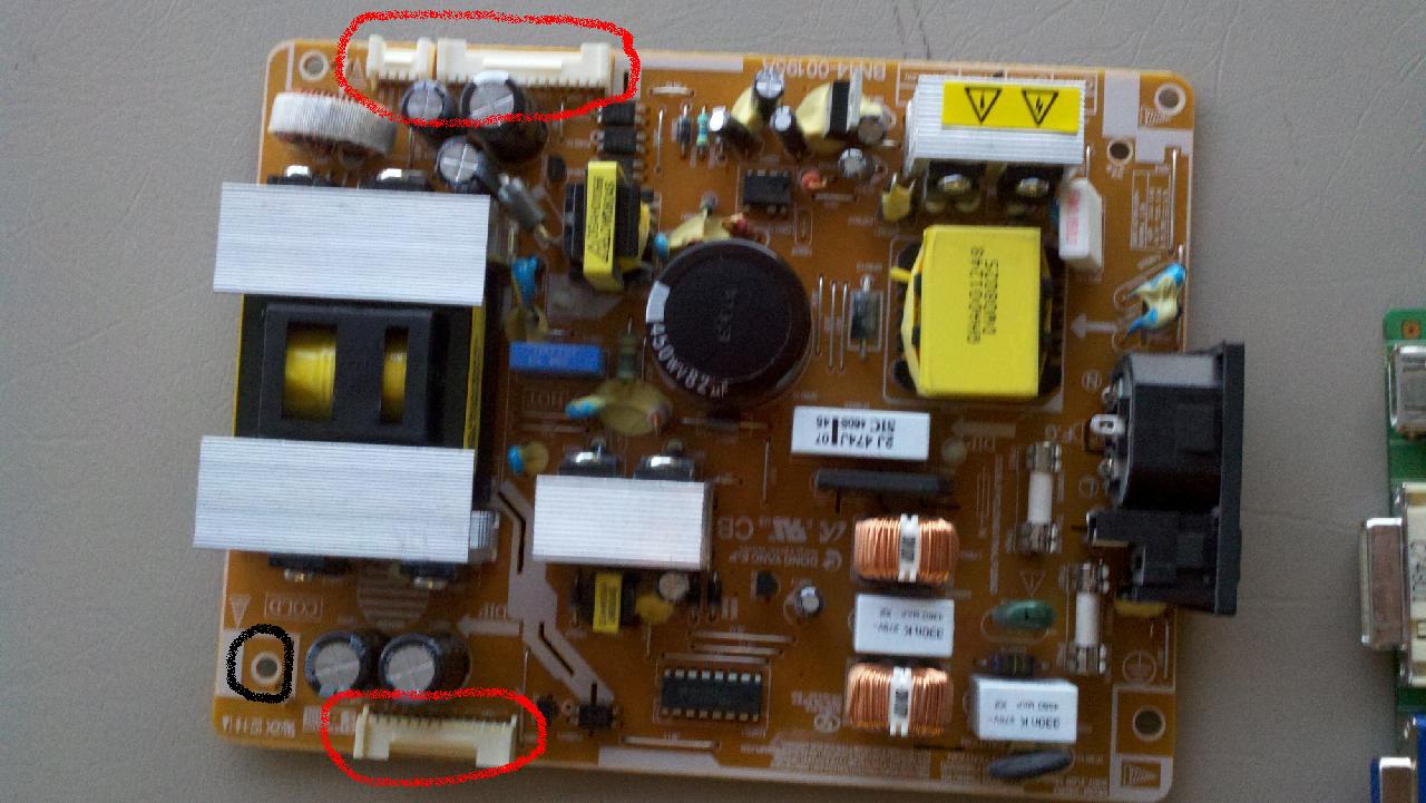

      Originally posted by rob85635
      Yes, I have a multimeter but I only use it rarely and to measure AC and DC voltage and I am unfamiliar with the other features but I will learn as needed.
      1) On the power board, let's get DC voltages for each connector pin circled in red. Put your black probe on the ground screw that I circled for all readings. Put your red probe on each pin and report the voltage along with its legend/label. For example,
      Connector CN200
      pin 1 - label 5VSB - my reading is 4.99V

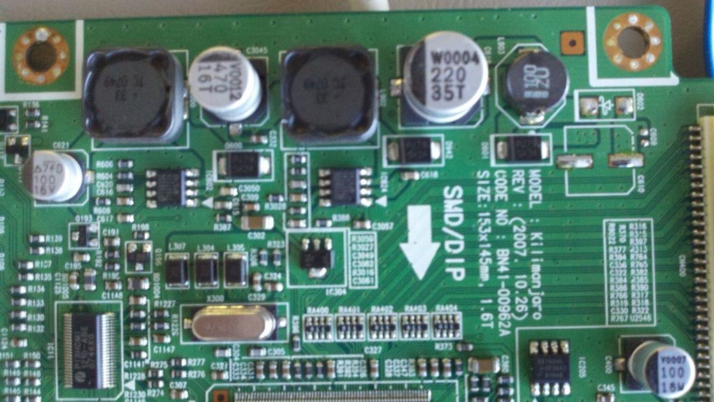

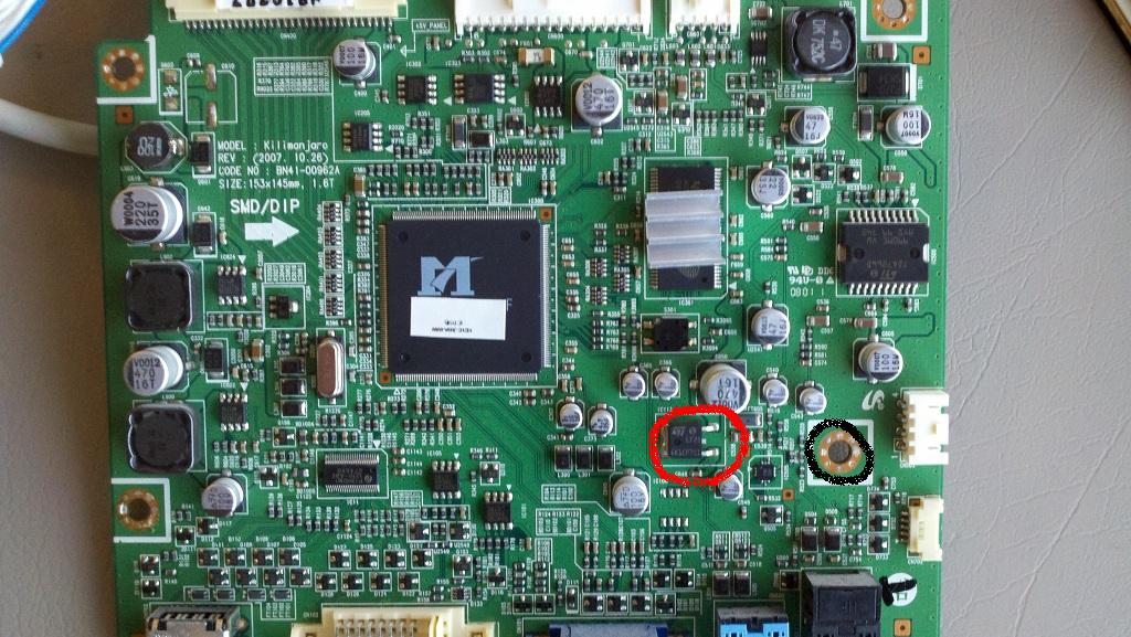

      2) On the logic board, there is one voltage regulator that I can spot. Put your black probe on the ground screw that I circled for all readings. Put your red probe on each pin (3 pins - ignore the top tab) and report the voltage along with the part number of the voltage regulator.
      3) For bonus points, post a picture of your multimeter.

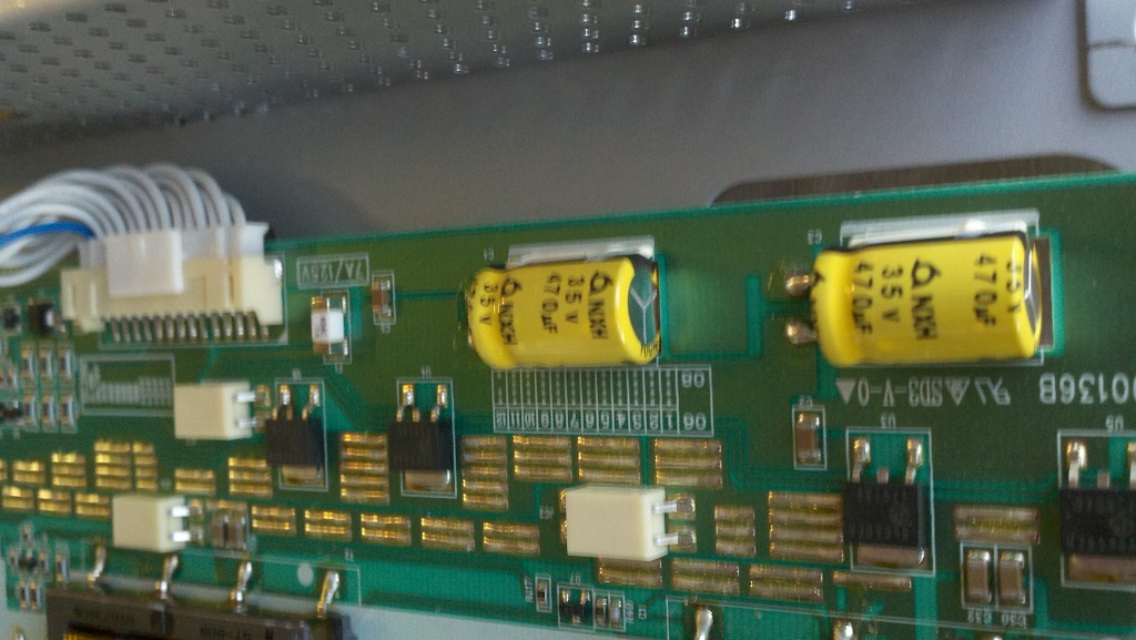

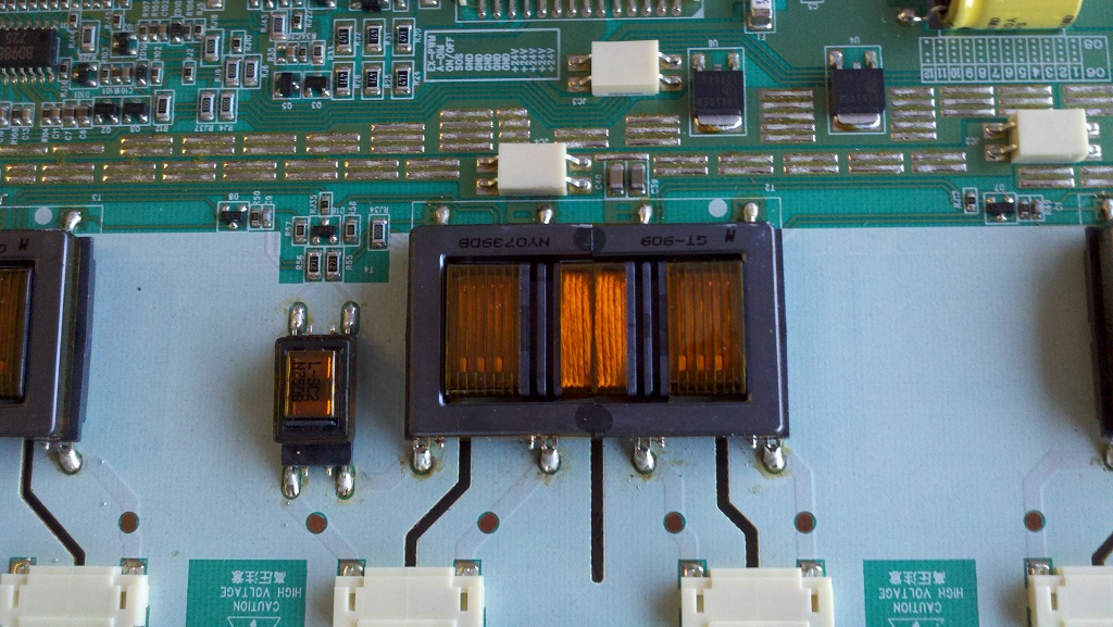

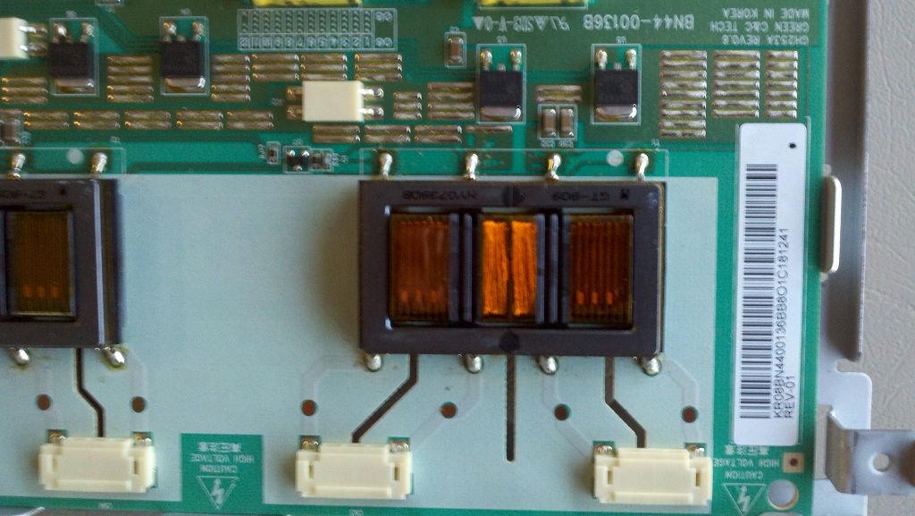

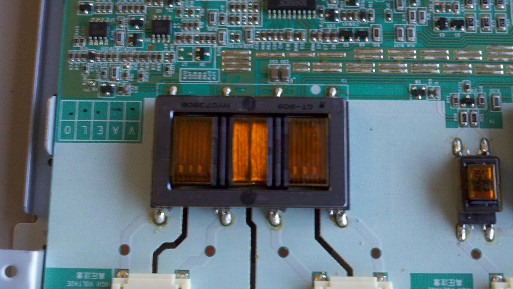

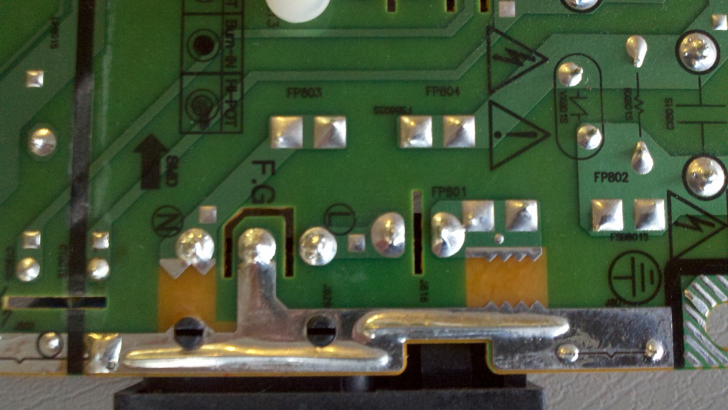

        Pictures although plentiful are not really clear enough for troubleshooting - they need to be really clear ,as near to 2 MB as you can get. As your blue light is on i guess the two white fuses on the powerboard are ok but you may as well test them. With power off, meter on ohms setting- note what it registers when you touch the probes together, then one probe on each end of the fuse - you should get the same/ similar result.
        There is another fuse - see pic 5 in last series there is a small white block the label nearby says 7A 125V. Please measure that in the same manner and post results.

          Here is a picture of my multimeter for the bonus points. I will get those measurements ASAP but my 3 year old daughter swallowed a hair clip that so far has not passed naturally so we have to go back to the ER and get another X-Ray to see what the next step is. Thanks again for all the advice so far.
          Rob
            Nice multimeter. One retiredcaps bonus point awarded.

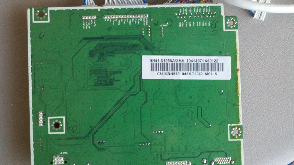

            When you have time, we will also need a picture of the panel board. This is the board that runs the entire length of the lcd. It is usually found at the top of the monitor sometimes underneath some metal shielding. This panel board may have a fuse on it which may require testing.

                                        You can start by chechking the 2 main fuse near the power cord. Also the 'Green' resistor beside the main capaitor and the 0.22ohms infront of the 2 mosfets in the middle of the board.
