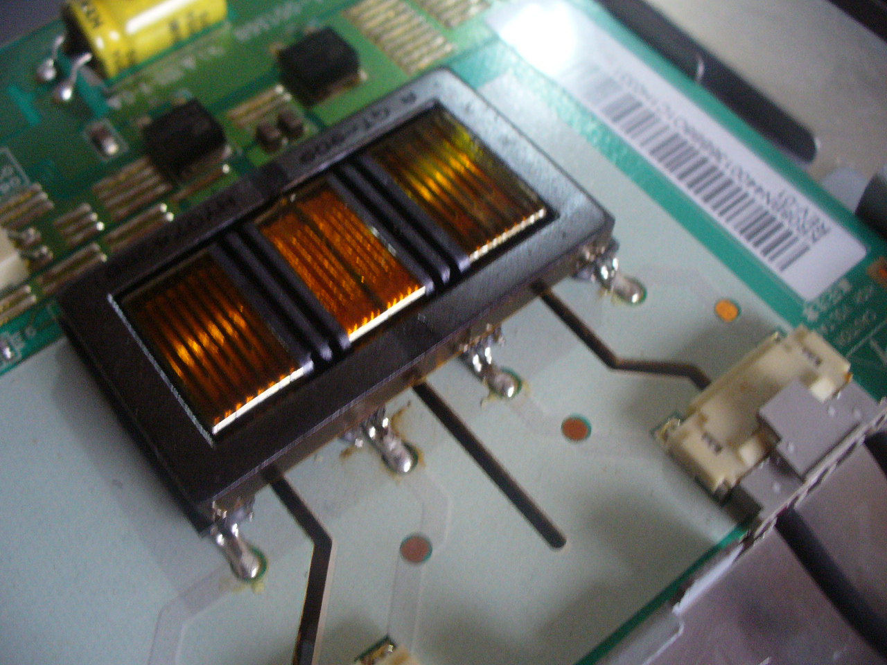

    Hi. I am having blank screen problem with the same monitor. Had to replace a power supply cap recently, and now no screen. Also, I had an arc sound with a flickering from back light. Had to resolder one of those inductor things in the inverter board. If you turned the olights off you could even see the arc. Whats happening with the quality control from samsung?
    I tested the voltage in the on/off line, my cheapo non exact multimeter read 0.28 volts on that line. The 24v rails all of them have power. The first and second (EX-PWM and A-DIM) read 0 volts.
    Any word on this??? Could not see anything with a flashlight on the screen...
    I am attaching some pics of the inverter board.
      Re: Samsung SyncMaster 2493HM black screen with power
      Well if you could see an arc i think it should be obvious that you need new inverter transformers.
        The arc was formed because of a broken solder spot.
              Thanks for chiming in. Well, maybe I did not elaborate enough. The cap that I replaced from the power supply has been working fine since like 7 months, the monitor had problems to turn on its power led, and the cap was leaking. The inductor transformer broken solder making the arc; I fixed it like 9 months ago. Now yesterday it did not start all of a sudden, but its power led remained lit, so I am not suspecting of the PSU, also because of it putting the right amount of volts right in those rails.
              Now talking about the power supp cap I replaced, I would not think of it being the best, its hard to find a shop with good caps here, I live far from US, and I need the monitor to work on it, so wait for a intl shipment is an ultimate choice. It is Jakec brand. There is a read in this forum where a person had success with them in a PSU.
              My suspects are the logic board or the inductor board. The logic because of the "A-DIM" rail showing 0 volts, and the "ON/OFF" having low voltage, if the other read is an homolog, that could be it. However I do not have the skills to test it. Thanks for the kind help.
                  Hm also found this 3A pico fuse its putting 117ohm.

                    #29
                    An image is worth a thousand words, here are the results. I bypassed the fuse with a piece of wire and this was the result:
