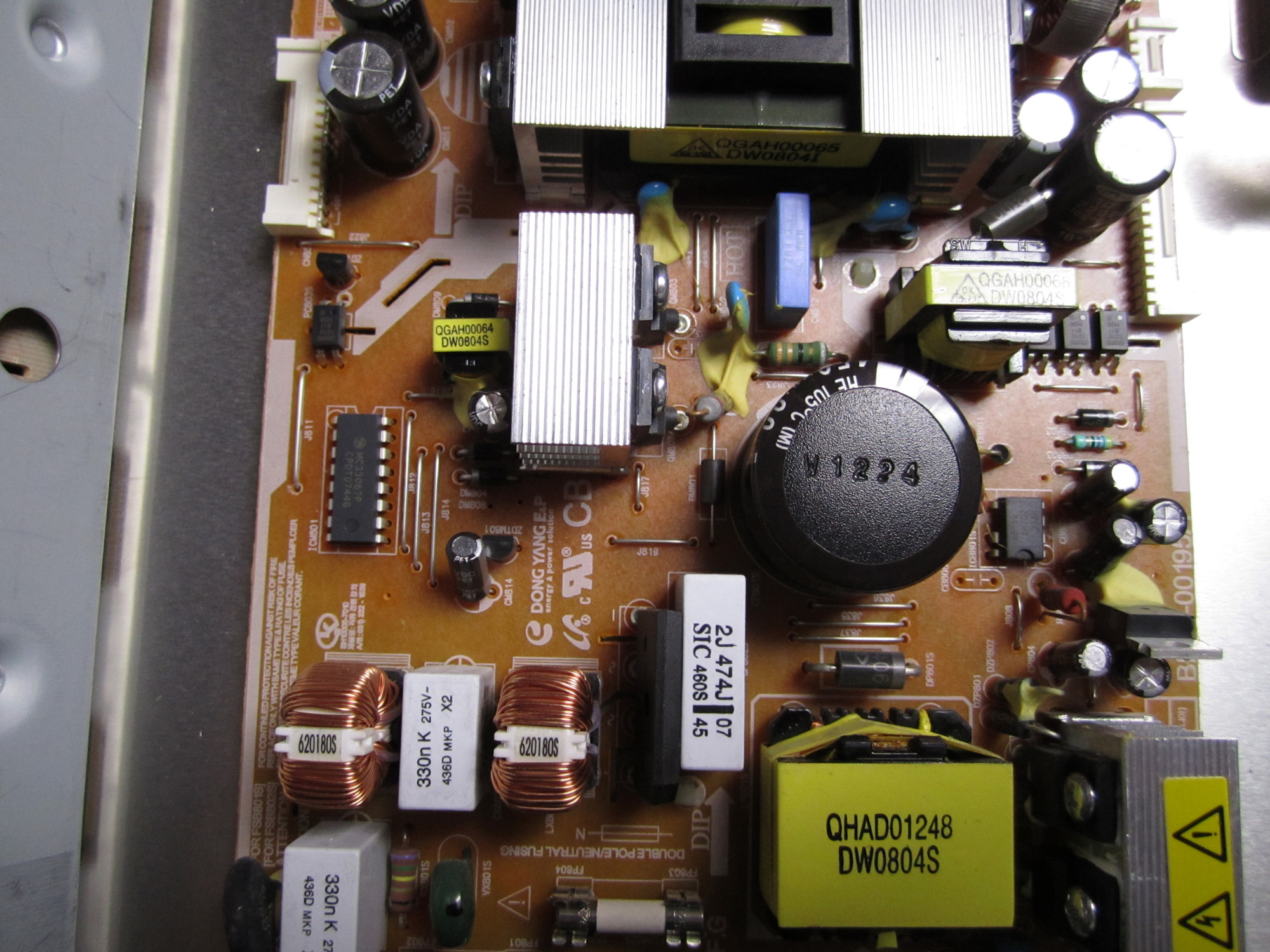

    Hello. My Samsung 2493HM will power on but has a black screen.
    Working great for a while, it even sometimes works for a long time but then the screen goes black.
    This is what I do know;
    The Blue LED is solid when this occurs.
    Sometimes while it's black, a clicking/ticking noise will start in no particular pattern. The noise may be coming from the speakers but I cannot tell for sure.
    I have opened the case, inspected the caps and they are not visibly swollen. I know this might still be the issue I just want to move in the right direction.
    I shined a flashlight on the screen and I see no picture/color.
    One of the leads to a speaker cone was broken so I soldered to repair but I do not think this is related. The speakers work at all times.
    Before I start replacing the wrong (or right) parts I was hoping for the shared expertise and experience here to help me in the next direction of troubleshooting and repair.

    The solid blue led indicates that the power board and logic board are likely to be working okay. When the screen goes black, this suggests something wrong on the inverter board.
    The standard procedure here is to post clear focused pictures of all your boards using the manage attachments functions so the pictures are attached to this forum. Please do not post inline because it slows down the loading of pages.
    After you have posted the pictures using manage attachments, we can suggest test points or see if the caps on the inverter board are known bad series.

        The pictures are clear enough to give me a point to check. On the fourth picture (inverter) it appears the third pin from the top is the On/Off control line; the fifth through ninth are ground. Measure the voltage on that line when the backlights have gone off. It should be about 3.3 volts. If it is, you have a 'two seconds to black' problem. I believe replacing the two caps on the inverter would be the first step.

              I would also replace the two yellow Sam Young caps on the inverter board, since that brand is not the most reliable.

                Sorry, picture 4 shows both boards and I can generically troubleshoot components but I have no idea the location you refer.
                Sorry, I am ignorant to these monitor's components.
                  Re: Samsung SyncMaster 2493HM black screen with power
                  So the invertor board is the one in picture 5? I know what an invertor board looks like in a notebook and that looks most like it?
                    Yes, pic 5. Two yellow caps, marked NXH 470uf 35V.

                        Replaced the two 470uF 35V CAPS on the invertor board. The ones from digikey were too long but they worked any way. They did not however fix my problem. The screen is black, LED is still solid blue and I still here the clicking/ticking. It hasn't light up at all now but the noise is the same. I will try to record it and attach.

                            1) Check for poor solder joints on the inverter board.
                            2) I wonder if that clicking sound is arcing? That is, poor ccfl or burnt out wiring to/from the ccfl?
