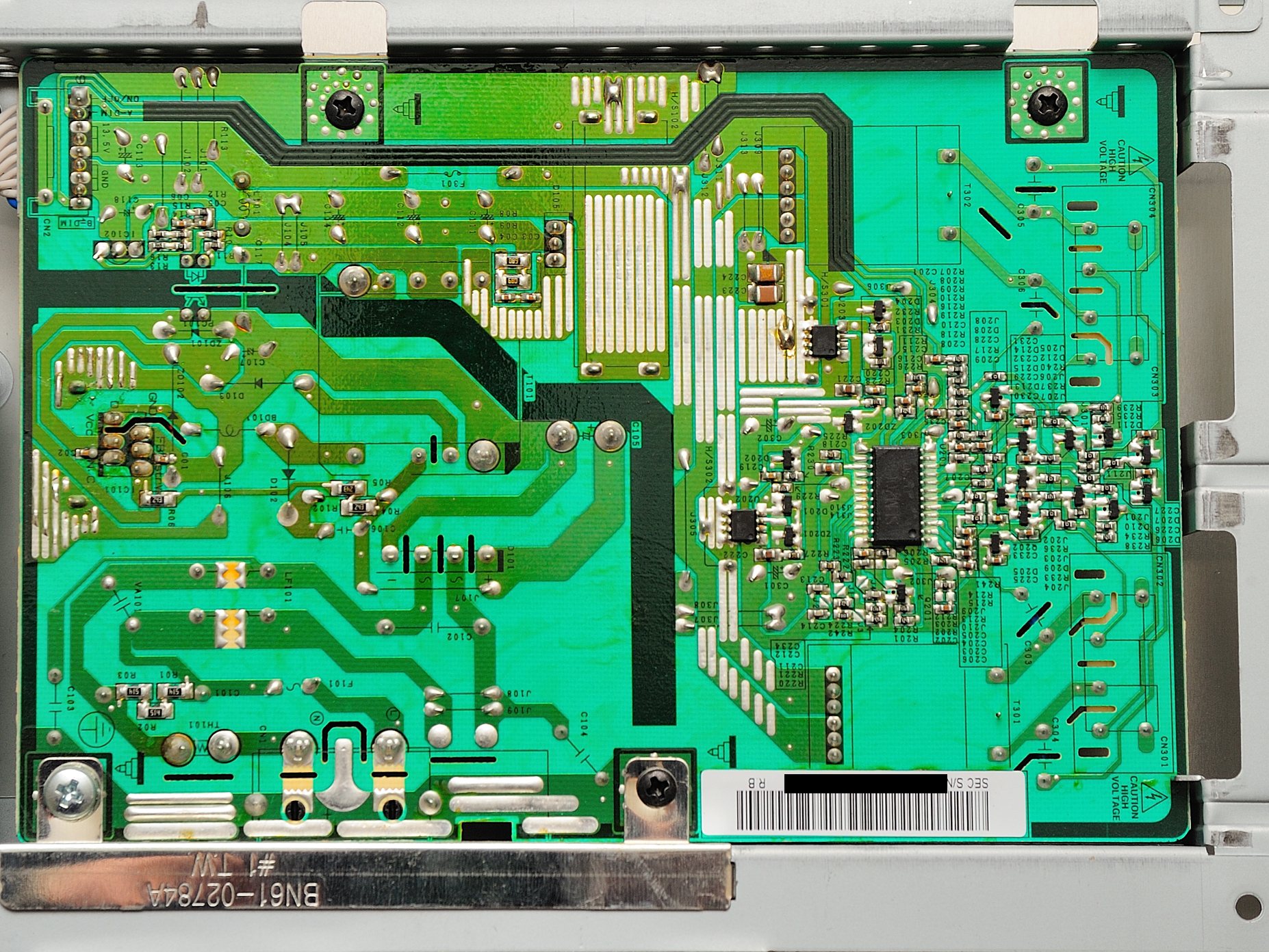

    Recently my monitor became flickering coming out of standby. I do not often shut off my computer (including monitor) but did so a few times. The problem showed up during Bios/Post screen all the way to Windows Login. Obviously not a driver issue, to make a long story shorter. Having dual monitors, flickering and one not (reversed connections at GFX card same monitor flickered). Monitor also exhibits flicker when not plugged into any GFX card when powered on.
    So I took it apart and have located some bad caps (surprise ), some bulging, and some leaking. Attached is a photo of the power board (front and back) as well as the Capacitors I would like to replace (whether they look bad or not). I would appreciate any advice on whether I should replace other parts that I have not listed. Thank you!

        Re: Samsung 2232GW
        1) Wow, I have seen a lot of photos over the last year, but this is easily one of the best focused and sharpest picture I think I have seen.
        2) Capacitors die from age, heat, and shoddy build quality. Capacitors DO NOT have to be visibly bloated in order to bad. They can be out of tolerance uF (a 1000uF measures 20uF) and/or have high ESR (ohm). A multimeter will be insufficient to test for ESR. For that you need an ESR tester which costs between $50 and $300.
        Most members here will recommend that you replace ALL capacitors with reputable brands from reputable sellers. Brands like Rubycon, Panasonic, and United Chemicon are suggested. A list of recommended caps can be found at
        https://www.badcaps.net/forum/showthread.php?t=2280
        3) Capxon doesn't have the greatest reputation here and with a 50% cap failure (4 obvious bloated/8 total - not counting the big one), it is wise to replace them all. The biggest cap rarely, but not never, fails.
        4) Follow PCBONEZ's post and list the info (particularly the series which is usually a 2 letter code found the cap's sleeve) and he can tell you all about ripple, ESR, etc.
        Again, excellent photos. I will now be using your pic for a "reference" for others to see.

          Re: Samsung 2232GW
          AGREE!

            Re: Samsung 2232GW
            A few of other thoughts regarding the flicker and not powering off.
            1) With the bloated caps, it is likely the inverter section is getting unstable power which is likely to cause the flickering.
            2) The board is dated 2007 April 18. So this monitor is 4 years old. I seem to recall that ccfls have a lifespan of generally 40K to 60K. If you have the "default" settings, your brightness is likely set to 90 and contrast to 50.
            3) After you replace the caps and if the flickering is gone, the life of the ccfls may be reaching their end of life. If I'm interpreting your "not shut off" comment as running your system 24x7, then
            365 days x 4 years x 24 hours => 35,040 hours.
            So you may, after recapping, be replacing the ccfls in another 1 to 3 years depending on the lifespan of the original ccfls.

                                Re: Samsung 2232GW
                                Originally posted by PCBONEZ
                                Step #1 - ID old caps and look up their ESR and Ripple specs.
                                - What brand, series, and diameter are they?
                                Made corrections on Capacitors (fresh eyes this morning!) and updated initial "Samsung 2232GW_Capacitors.txt" text file with Mfg. Series as well as Dimensions. Great information!
                                Thank you, I will let the kids now, they helped hold the chair still (that I was standing on) while I snapped away One of my other hobbies is photography, I did not do too much to prep for the photo. Small Aperture (increases apparent depth of field)+indirect/diffused flash (bounce flash removes harsh lighting glare)+some editing and resizing. The back of the PCB did not turn out so well.
                                I do not have a ESR tester, I have many tools here but not that one! I would possibly pick one up if I saw one for $50.00 but at $300.00 it would have to start earning its keep. lol
                                I had been inclined to replace all the ones I listed since I am already mucking around inside my poor display. I was unsure of the 100 uF, 2.2 uF, as well as the small (film?) capacitors that I have not listed. I like the old saying, "If you don't have time to do it right the first time, where do you find time to do it twice?".
                                Thank you for the information!

                                  • TAdams
                                    • 9
                                    Re: Samsung 2232GW
                                    Looking for replacements, so far here is what I have come up with:
                                    1 x Panasonic TS-UP 2.2 uF 50V http://search.digikey.com/scripts/Dk...EU-FC1H2R2H-ND
                                    1 x Panasonic FC 100 uF 450V http://search.digikey.com/scripts/Dk...&name=P7427-ND
                                    5 x Panasonic FM 820 uF 25V http://search.digikey.com/scripts/Dk...name=P12391-ND
                                    1 x Panasonic FR 330 uF 25V http://search.digikey.com/scripts/Dk...name=P14415-ND
                                    1 x Panasonic FC 2.2 uF 50V http://search.digikey.com/scripts/Dk...EU-FC1H2R2H-ND
                                    For some of these there were more desirable components, with longer life, but they were either out of stock or had a .min order quantity (far) exceeding the numbers I am looking for. Any changes and or recommendations?

                                      Re: Samsung 2232GW
                                      No, don't need to worry about film caps.
                                      Any cap can fail but it's cheap lytics that cause 99+% of the caps problems
                                      Please refer to the data sheets so you understand what is going on. [Will help you in the future.]
                                      Should note here that crap brand data sheets can be erratic an inconsistant so sometimes you have to funge factor and guestimate [ball park] what the spec values for the specific one you need are.
                                      Some crap brands don't even publish data sheets in which case you should ask someone that works with that kind of circuit all the time.
                                      For Ripple you want the same or more.
                                      For ESR you want the same or less.
                                      C105 Samyoung NFC 100 uF 450V
                                      This is a junk brand but it's the AC input cap. Has 'different job' than the other Lytics.
                                      They [AC input caps] rarely fail and it's not bloated so no reason to suspect it at this point.
                                      Some people like to replace them anyway so here's where the specs are:
                                      http://www.samyoung.co.kr/eng/product/product_info.asp
                                      https://cdn.badcaps-static.com/pdfs/...b68155e348.pdf
                                      Keep in mind this kind of cap has Ripple stated at 120Hz which 'doesn't cross' with the specs used for 'normal' caps.
                                      The standard used for 'normal' caps [typical ones -we- see] is Ripple [and ESR] at 100kHz.
                                      Don't worry about ESR on this one, it is a GP cap [General Purpose], focus on the Ripple rating which is 602 mA..
                                      All the Capxons listed should go.
                                      [Some would leave the 2.2uF but the cost of a few is so slight and much less than shipping should you end up having to place another order just for them.]
                                      http://www.capxongroup.com/en/prod_all_cat_full.aspx
                                      C107 . Capxon . KM 47 uF 50V 6mm
                                      This is a GP cap. [General Purpose] - We know this because ESR is not even in data sheet.
                                      Most techs [including me] recommend using at least 'entry level' Low ESR caps for these.
                                      ........ Just make sure the Ripple is the same or more...
                                      Something along the lines of Chemicon LXY, LXZ - Panasonic FC - Nichicon PW
                                      There are many options in that range. Those mentioned are common and easy to find.
                                      On to the Low ESR Caps.
                                      ----- Look in the data sheet so you know where got these numbers.
                                      C111 . Capxon . GL 820 uF 25V 10mm ... Ripple= 1460 mA, ESR= .043 ohms
                                      C113 . Capxon . GL 330 uF 25V 10mm ... Ripple= 720 mA, ESR= .082 ohms
                                      C118 . Capxon . GL 2.2 uF 50V 5mm ... Ripple= 33 mA, ESR= 2.60 ohms
                                      - Remember..
                                      Note: They use Impedence (Z) in some data sheets and ESR in others.
                                      That is because at roughly 100kHz the Capacitive Reactance and Inductive Reactance cancel each other out leaving ESR as the only thing contributing to Z.
                                      IOW: At roughly 100kHz ,,, Z = ESR. [Or at least so darned close we just say it is.]
                                      That is one of the reasons they use 100kHz as the standard.

                                        Ok, there is more to it than just uF and volts I believe with your help, I have determined that the parts I selected (more like stumbled upon) in the earlier post are good replacements, however.. Now I know why!
                                        Spreadsheet attached, I thought that .xls were not allowed, and lets face it... The text file is way more difficult to maintain rows and columns. If everything looks good I will proceed with purchase. Thank you so much PCBONEZ, and everyone else also! I really appreciate all the help.
