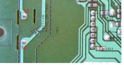

              Re: Monitor LG Flatron W1934S 2 seconds then turned off
              I have tried measuring resistance between pins but i cant get fixed reading, its increasing constantly. Should i desolder it first?
              • selldoor
                Slow Learner
                • Dec 2010
                • 7870
                See pic
                Set your meter on ohms 2000
                NO power to the board test S1 to S2 and post the result.
                Resistance should not continue to rise - is battery good in meter
                • mulanputrovic
                  • Jul 2015
                  • 5
                  • Serbia
                  S1 to S2 760 Ohm, resistance is rising on pins on another side.
                  • selldoor
                    Slow Learner
                    • Dec 2010
                    • 7870
                    #29
                    760 may be ok - cant quickly find the specs for it - have you looked?
                    At least its not open or shorted.
                    When you say you tried a laptop tube do you mean just on its own?
                    If you just use a single tube you will almost always get 2sec to black.
                    You need to substitute the lapstop tube first for one of the panel tubes leaving the other panel tube plugged in then do the same for the second panel tube plugging the first panel tube back in.
                    • mulanputrovic
                      • Jul 2015
                      • 5
                      • Serbia
                      #30
                      Thanks!!! Thats it.
                      Connection on one ccfl was lose so i soldered it, now everything work as it should.

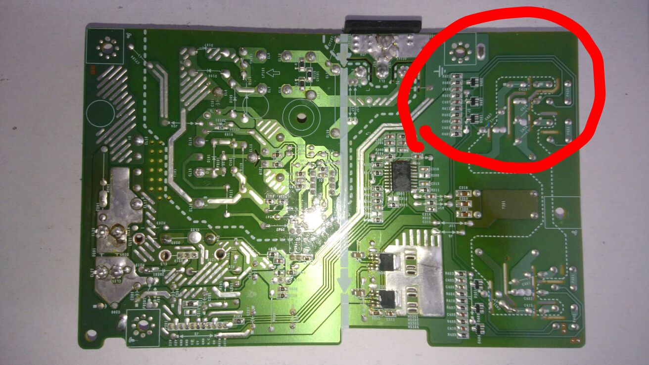

                                      #38
                                      Hi everyone, my name is Federico.
                                      I have an LG Flatron W2241S with the 2 seconds on-off problem.
                                      Well, after some tests I have discovered the broken component, the one in the pic, that should be the inverter tranformer (?)
                                      EBJ57534701
                                      EEL-22D
                                      One of the two secondary, the one inside the red circle, is broken.
                                      Or well, I think so!
                                      I have already desoldered it, so I can make all measurement needed to prove it is the bad guy.
                                      The question is, what kind of measurement (with the multi-meter) should I try?
                                        #39
                                        Put meter in Ohm mode (2K Ohms scale).
                                        It sounds like you do not know how to use meter, correct?
                                        BTW, you should start the new thread since your model does not match the original thread.

                                          #40
                                          Well, I solved in another way.
                                          I just reversed the transformer and tested the other two outputs and they works fine, so the problem is that component (is made up of "two" different transformer in one).
                                          However, I know well how to use a meter. But I didn't know which kind of value could I measure
                                          Thank you anyway for your kindness
