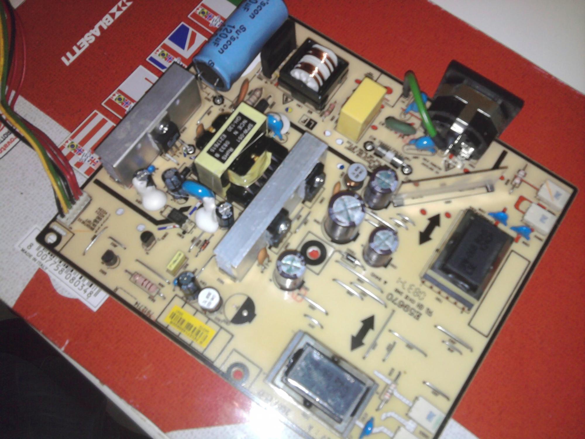

          hello and thanks for the reply, the problem is that the backlight turns off the power LED stays on
          capacitors do not seem inflated.
          the primary measure all 0.5 ohm transformer, the secondary measure 618ohm.
          resistances are all ok
          and can do some measurements on this chip oz9938gn-ic I know that this takes the security chip
          I can give a hand to do some testing
          I am attaching photos
          possibbile would find a wiring diagram

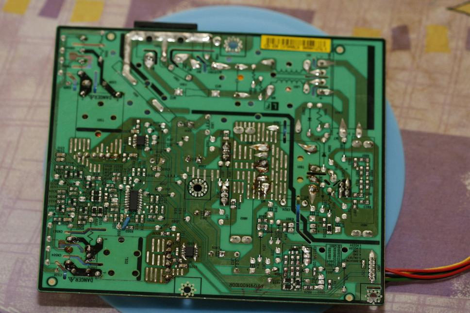

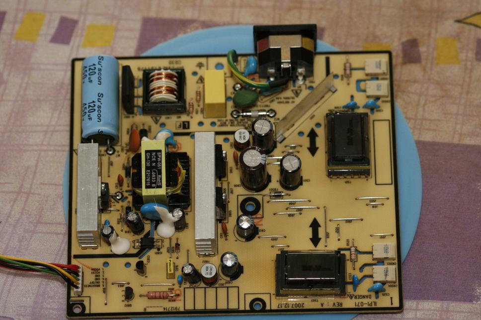

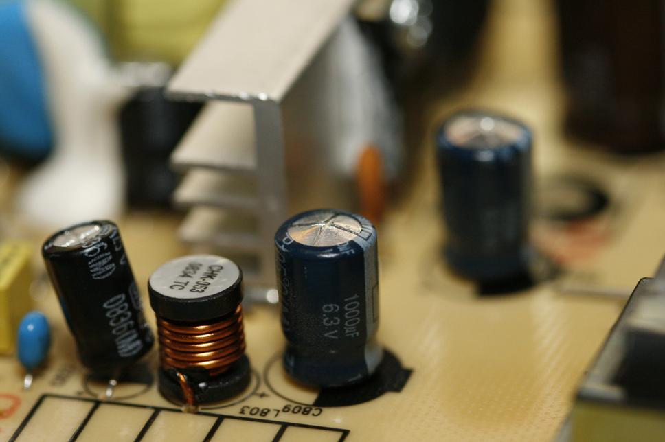

                                    Sorry for digging out the old thread but since the problem is the same Ill use this one.
                                    Problem : LCD monitor LG Flatron W1946S turns on briefly then goes off. Backlight goes off, but power light is on, so as indicated here, Ill check on caps, wiring, invertor and ccfl's.
                                    Reporting back with solution and images.
                                    Thanks to lcdman for the pdf repair guide.
