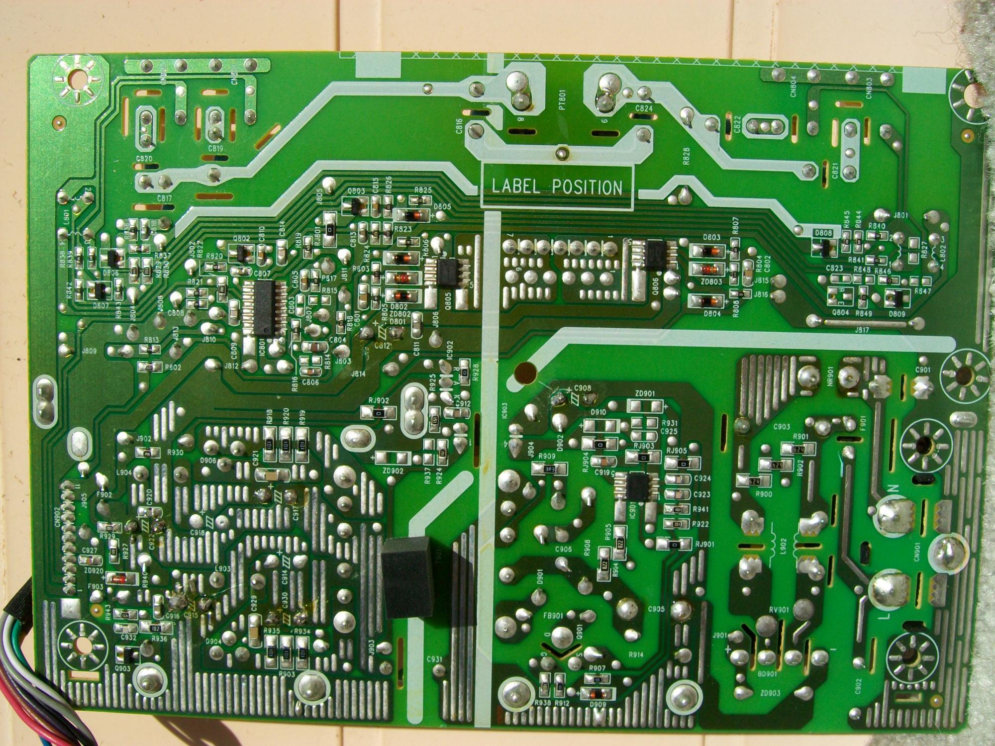

    Post #8? What did you get for ohms measurements on the inverter secondary transformers?
    Lol. Guess I missed that one. Sorry. Which one is the secondary transformer(s) or which terminals should I test? Power off I guess? Thanks.

      We need a clear focused picture on the backside of the power/inverter board. Yes, measure the resistance with power off and lcd unplugged.
      The secondary inverter transformer pins are the ones "leading to" or connecting to the blue high voltage caps.

        Re: AOC Envision L19W861 failure
        I see now it is 801, the one to the left center side of the board. Which terminals should I test? Do I ground one probe and test all of them? Sorry for being so slow. Trying to do a million things here. I appreciate all your help, just please be patient with me. I'm just trying to help out some other people with this and not charging anything for the work.
        Your previous post just showed up after I posted this one. I see it now. Will do tonight and report back here asap. Thanks.
          Here is a close up of the backside of the board. Measured resistance across terminals 8 & 9 displayed .45 m/ohms. I also tried to measure across the two blue caps but received no readings on any setting of my meter. However, I also found another flat panel lcd with similar ccfl plugs so I tried plugging it in to the AOC Envision. The display came up with my desktop and stayed on for several minutes.

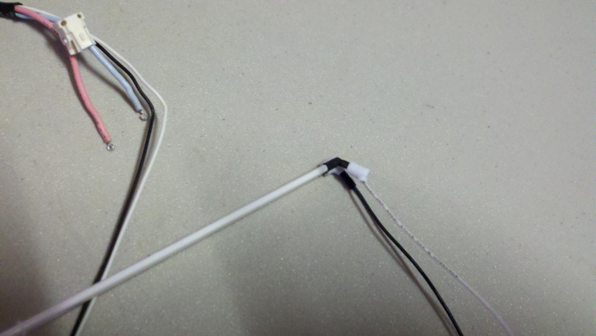

              This appears to be a case of 'two seconds to black'. You can verify this by hooking up a source with audio and video, stepping through the inputs, and verifying that sound remains after the backlights go away. You test verified that the backlights are shutting down, they are not being shut down by the signal card.
              If you have another monitor with 4 good CCFLs with compatible connectors, try hooking up all four. If they stay on, the problem is the CCFLs in this monitor.
              PlainBill
              I found another lcd that had similar connectors and switched displays (even though they are different sizes) and the new display came up with a normal, if incorrectly sized, display. Reading across the power inverter showed .45 m/ohms. I could not attach an audio source with what I have available.

                  If your test display stays on,you have Confirmed that the CCFLs are causing your 2 sec. to black problem.

                    Thanks, that's what I was afraid of. I'm checking wiring now to see if something could have been shorted or cut. Next I'll have to find a CCFL supplier that doesn't cost an arm/leg or gallon of gas! Never did this sort of repair before. It's great knowing what to do now.

                      After thinking on how the monitor was used most likley 24/7 i would think it would be something other than a wire problem.
                      there several CCFl suppliers that members have good luck using.

                        As Alexanna said, you have identified the problem. If I recall correcctly, CCFL Warehouse has good reviews from members here. I suggest you wait until retiredcaps chimes in to confirm that. He probably also has a link to a video on replacing the CCFLs. It is NOT a job for someone with a surplus of left hands like me.

                            You've got that right. I spent the better part of the day just trying to figure out how to take the display apart. I finally got one side out and both tubes are blackened at each end. One is actually cracked. These look like special tubes. They are mated into a channel with fitted ends and glued together. I've sent a request to CCFL Warehouse with the measurements and am waiting for a reply, probably by Monday.

                              Tutorial on taking apart and putting together the ccfls, which you may have already seen, is at

                                    Only cost $43 for 4 lamps, end caps, spacers, shrink tubing, replacement tapes and shipping.
                                    Go slow and take pictures so you can re-assemble. Do not force anything because the ccfls are fragile. Work when not tired and have decent light.

                                      Fragile is not the word for it. I had one assembly all together and realized that I forgot the shrink tubing. So I broke one after unsoldering and adding the shrink tubing. As I went to slide it back on, the brand new ccfl broke. I went back through the used ones and picked one that looked ok. Got it all back together - without the shrink tubing. Then I started on the other set. This time I placed the shrink tubing over the wire before soldering. Good Boy! Wrong. As I got to slide the silicone end cap back over it (they are all at a 90* angle) the end wire broke. So now I've wasted that $43 plus the original $10 for the bad caps.
                                      I will never do this again!!!!
