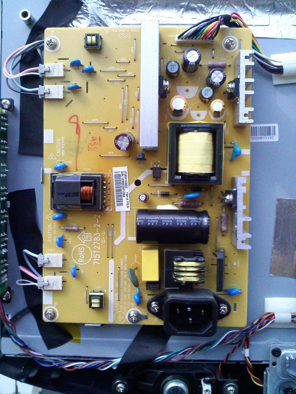

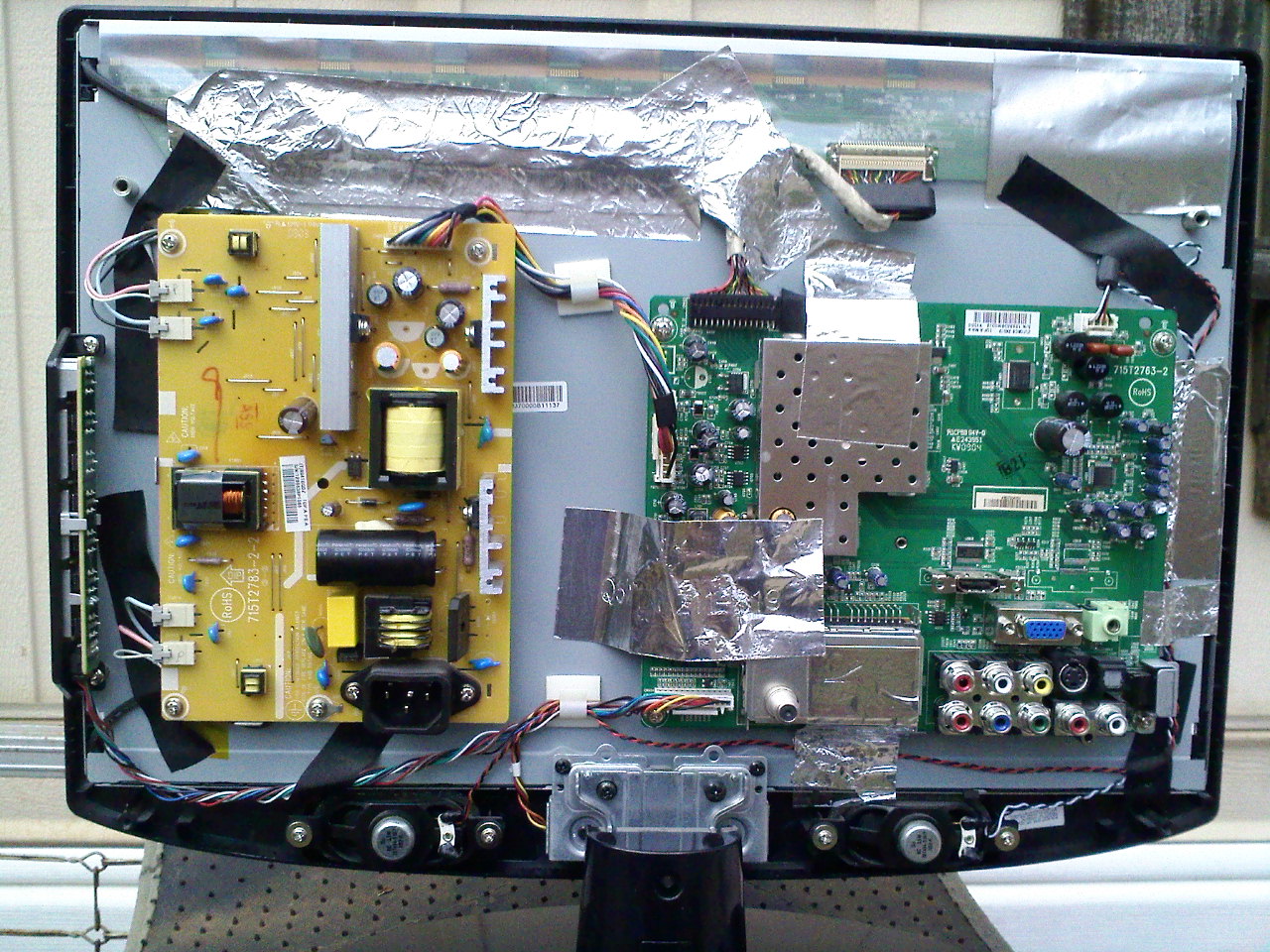

    Being the newbie here, I have looked all over hoping someone else had the same problem I've had. This RadioShack unit worked fine for about 2 years as a closed-circuit tv monitor for a security system. Then one day it just went black. I replaced all the caps (except the largest dog on the field) and all I get is the power light flashing red when I plug it in. Upon hitting power (on board or remote) the red flashes about 6 times and turns a steady blue. The monitor flickers, displays the usual "Please Wait..." and goes black. I have check and rechecked solder joints, wiring, plugs, etc. The unit is 3 years old and is good for nothing but a paper weight right now. Any ideas??? Please?
    1) If you hookup a working computer displaying your favourite wallpaper, can you see it by shining a flashlight on the lcd?
    2) How long does the "please wait" stay on before going to black?

        1) With a working pc attached and as bright a flashlight as I could find, there does not appear to be any image on the dark screen.
        2) The "Please Wait..." stays on for a mere second.

            Here's the parts list of those I did replace. (1 ea) 25v-1000uf, 10v-680uf, 25v-470uf, 16v-470uf, 16v-330uf, 50v-22uf.
            • jetadm123
              • 2169
              Re: AOC Envision L19W861 failure
              You have two heatsinks opposite each other with a cluster of cap between them. The devices mounted on the heatsinks are diodes that output the 5V and 12V. With your black probe to ground, use your red probe and measure the voltage of the middle leg of each diode and record the voltage.
              • retiredcaps
                • Apr 2010
                • 9271
                The inverter transformer is PT801. Report and measure the resistance of the secondaries.

                    Alexanna, yes, it's a TV. I can identify RF, Composite, S-Video, Component, HDMI, VGA and audio inputs.
                    Mrfixit01, there are three possibilities, a failure of the backlight circuitry, a problem with the power supply, or a failure on the signal board. Because of your source of caps I will temporarily ignore the power supply as a possible cause of the problem.
                    In the upper right corner of the power supply / inverter board is CN202, an 11 pin connector linking the power supply / inverter to the signal board. It appears the pins on the connector are labeled. We'll try this the quick way first. One of the pins turns the inverter on and off, another controls the brightness. The first is commonly labeled BL_ON (or something similar), the second is commonly labeled BRI. I'm interested in the behavior of the BL_ON pin. With the TV off, but (hopefully) connected to a signal source, monitor the voltage on that pin while you turn the TV on. It should start at 0 volts, jump to over 3 volts when the backlights come on, and then may, or may not drop back to 0 volts when the message vanishes. Report the behavior.
                    IF you are unable to identify the pin I am referring to, either list the labels on the connector or post a picture.
                    PlainBill

                              PlainBill here's what the cn902 labels are on the top right of the PB; (L-to-R) +12v, +12v, G, G, +5v, +5v, +5v, G, G, N/F, Dim.
                              reading the +12v pins: 13.08v, the +5v pins: 4.96v, N/F fluctuated between around 200 & 400 mv off and jumped to 3.96v on. Dim read 2.6v on but varied between 4.0v & 28mv off. Turning pwr on then off Dim went from 28mv to 2.6v, jumped to 3.4v & dropped quickly back to 2.6v and steadied there until pwr off then back to about 28mv. Hope this helps. Thanks.
                                  This appears to be a case of 'two seconds to black'. You can verify this by hooking up a source with audio and video, stepping through the inputs, and verifying that sound remains after the backlights go away. You test verified that the backlights are shutting down, they are not being shut down by the signal card.
                                  Possible causes include bad caps, bad CCFLs or the wiring to them, a bad inverter transformer, or a bad component in the inverter protection circuitry. I see several possible approaches. The easiest appears to be a very rudimentary CCFL test. Disconnect all but one CCFL. Turn on the power. Do you get a display on the screen (it will be dimmer than normal)? Turn off the power, disconnect that CCFL and connect the next one. Turn on power. Repeat for the remaining CCFLs. If one CCFL does not produce light, that CCFL or the wiring for it is bad. If all light to the same brightness, I'd pull the power supply / inverter board and look for any signs of problems on the back side. If nothing shows up, replace all the electrolytic caps on the power supply / inverter (with the possible exception of the large electrolytic).
                                  If you have another monitor with 4 good CCFLs with compatible connectors, try hooking up all four. If they stay on, the problem is the CCFLs in this monitor.

                                    I guess by CCFL you mean the 4 plugs that go to the back lights. (I'm a real newbie, now.) I tried unplugging all the wires and plugging them in one at a time. The same thing happened as before, just dimmer. I already replaced all the PSB e-caps except the large one. I have looked at the back of the boards twice now and don't see anything abnormal. Thanks for all the help so far. Check back later.
