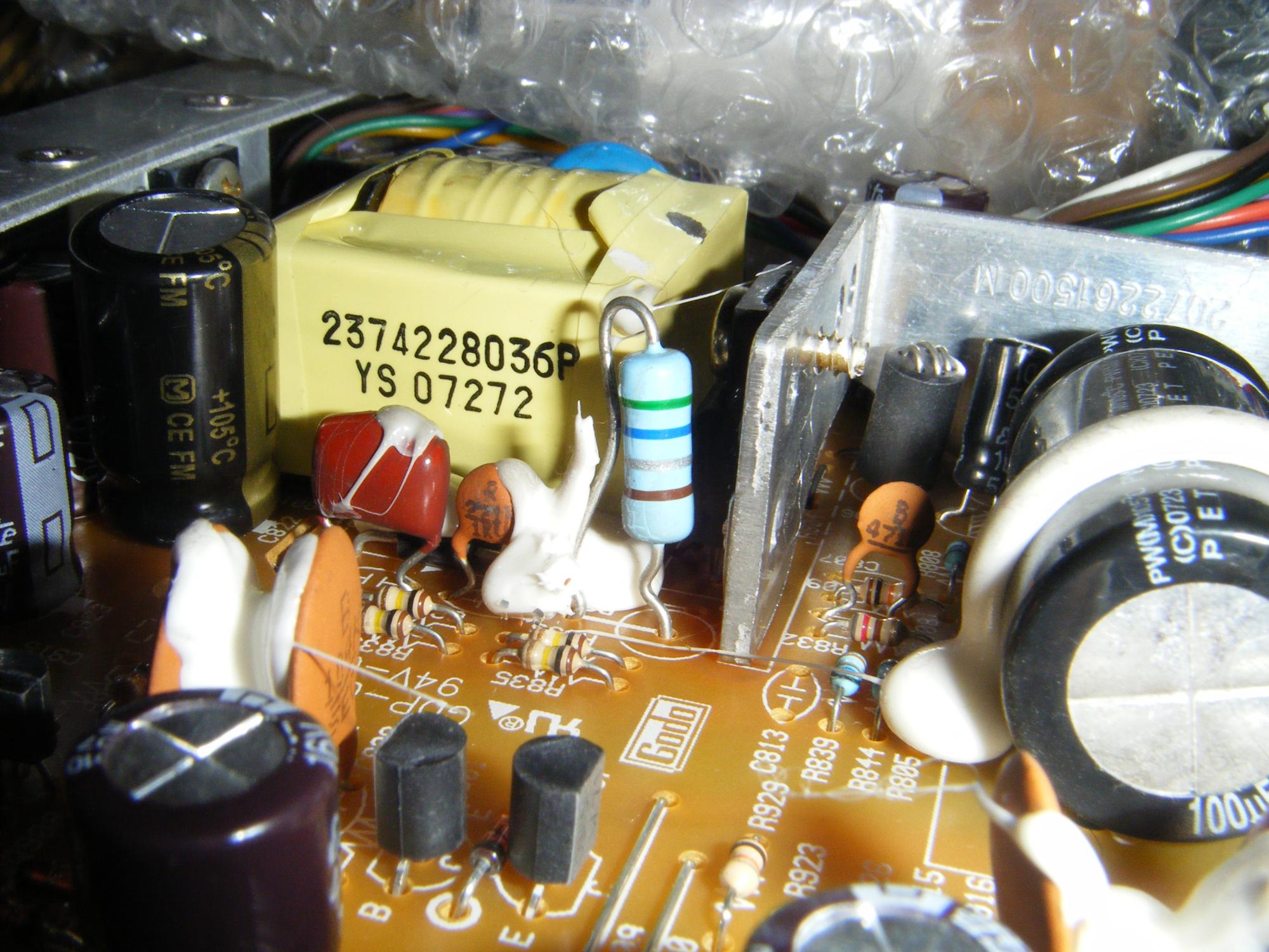

          Another thing i would like to clarify. I have attached a photo of a resistor R811. It measure 1.0 ohm in circuit. But i could not figure out what is the correct resistance should it be. It is color coded as Brown-Gray-Blue-Green. This is the proof why i could not get an Electronic Engineering degree. ..
            Re: HANSS 19" fuse keep blown
            R811 should be very low, color coded 0.56 ohms.

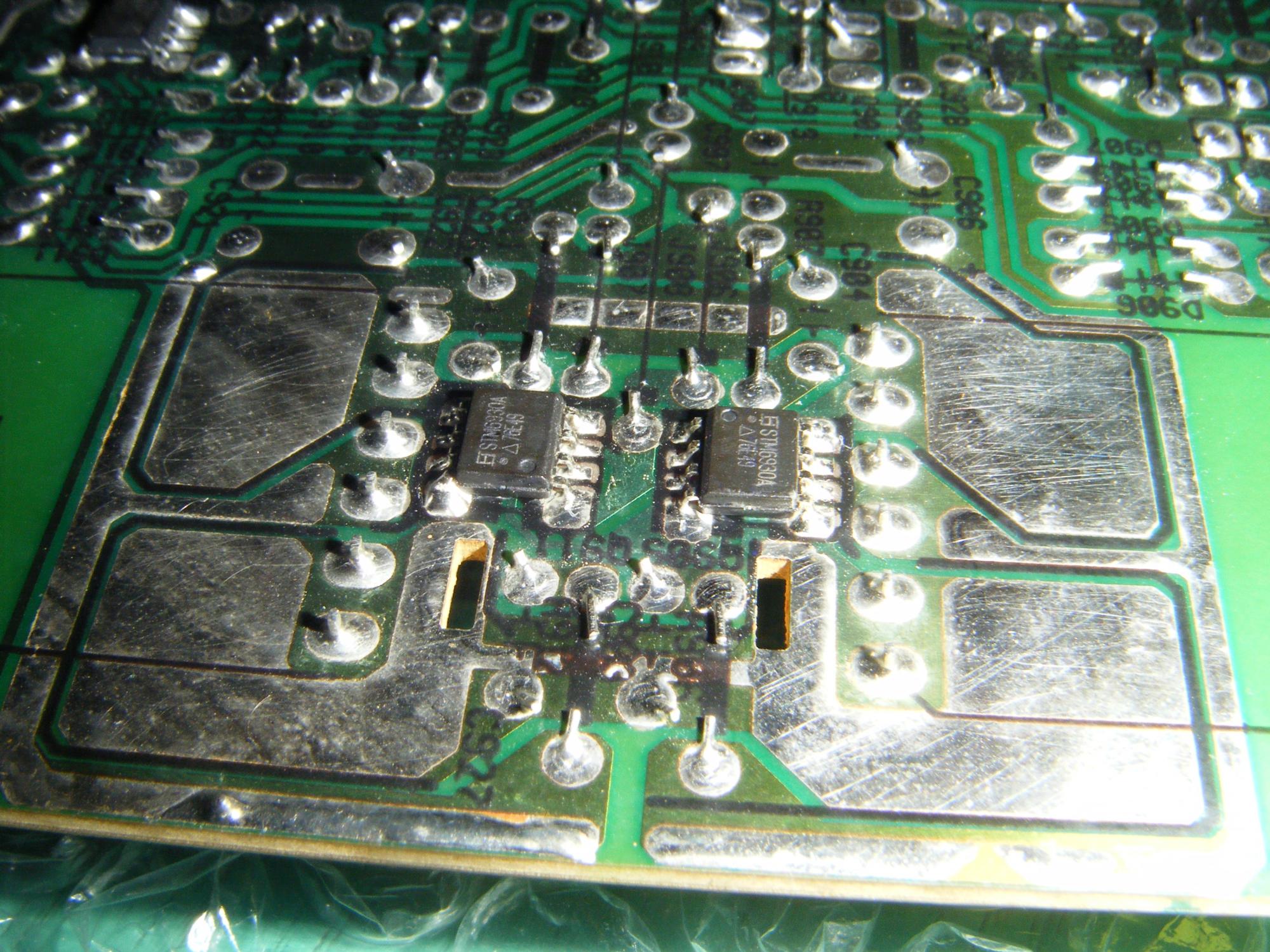

                  Upon closer inspection of the inverter section, it looks like the two MOSFETs under transformers T901 and T902 may have overheated a bit. Can you post a zoomed-in picture of that area?
                  Also, what resistance do you get between ground and either of the two rightmost pins of T901 and T902?
                  Lastly, try the light bulb trick as PlainBill suggested, and if the light bulb glows, remove L801, then give the power supply another try with it disconnected from the rest of the monitor.

                    Momaka, i have attached the photo as you requested. Pins 5-6 are all shorted together but the rest are not shorted to each other. Resistance i get between ground and either of the two rightmost pins of T901 and T902 is ERRATIC. Setting to 2000k it start with a reading of 200 then decreasing steadily. I am not sure what does the reading means. For the record the secondary winding resistance for both T901 & T902 are 374 ohms & 376 ohms respectively.
