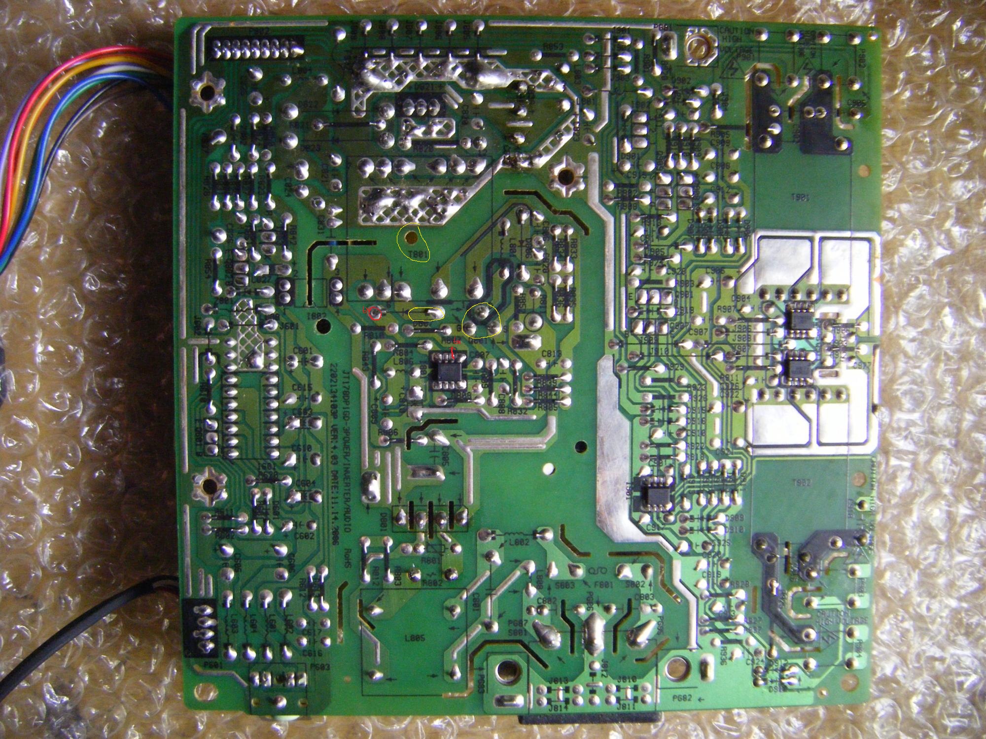

Re: HANSS 19" fuse keep blown
Sorry about that, Chief...
With one of the L801 leg lifted & using the bulb as fuse, I applied power. But no reading could be seen on any of the 9 pins of the cable linking to the signal card, with DMM volt set to 20. On the Big cap it reads 326V & VCC (Pin 6) of PWM controler (LD7575PS) is 13V.
should i resolder L801 & re-measure?.. thanks, Chief
