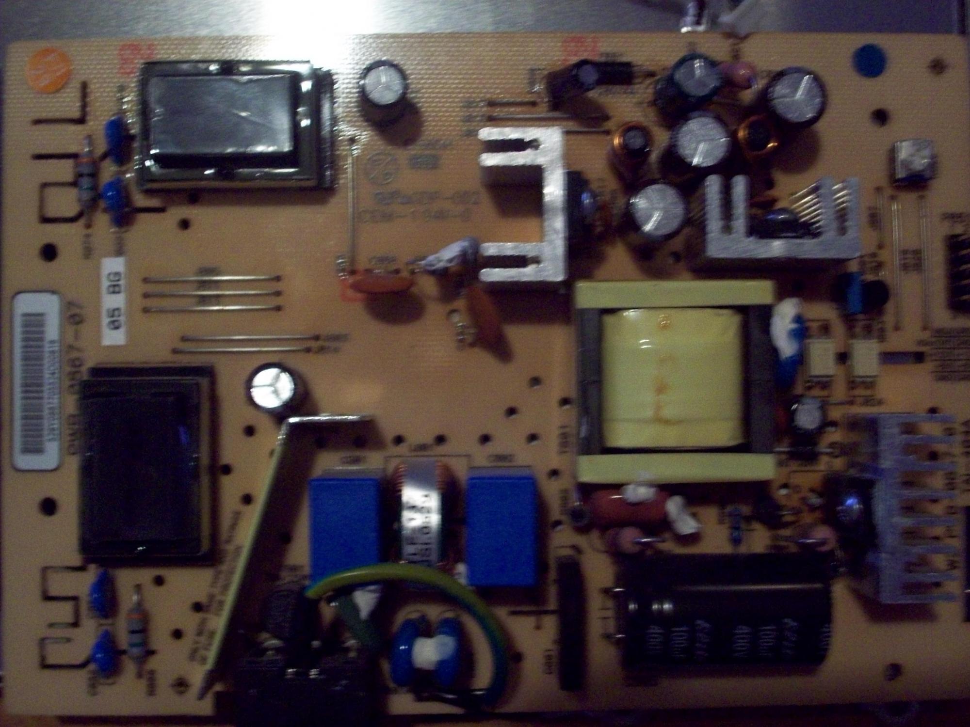

      IIRC, this model is what I describe as a 'front loader'. What you do is separate the two halfs of the bezel enough to slide a thin piece of plastic between them, then work your way around the case with another. Be very careful around the button area.
      What kind of plastic? I prefer guitar picks, others use old credit cards, even a thin bladed screwdriver (or two) will work.
      This monitor, is notorious for bad caps. Replace ALL of them in the power supply. You may have to replace those on the signal card (logic card) too.

        Well I had better luck in round 2, but lost a few plastic tabs. oh well.
        Here are pics
        Uploaded with *************
        No visible signs or bad smells.
        The 'lytic cluster in the top right of the PSU are
        x3 KZE 10v 1000uf
        x1 KZE 16v 330uf
        x1 ELITE 50v 1uf
        The two on the DC side of each Transformer for CCFL are
        KY 25v 220uf
        The three on the top right of video board are
        x2 ELITE 25v 220uf
        x1 ELITE 16v 220uf
        Should I change every capacitor or just the bigger 'lytics with vents?
        I have a FLUKE 87V for measuring.

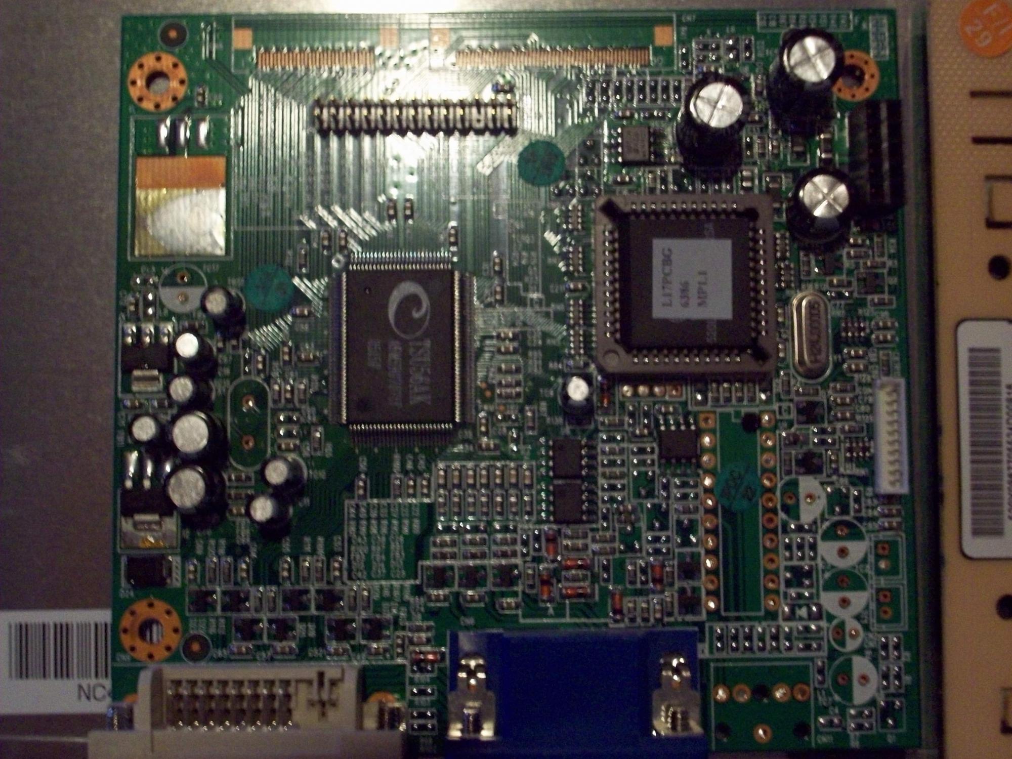

              Please follow the instructional links in PlainBill's signature to post pictures. Please do not post pictures inline.
              fixed here.
              Also reupped video h++p://www.mediafire.com/?f68bcwum9d4kjzn
              Again if anyone can help the problem is the pixels are not stable. They dance around, looks like an interference issue.
              I originally blamed the PSU, but I powered up the video board with seperate power (I kept the CCFL's powered with the original power supply) (the 10-pin header has (x2)12v (x2)5v (x4)gnd Von/off and Vadj), but still have the same issue.
              So by process of elimination, it is either the video board or
              the CCFL connections from the original PSU.
              Could it be the CCFL's or the frequency? I can measure Hz setting on the multimeter like here http://www.fonerbooks.com/test.htm. What is ideal number for this screen???
              If I start replacing caps on the video board should I replace all caps, just the 'lytics, or just the 'lytics with vents?
              Please help.

                I would start by measuring the output voltage of the voltage regulators located on the lower left side of your board. I believe these are the two 3-pin devices with their upper tab soldered directly to the logic board. With respect to ground, measure voltages of all 3-pins and supply part numbers for each device.
                If the output voltages are good, then I would start replacing the larger caps values first.

                  Re: FPD1760 700g
                  Cant find datasheets, but the part numbers are enough.
                  Closest to the DVI port and from left to right we have...
                  "5DGL
                  17-18L"
                  1. 4.955vdc
                  2. 1.800vdc (also tab)
                  3. gnd
                  "5FSL
                  17-33L"
                  1. 5.214vdc
                  2. 3.295vdc (also tab)
                  3. gnd
                  The cluster of 'lytics by the regulators are G-LUXON
                  2x 16v 100uf
                  7x 16v 10uf
                  The three vented ones are ELITE
                  2x 25v 220uf
                  1x 16v 220uf
                  I am stumped.
                  Should I Connect some powered laptop lcd inverters to power the CCFL's to completely rule out the PSU?
                  The pixels do become even more active as the monitor "warms up".
                  Or can I narrow it down to the the i/o ot the video chip (TSU56AK), but I cant find a datasheet for that either.
                  Also I have yet to mention the problem happens on both digital and analog inputs.
                  Thanks for the help ;-)

                    The 3.3V and 1.8V outputs look good. Since you tried powering up the logic board using different power sources with the same results and unless you're power supply output voltages are fluctuating, too low or high, it looks like you isolated the problem to the logic board.
                    Because of the logic board's smaller footprint, the manufacturer has to use physically smaller caps. This involves cramming a large cap value into a small can, which can dry out more quickly. Luxon and Elite have poor records and I would first try replacing the 220's followed by the 100's. Of course, it's your choice.
                    Also, I agree with PlainBill that the power supply onthis model is notorius for bad caps. Even if the output voltages check good, consider replacing all the smaller caps,except for the large 450V one.

                      .... unless you're power supply output voltages are fluctuating, too low or high, it looks like you isolated the problem to the logic board.
                      Since the board needed +12 and+5 volts I thought it would be a no brainer to use a PC PSU.
                      ... I would first try replacing the 220's followed by the 100's. Of course, it's your choice.
                      I am in debt to you. what is you paypal? ill buy ya a beer-cheers
                      Replaced all the polarized caps on the video board and everything works!!!
                      I tested each one with my capacitance meter.
                      3 of the 7 16v 10uf were reading less than 7uf and the other four were between 8-9uf. one of them were completely open.
                      the 100uf's were reading around 80uf
                      the rest were reading fine, but this was just capacitance not ESR.
                      Again thanks jetadm123 for some direction.
