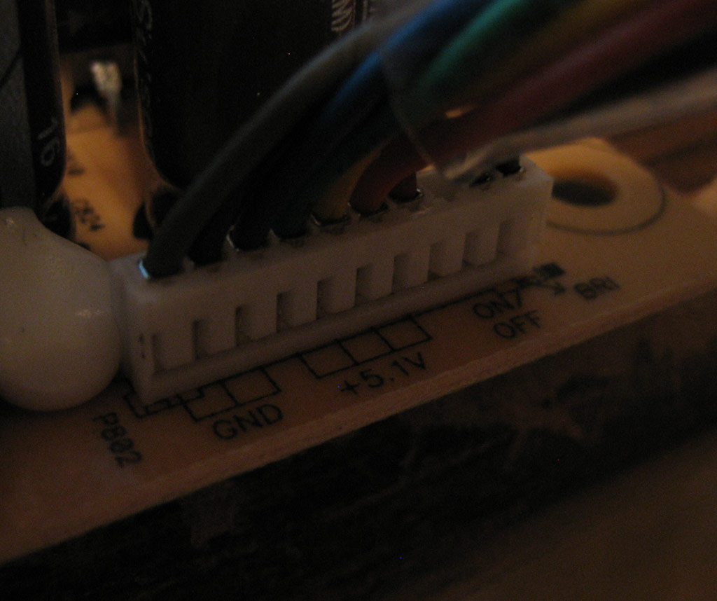

    I have a HP W2007 LCD 20" monitor. Some day i was playing a game and my screen turn all in full white screen.
    I was searching for a solution but no luck.
    I opened the monitor and check capacitors and seems to be all ok.
    I check the voltage in the power board (E131175) in P802 cable, the board says 5.1 V in 4 points but my multimeter says there is 5.9v in each of the 4 points. the Is this ok?
    please help me!
    sorry for my english :P
  • retiredcaps
    • Apr 2010
    • 9271
    Re: HP w2007 white screen problem
    A few people in the last week have been using multimeters with low or near dead batteries. This gives poor and inaccurate readings.
    As a test, put your multimeter on the lowest ohms setting (probably 200). Touch the red and black probe together. You should get something less than 1.0 ohms. If not, check/change your battery and/or reseat/clean your probes.
    If you do get less than 1.0 ohms, then 5.9V DC is too much for a connector marked 5.1V DC.

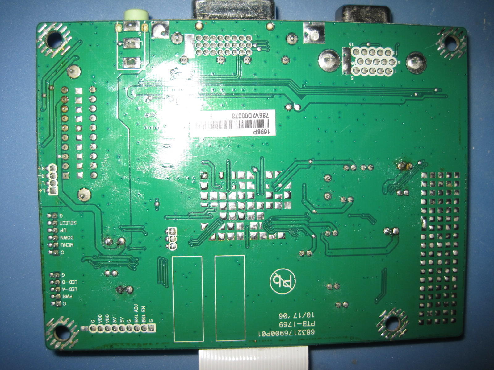

    • pcjiet
      • Dec 2010
      • 13

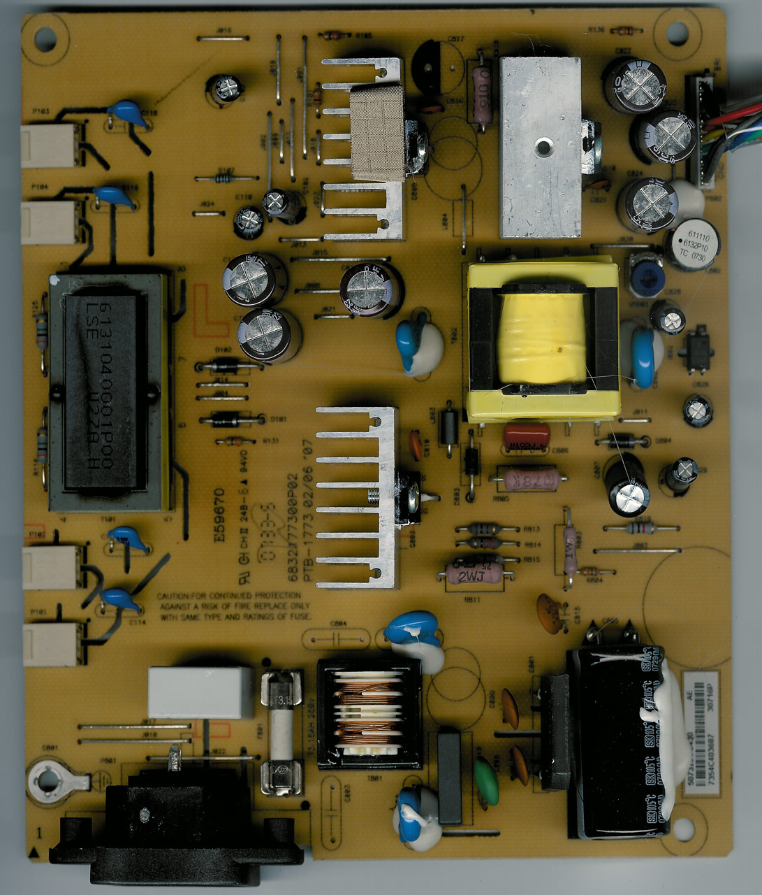

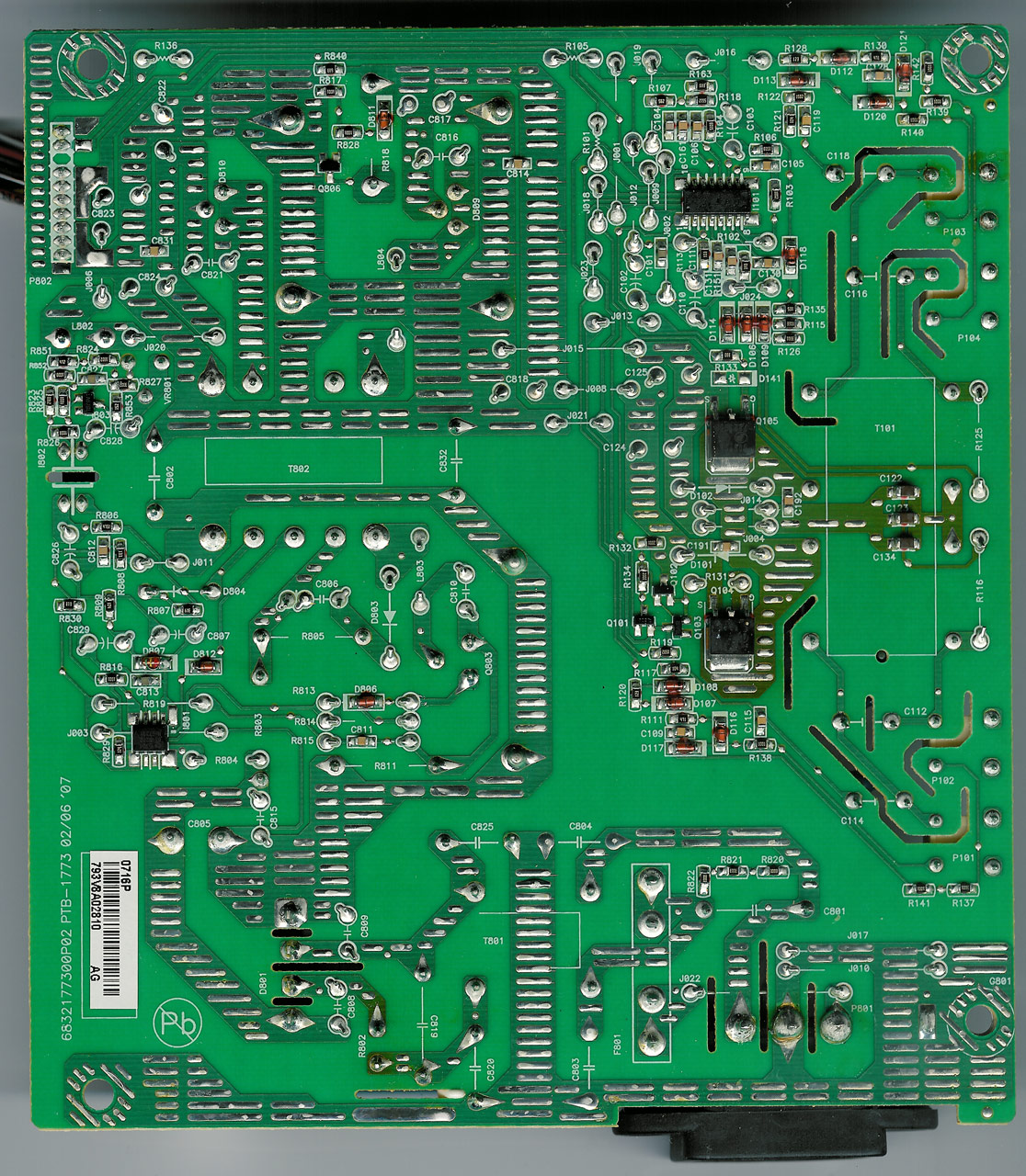

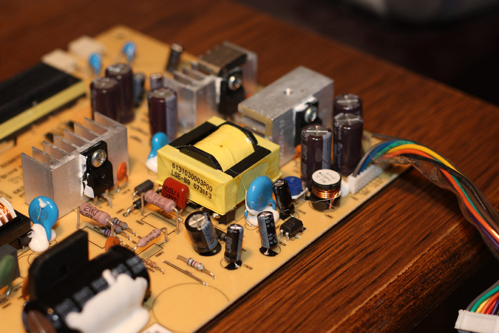

      This are the pics, do you think its the power board? or mabe the logic board?
      • retiredcaps
        • Apr 2010
        • 9271
        AARRGHHH. Please do not post pictures inline as they slow down the loading of pages. Please use the edit button to fix this.
        Please post pictures of the logic board, but NOT inline. Also the logic board connects to the lcd panel. On this panel, there will be a pcb. Please also post those pics.

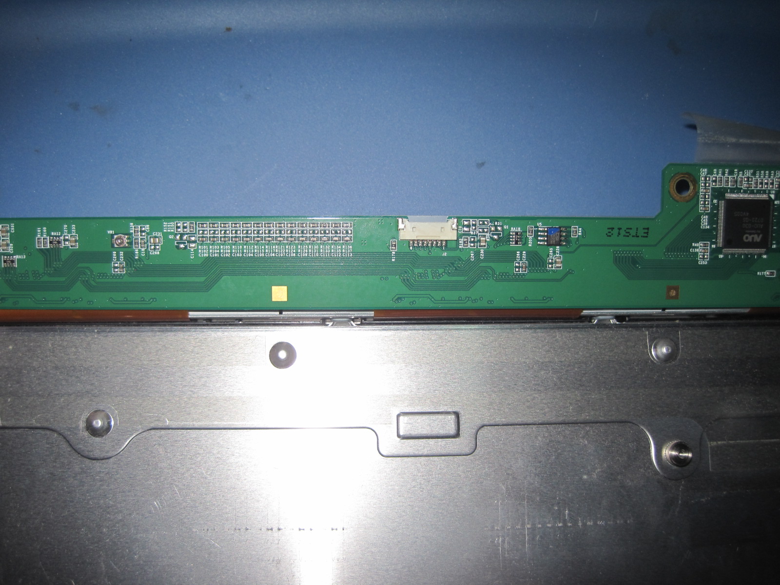

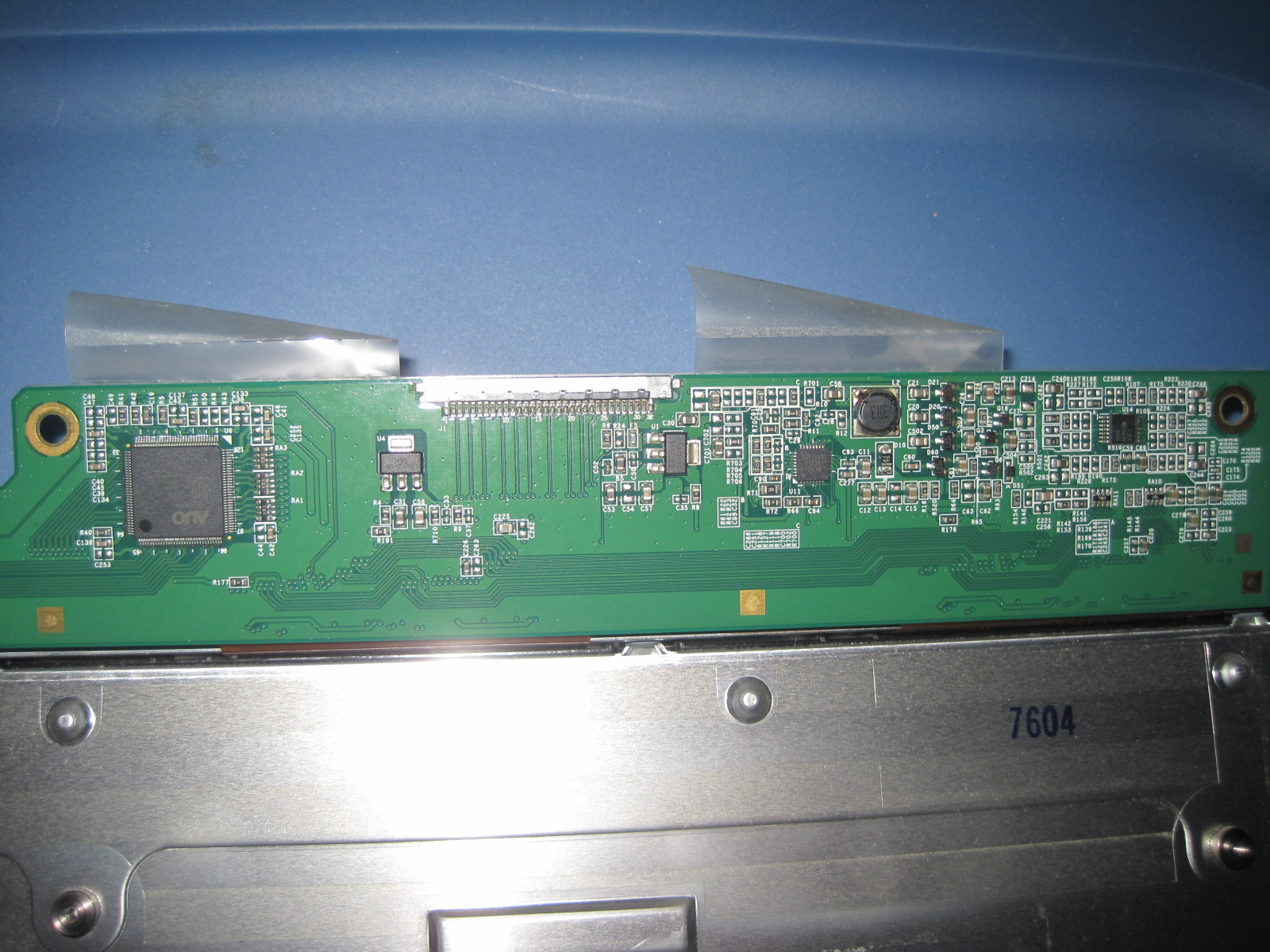

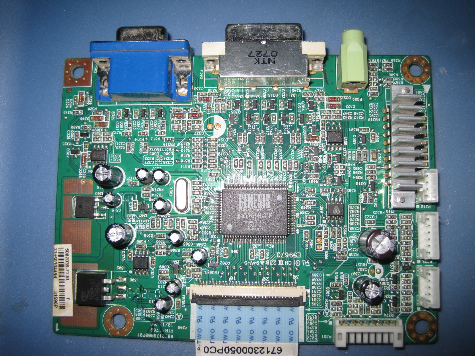

        • pcjiet
          • Dec 2010
          • 13
          here are the logic card and the pcb... in the board atached to de LCD screen, i check in diode mode the F5, i think is a fuse and there is infinite resistence, mabe is the bad one. But what about the 6v in the marked 5.1v spots?
          • retiredcaps
            • Apr 2010
            • 9271
            F5 is a fuse. I usually use the ohms test instead of diode. In ohms, a good fuse should measure less than 1.0 ohms.
            Regarding the 6V, please refer re-read the first 3 sentences back in post #2 and post the results.

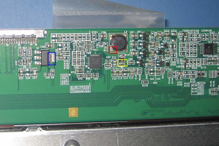

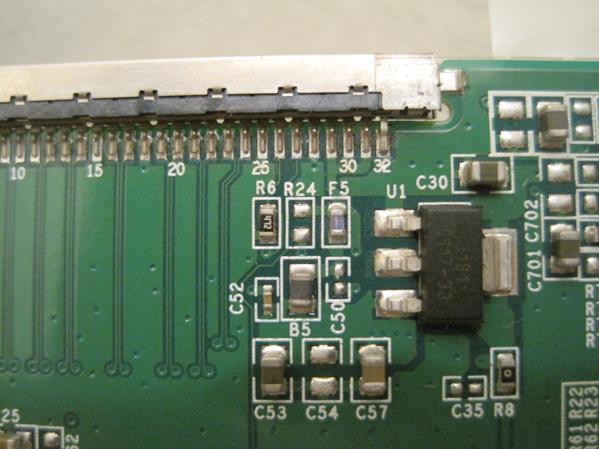

                            • pcjiet
                              • Dec 2010
                              • 13
                              this is the pic of the fuse (F5) there are no marks on it, its just blue, in the pic you can see the little cable burned or opened inside the fuse.
                                master hoarder
                                • May 2008
                                • 12175
                                • Bulgaria
                                but how can i get another of those tiny fuses, whats the value or the amperage?
                                My guess would be under 2 Amps based on what I've seen in other monitors. Not sure about exact rating, though. You can buy those fuses at Mouser or Digikey. Probably best to buy a few dozen with different ratings in the range of 1 to 2.5A.
                                Before you replace the fuse, however, there are a few other things you should check on the panel board.
                                1) Measure resistance between ground and the inductor L2 ("3R3") (circled in red)
                                2) Measure resistance between ground and cathode side of D10 (circled in yellow).
                                3) Check D10 with diode test on your multimeter.
                                4) Measure resistance between ground and the tab of U1 (circled in blue).
                                Post back what results you get for above measurements.
                                Also, what are the marking of chip U11?

                                  4) u1 check: in range of 20k ohms marks: .45
                                  - u11 chip: AAT1164C, AC2082, 0650
                                    master hoarder
                                    • May 2008
                                    • 12175
                                    • Bulgaria
                                    2) D10 catode: multimeter in range of 200 ohms marks 21, in range of 20k marks 0.00
                                    21 Ohms seems low. Looks like something could be shorted on the main boosted voltage rail, then. I just repaired a monitor like that 2 weeks ago (Samsung SyncMaster 931B). Problem was a shorted ceramic cap (it was showing ~30 ohms - ceramic caps should appear as open circuit when measured on a multimeter).
                                    U11 is the chip that provides all of the necessary voltages on the panel board. It is AAT1164C as you stated - Google the datasheet and download it, it will be very useful.
                                    On your monitor, the main boosted voltage rail (given as Vout1 on page 14 of the datashet) is basically everything that is directly connected to the cathode of D10 (circled in yellow in picture in previous post). With that said, we (i.e. you ) have to find which component is causing the above low reading of 21 Ohms (for our purposes, I'm just going to call this reading a "short circuit" from now on).
                                    Now, If you could post a larger version of the picture just like the one I edited, that would really facilitate things. From what I can see, the main boosted voltage rail continues through two jumper resistors - R16 and R250 (the zero on them indicates they are resistors with 0 resistance - i.e. same as jumpers). It's probably best to start by removing R16 and R250, but try not to damage them since we're only temporarily removing them to narrow down where the short circuit is. Here's how to proceed:
                                    a) First remove R16, then measure again between the cathode of D10 and ground. Still getting 21 Ohms on the 200 Ohms scale?
                                    -If no, then the short circuit is somewhere down the line of R16. See step c)
                                    -If yes, remove R250 and proceed to step b)
                                    b) Measure resistance again between the cathode of D10 and ground. Still get 21 Ohms?
                                    -If no, the short circuit is after R250. See step c)
                                    -If yes, then the short circuit is most likely caused by one or more of the ceramic caps C12, C13, C15, and possibly C11. See step d)
                                    c) If the short circuit is either after R16 or R250, then you will have to find all of the components that are connected to whichever of these resistors the short circuit was after and then see if the short circuit can be further narrowed down. This can be quite time consuming. I doubt this will be the problem, though, so re-check your results again. If you end up at this step again, let me know.
                                    d) Start by removing C15, then measure resistance between the cathode of D10 and ground. If you still get a reading of 21 ohms, proceed to remove C13. Then measure again between D10 and ground. Continue doing this with C12 and C11, until the short circuit (i.e. 21 ohm reading) disappears. If it doesn't disappear, let me know.
                                    I hope I didn't scare you with this wall of text. Doing these measurements is actually easier than you think it is.
