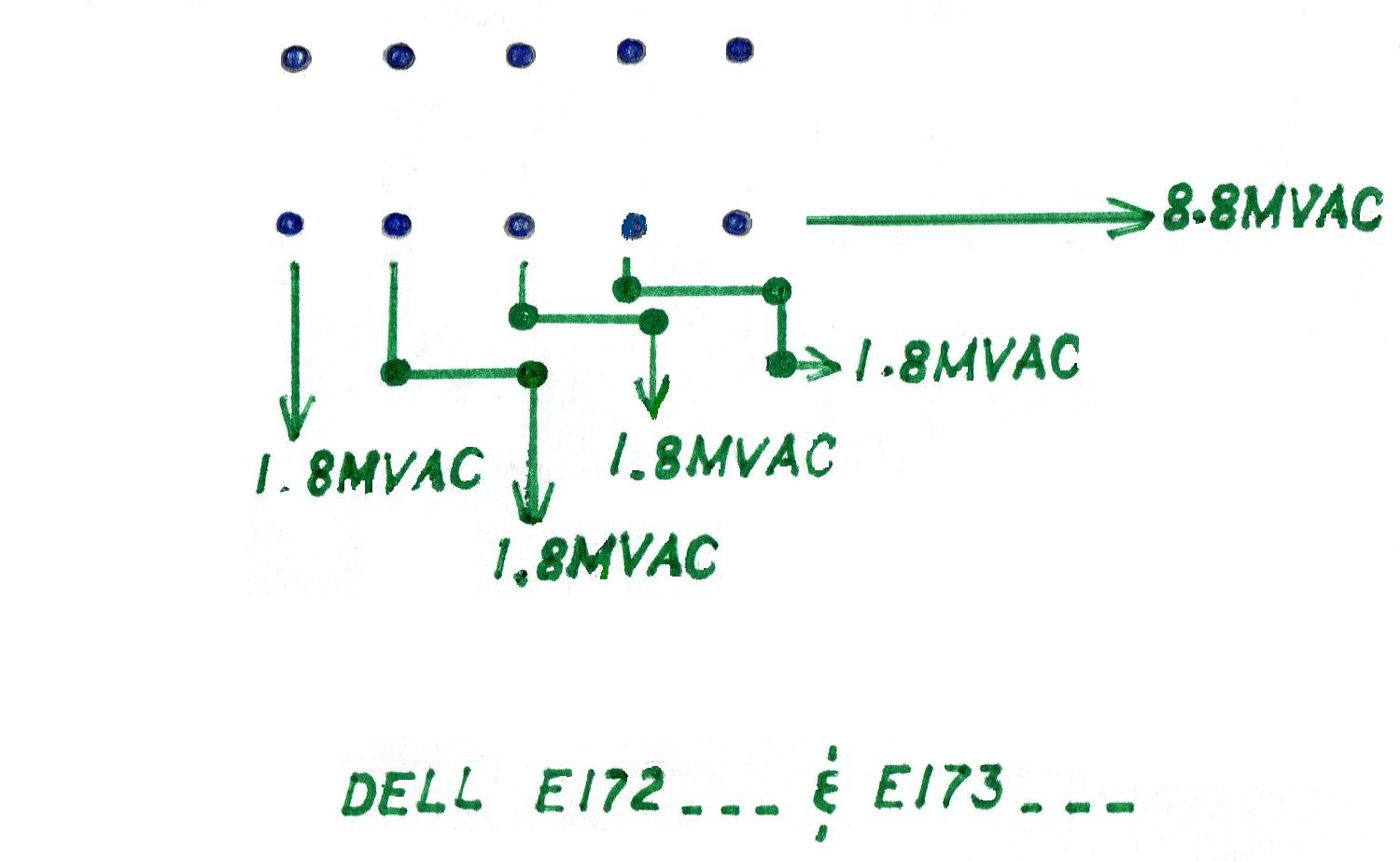

    I need ACTUAL circuit schematics for a Dell e172FBb inverter/power board. I've seen some but they never have all the parts in them? I have the following board revision numbers that I'm looking for at this time.
    48.L9202.A01
    48.L9202.A02
    48.L9202.A10
    48.L9202.A11
    48.L9202.A12
    48.L0J02.A12
    These are out there somewhere! I just haven't located them yet. I've checked and replaced all bad caps,transistors. None of the resistors appear burnt. And all of the diodes and the PF751 fuse check good. But I' still not getting the correct voltages at the union connector between the inverter/power board and the logic board? Any help that this site could provide would be awesome!
    Can you give an example of incorrect voltages? Are the voltages fluctuating or steady?
    Also, what are the voltages at the dual diode pack/Schottky?

        I have a pin-out of a working board at the connection point between the inverter/logic boards. Hopefully I posted it correctly? The voltages drop and don't recover. As far as "dual diode pack/Schottky", I don't know which part on the board you're referring too? Maybe you can tell me a part # on the board or even a picture of what you are talking about?
        Thanks Again.

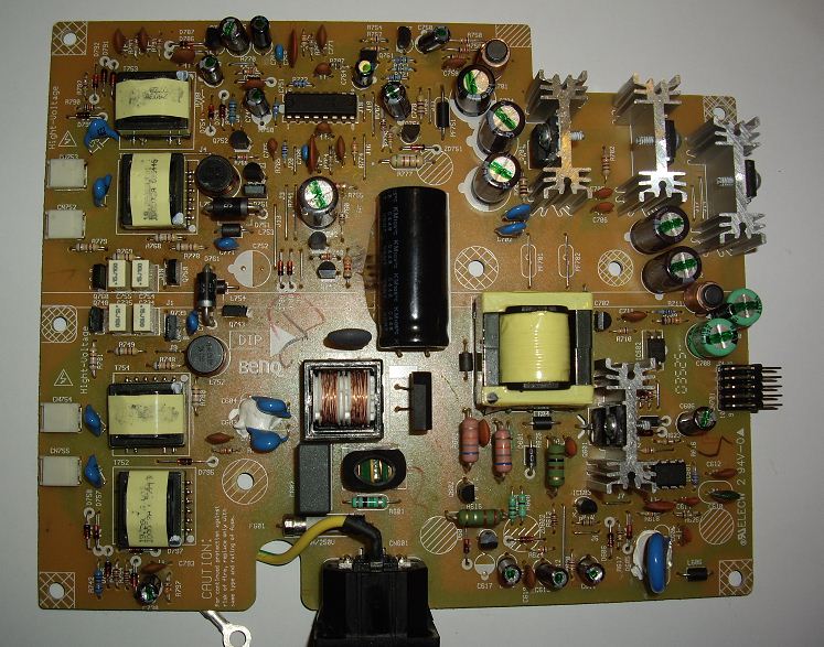

          It would help immensely if you could post photos of your board. That way, members can point exactly to the component they want you to test. There were many different versions of power supplies used on the E172-173 series of monitors and members will not spend too much time looking for pictures for you.

            Sorry for breaking the no-inline pictures rule, but ....

              Just so we are clear, the units you have listed is mvac. Is that millivolts AC? If not, what is it?
              Generally, on the connectors between the inverter and logic board, we are measuring DC V. Some board will have the voltages printed right on the PCB.

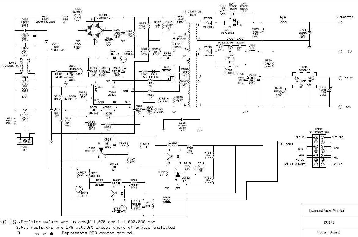

                Re: Dell e172FPb Actual Schematics
                Not sure if this will help its the only one i have but there are a lot of revisions on this unit so this one may not be correct

                  The readings I got at CN701 were in millivolts AC! I checked all electrolytic caps. And replaced where they were bad. I replaced all (4) C5707 and the (2) FU9024N transistors. I even checked the main fuse and PF751. I also checked all of the diodes. And all of the other transistors on sinks as well as just regular transistors without sinks. The only things that I didn't finish checking were the resistors as seen in the one A10 picture. I fixed one e172FPb with replacing just the (4) C5707 and the (2) FU9024N and PF751 fuse. And its still working well several months later. But before that monitor I never tinkered with an LCD monitor before. So I have alot more to learn thats why I'm here on your site!
                    At that connector, we want to measure DC V. Typically readings for Benq style boards are 5V and 12V DC.

                        Use the manage attachments button to upload pictures. It is documented in the FAQ link I posted above.
                        I did try measuring DC at the union between the two boards. I went from left to right. Measuring top and bottom pins as a set all the way across. Is there a different process for measuring the voltages at that point?
                        To measure DC voltage, put your fluke on DC voltage. Put all your boards together with the ground screws back in. Put your black lead into the COM. Put your red lead into the Volt.
                        Put your black probe onto a ground screw near the connectors. Put your red probe on each connector. All these voltages on the connector are typically less than 19V and will not cause a problem for Flukes.

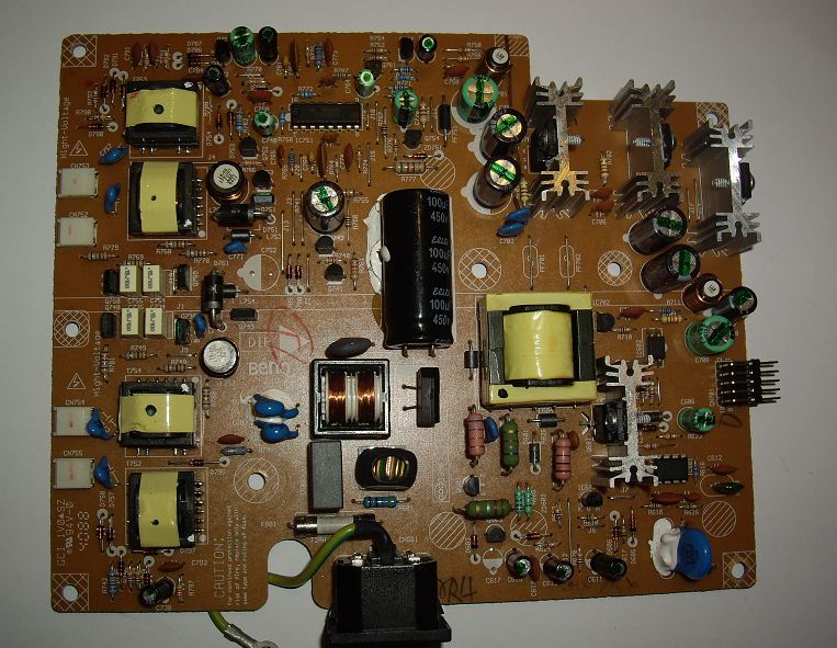

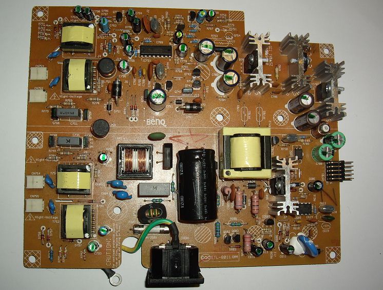

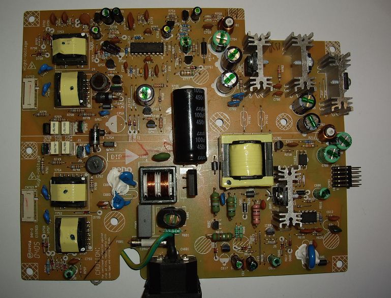

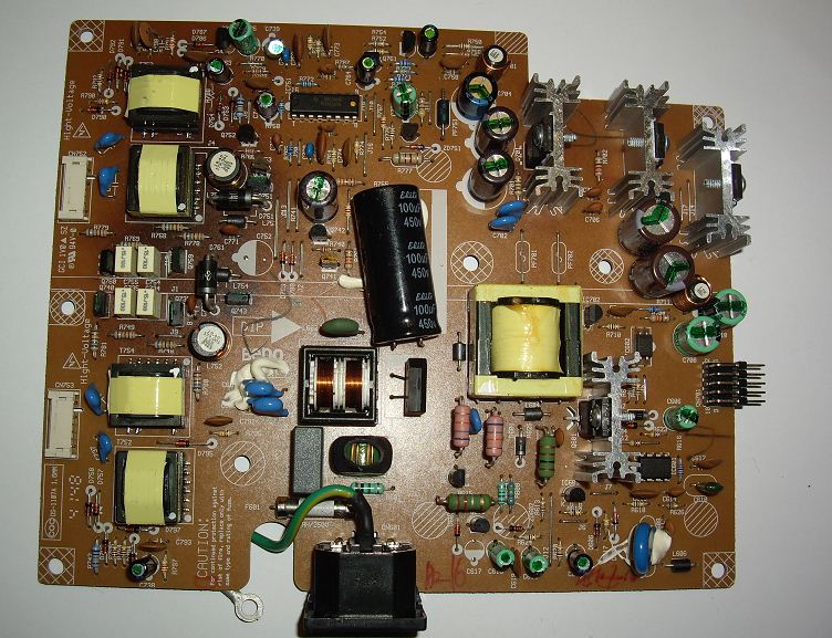

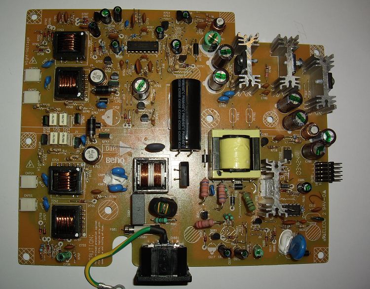

                                • lcdman
                                  TinkerTech
                                  • Nov 2010
                                  • 232
                                  • U.S.A.
                                  Hello Yet Again,
                                  I smoked a logic board. Since then I've been trying to get a working monitor. Maybe there was a short? I think that the pictures will work now. Sorry for the delay. I said that I was new to this site! Thanks again for all your wisdom.
                                  Till Next Time,
                                  lcdman
                                  • PlainBill
                                    • Feb 2009
                                    • 7034
                                    Hello Yet Again,
                                    Till Next Time,
                                    lcdman
                                    You don't follow instructions very well, do you? Those pictures are too low resolution to be useful. It's just as well you also omitted pictures of the bottom side of the board.
                                    You 'Smoked a logic board'. HOW did you smoke it? And why are you posting pictures of the power supply?
                                    Here are my instructions: Read the suggestions on attaching pictures. Take good pictures of the top and bottom of one of the power supplies. In your next post explain EXACTLY what you are trying to accomplish. If requested, attach the pictures.
                                    A lot of the people here started off knowing next to nothing about repairing monitors before they found this board. I am one of them. Some knew very little about troubleshooting electronics. Most knew a little.
                                    That doesn't matter. We are willing to help you, but you must also provide clear and correct information before we can help.
