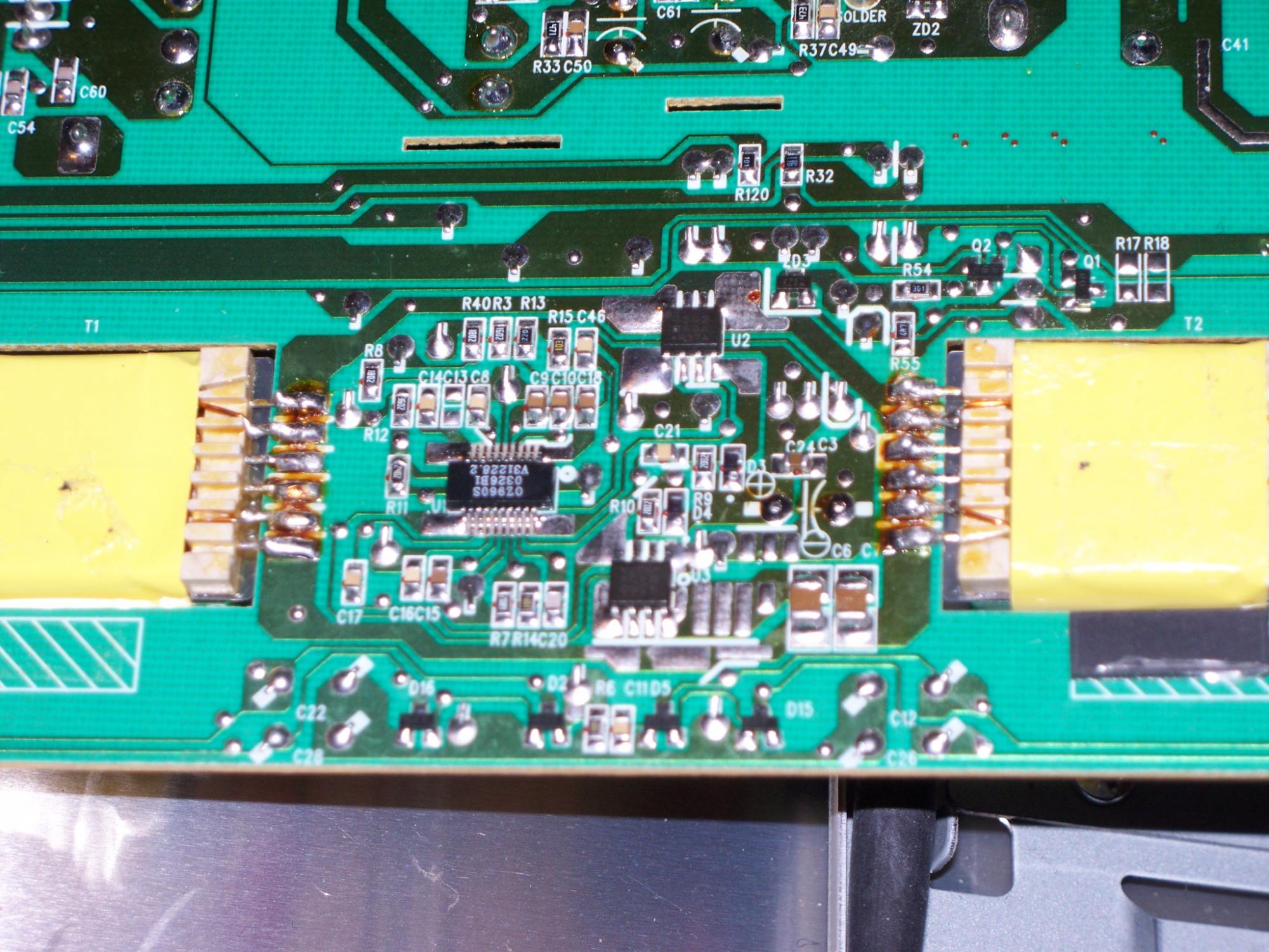

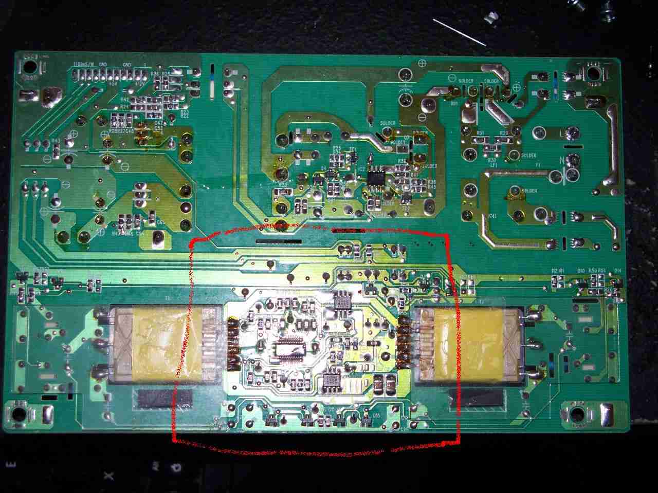

                          Can we get a clear focused close up photo (as close to 2000x2000 and without flash) of the area in red?
                          edit: What is the part number of that 20 pin IC in the red area?

                            Sorry, had to use flash, as I don't have bright house lights.
                            I think I got a clear enough photo. If not, I can try again.

                              Have you done any thing, as far as re soldering the inverter transformers?

                                Substitute one ccfl at a time again, but find a place on the back of the lcd where you can see the light of the ccfl.As you try the ccfl in each socket dose the brightness look the same on the test ccfl in each socket.
                                I am hoping this might find a area of the inverter to look at closer.
                                Al.

                                  Can you give us the part numbers for U1, U2 and U3?
                                      / = new line
                                      U1 = 0Z960S / 0326B1 / V31228.2
                                      U2 = 4542 / (logo)AD(Delta smbol) / W37A
                                      U3 = same as U2
