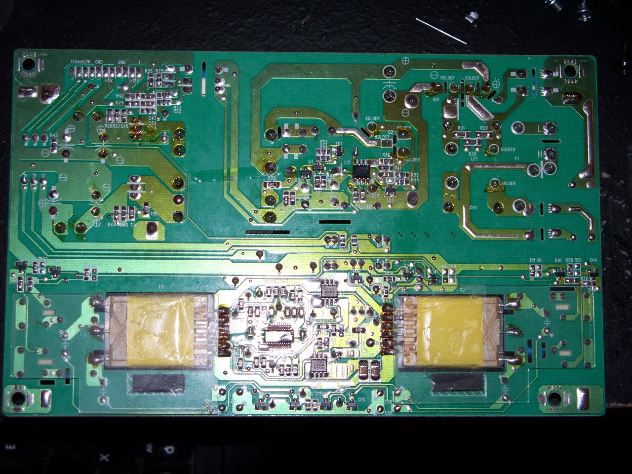

    Monitor powers on, display turns on, then off, then flickering like auto-adusting, then on for a few seconds, then more flickering, then off, then on, but with the display at the wrong resolution, then off, then flickering, etc...
    It would settle down and the display stay on after it had warmed up for a few minutes. It no longer seems to settle down.
    No visibly bad caps, and I don't have an ESR meter.
    I haven't tried a good CCFL yet. I did see another post where someone fixed this model by replacing Q207 that had gone high on ESR. Q207 is a 10uf 16V surface mount cap. It is the small cap next to the brown sleeved smaller electrolytic on the logic board.
    I did touch up the solder connections on the transformers.

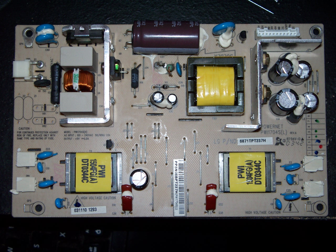

    Don't you mean C207? The designator "Q" usually specifies a transistor. Your description sounds like a cap problem. If you think that replacing the 10uf cap will solve the problem, give it a try. You can use a regular low-esr electrolytic cap in place of the surface mount one. Using a pair of pliers, bend the leads outward. If you have an old computer power supply, you might be able to "liberate" a 10uf for testing purposes.
    Also, what's the brand/series of caps on the power board? Note: Caps don't have to buldge to be bad.
      I have several new 10uf 50V eletrolytics (Panasonic) that I could use to try. If I remember right, you can go over on the voltage spec, right?
      Most are Rubycon YXG, though there are 2 Sam Young LXZ caps on it as well.
      And yes, I'm aware they don't have to bulge to be bad.

            1) replace all the small electrolytic caps on the power board with better quality ones.
            I replaced:
            3x 470uf, 25V
            1x 1000uf, 25V
            1x 1000uf, 16V
            I wasn't able to swap out a 100uf, 35V and a 1uf, 10V that I didn't have replacements for.

            I tried checking T1 and T2. I think they are ok. Secondaries are about 1K ohm. And I get identical restances for the two units.
            I also tried 1 lamp from another montior, in each of the sockets.
            Still no change in behavior.

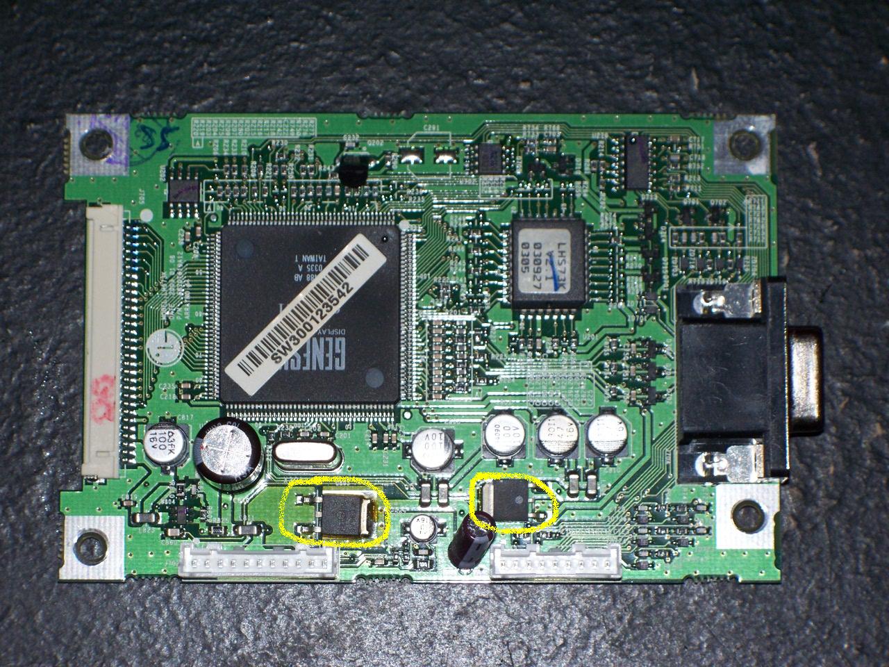

                The 1uf is probably part of the startup circuit and if bad, can cause power up problems.
                Check voltage reg(s) output. I circled in the photo what I think are the regs. I can't see the part numbers. If they are marked 1117, then they are regs. The number 18 or 33 will indicate a 1.8V or 3.3V output.

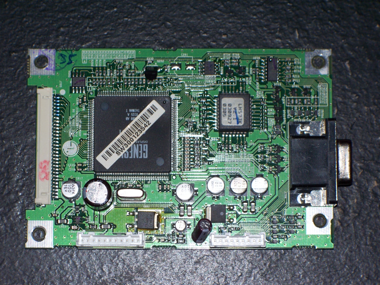

                  The one on the right is marked BA033 (second line) 37 15. I think it is this is the data sheet for it, even though I can't see a T at the end:
                  http://www.alldatasheet.com/datashee...HM/BA033T.html
                  3.36V output.
                  The one on the left is marked D 35 AG (second line) 1086D25. I think this is the data sheet for it: http://www.ic-on-line.cn/IOL/viewpdf...25_2827670.htm
                  2.48V output.

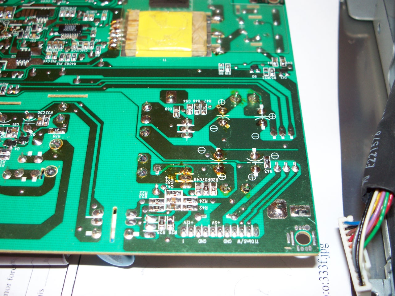

                    The legend on CN1 in the photo is a bit obscured, but if it says 12V, then 13.82V is pretty high? Was this measured with all the boards (logic and ccfl) hooked up?
                    I believe the 12V DC is for the inverter section.

                      CN1 legend:
                      +12V
                      +12V
                      GND
                      GND
                      +5V
                      +5V
                      GND
                      N/C
                      ON/OFF
                      Dimming
                      N/C
                      And yes, almost 14V out of a 12V line seems like it would be out of spec to me too. But I'm not sure where to look for what might be affecting it.
                      Yes, all boards and lights hooked up. VGA cable not plugged in though. I don't know if that will make a difference.

                        Everyone has different troubleshooting techniques, but this is what I would do.
                        1) Have the upper 4 capacitors in your picture been replaced? I know you replaced some, but I can't tell from the picture if those 4 have been replaced?
                        2) In that same area, there are 2 inductors (marked with L on the PCB). They are covered in glue. You can remove the glue. With power off and LCD unplugged, the inductors should measure less than 1.0 ohms on your multimeter.

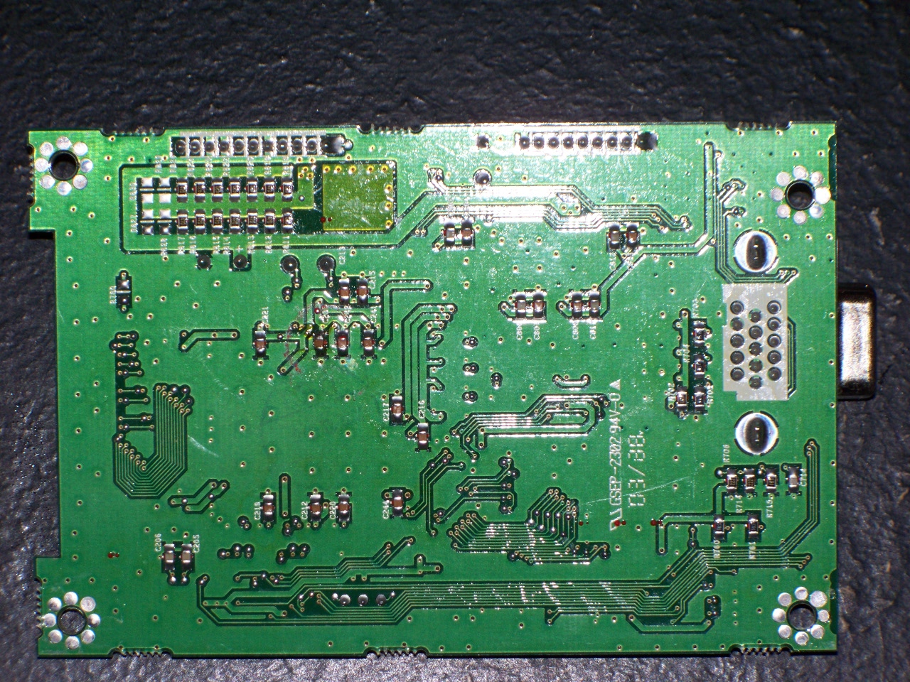

                        3) On the backside, there are 9 SMD resistors by the connector area. With power off and LCD unplugged, measure the resistance of each one. List the values and their measurements.
                        4) There are two, I believe, Schottky diodes mounted on the heat sink. With power on, put your black probe on a ground screw and red probe on the middle pin. Report both readings.
                            I'm not quite sure about the values, some of them were hard to read. However, I do see that not all the ones marked 470 read the same. Also, I attached a closeup photo of that area.
                            R22 -470 - 47 ohms
                            R23 - 195 - 560 ohms
                            R24 - 202 - 664 ohms
                            R25 - 1095 - 933 ohms
                            R26 - 222 - 935 ohms
                            R27 - 470 - 23.5 ohms
                            R28 - 470 - 23.5 ohms
                            R42 - 3907 (3902?) - 1265 ohms
                            R44 - 272 - 2680 ohms

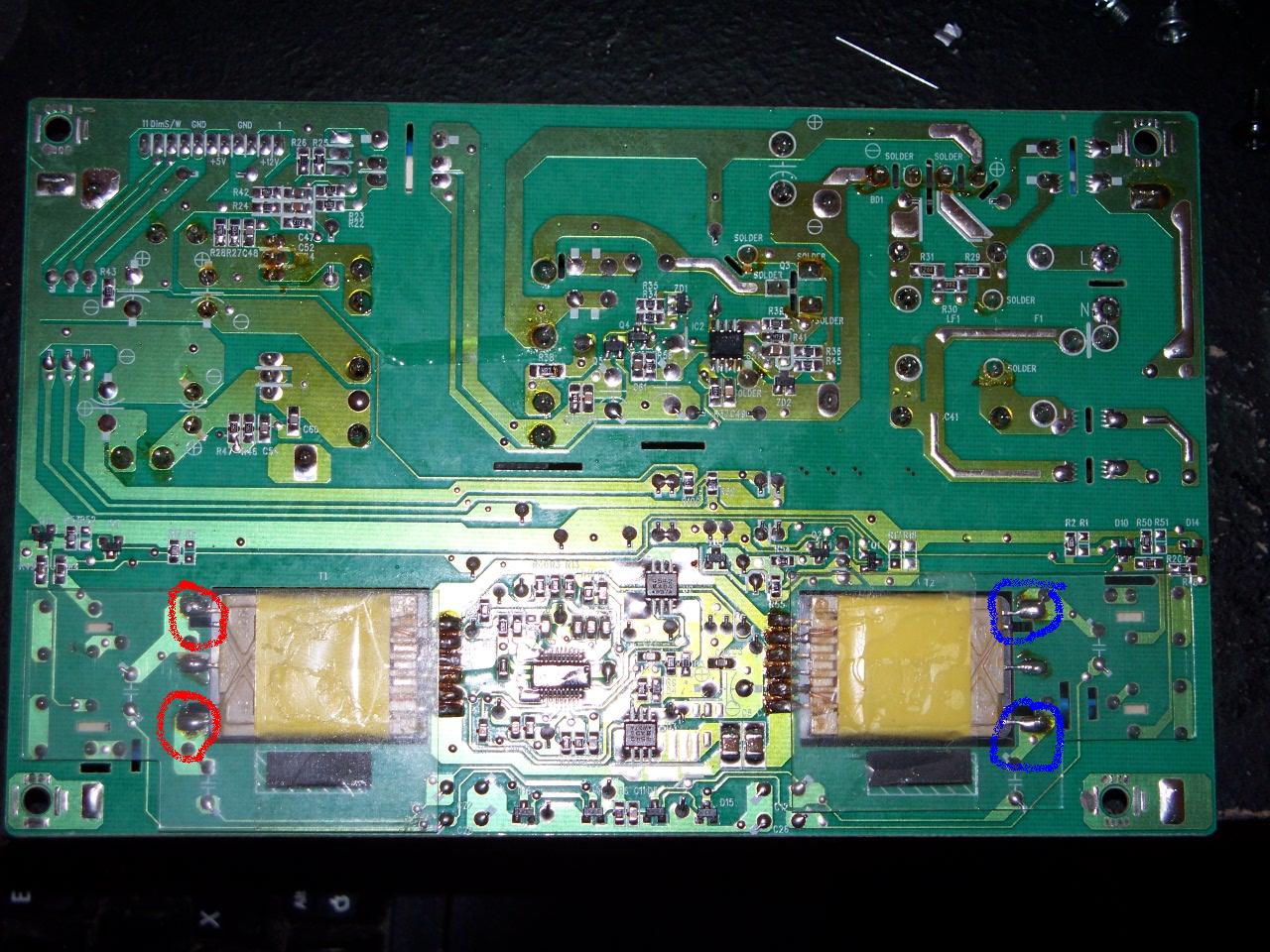

                                Try measuring the secondaries. I believe what I circled in red and blue are the secondaries.
                                Put your mulitmeter on 2000 ohms. You should have one reading for red and one for blue. Report both.

                                  Also there is a 470uf 25V cap on the logic board I can replace as well.
                                  Has this one been replaced as well?
                                    Red 974
                                    Blue 1003
                                      Not yet. I'll do it now.
                                      Edit: Crud, I'm out of 470uf 25V caps. I have 680uf 25V caps. Too much of step up in capacitance?
                                        What points on T1 and T2 did you check when you first took these readings?
