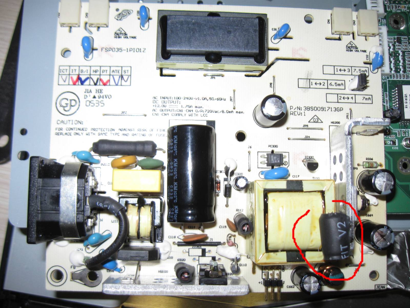

            I'm doing a Princeton VL1918 with no display and typical bad swollen caps made by 'Craps-On', and I noticed how similiar the layout, RF shield and boards are to Samsung 931B's I've done in the past. While here I have some pics and a couple questions for you vets.
            My first pic show the P/S inverter board with the bad caps and circled in red is a tough plastic sleeve, marked FIT V2, that was on the 330uf cap next to the transformer. So what is the purpose of such sleeves and should I replace it on/with the new cap ? I note other components near heat sources may have them as well. They do tend to hide and disguise a cap so look closely.

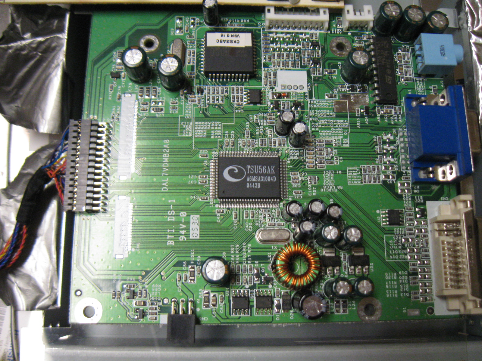

            My second pic and question is about the A/V boards found in these units. Mine has 18 caps, mostly of green with gold stripe Teapo Series SC, and some smaller caps in SH. None were replaced and LCD works fine now. The question is since I don't read a lot about folks repairing this side of the board so to speak, what do you vets say about doing so ? Some insight on what goes on in A/V circuit boards and what to do about them during repairs would be a great value to us newcomers and weekend techs as well.
            Thanks!
              Re: Samsung Syncmaster 931BF - full white screen
              I'm not sure why the plastic sleeve is used. The two possibilities that come to mind are mechanical protection, and protection from heat. Neither make a lot of sense.
              As far as teh caps on the 'A/V' board (I call it the logic board), unless there is an obvious fault, I don't touch them. They are not under the same stress as those on the power supply.
              PlainBill
                PlainBill
                I second that. No need to change them unless you are positive they are damaged/failing.

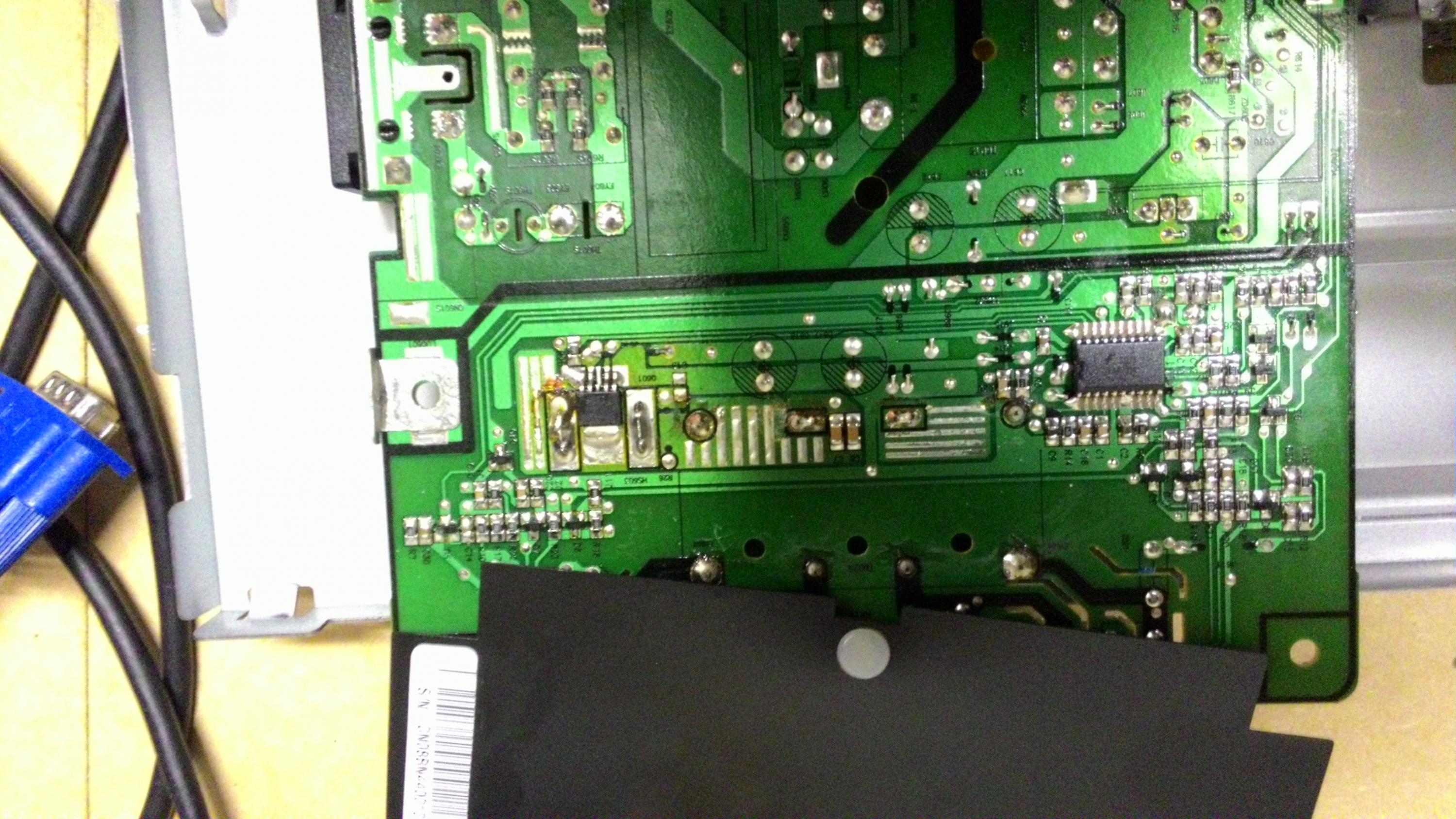

                  I'm guessing the panel in this monitor is a HannStar. Just fixed two of these with a white screen this week - one was a SyncMaster 931B (fix to be posted in a few days). In both cases, it was shorted ceramic caps (in different parts of the circuit, though). The two I fixed had a slightly different layout than yours, but overall they have the same basic design.
                  With that said, I think the first thing you want to get is the AAT1164 datasheet (component U11) - this is the IC that controls/produces voltages for the LCD buffers. The datasheet will give you a pretty good idea of the circuit.
                  Next, power on the monitor and see if U11 gets hot at all. If not, see if D10, Q6, Q16, D20, D21, or D60 get hot.
                  If not, check the voltage with your multimeter between ground and the little pad labeled "AVDD1" (this is "Vout1" in the datasheet). Could be anywhere between 5v and 28v, probably closer to 10v-13v.
                  Let me know what results/readings you get.

                      Sorry for the delayed response.
                      The panel in the Samsung 931B is HannStar HSD190ME13-D10 Rev:2. Problem was a shorted ceramic cap on the boosted 12v rail on panel board (this would correspond to "AVDD1" on vrga's monitor).
                      The other panel is from a HP w19b monitor, and it's a HannStar HSD190MGW1-B00 Rev:1.
                      Hope this helps.

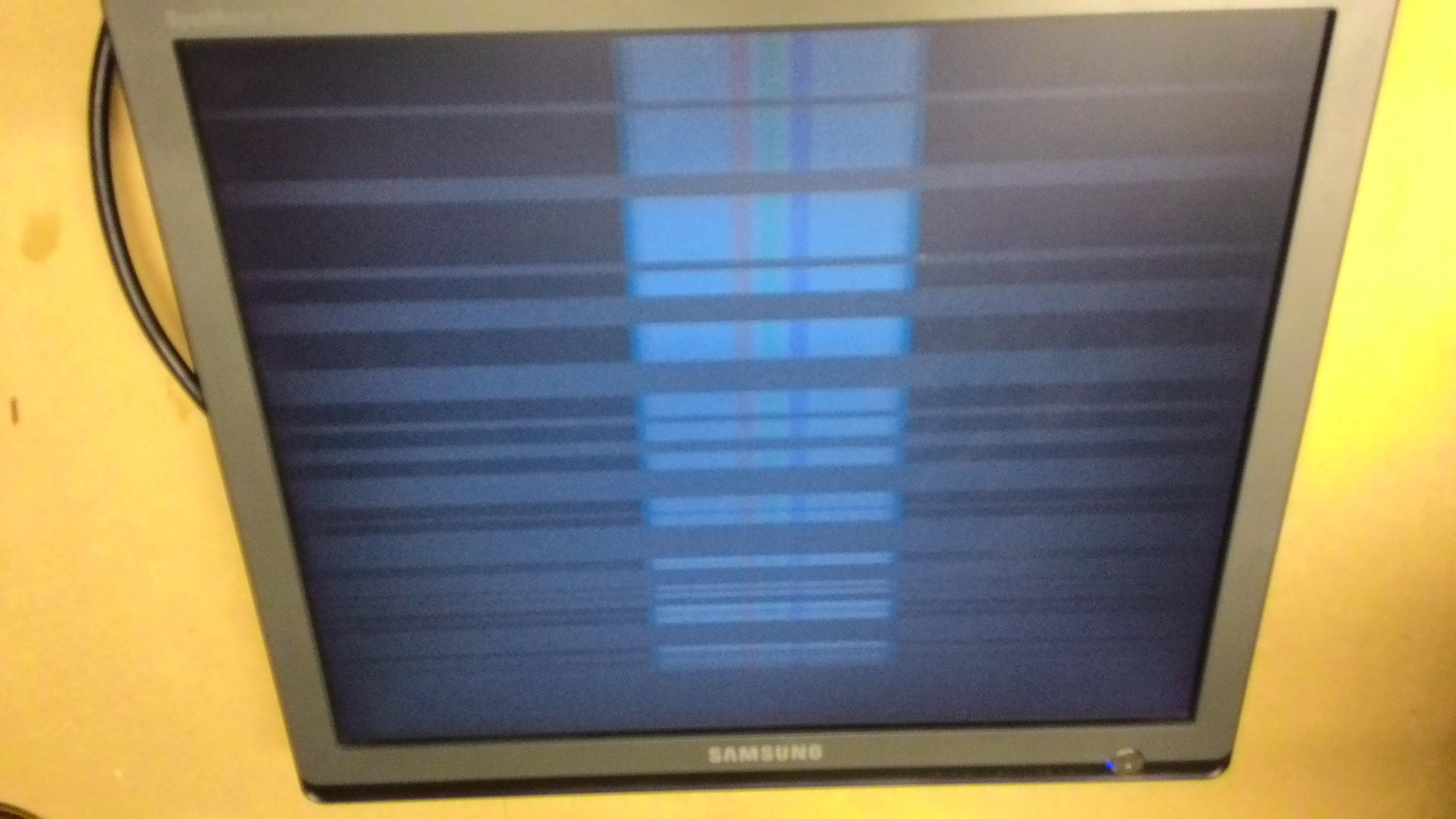

                              Hi Guys,
                              I have a Samsung 931BF with all lines and distortion on screen when powered up, without any display cable plugged in - see Pic1.
                              I disassembled, took out the main pcb, and could no sign of any burst capacitors or heat damage.
                              The only thing I saw was some marks on the back of the pcb - see Pic 2 - which I cleaned off and reassembled to test, with no change, still the same lines and distortion.
                              I am just wondering if anyone has seen similar lines, and if so was it the capacitors, or the transformer.

                                  Hi A43,
                                  the problem you're having could be caused by many things: bad caps, bad connection on the LVDS cable between the logic and t-con boards, or bad tab bonds on the LCD panel. Therefore, I suggest you post more pictures, especially of the power supply top side and logic board top side. Also, clean the LVDS connector with some IPA (Isopropyl Alcohol).
