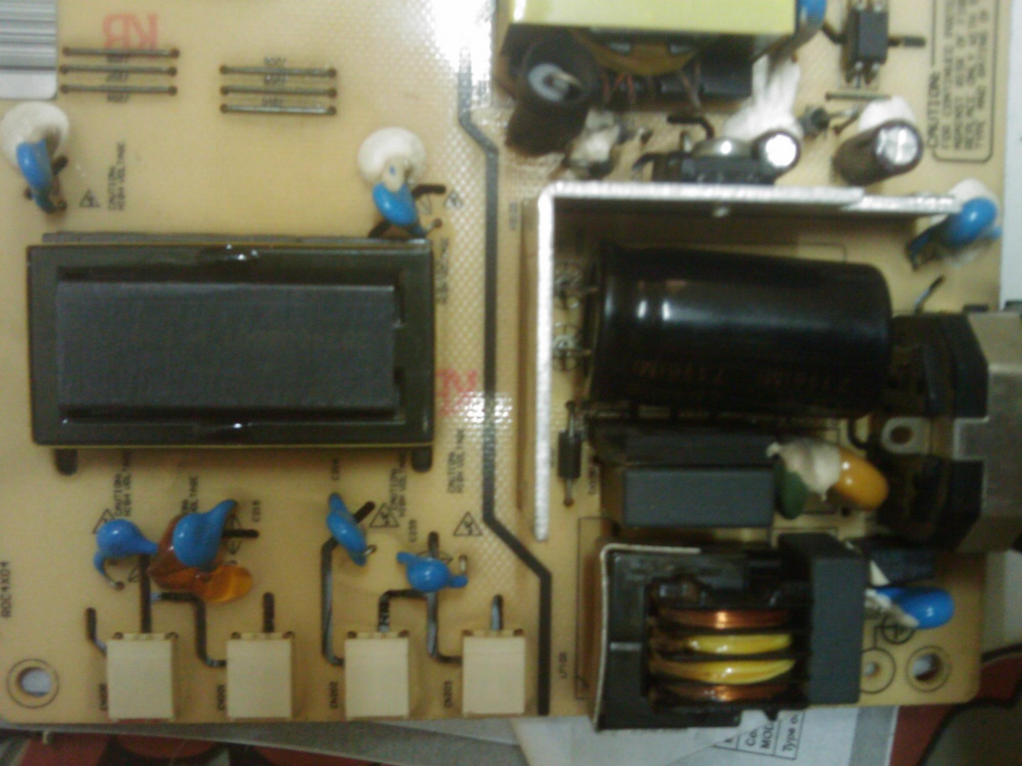

    Hello everyone..
    My name is Ashwin, and i am from india.. I have been using my lcd for 3-4 years.. and it suddenly died on me.. (I think the backlight, as I can see the image if i put a flashlight on the screen).. I removed the power board and replace all the barrel-shaped capacitors.. 4 were bulged..
    Now, it still does not work.. The image is still seen, very dimmly, but otherwise, it does not work.. The power board is dac-19m011.. Kindly help me out.. I will post pics as soon as I can.. Thank u everyone,

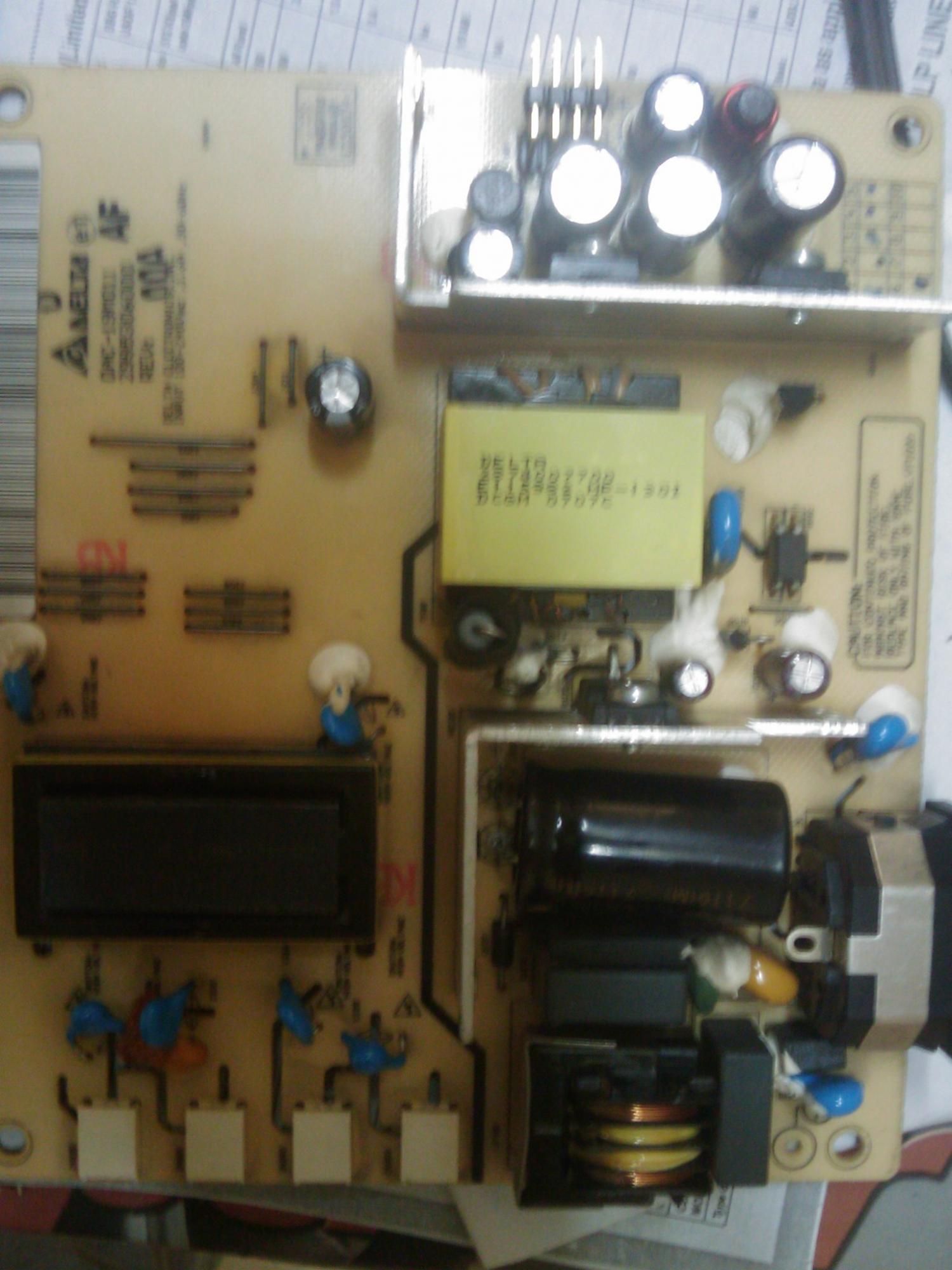

    Hi.. I m uploading the pics.. Sorry for the quality..

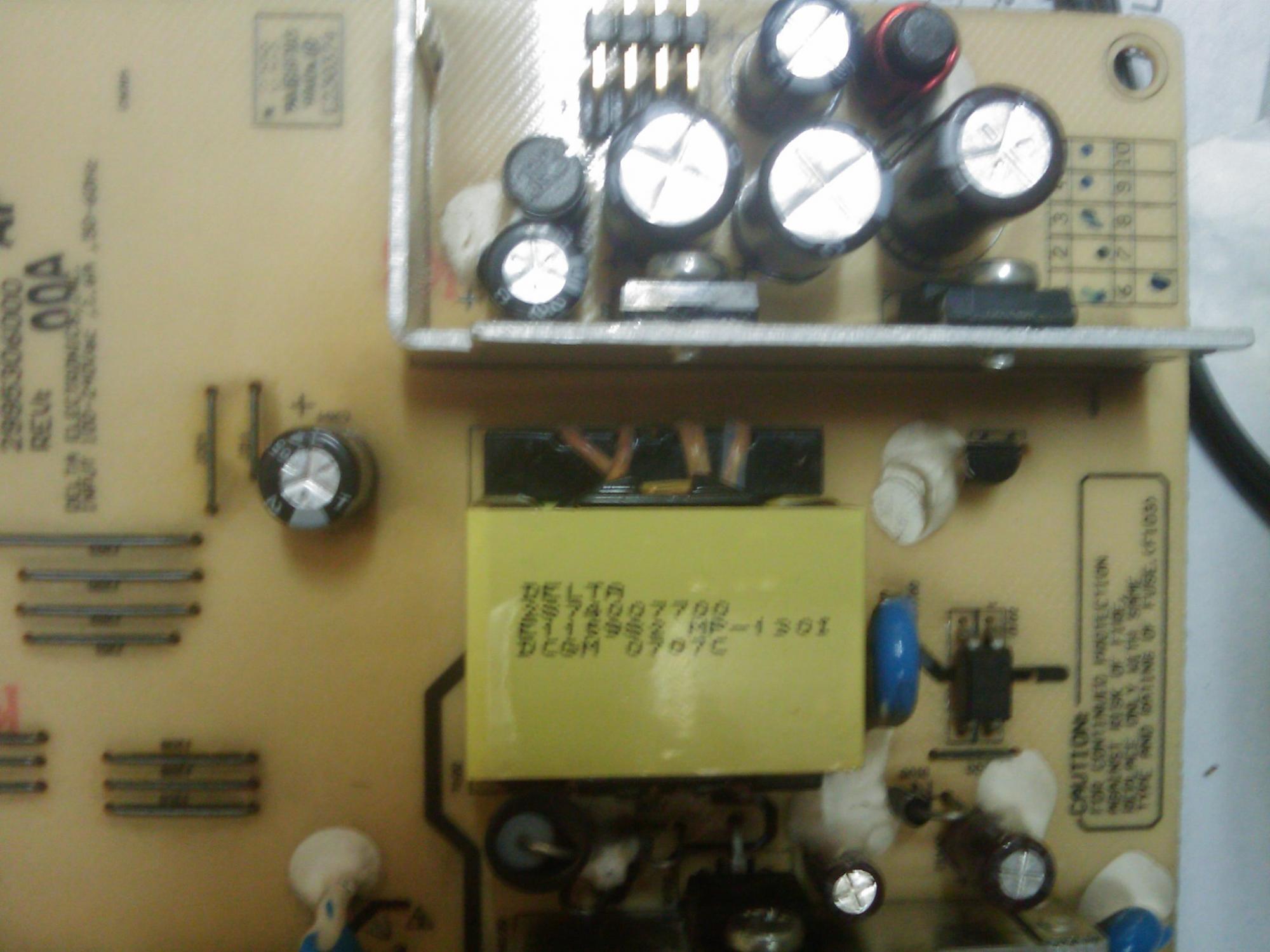

      Questions: what brand/series of caps did you use to replace? I count 9 caps, did you replace all of them or just some? Is there a fuse for the inverter (probably a surface mount on the backside), and have you checked it (continuity check, open reading = bad)? It will have a reference designator beginning with F (Fxxx).

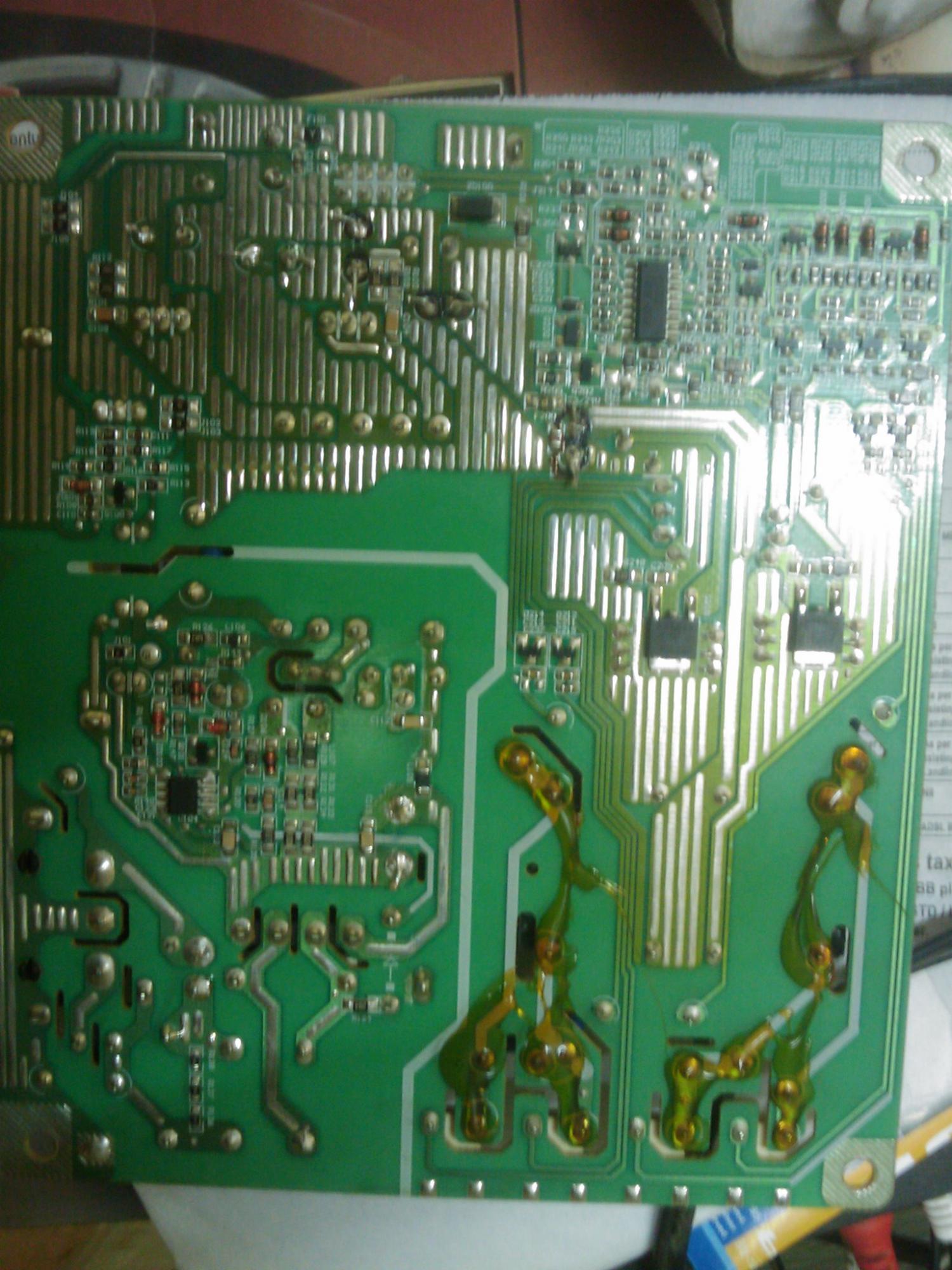

        The quality of those pictures is really bad; that makes it difficult to help you. Top, at about 11 o'clock on the last picture is an SMD device, F101 that is probably the fuse for the inverter. Check continuity on it.
        At the right side of the same picture at about 3:00 o'clock are a pair of SMD transistors. They are the drivers for the inverter. Are they shorted.
        Wrog is right, what capacitors did you use as replacements?

          @Wrog: please bear with a noob.. I could not get the panasonic ones, so I used another brand available here.. Its called TEAPO.. The ratings were the exact same as the blown ones.. Yes, I replaced all the caps, except the blue ceramic ones, which I dont get here.. But, all the other cylindrical caps are replaced with high temp caps of same ratings..I replaced only 8 which I could see.. I thought the fuse was the thing next to the mains connector.. Oops.. I have not checked that.. Seems hard to desolder and resolder.. is it??
          @PlainBill: I will check continuity on the fuse now.. And how do I check if the smd transistors are shorted? Same as checking continuity? I mean open = bad?
          Would it be better to replace them both? Also any idea about their values?? THank you both for your replies..

            Note that Teapo is on the Bad Capacitors List (over in the FAQ subforum), but if you matched them up properly in terms of ESR and ripple capability it would not prevent it from working (it just won't work for that long). If you did not match them up properly, that's a different story. If possible, please list the series of the Teapo caps you've used (this is usually a 2 or 3 letter marking on the cap) and someone can check the datasheet(s).
            The ceramic caps don't need to be replaced unless they are visibly damaged. The 9th cap is probably the huge one laying on it's side next to the mains. This also doesn't need to be replaced unless it is visibly damaged. You are right, there is a fuse next to the mains, but there is usually another for the inverter. If the fuse next to the mains was blown, you wouldn't even get a power LED so it's probably still good. No need to desolder the fuse in order to test it.

            You'll want to test the transistors using a resistance check between all legs (1/2, 1/3, 2/3) and report back what the values are... anything low (under 10-20 ohms or so) indicates a possible short. If this happens, you'll need to remove them from the board and test them again. If they still show a possible short, they need to be replaced. Make sure to record their markings before you removed them in case they are damaged. From time to time, it's difficult to remove these because sometimes they are glued to the pcb in addition to having their legs soldered. Post the markings here so that a suitable equivalent can be found.

              Fuse: Set DMM on 200 ohms scale. Measure resistance across fuse. Less than 1 ohms is good, > 5 ohms is open; in between short the leads of the dmm together and check your reading. It should be less than 1 ohm.
              Transistors. Set the DMM to the 200 ohms scale. As Wrog says, measure the resistance between all pins on the transistor. If all read < 10 ohms, no need to pull the transistor yet, it's bad.

                SMD1
                9973gh
                g25191
                smd2
                9973gh
                g25151
                The smd2 surface looks a bit blurred, could it be due to damage?? The letters are not clear and the plastic itself looks duller than the smd1.. Also, should the smd values be the same??

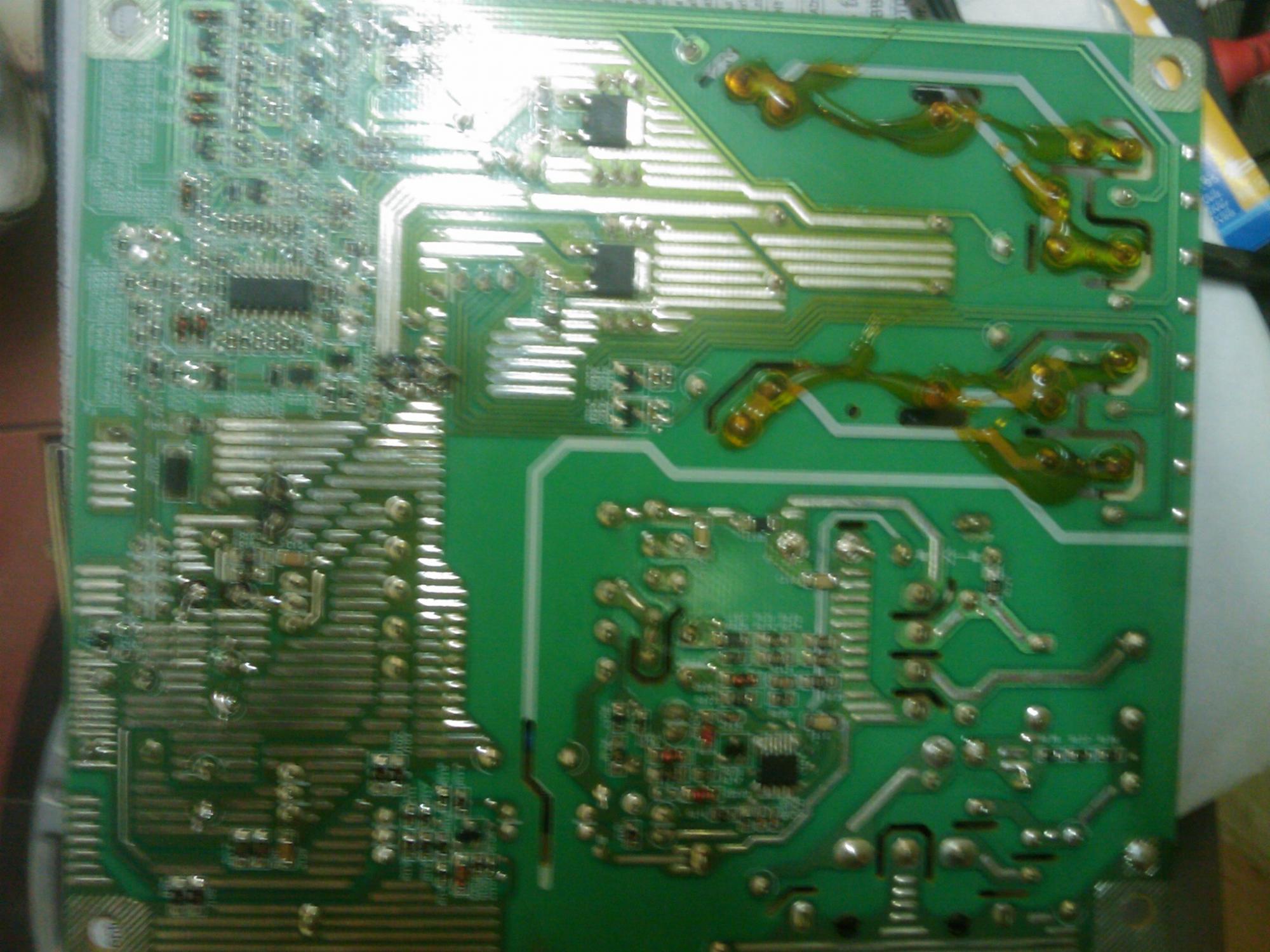

                              hi i checked the resistances of the smd transistors.. i think the soldered top chunk is base.. im gettiing high resistance.. from 700 to max.. what does this mean?

                                    Hey all... ITs FIXED!!! It was the burnt looking transistor.. It was a real pig to remove.. THey had soldered a huge chunk and glued the thing as well.. But, I was able to remove it and put a new one in.. Its working as good as ever now.. Thank you all for your support.. Specially Wrog and PlainBill..
