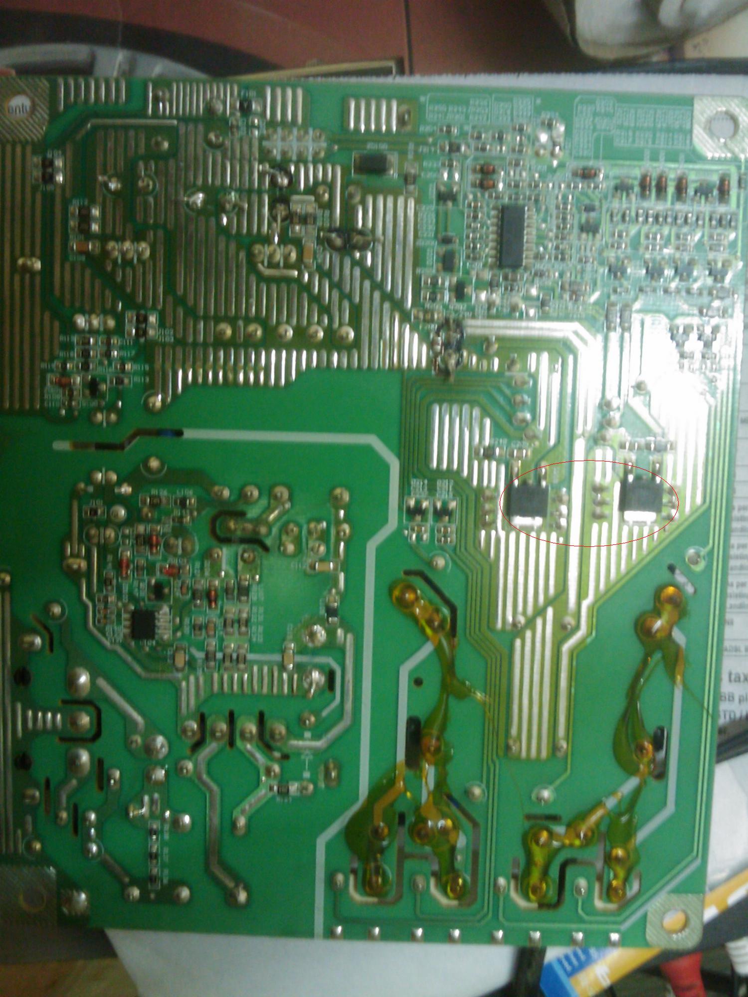

Help to repair Viewsonic vx2255wmb monitor
    Re: Help to repair Viewsonic vx2255wmb monitor
    I believe they are refering to the 2 transistors in red. They should be checked first for possible shorts and if one is bad, then both should be replaced.

      Thanks jetadm123! I'll check them out.. I can just respond to this thread if there are problems, or should I open a new thread.. Sorry i'm completely new here
        Since this thread is so small, it's not going to hurt responding to it. However, be advised that companies like Viewsonic and Acer are notorious for using several different power boards for the same model monitor. As poor as the existing photos are, try comparing your power board to the photos. If yours looks different, it's a good time to open a new thread. Additionally, if the transistors check good, then it would be good to post some good clear photos of your board, so members can suggest components for you to test.

          Please do not attempt to fix the transistors if you arent skilled with a solderingiron.. That thing was HARD to remove and replace.. You also would need 9973gh transistor(s).. They were hard to find as well.. But, before all that, make sure ur caps are good.. and follow the advice of these guys here.. They are awsome!!
