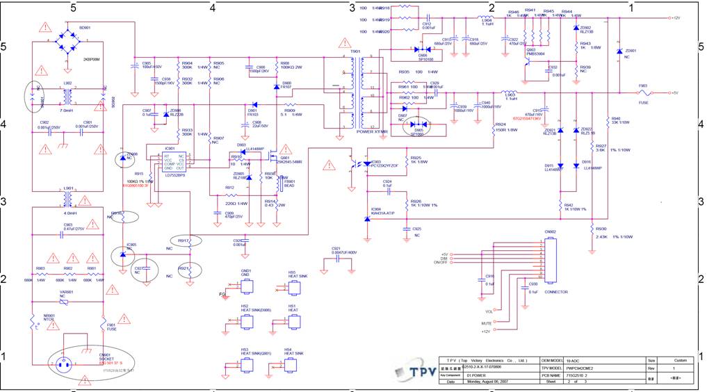

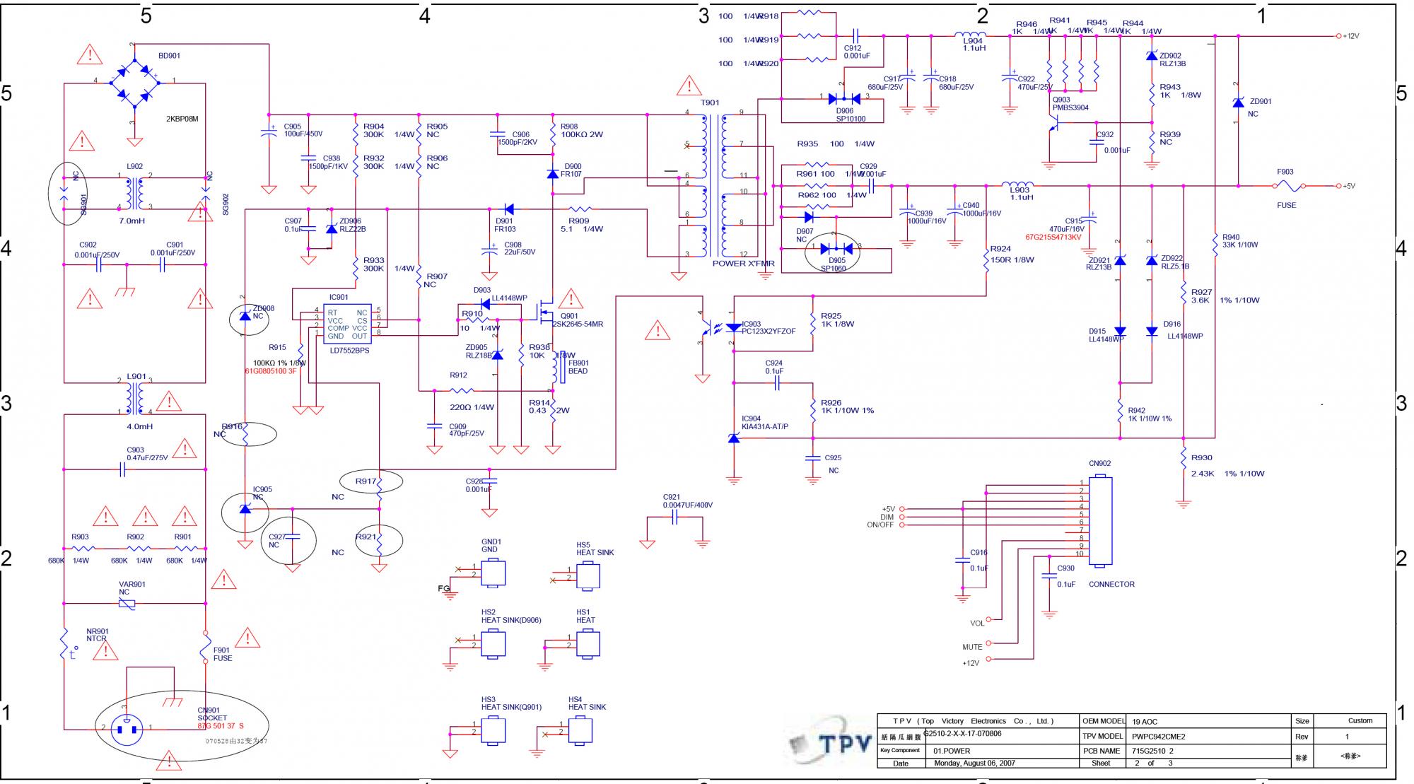

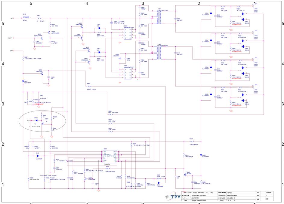

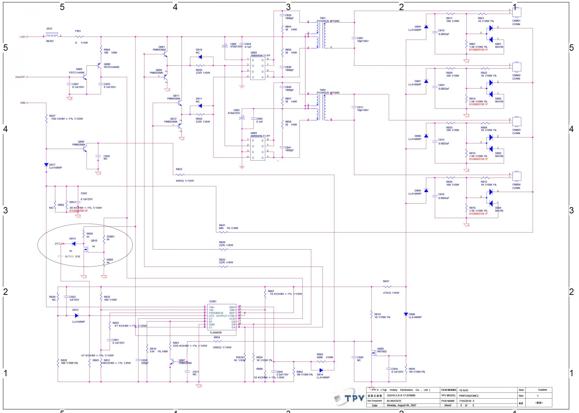

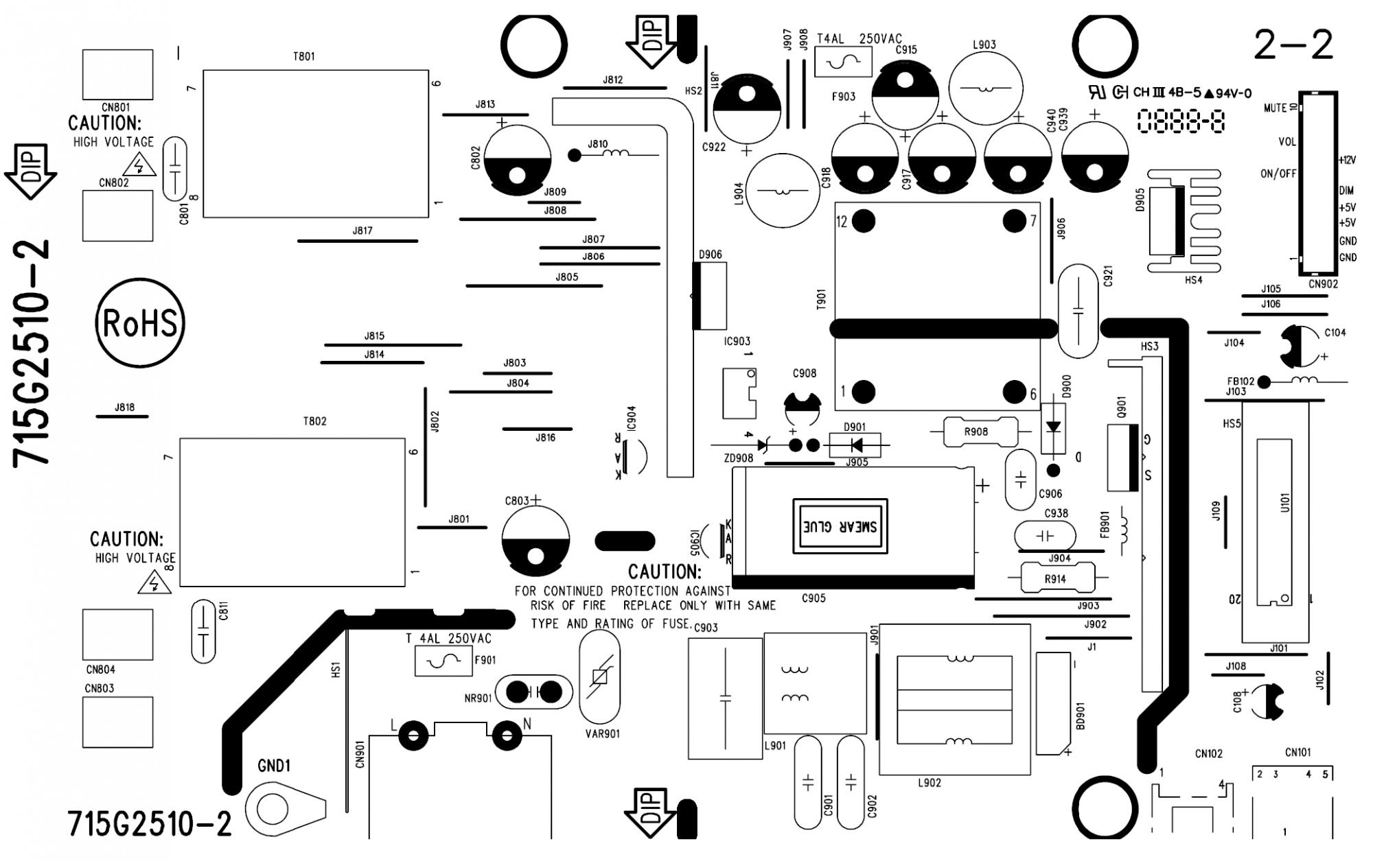

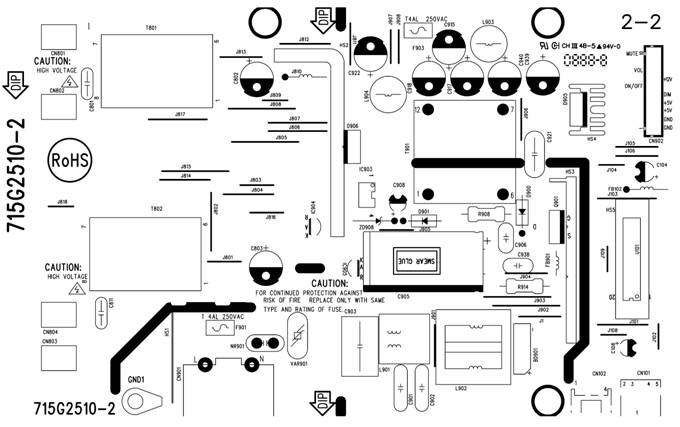

    AOC 2217v goes blank after power on.
    My problem is the same as ones I've seen posted here and on the net.
    When I turn on my monitor I can see my desktop display perfectly for about 3-5 seconds, but then goes blank. It is not going into "sleep" mode. I can hold down the power button to shut down the monitor. When I power it back up, I get the same result everytime...desktop display for a few seconds, then black.
    I've tried the suggestions I've seen for similar problems people have posted, but I'm still having no luck.
    Here's what I've done so far:
    Replaced all 10 of the capacitors (c802, c803, c905, c908, c922,c915, c917, c918, c939, c940) though none of them looked bad by bulging or leaking.
    Replaced diode (d906) because it had a little discoloration on the circuit board around it.
    Desoldered and scraped clean the coils (L903 and L904).
    Reheated quite a few other solder points on the board incase of cracked or cold solder joint.
    If possible I'd like to avoid troubleshooting (and buying) every little component on this board by trial and error, so I'm hoping someone can help me narrow it down.
    Here are the pictures of the circuit board and schematics.
    http://i746.photobucket.com/albums/x...rcuitboard.jpg
    http://i746.photobucket.com/albums/x...schematic1.jpg
    http://i746.photobucket.com/albums/x...schematic2.jpg
    Thanks for any help.

    Re: AOC 2217v goes blank after power on.
    1. Note the links in my signature on attaching pictures and do that. I dont go to other sites for pictures - I've been burned once.
    2. Thanks for supplying schematics. That will earn extra help AFTER you attach the .jpgs.
    3. What brand and series capacitors did you use.
    4. Even though in your case it's 3-5 seconds, these symptoms are often referred to as 'two seconds to black'.

          The pictures I linked in my first post display larger than the ones shown on the second post...but you won't visit external links...so I'm a little suprised you're requesting a link now.
          Regardless, the only place I was able to find schematics for this monitor was at elektrotanya.com (download link here). The site isn't in english but "Get Manual" link is. Also, the manual itself is in Japanese but the schematics are legible enough as you can see from the pictures. The .doc file schematics are much sharper and easy to read.
          The part number for the IC is 715G2510-2.
          Hope that helps.
          Thanks again.

              • smason
                • 1652
                Perhaps, but they're still unreadable.
                Can you not post pictures of the actual boards?

                  • Heliotropic
                    • Oct 2010
                    • 14
                    Maybe these will help...
