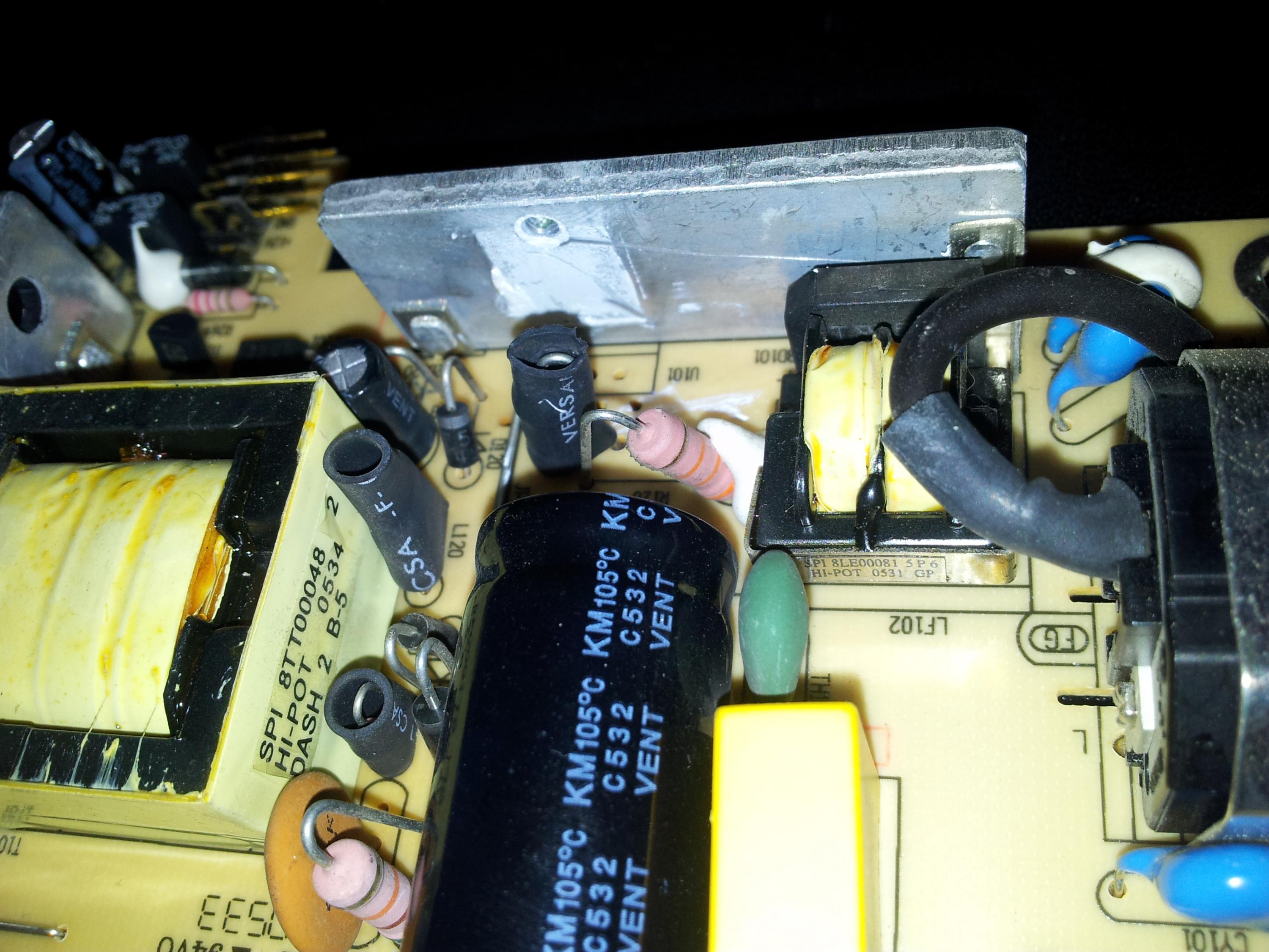

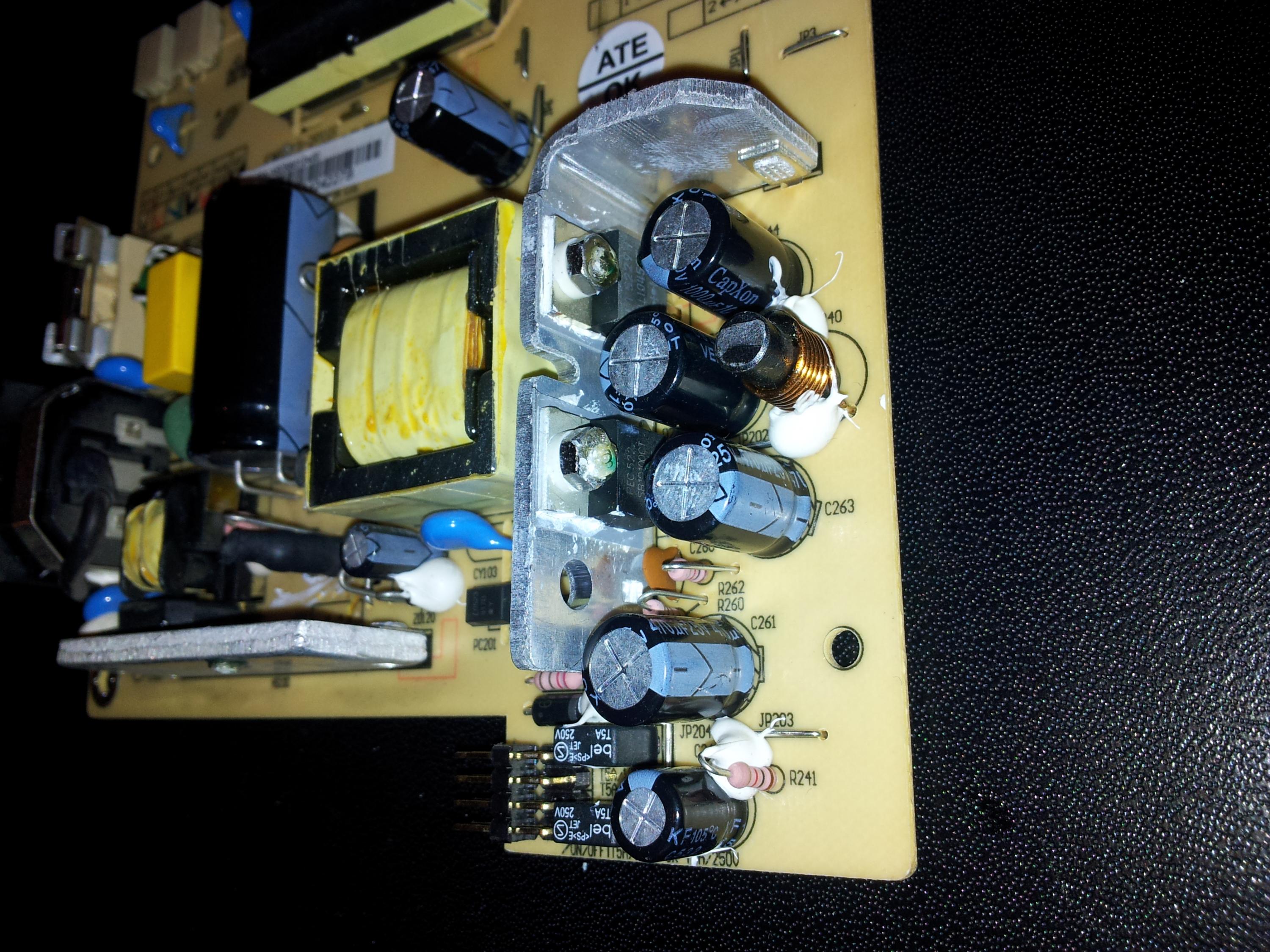

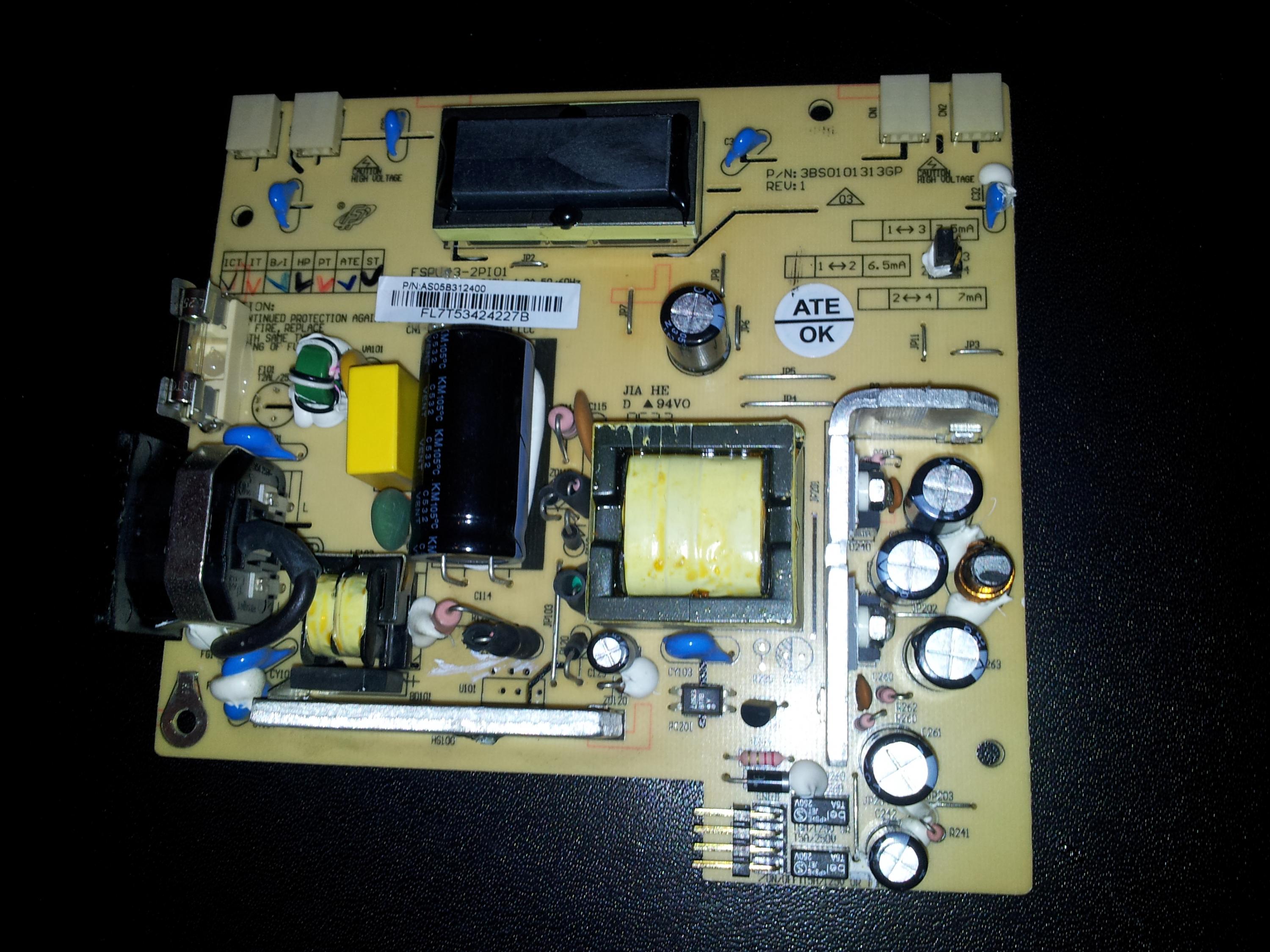

    The monitor works fine as long as I don't change resolution. Then the LED power on indicator just flashes. I have opened it up and the power supply board (see image) seems to have a few caps that have swollen. I circled them on the image.
    Are there other things that I should check before replacing the caps or could they be the root cause of the problem?

    Acer and Viewsonic are notorious for using different power supplies on the same model monitor. The bulged caps should be replaced as they COULD BE the source of your problem. They will definitely cause problems in the future if not replaced now. Replace ALL 7 of the caps except for the large one on it's side, as these rarely fail. If you're in the USA, I suggest using Panasonic FM or FC caps from digikey.com. Total cost should be under $10, including shipping. Use the directions below for ordering:

                      Hi, can anyone tell me what the code is for the 6pin IC chip which is screwed on the metal heatsink (below the capacitor c123, 22uf, 25v) thankyou
                        Re: ACER AL1916 with flashing power LED indicator.
                        If you're talking about U101, then it's a Fairchild FSDM0565R

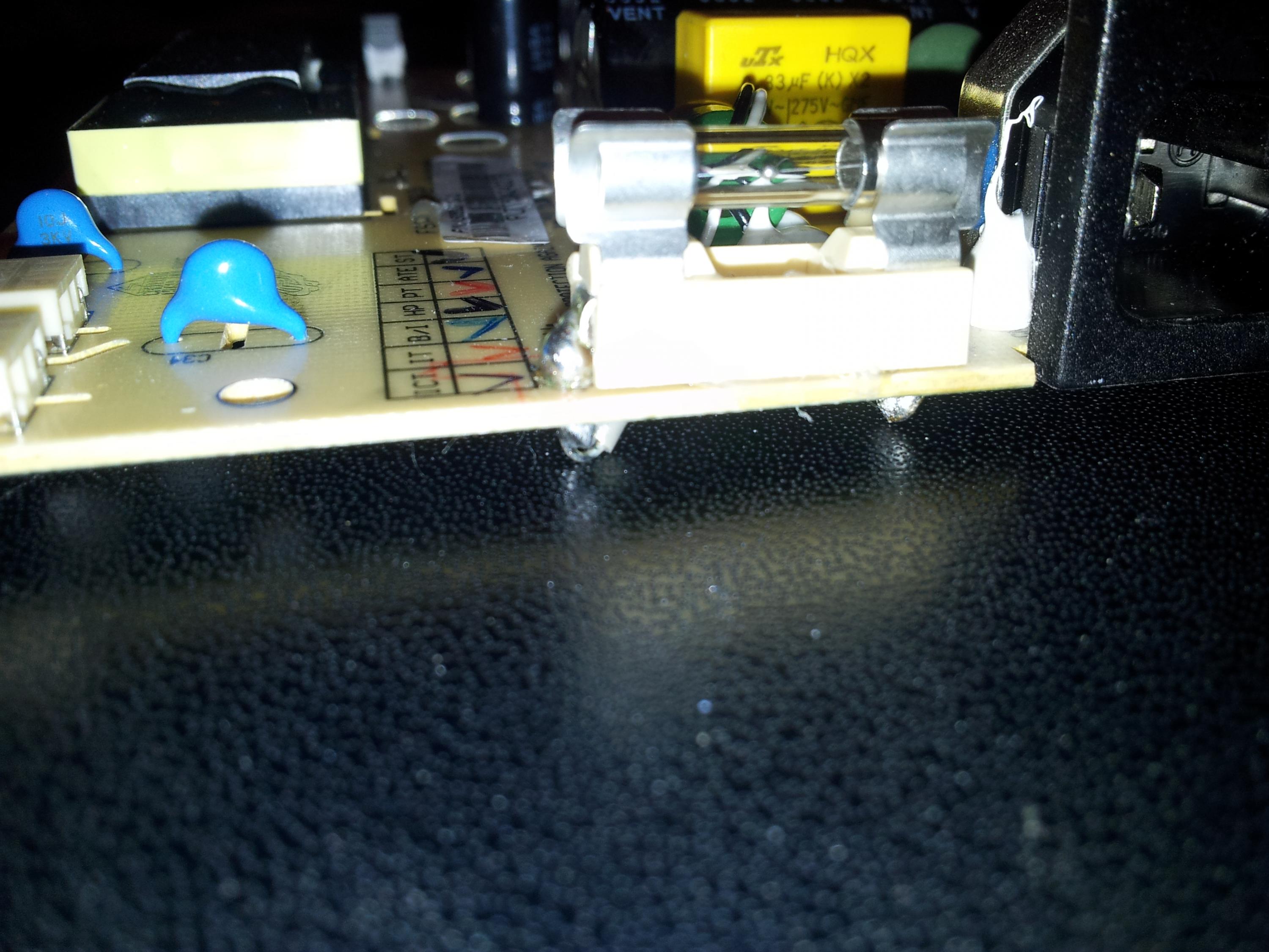

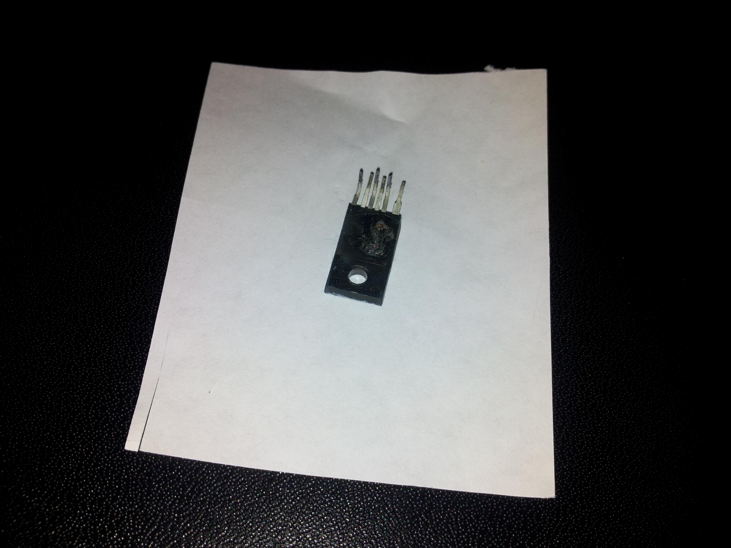

                          Gave this monitor to my sister, she brought it back saying it was working fine but then it blew from back, so i opened it up and discovered this IC was burnt out (attached image). My local electronics store didnt have red capped fuse but told me its 2amp so i modified board. Could the IC burn due to wear and tear? Ive had loss of current in house twice in 3 years when the monitor has been on. Also now that the IC is off, the fuse doesnt blow. The capacitors are fine.
                          Thanks again for all help
                            ive managed to replace the IC, put everything back together but it doesnt switch on
                            ive checked the 2 t5a 250v slow blow fuses, which seem fine. any ideas?? Thanks
