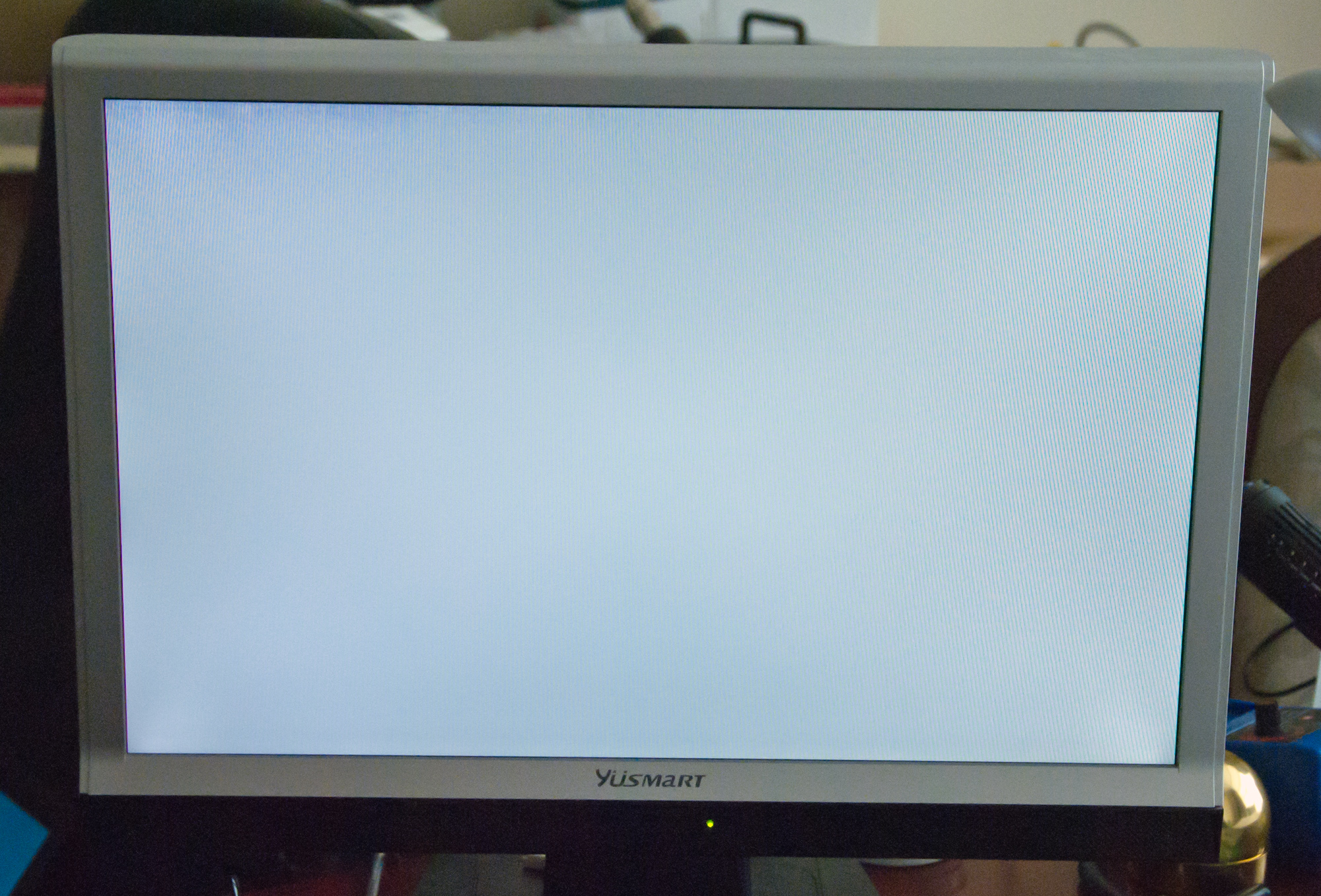

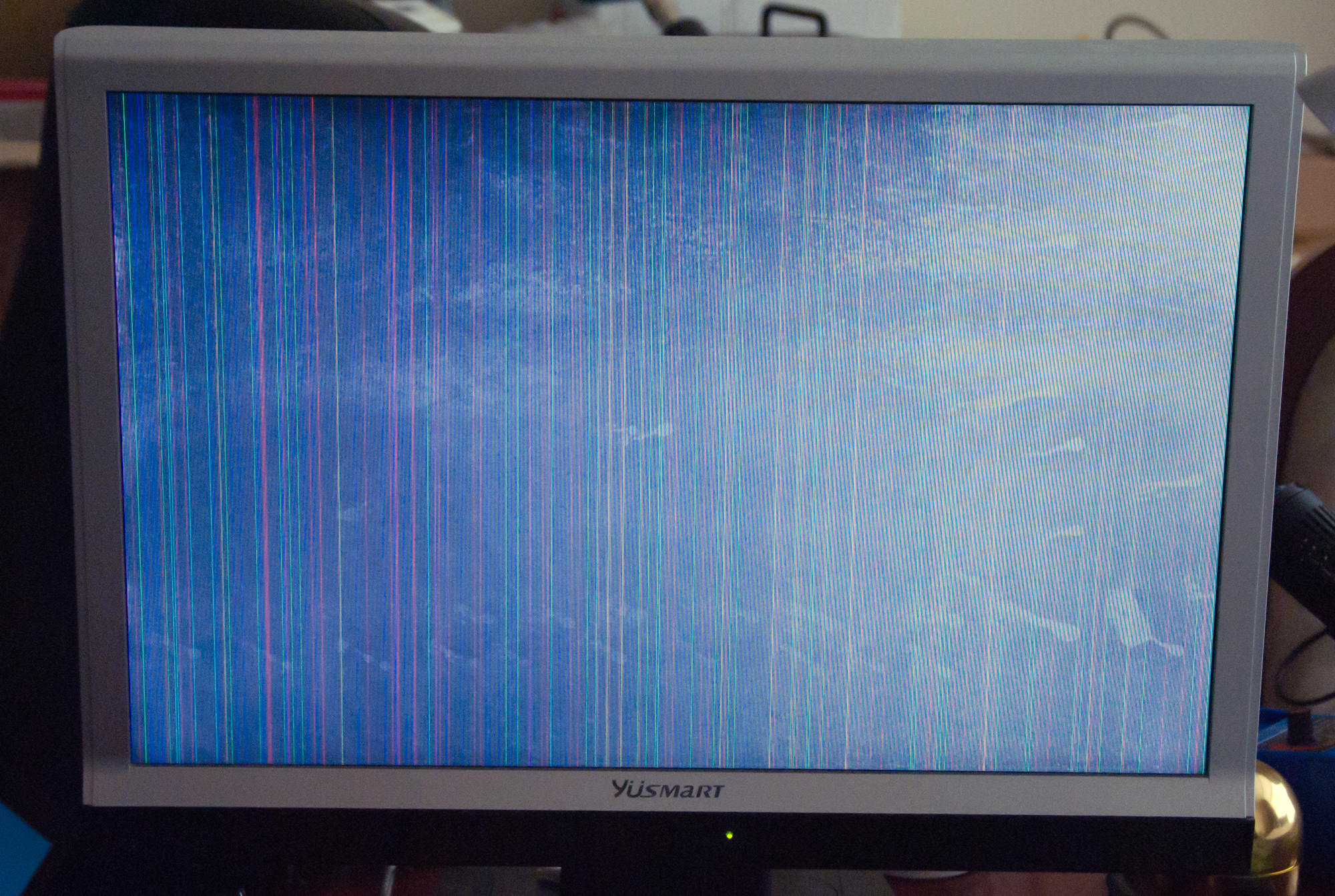

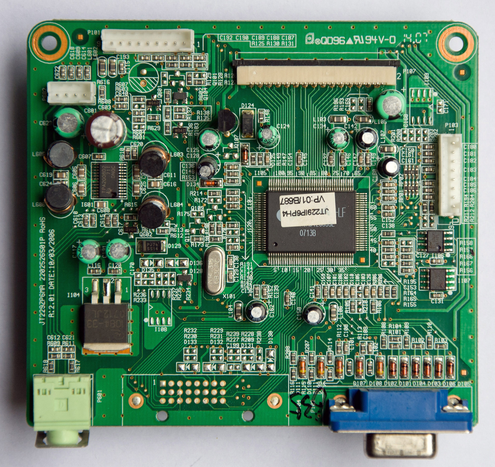

    Hello everyone, new forum user so please be gentle. The problem is my faulty monitor. Upon turning on, a grey screen fades to black with red, green and blue vertical pinstripes. Some of the electrolytics on the main board did make me wonder, but I haven't changed or tested them yet. Thought I'd hear from you guys first. Wondering where to begin. Cheers in advance, Lee.

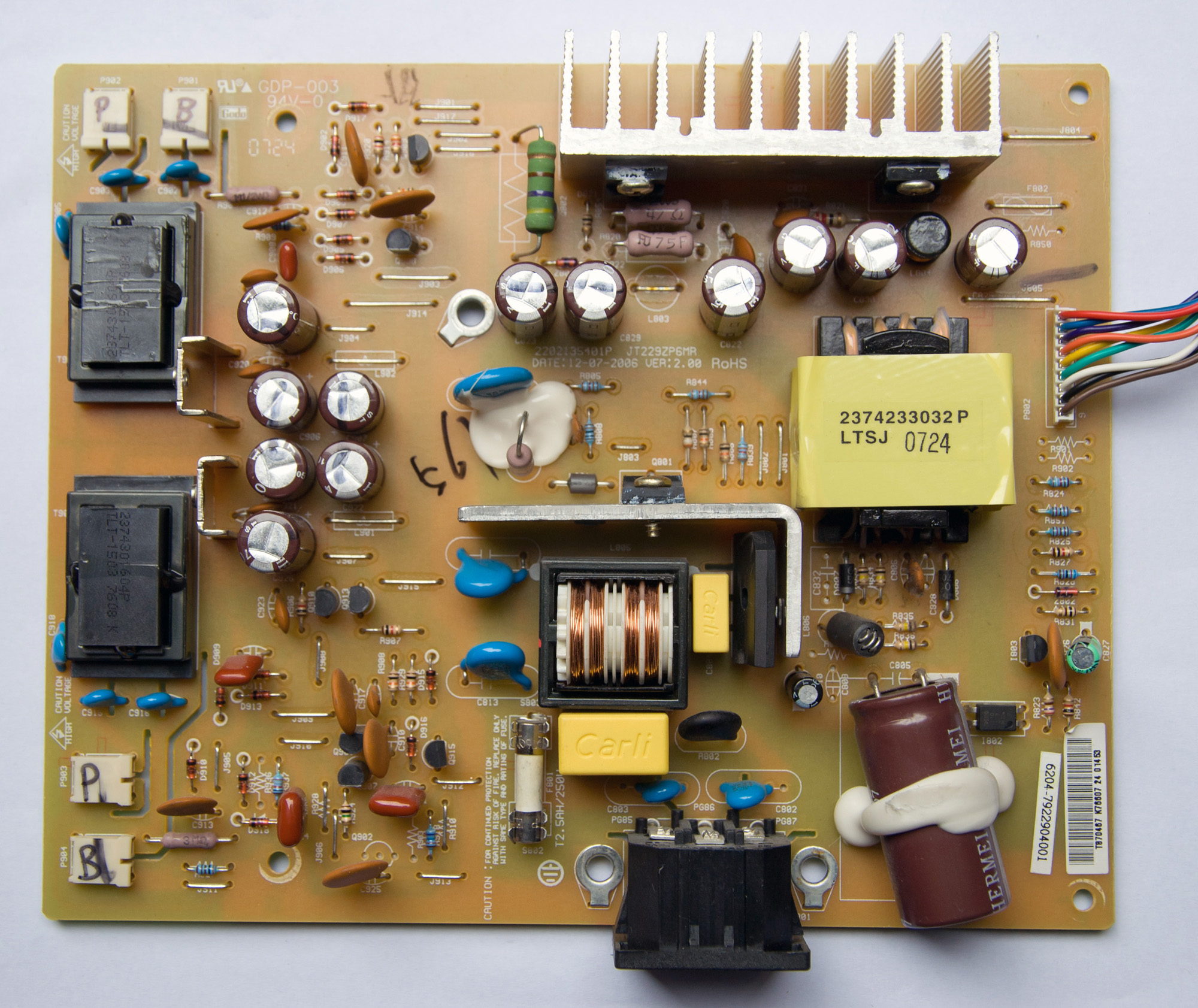

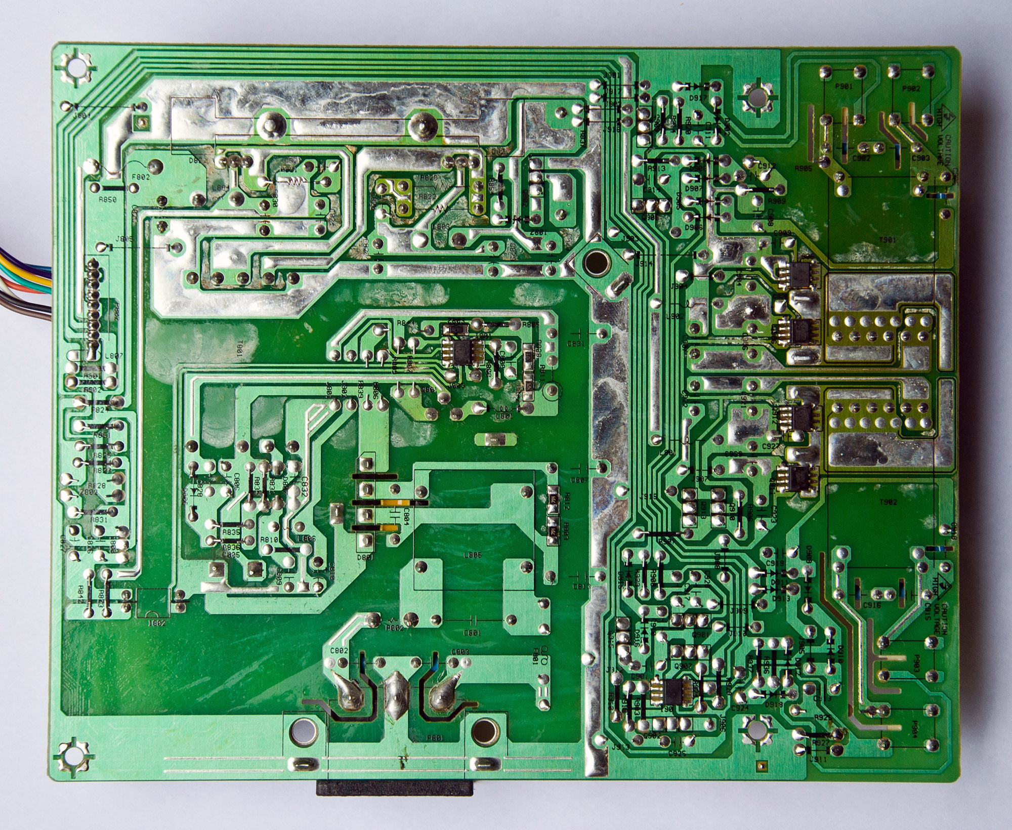

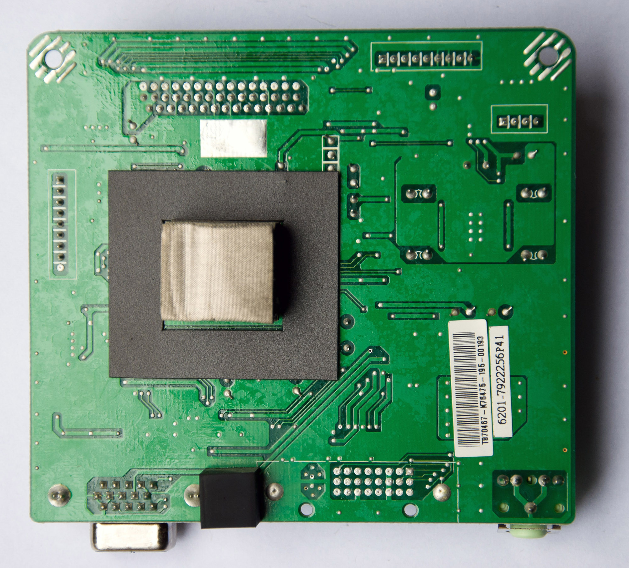

        Hello all, board pictures now uploaded (had to wait for daylight) I've been looking at your badcap list, these boards contain both Hermei & Lelon caps, but they aren't bulging or leaking. Cheers, Lee.

          Welcome to the forum! Funny, but there's another member that posted problems with their Yusmart. Although their problems are different from yours, it's worth reading:
          https://www.badcaps.net/forum/showth...hlight=yusmart
          Please post a photo of what the screen looks like with the vertical lines, etc.
          You can probably start by checking for proper voltages at the power supply. Measure the output voltages at the 9 pin connector cable (P802) at the right side of your first photo.

            Also check the voltage regulator (I104) outputs located on your logic card (3rd photo). Pin 1 is ground, Pin 2 = 3.3V and Pin 3 = 5V.

              Excellent photos. A+.
              Like jetadm123 suggested, check the voltages first and report back.

                I've been measuring and here are some findings :
                I104 has 3.29 and 4.66V from pins 2 & 3 respectively.
                C805 ( the big one) has +161-3V on the anode & -154-6V at the cathode and also the end cap.
                My P802 (9 pin connector) voltages are pretty much the same as fusionmax in the other thread, however mine are 4.99V compared to his 5.15V on the same pins (2,5 & 6). I get pin 7 reading 1.62V & pin 8 reads 2.83V all other pins read zero (1,3,4,9)

                  Output of I104 looks pretty good.
                  Please note that I'm referencing a schematic from a Viewsonic monitor as provided by fusionmax.
                  5V output vs 4.99V is good.
                  C805 Voltage is good.
                  Pin 7 controls brightness.
                  Pin 8 is on/off
                  24V output is probably good, since the backlights are coming on.
                  Unfortunately, nothing is sticking out at this point.

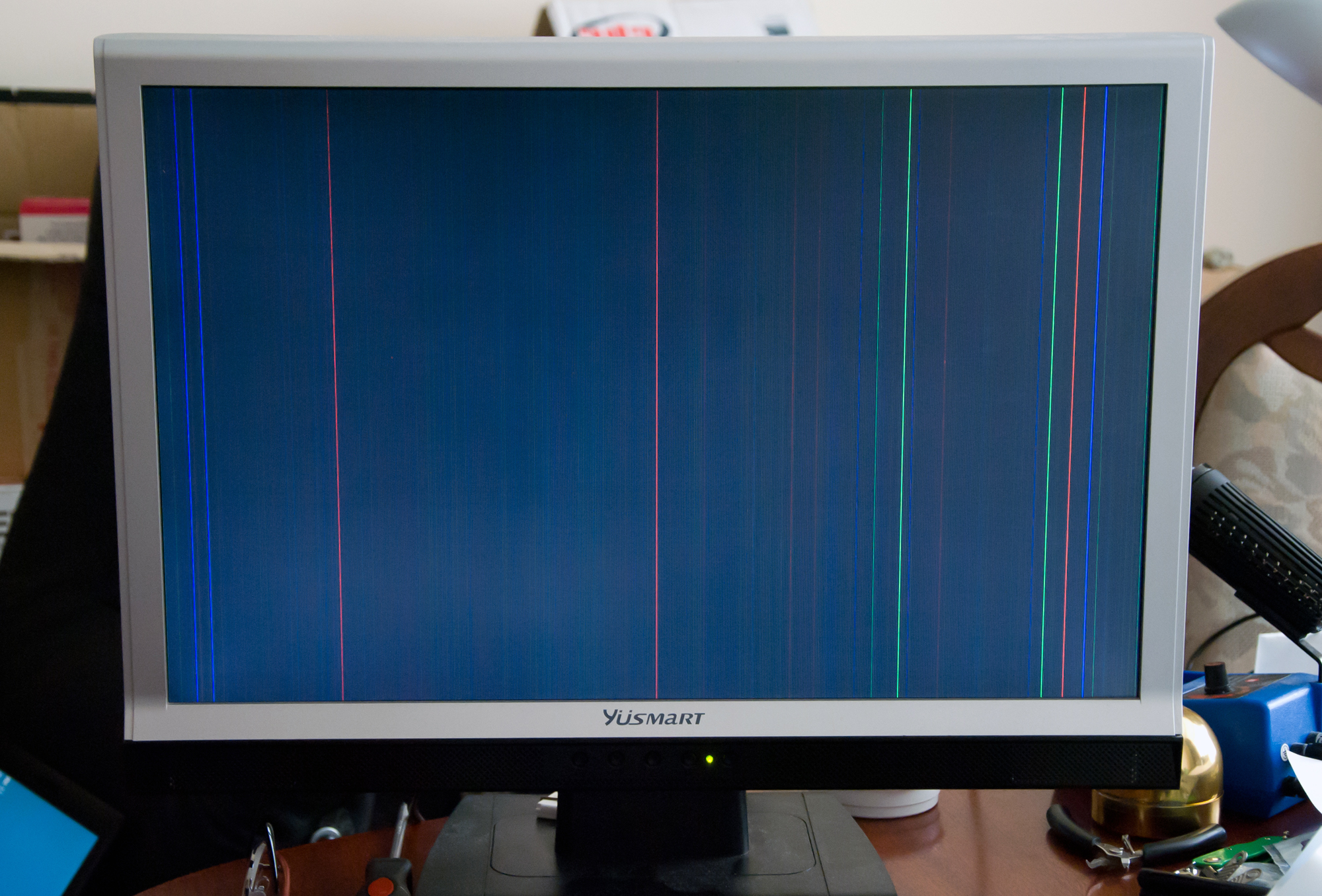

                  Looking at the photos of the vertical lines: Are the same lines present everytime you turn on the monitor? Or are they random?
                  I suspect you already reseated the cable connecting the logic card to the LCD panel, since you had to piece everything back together to take the photos.
                  With the vertical lines showing, have you tried GENTLY tried pressing on the LCD screen at the top most point of one of those vertical lines to see if it goes away? Just checking to see if there's a loose connection.
                  If there was also a picture with the vertical lines, I would say it was the LCD panel that had failed, but what's got me puzzled is the lack of a picture. Bad logic card?

                    If you get no respite with jetadm123's suggestion,then there is no other option but to try a replacement Logic board to confirm Logic or LCD Panel,but I'm sure you would have done that,if you had one.Chances are that it is the Panel.

                      I've managed to acquire another logic board, shall have it tomorrow hopefully. Will keep you updated. Cheers, Lee.
