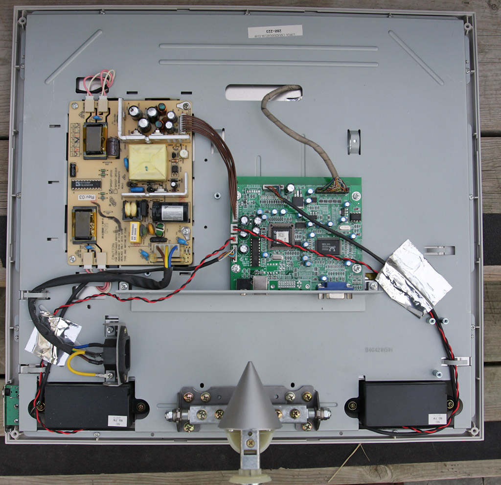

    I acquired a dead 19" monitor yesterday.
    Picked it up, took it home and took it out of the box.
    I have no clue what brand or model it is, there's no markings on it anywhere.
    Looks like a decent monitor, good shape, has speakers, and touch controls (metal buttons on a metal faceplate, see first pic)
    There is a missing plastic piece on the back that might have had a sticker on it.
    This thing was a dream to work on. 4 screws and the back practically fell off.
    2 more screws and the metal cage came off over the power supply/inverter card.

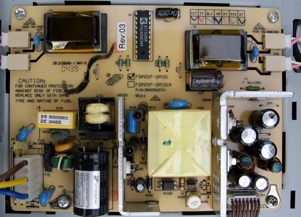

    Oh look, never seen this before...... bloated Capxons. Who'd have thunk it?
    I didn't try it before opening it up. Recap first, ask questions later.
    The board was good quality, nice lead solder. Almost every cap I hit with the soldapullt fell out.
    7 caps later, I test the pico fuse good, and all of the T0-220 devices for shorts good, then put the board back in. Fire it up. Works!
    Screen looks a bit crappy. Factory reset, and adjust brightness contrast and white balance, and it's not bad at all. Not a keeper, seems a bit washed out,
    but will make a nice donation to someone in need.

    Oh forgot to mention there was some nasty rotted glue that may have gone conductive. Scraped it off as well.

      Nice FSP power board. Really interesting how they mounted the power receptacle off of the board. Actually looks better than some of the name brand stuff. Any idea who made the LCD panel?

        No didn't have to go deep enough to see it.
        Just measured some of the caps
        330 uf @35v 52 uf 4.7 ohms esr
        470 uf @ 25v x3 156 uf 85 uf 161 uf all about 4.something ohms esr

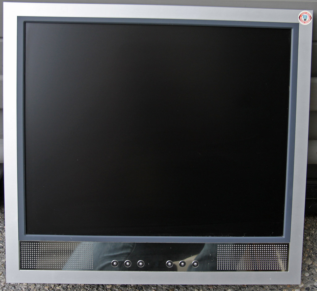

          I forgot to ask earlier, but in your second photo what is that little cone shaped device at the middle bottom of the panel?
          • smason
            • 1652
            Re: Mystery Monitor
            That's the top part of the mount that mates with the swivel base.
