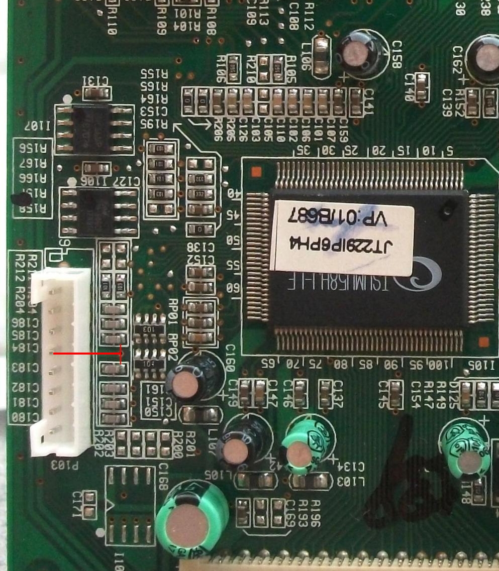

                    I've been real busy lately but finally managed to find some time last night to try and trace the power button back to the IC. I have attached an image of how far I have got....... not far!
                    I am still having no luck with finding a datasheet for the IC, the manufacturer haven't come back to me and I can't find anything anywhere

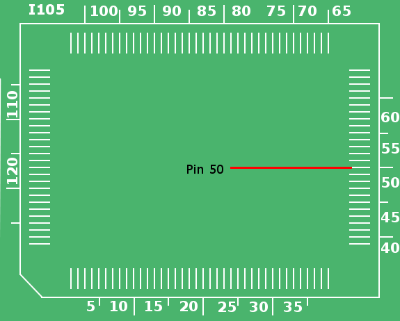

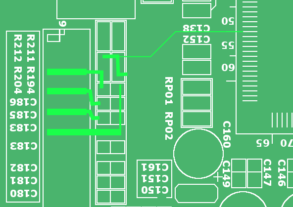

                                Ok, so I've finally managed to find some time and traced the power button back to the IC on the Logic board.
                                It appears to be at pin 50 and doesn't go through any capacitors. I have attached some images showing this.
                                Can anyone give me my next move?
