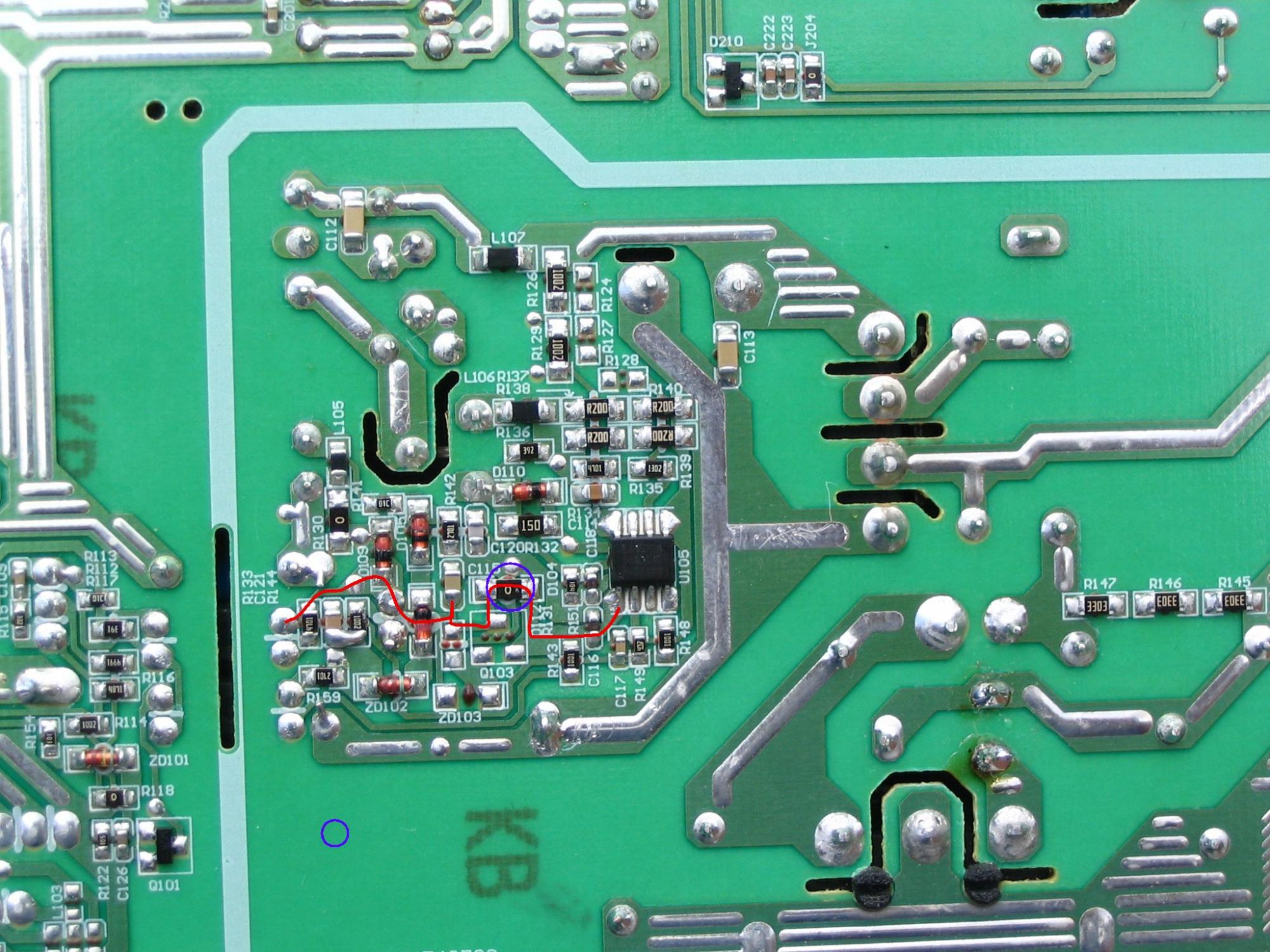

    You reported Vcc is low. There are only a few reasons for that.
    1. The rectified mains voltage (at pin 8) is too low. It should be at least 125 volts
    2. The capacitor hooked to pin 1 is leaky
    3. The diode from the tertiary winding is leaky.
    4. The TEA1532 is defective.
    Thanks for write-up explaining the startup function of the SMPS chip, that helped a lot.
    Looks like #4.
    I removed a jumper (blue circle) that's part of the pin 1 circuit (red line), this eliminated the cap, & diode from the circuit. Still only had 9.7VDC on pin 1.
    Hello Digikey...
    Is there anything else I should add to the order? (Just-in-case)
    Thanks everybody for the help.

        Hmm, another dead EA1532A. Just like this thread.
        https://www.badcaps.net/forum/showth...hlight=ea1532A
        BTW, the pic in post #19, there is one really bad looking solder ring crack joint just above the AC input. You might want to clean that up.
        Oh yeah, please report back if you got it working or not once the part comes in.
          Optical delusion
          Just some flux left over after sparky paid me a visit while measuring the 120uF capacitor Replaced the fuse when I changed the capacitors, need to go back and clean the flux off.

            Since the TEA1532 is just a little over $1.00 (yeah, I can't believe it either!), it probably wouldn't hurt to order an extra one just in case............
            • a55bruce
              • Aug 2010
              • 26
              Re: Acer AL2216W 'was' Dead
              Success !!!!
              I replaced the SMPS chip, plugged it in and ta-da the 5V magically appeared at the connector. I couldn't get it plugged into the screen fast enough. Put it all back together connected up to a system, hit the on button, and it works great!!!

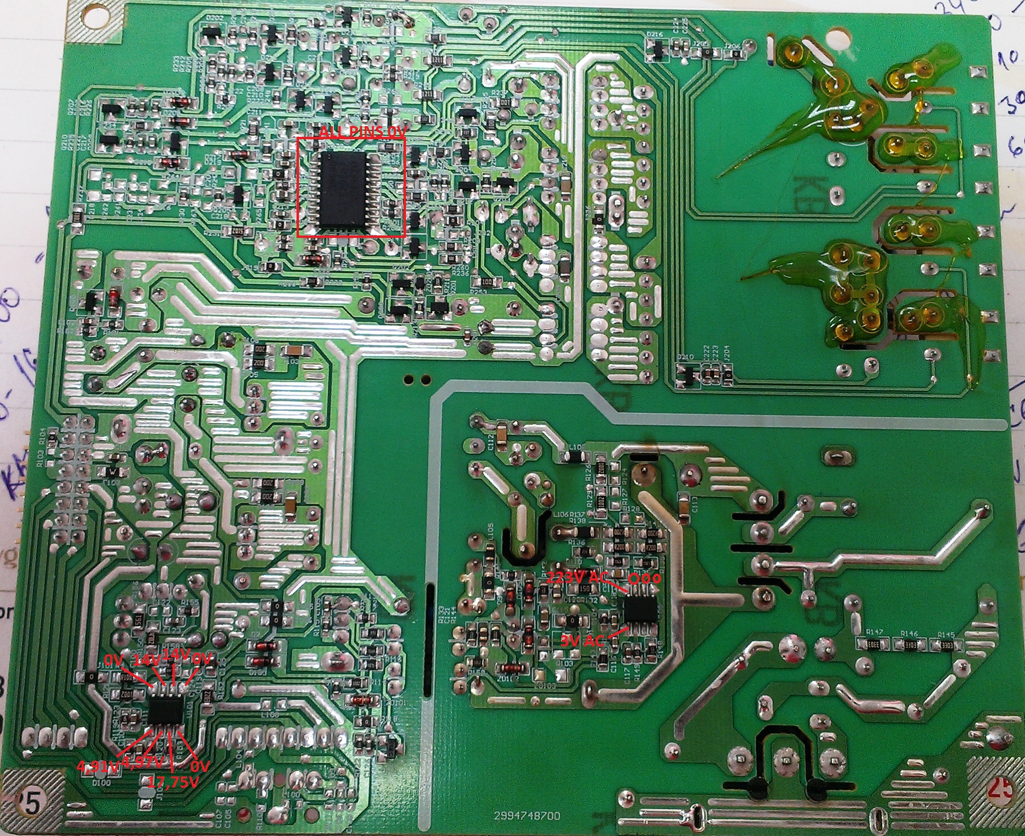

                      I found 4 fuses (F100,F101,F102,F200) that check good.
                      Anyone know more about that F102 Fuse? I acquired a failed monitor from one of my customers and figured I'd dig in and try to see if I could fix it. I'm working on it and think ultimately I'll win!
                      The board was missing the 5V output. The 13.8V out is ok. I found this site, and on searching e-bay I found a supplier for a repair kit for this board so I ordered it. It's a kit containing the 8 caps on this board that fail. Just before installing them I was looking at the board and found the F102 fuse, a surface mount fuse on the bottom of the board, near the 5V output pin. I checked that fuse and it is open.
                      I've searched all over to find a schematic for this board that will tell me what type and rating this fuse is. The fuse is black and is marked with a "W". I didn't find the schematic, but after visiting the Bourne site, I think this fuse is a 4 amp fuse. I don't know if it is a slow blow fuse or not though. Maybe someone else might know the answer to that? I've now ordered a few of these fuses. I ordered the slow blow ones, don't know if that is the right move or not, but seeing that this is a power supply, a slow blow fuse might let the board supply some current surges to the video board for a short while before it blows. Maybe someone can let me know if my thinking is right?
                      I hope this information helps someone else in the future that is having a problem with the 5V output on this board.

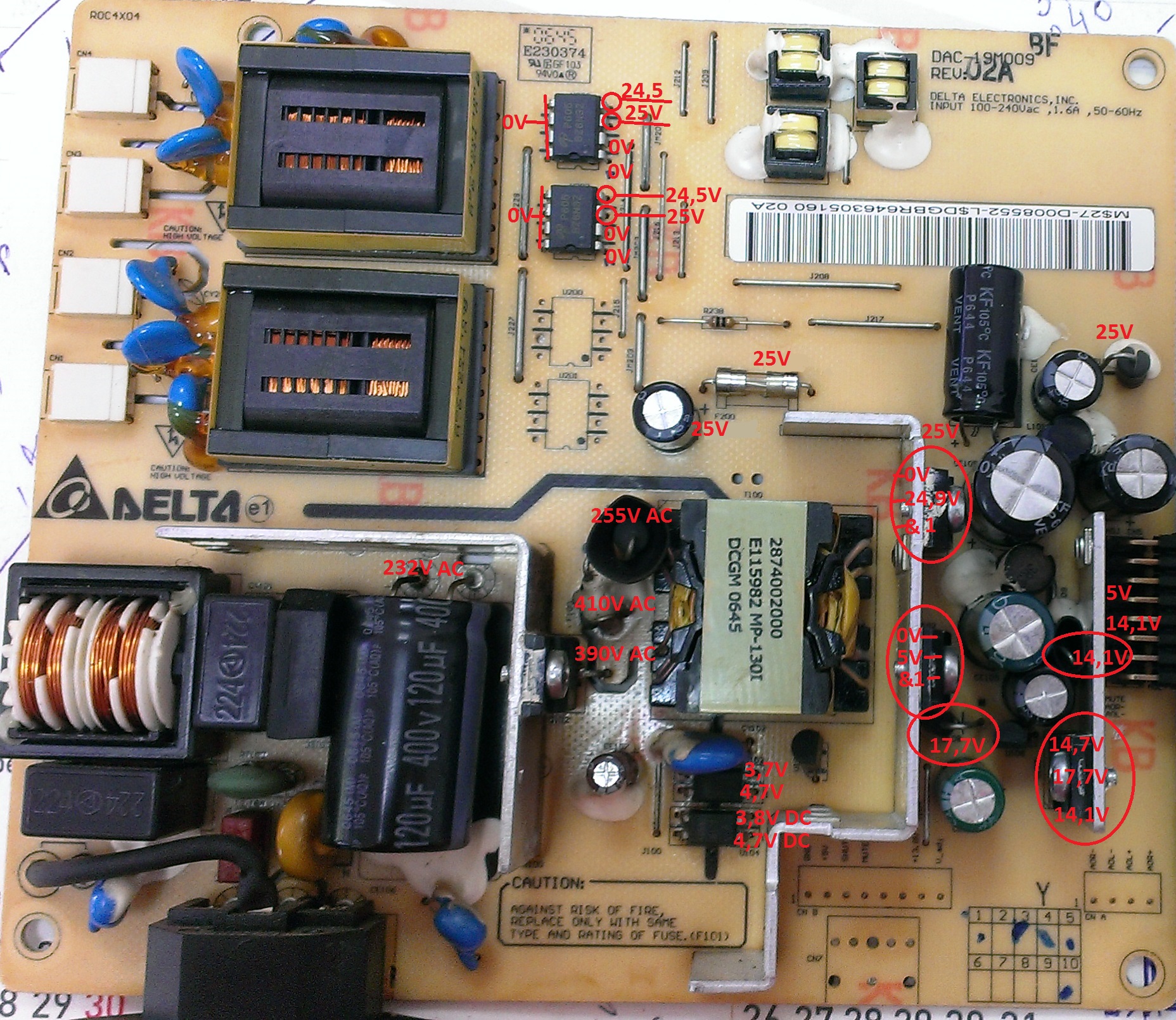

                                  I did and got the same readings again. Output 4.9 ~ 5.0V and 24 on the fuse. 5v and 14V is showing on all pin-outs as written on the board right beside 16 pin connector. I have checked mosfets on logic board too- got readings of 3.3 middle pin, input 4,9V and pin 3 4.7V.
                                  I have the power led AMBER all the time and it would not turn on nor show picture or even flash for a second or anything.

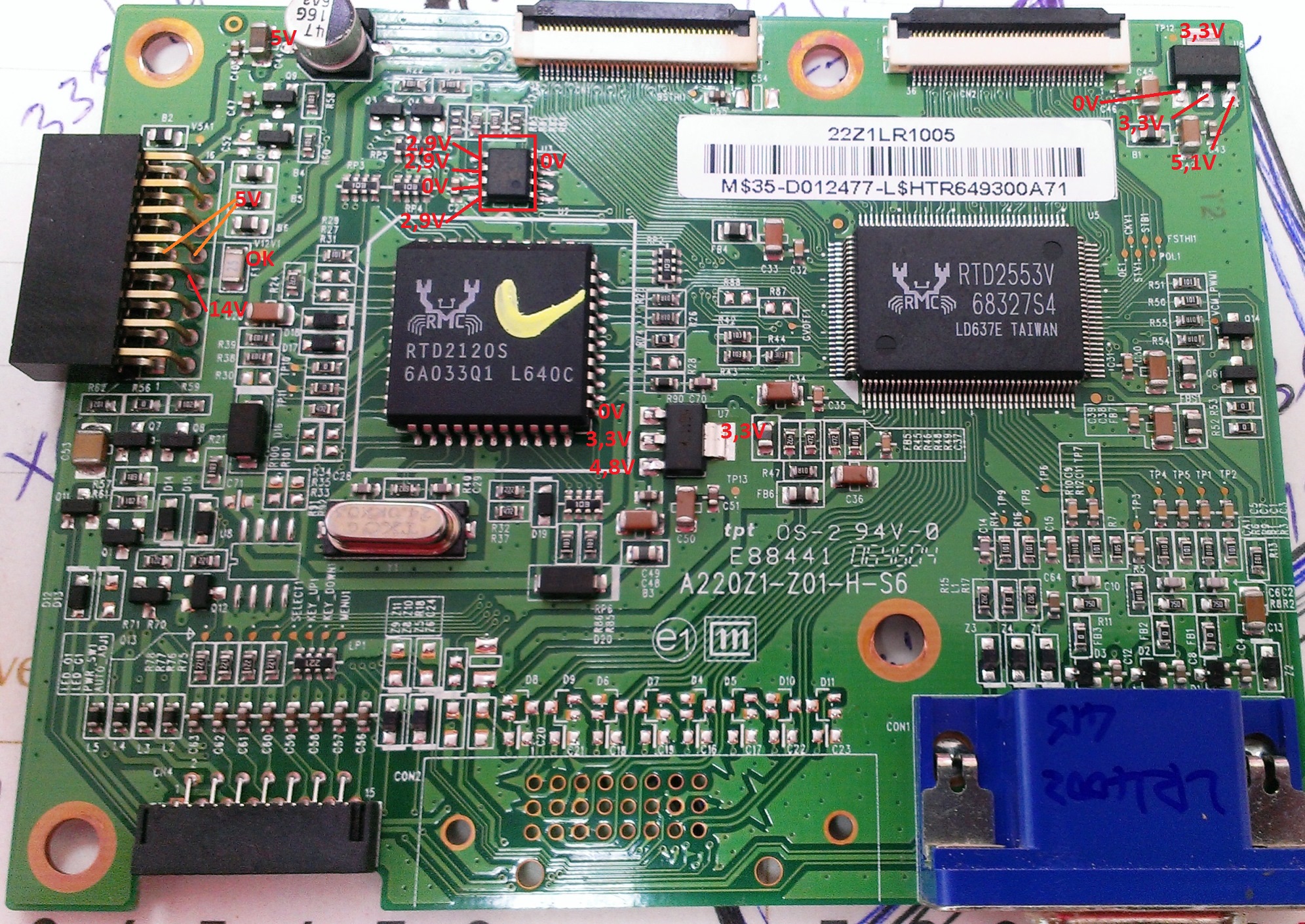

                                      can you post a picture of the logic board ?
                                      and which mosfets are you checking
                                      if they are the50117k, those are voltage regulators and pin 3 should be ground
                                      tab and center pin 3.3 and 5v input

                                        I'm thinking the F200 voltage should be around 19V. What's the voltage rating of the cap next to it? 25V? Is your meter accurate? Try measuring a battery to verify it's accuracy.

                                          OK. here it is with pictures...if you need any more measurements just shoot. Thanks peps.
