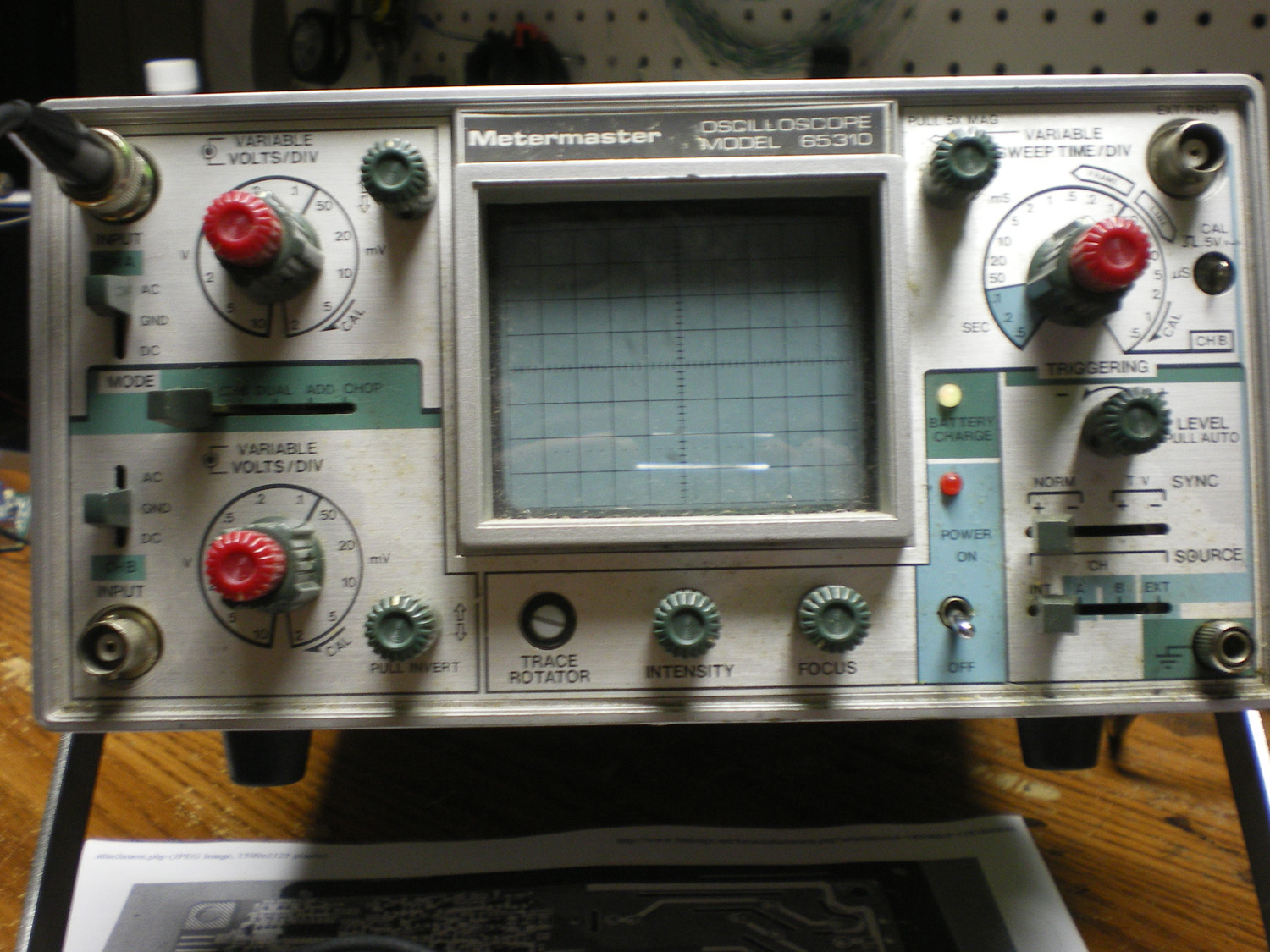

        Okay, I've got the whole thing rigged up and ready to go - just one more thing before I proceed with the tests, if you don't mind.
        When you say the oscilloscope ground goes to the inverters corner ground plane, do you mean the ground clip on the probe, or the oscilloscope's ground connector on the bottom right in the picture I attached? I've always used the probe's ground for low current/voltage circuits, without hooking up the ground on the oscilloscope, but I have no idea which one to use for a line powered device like this. If I had to guess, I'd think the oscilloscope's ground is there for when running on battery mode (and not properly earth grounded)?
        It's a battery powered oscilloscope running off of the wall plug - it's connected to a properly earthed circuit with a 3 prong plug right now - I read somewhere you could create a ground loop, and that would be bad if you do it wrong, so figured I'd check before doing something potentially stupid

            #45
            Re: Acer x193w with Darfon B092-XXX inverter - assistance needed! [lotsa pics!]
            Okay, well I just got back from trying these tests out...
            I tested the scope just to make sure I can get a waveform on it with a simple square wave oscillator. No problemo, so I think it works. Onto the tests...
            When testing over the transformer, I can't get a stable waveform - though there is one when the buzzing I described earlier happens.
            This is what happens:
            - I turn the monitor/power bar on, the blue power LED comes on
            - A moment later, there is a buzzing sound coming from the board. At this point, the oscilloscope displays a waveform that is either noise, or I just can't get focused on it for the second that the transformer is on
            - The buzzing stops a second later, and the oscilloscope displays nothing.
            - The board waits another second, then buzzes again, then stops - same thing.
            - The power LED turns orange.
            After that, there is nothing displayed on the oscilloscope, and no buzzing. I assumed this is what you meant by not getting a waveform and went onto the next test, but I went to point V1, and tried numerous settings with the probe clipped on there. I cannot get a waveform to display for V1! Weird.
            Out of curiosity, I went back and forth between the top and bottom transformer points. The top one displays a higher amplitude waveform than the bottom. Does that matter, or is the amplitude relative to how close I am placing the probe on the board? Whether the waves are the same or not in frequency or shape, I can't tell because it's just a blur of lines for the second it's on.
            Does this mean the whole board is losing power (is that possible?) or am I just not using the scope right somehow?

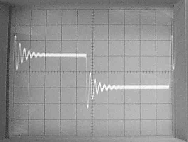

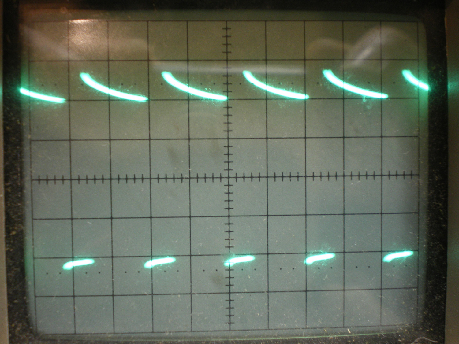

                      #50
                      Okay - both of the waveforms appear to be the same. It doesn't look anything like the ring in your image. Is my oscilloscope broken? I don't know why it doesn't display vertical lines.
                      Also, the square wave generator I speak of is just a basic CMOS oscillator - not an extremely accurate function generator or anything, so the square wave has a very slight corner on one edge of the waveform. Is this going to render the test useless?
                      That would be a bummer if it was the oscilloscope being broken...it appears to work properly though - a square wave shows horizontal lines only.
                      So, have any ideas of what to try next?

                                  #56
                                  Alright!
                                  Sorry for the age long reply...life kinda got in the way...it probably will again, but I must see to it that this puzzle is solved eventually!
                                  I got some time today to revisit the ring test, as per the updated instructions. I had to isolate the signal with a capacitor as said, and BLAMO! - I got ringing to display! Unfortunately the transformer exhibits a very nice (and identical) ring on both secondaries...so no easy fix! Shucks!
                                  So, any idea of what to try next?

                                          I also have a X193w with the same problem, back light will only light for a few seconds.
                                          But it looks like I have a different powersupply/inverter board then you other guys. P/N is E59670 ILPI-031.
                                          The inverter is controlled by a 16pin SMD chip number MP1008ES. I cant find the data sheet for it. And would like to know what pin's are the enable/shut down.
                                          The 5v and 12v supply runs like a champ (checked with scope). Just the darn inverter keep's trippen.
                                          I get about 500ohms on the secondarys and .6 ohms on the primarys for both of the transformers.
