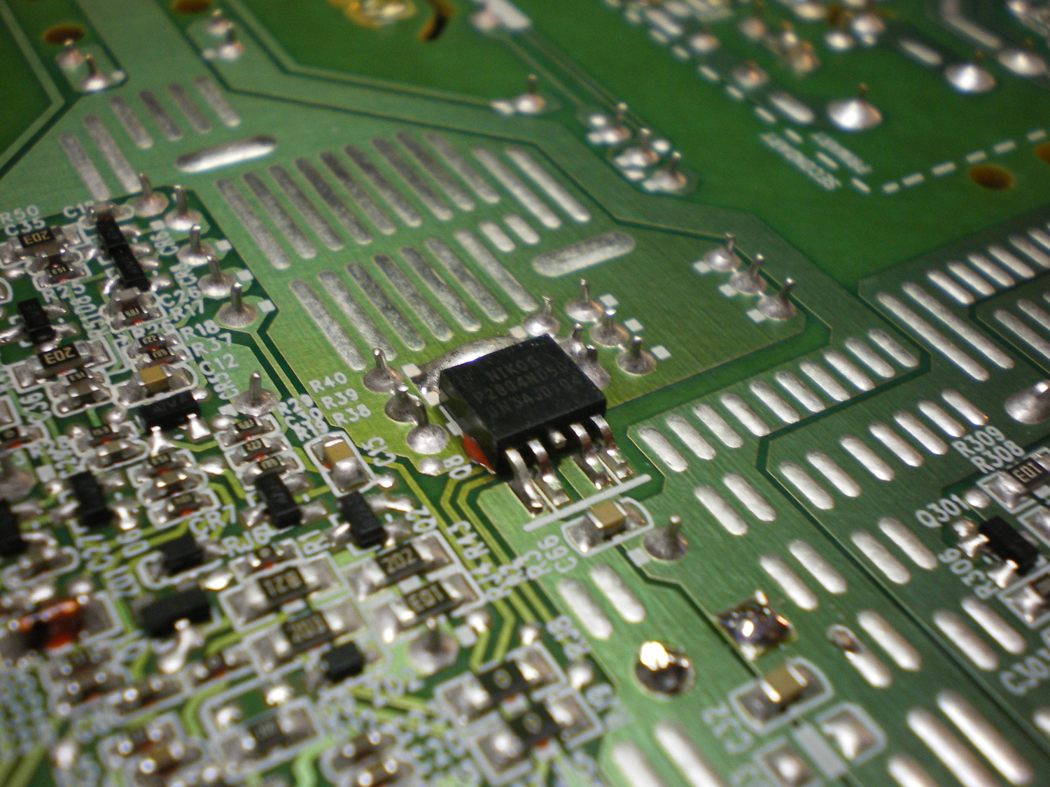

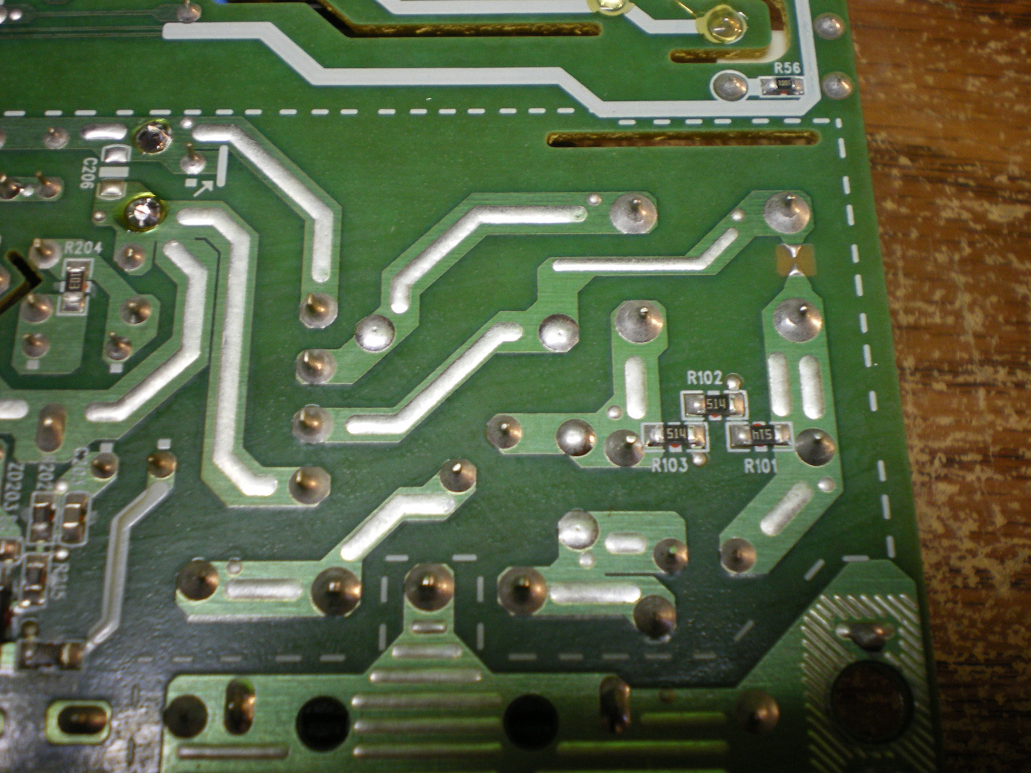

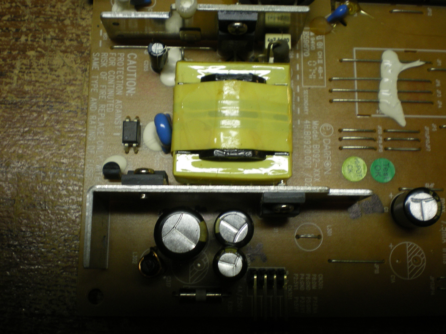

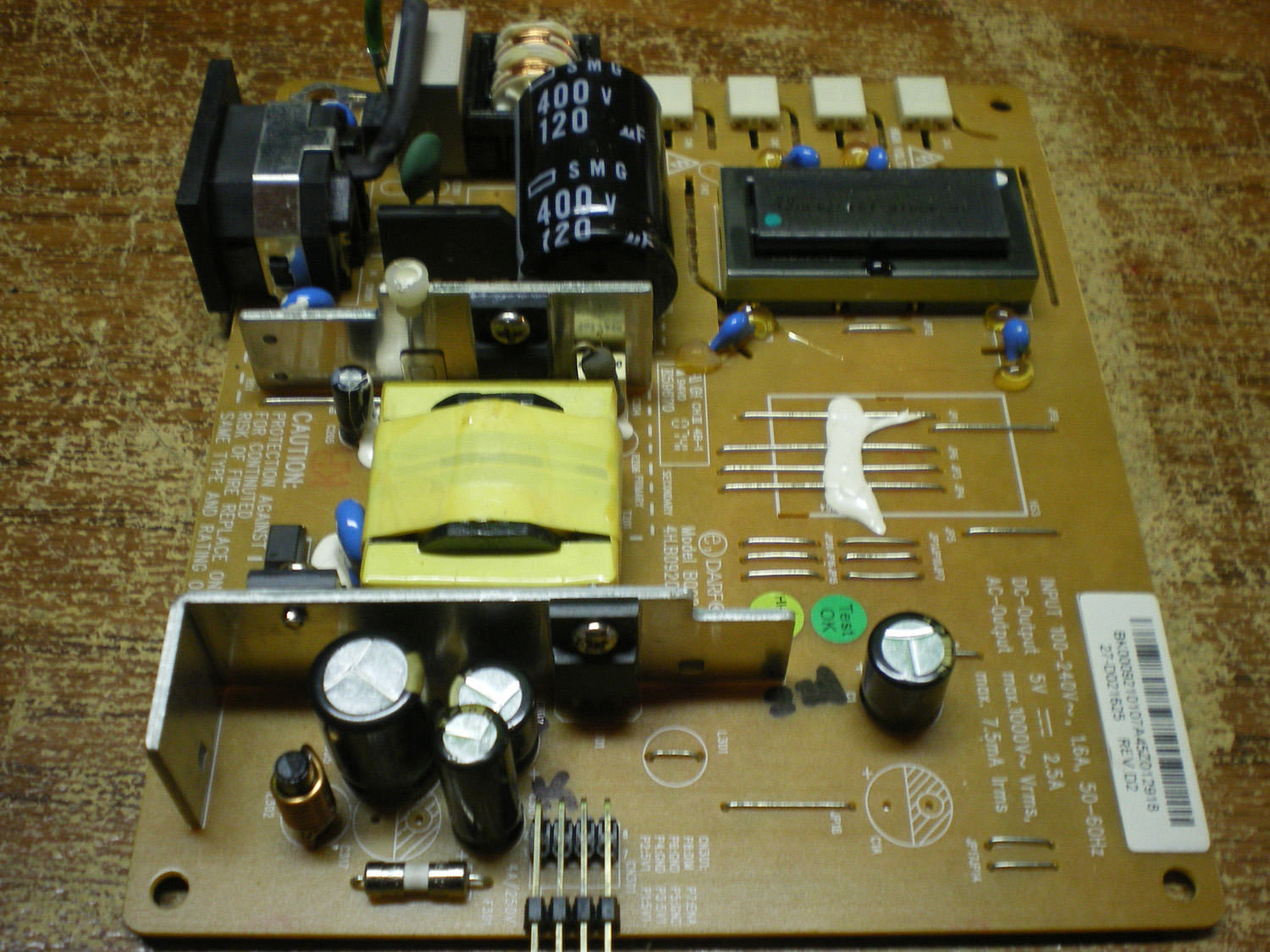

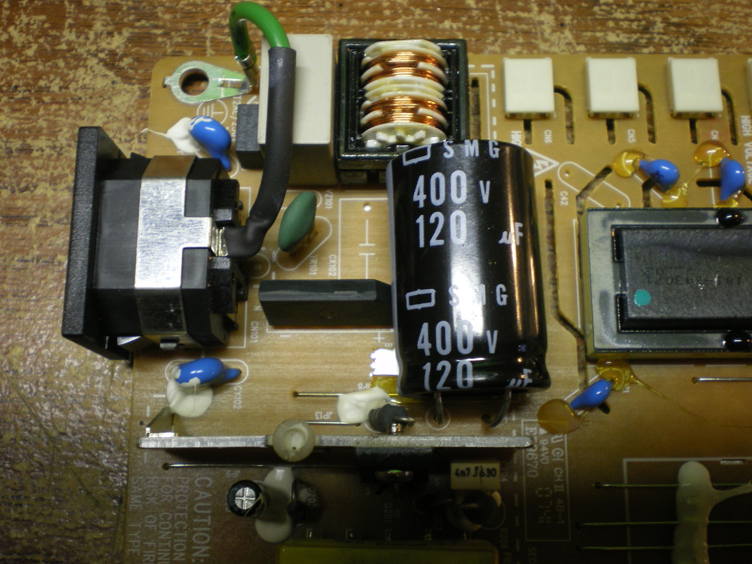

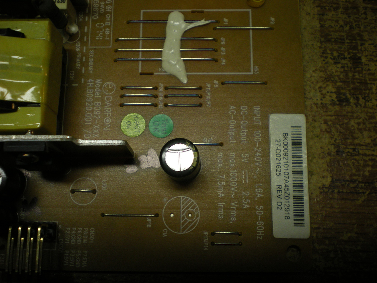

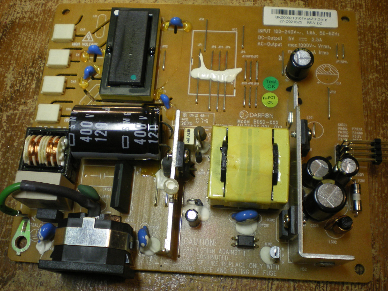

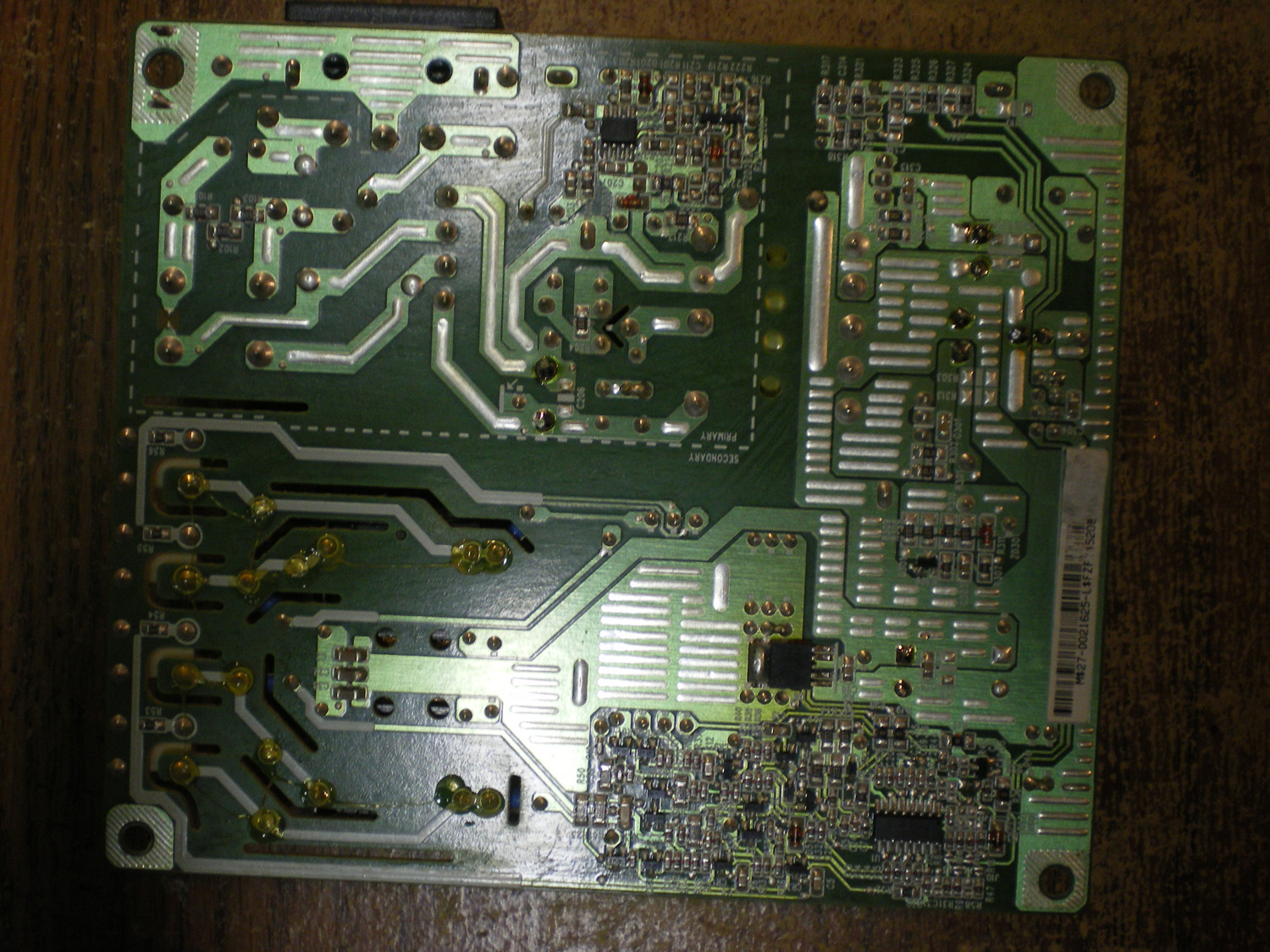

    Howdy folks I've lurked these forums a bit but have not registered until now. I was hoping that someone with a whole lot more experience than me could help shed some light on this strange inverter boards problem (I say strange, because I can't find mention of other monitors that use this board)
    I got this monitor for free, so I'd really like to get it going and save it from the dump
    The unit powers on and displays a nice picture for 5 or 10 seconds and then the backlight turns off. Checking with a flashlight, I can see the picture when the lights are off.
    I'm really new at repairing LCD's... I have a decent understanding of basic electronics, but am a mega noob when it comes to repair. So far, I have replaced all of the cheap capacitors that were on there (including the large filter capacitor), and that did nothing. I've checked the fuse, rectifier, as well as any large resistors. All check out fine using the appropriate multimeter tests.

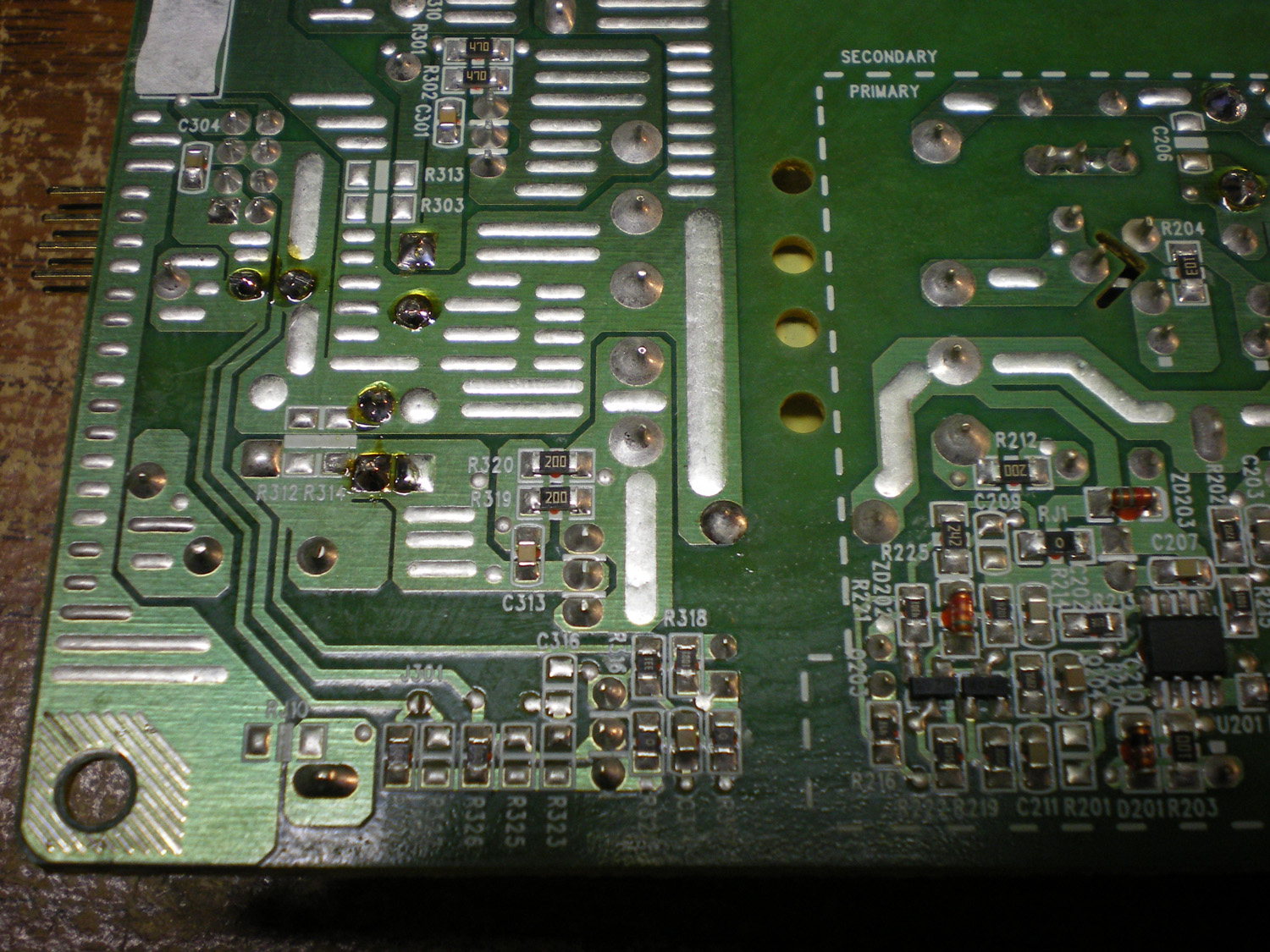

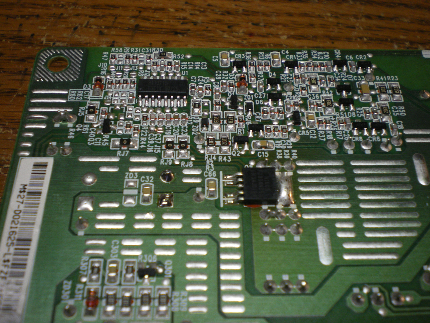

    I've scoured high and low on the bottom of the board looking for any indication of a surface mount fuse...I can't find any "F's" or SMD packages that look like fuses (just the standard resistors, caps, transistors, etc). There is however a dual package fet that has some discolouration around it - I found a datasheet for it, but instead of being a normal FET, it's a P and N type in one package - how do I test this guy? (I've never really tested any FETs before...)

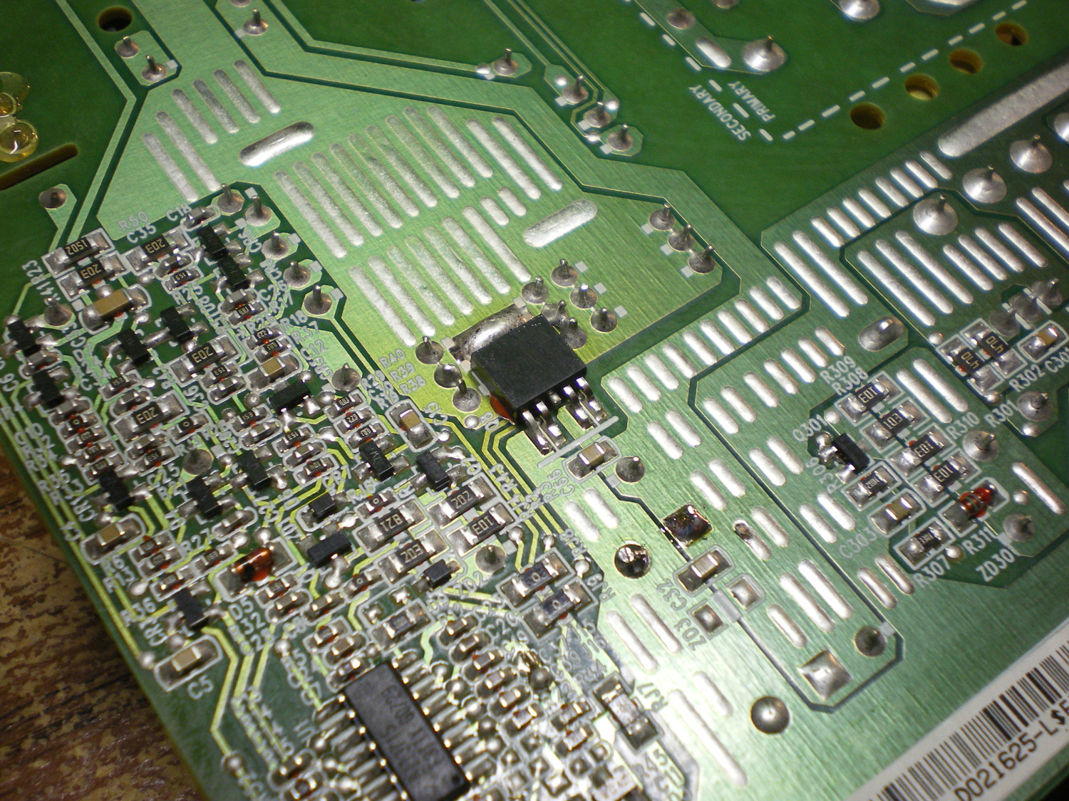

    Here's the FET's datasheet:
    https://cdn.badcaps-static.com/pdfs/...3d6e9db571.pdf
    I guess the ultimate thing would be if someone here is familiar with this board and has some specific things I should look at. I did find a service manual for this model of monitor, however the inverter board is not the same
    I've attached some pictures for reference (scroll down)!
    Thanks for any help!

    Re: Acer x193w with Darfon B092-XXX inverter - assistance needed! [lotsa pics!]
    Welcome to the forum! Looks like you did some recaping. Panasonic FC series? It also looks like you forgot to replace the small cap next to the yellow transformer. It's part of the startup circuit. You'll be interested to know that someone else is having similar problems to yours except that the exact same board is in a Westinghouse L2210NW. Unfortunately, there's two different boards in the thread. Your board starts with the member testas86. Take a look at the link below:
    https://www.badcaps.net/forum/showthread.php?t=9149

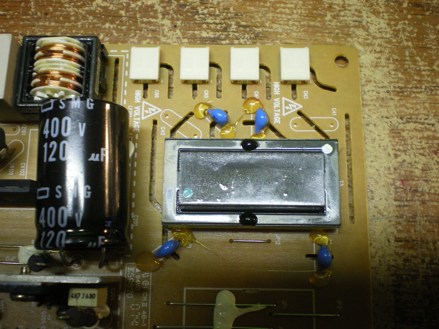

        And as a side note, Darfon inverters are notorious for bad transformers. That inverter has two secondaries - one at each end of the transformer. Measure the resistance between the pins at each end. Yeah, I know, they have glue on them.

          post #41 through #72 are relevant to transformer testing. You should get 880 ohms if the boards are similar. Look at the other thread posting for the numbering of the pins and you can test the same 1-2, 7-8 pins.

            My 1-2 and 7-8 readings are 839/840 ohms, respectively - so I guess that means it's okay? My readings between 3-4 and 5-6 are both .5 ohms.

              Yes, those readings look good.

                        Have you had a chance to test the dual FET? Your results?

                          Also, what is the part number of the CCFL 16 pin controller SMD chip located on the lower right of the board (same side as the dual FET))?

                            Mmkay, the 16 pin controller IC is BIT3715 - I've unfortunately checked F301 a bunch of times just to be sure and keep getting very low ohm readings, so I'm pretty sure it's good. Checking the dual SMD FET as per Retiredcaps' instructions on the other guys thread showed it was working okay however. I got consistent over range indication so there were no shorts.

                                  Okay, this is how it generally works:
                                  On the heatsink with the two dual diode packs D301 and D302: they each take an output from the yellow transformer and each pack supplies the 5VDC and the other 12VDC (or more).
                                  To measure voltages, make sure everything is put back together. You should be able to measure the 5V at the power supply connector (on the right side) where it's stamped 5V.
                                  The 12V might be a little more difficult, since I didn't see anything marked 12V or more on the connector: You will probably read OV because the system shuts down after 2 sec. However, proper troubleshooting dictates you at least try to read the voltage. I suspect the lone cap (rated 25V?) by itself below the barcode label might be the filter cap for the 12V. Try measuring across that cap. The alternative is to measure the output of the diode pack (D301?) at the common cathode.
                                  The voltage is all DC until it reaches the dual FET, which converts it to the AC voltage required by the inverter transformer.
                                  As for testing the CCFL, try doing a search in this forum using the term:
                                  "ccfl tester", ccfl "testing".
