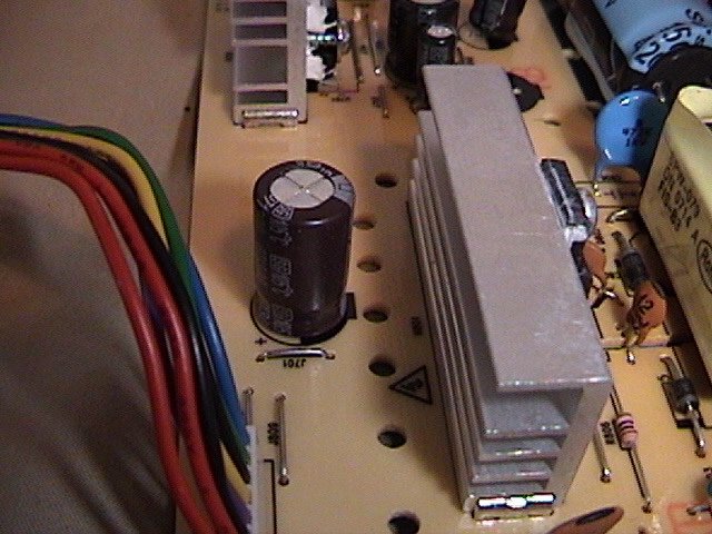

    I have a really nice View Sonic LCD monitor that doesn't work. when I plug it in the power LED starts blinking, but I'm pretty sure its a capacitor because it is bulged and I can hear it squeaking in sync with the blinking LED, and right as the capacitor stops squeaking the light flashes really bright. It looks like the LED is getting more power than it should and makes it flash wight/orange. If it is the capacitor how hard is it to replace the capacitor? any help would be greatly appreciated!

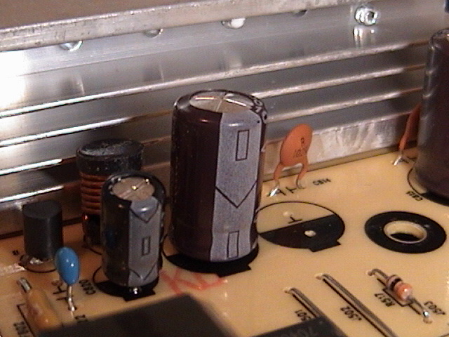

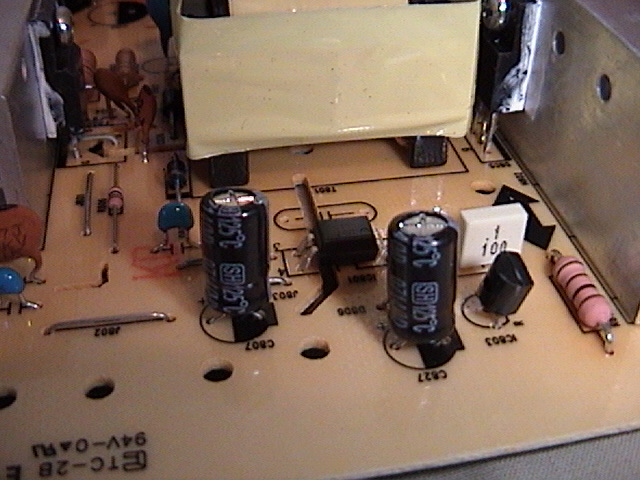

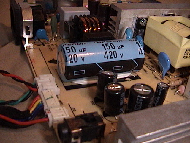

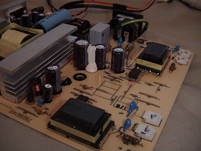

      The model is a View Sonic VX2255WMB. Here are some of the pictures the first one has the capacitor that is bulged and squeaks it is a (105°C 1000uF 10v) . I just added the others just in case I missed something.

        Most here will suggest that you replace ALL the capacitors with name brand caps like Rubycon MCZ series, Panasonic FM series or United Chemicon.
        Caps do not have to be bulged in order to be bad. They can have high ESR (ohms) or be out of tolerance. For example a cap can measure 8 ohm ESR which is really high. A good one might measure 0.2 ESR ohm. Or a 1000uF cap might meausre 220uF which is way out of tolerance.
        Now having said that and keeping in mind you are possibly new to soldering, you can always just replace the one bulged can and see if your monitor works. If it does, you can leave the other caps alone. The more experienced here will recap everything because they don't want the chance of reopening up the monitor and changing more caps in near future.
        edit: The cap that is bulged probably died from heat because it is right next to the heat sink.

            edit: You can leave the big blue su' scon alone. Su'scon is a hated name here, but those big caps rarely fail (but not never).

              The one you ID is the most commonly gone cap. That cap alone is responsible for your problem.
              You can skimp on the caps near the audio output if you don't want to make too many changes if you lack good/decent soldering skill (as explained by retiredcaps).
