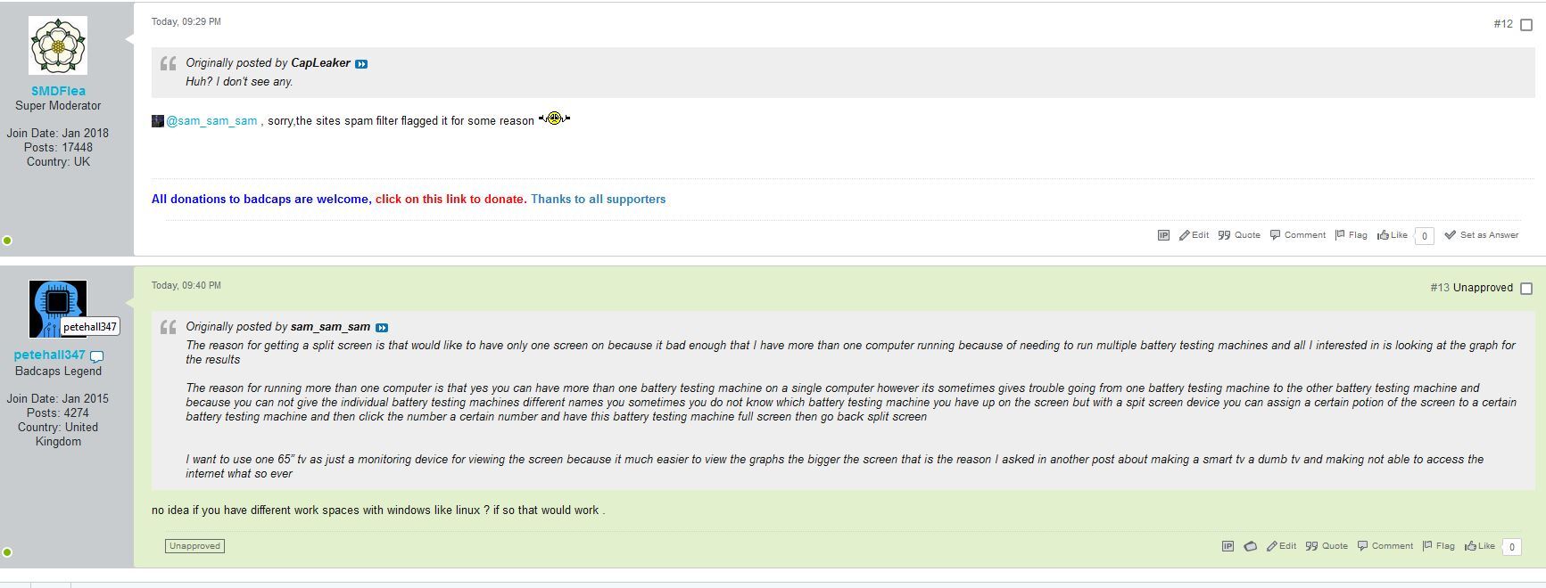

                    The reason for getting a split screen is that would like to have only one screen on because it bad enough that I have more than one computer running because of needing to run multiple battery testing machines and all I interested in is looking at the graph for the results
                    The reason for running more than one computer is that yes you can have more than one battery testing machine on a single computer however its sometimes gives trouble going from one battery testing machine to the other battery testing machine and because you can not give the individual battery testing machines different names you sometimes you do not know which battery testing machine you have up on the screen but with a spit screen device you can assign a certain potion of the screen to a certain battery testing machine and then click the number a certain number and have this battery testing machine full screen then go back split screen
                    I want to use one 65” tv as just a monitoring device for viewing the screen because it much easier to view the graphs the bigger the screen that is the reason I asked in another post about making a smart tv a dumb tv and making not able to access the internet what so ever

                        sam_sam_sam , sorry,the sites spam filter flagged it for some reason

                          no idea if you have different work spaces with windows like linux ? if so that would work .
