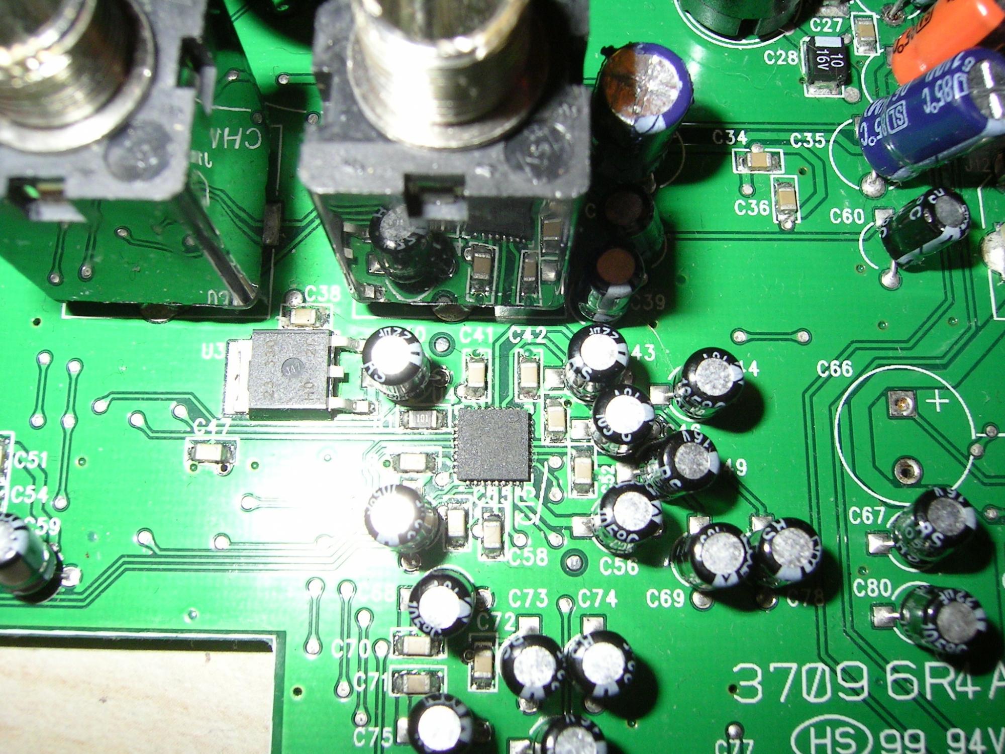

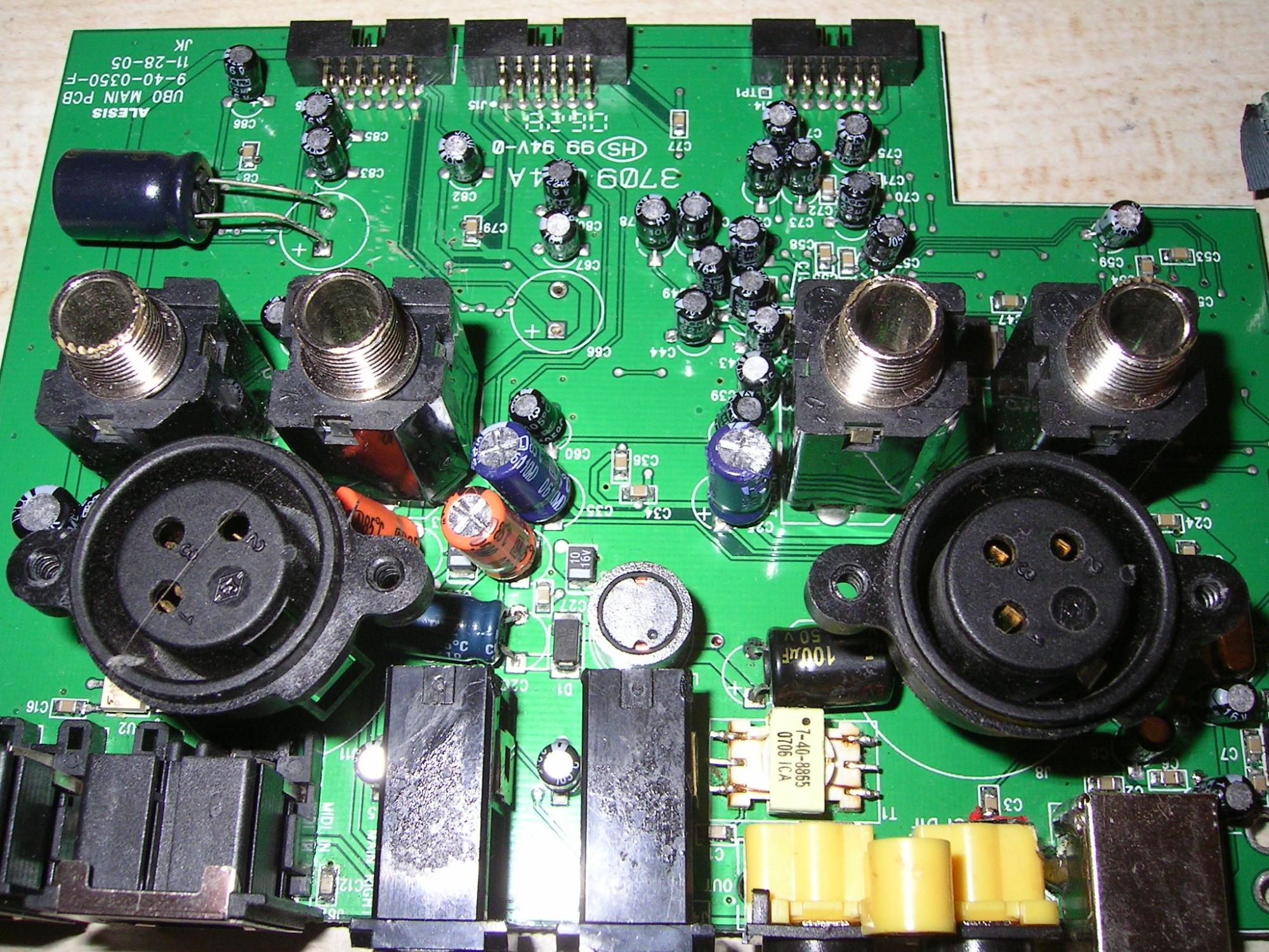

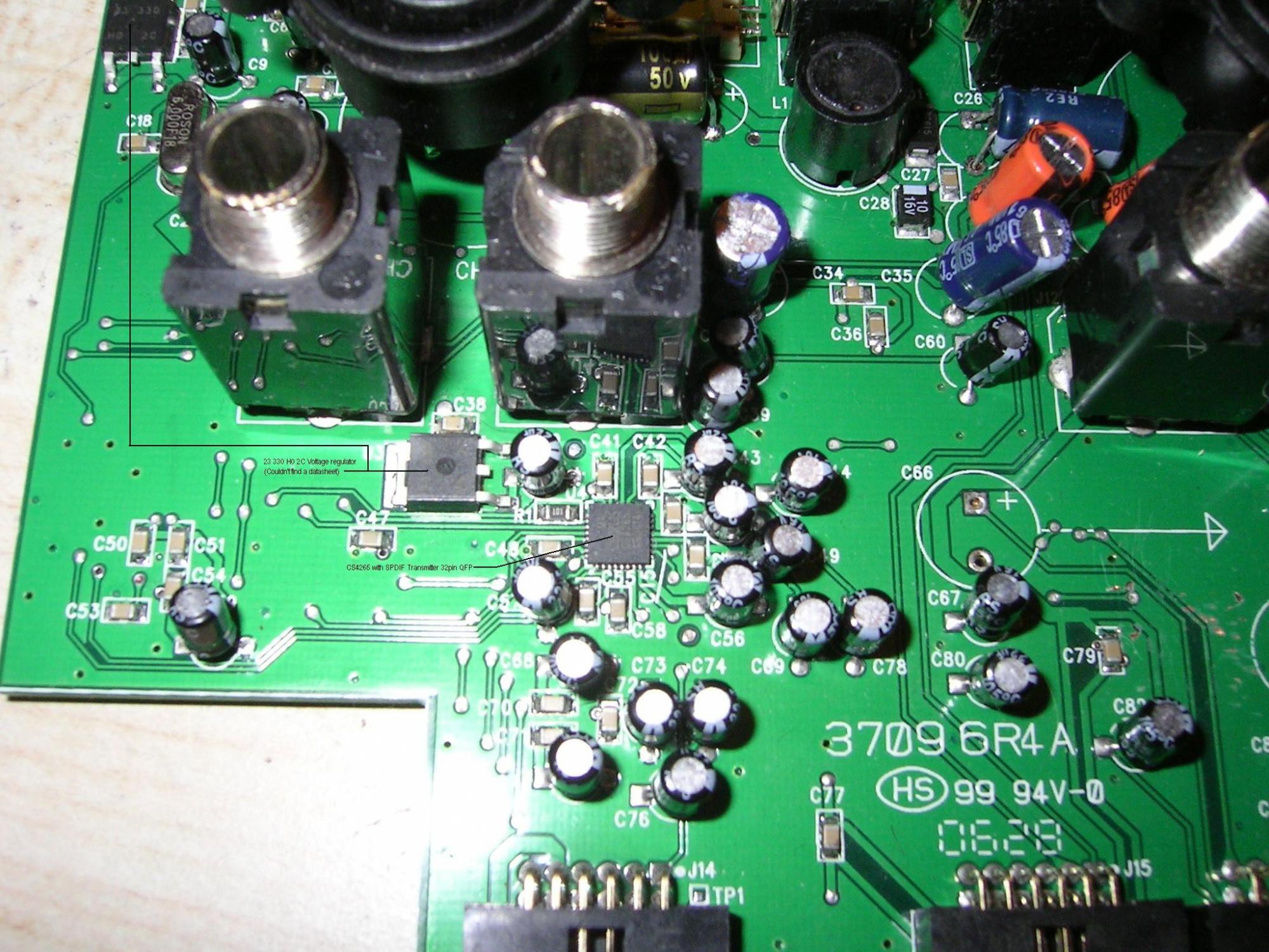

            Yes, tried USB different ports on my desktop and laptop, same:
            XP detects IO2 -> USB composite device -> USB Audio Device and
            USB LED lights up and audio level indicator LEDs light up full.
            Digital noise on headphones and main output when turned up full.

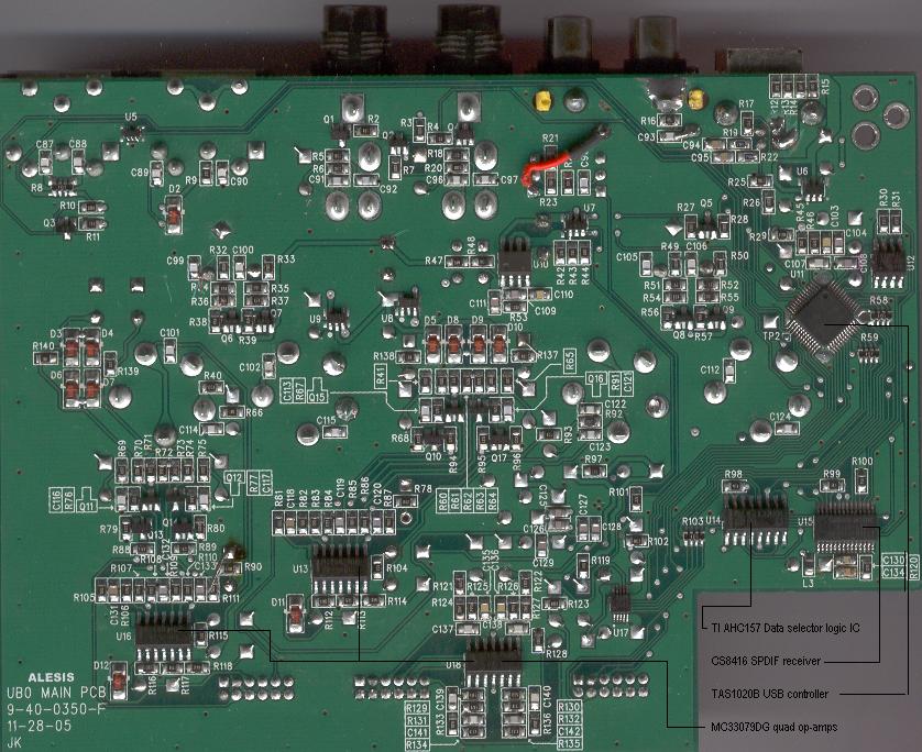

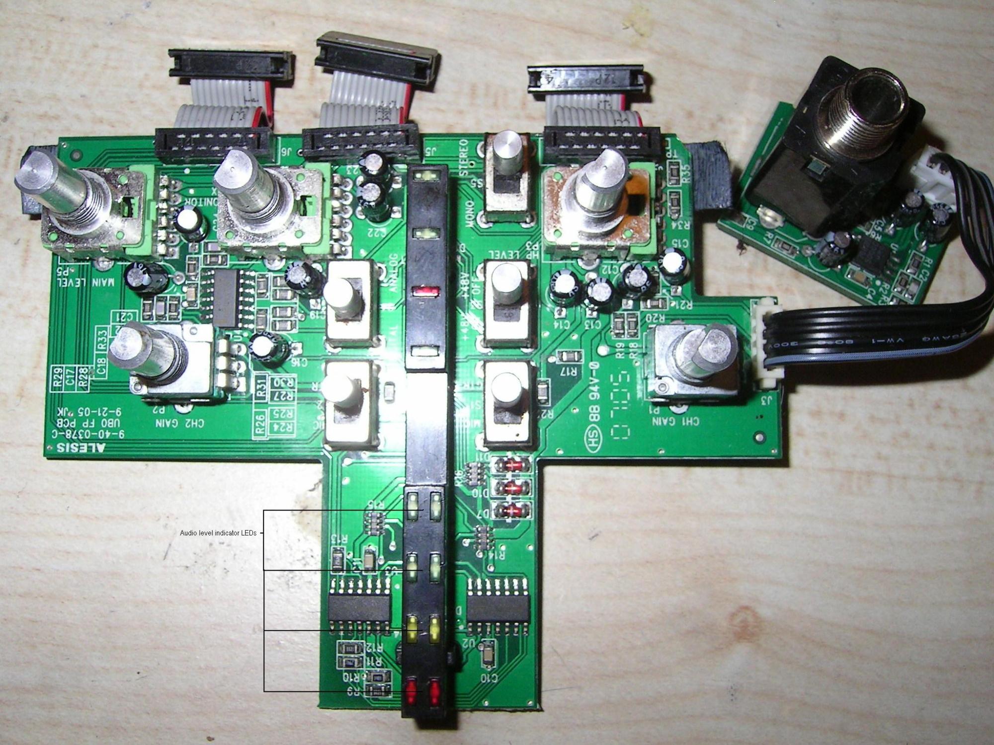

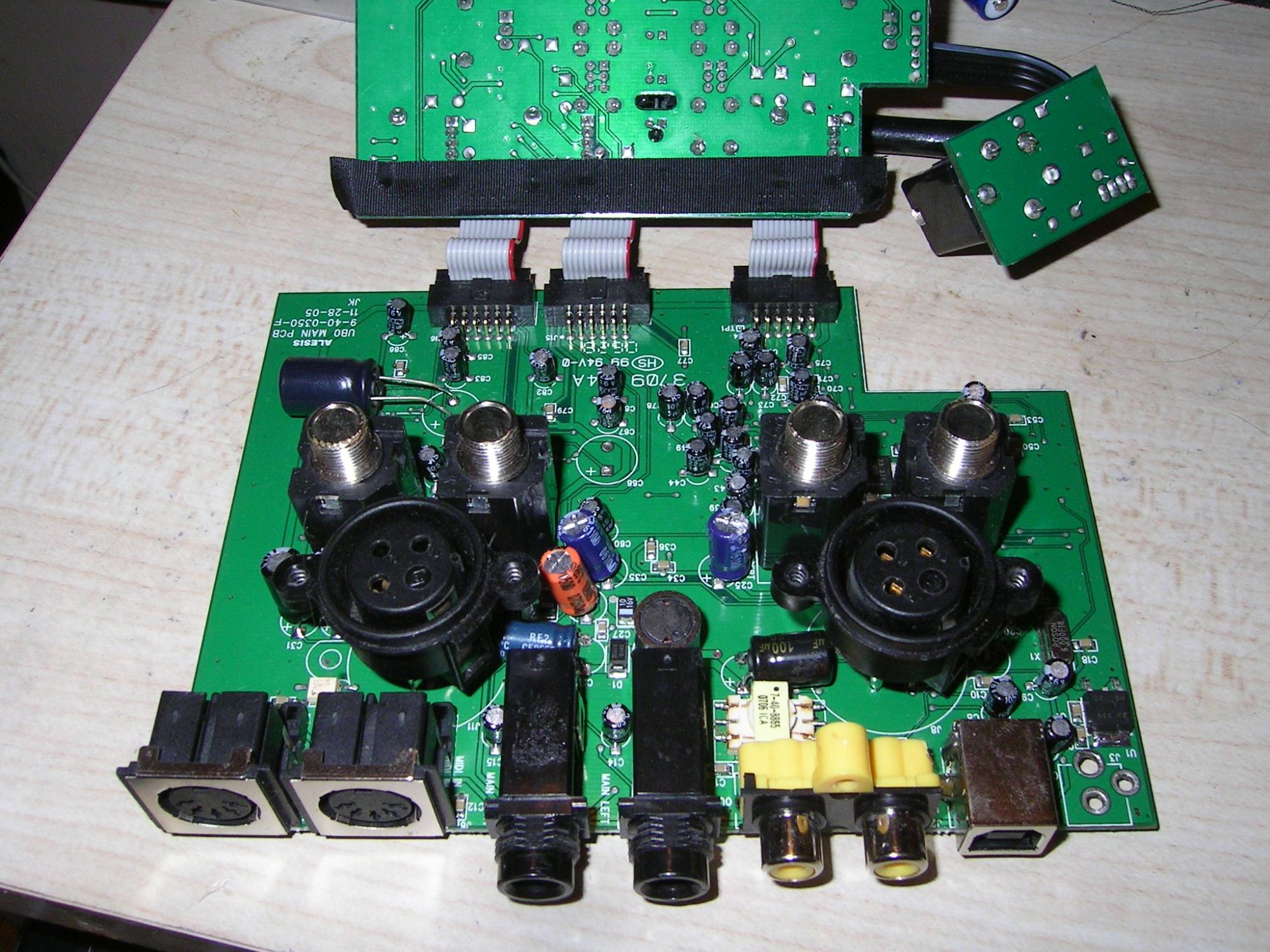

            I've finally taken some pictures of the PCBs, see attachments
            I did some research into the IC/chip part numbers and it uses:
            TAS1020B USB controller
            CS8416 SPDIF receiver
            CS4265 104 dB ADDA with SPDIF Transmitter 32pin QFP
            3 ON Semiconductor MC33079DG quad op-amps for analogue inputs/outputs on bottom PCB, 1 on top PCB below CH2 gain potentiometer.
            When I connect the S/PDIF output to my Denon AV reciever, the "Lock" LED on the front lights up so the CS4265 is outputing something, but I don't get any sound.
            The datasheet for the CS4265 says it has reset and mute pins, I'll check them if I can. Link

                      Yes I managed to get the service manual emailed to me for free. I've given up trying to repair mine as the problem is likely to be the CS4265 chip, which is pretty much impossible to get just 1 or 2 of.
                      From the pictures, you'll see that the pins are very short and soldering by hand would probably burn it.
                      I uploaded the manual to to eServiceInfo and it's a 3 part .rar achive containing the PDF due to 3MB max file size upload limit. Download all 3 parts to the same folder before extracting.

                              Thought i'd join/post as i found this post quite helpful
                              Ive just fixed 5 of these IO2's (for a studio)
                              All had the problem with the signal clip being lit up as soon as you plug it in.
                              I found on every one, the component U9 had failed! (after 6 hours of probing)
                              thought id post this up as i couldn't find a fix any other place!
                              Checked the service manual, U9 is a:
                              IC VOLTAGE INVERTER CHARGE PUMP UNREG TPS60403 SOT23-5
                              got mine from:
                              http://int.rsdelivers.com/product/te...5/5171208.aspx
                              soldered it in and jobs a good'n
