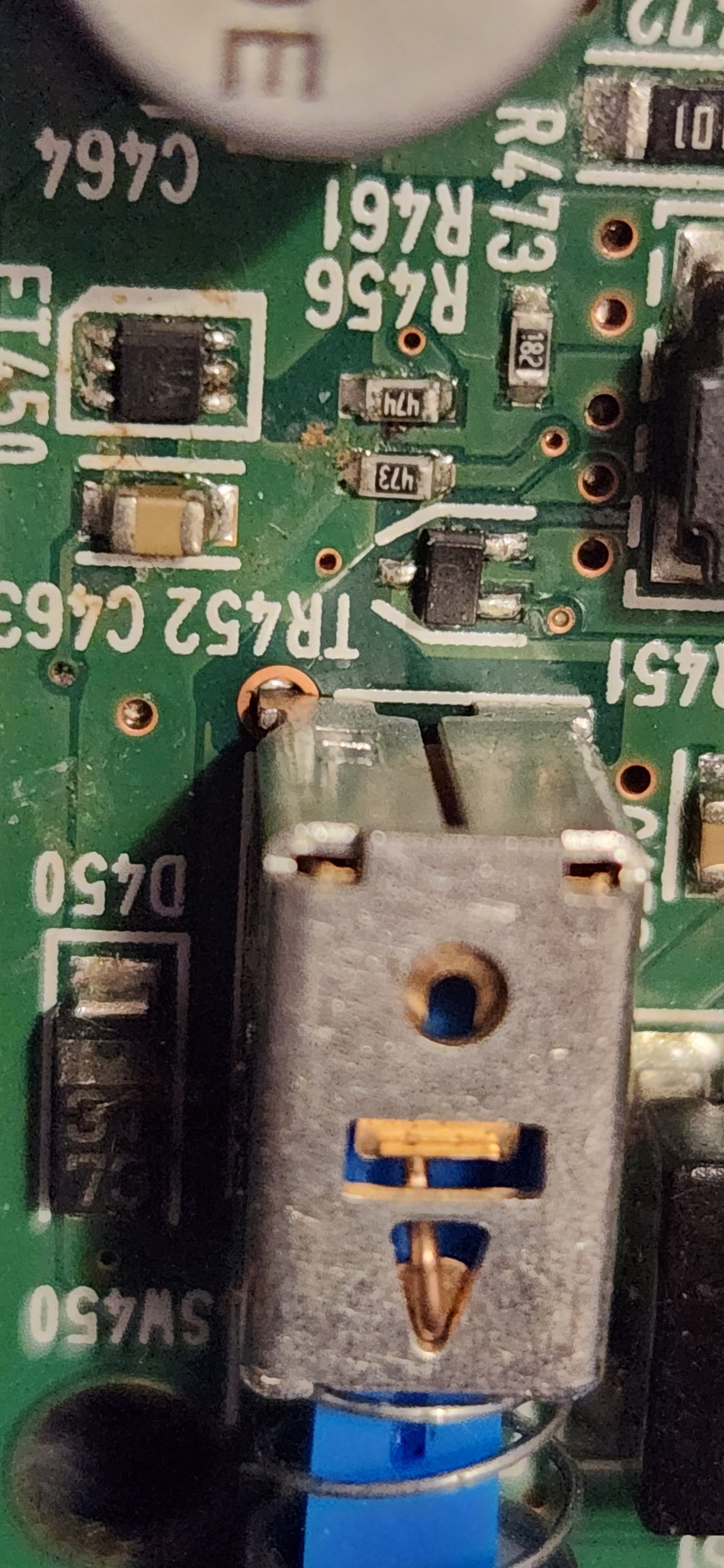

    I have a Steinberg UR44 audio interface that I had in storage for a few years, and now that I want to use it doesn't power on. I want to take this opportunity to learn electronics repair so I am trying to repair it for learning experience.
    I am looking for guidance on how to proceed with troubleshooting the problem.
    I have checked the original power supply with a multi meter and it works.
    I visually inspected the PCB board and don't see any issues, except what looks like a possible broken fuse but not sure. I checked it for continuity it reads 97 ohms, but 3 components that light up for a split second when I press the power button on the audio interface when I inspect the PCB board with a thermal camera.
    Link to video showing the 3 components heat up for a split second everytime I press the power button
    https://imgur.com/a/baUEack
    This pictures shows where the power jack is(blue circle), which is right next to the power button, and the barely visible green square shows the area where the 3 components are heating up/lighting up for a split second when inspected with the thermal camera.
    I am new to electronics repair, how should I proceed from here in troubleshooting the problem?
    Thanks for the help.

    Try the usb as a power source and see what happens then. Upload some high resolution pictures using the attachment function. These pics you posted are off site and I can't load them to zoom in.
    i would go and see if the voltage regulator or buck converter is shot. You probably need some hot air to replace SMD components. Could be also a shorted mlcc SMD capacitor.

      Looks like that 100R ohm resistor next to the 10uH inductor coil heats up pretty fast. Something is definitely shorted to ground.
      And yes, it's a resistor, not a fuse. A fuse will always read 0 ohm, and a blown fuse has no reading at all/no continuity.
      Please attach a zoomed in hi-res photo of the area, preferaby with a clear shot (meaning readable) of the marking on that 6 pin IC next to R466.
      I recommend to use two soldering iron (60W) with flat duckbill solder tips to remove a component. You can bridge a multi-pin component with lots of leaded solder to lower the melting point of lead free solder.
      Don't use hot air because the PCB is densely packed and with hot air you will just mess up everything.

              I Tried the USB power source, the audio interface still won't power on. It is completely dead.

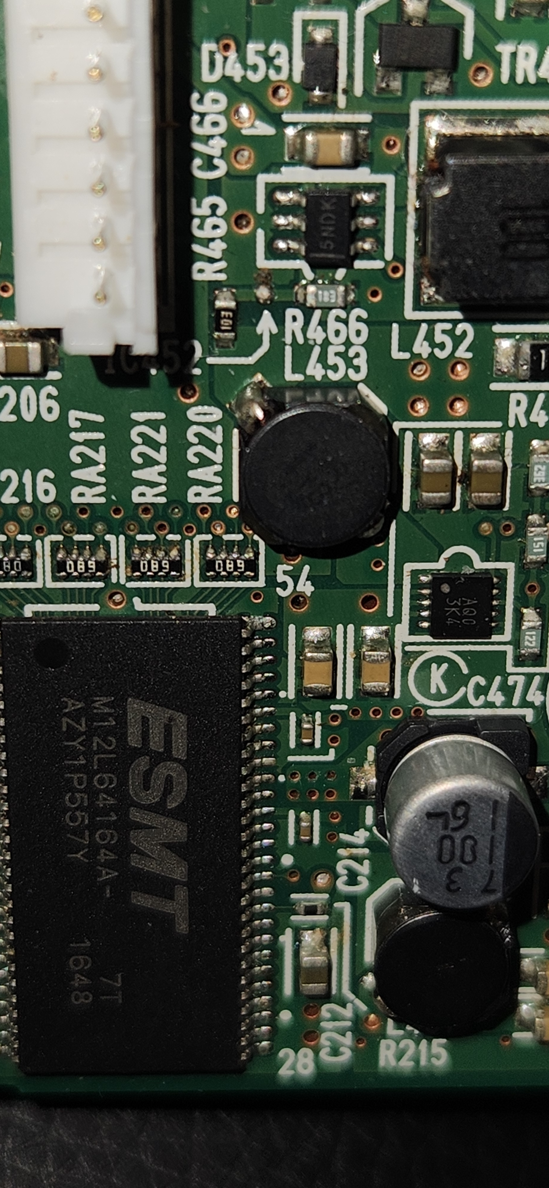

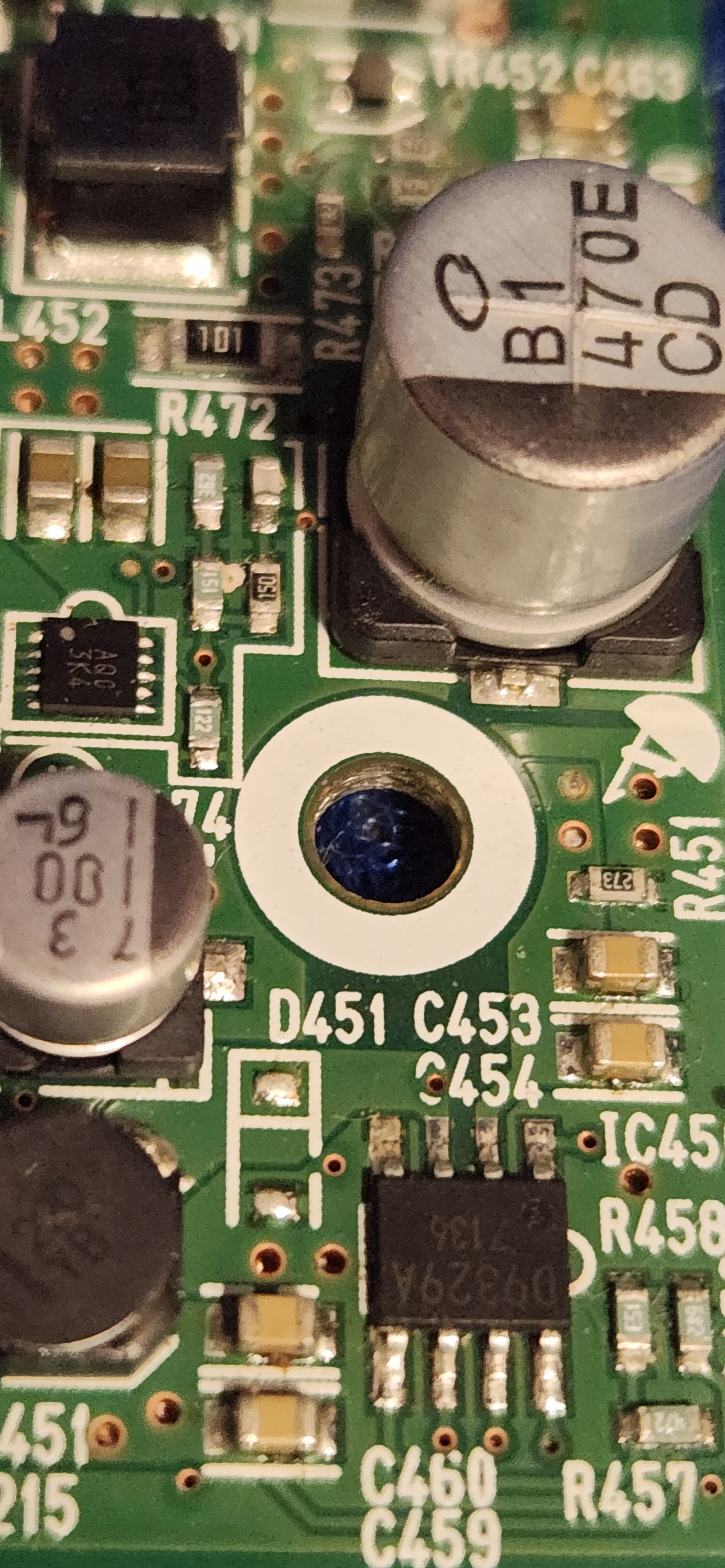

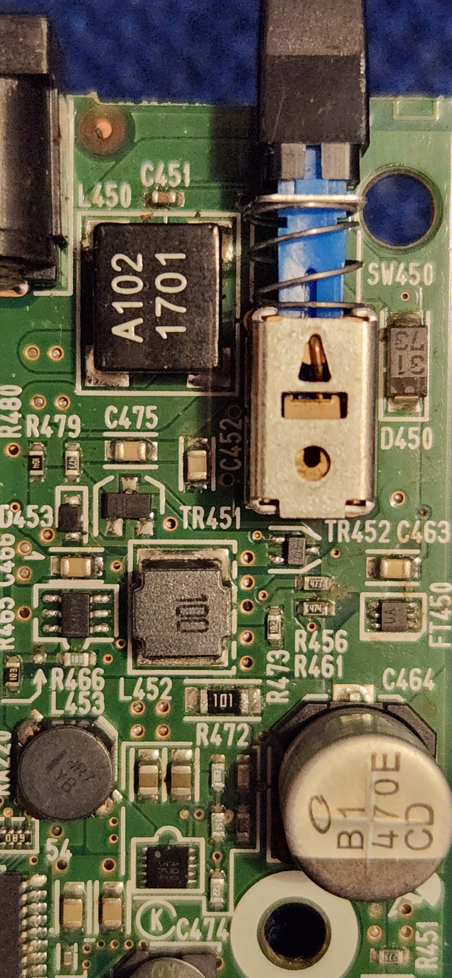

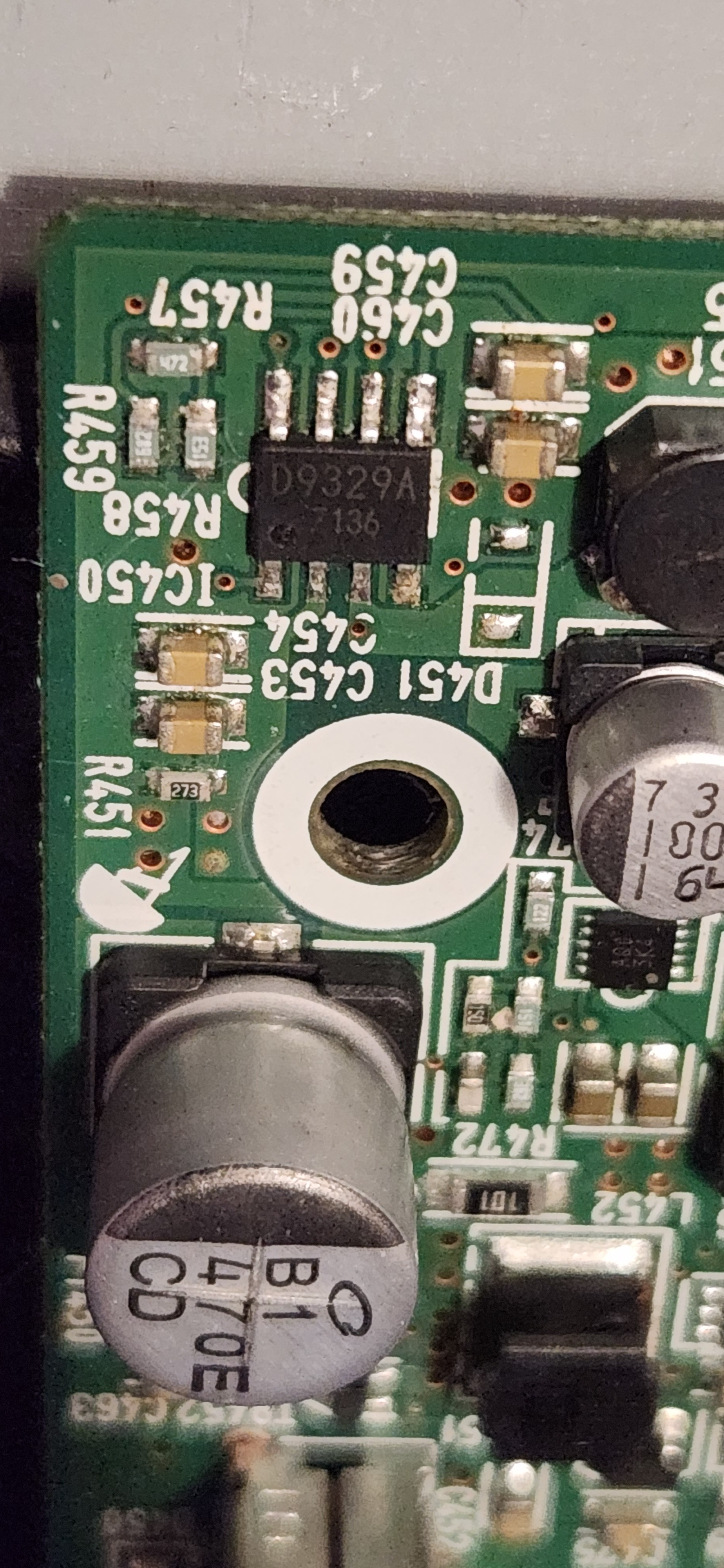

                I added hi-res pictures to the post. This board will probably be used so I can practice soldering/desoldering since according to the experts, it is a very difficult device to repair.

                  Anyway, your thermal camera already shown you where the problem is.
                  FT450 could be faulty. It's that 6 pin SMD part with a marking code "UA", which unfortunately, I don't know what exactly it is. Maybe someone else can ID it.
                  Can you measure the resistance to ground of R472 on its pin that is facing FT450?
                  Also check if the big capacitor 470uF (C464) next to FT450 is shorted or not. If you can measure its ESR while in circuit that'd be very helpful, because visually, it looks to be a bit bulging. Pretty easy to remove it though. Use a soldering iron to heat up one leg until the solder melts then gently lift the leg up with a pointy tweezer, and repeat the same process with the other leg until the cap came off of the board. Don't use force.
                  Edit: Oh i forgot that I suggested in earlier post to use two soldering irons to remove components. Here's a video of how to remove the cap with two soldering irons. Then you can check the cap's ESR.
